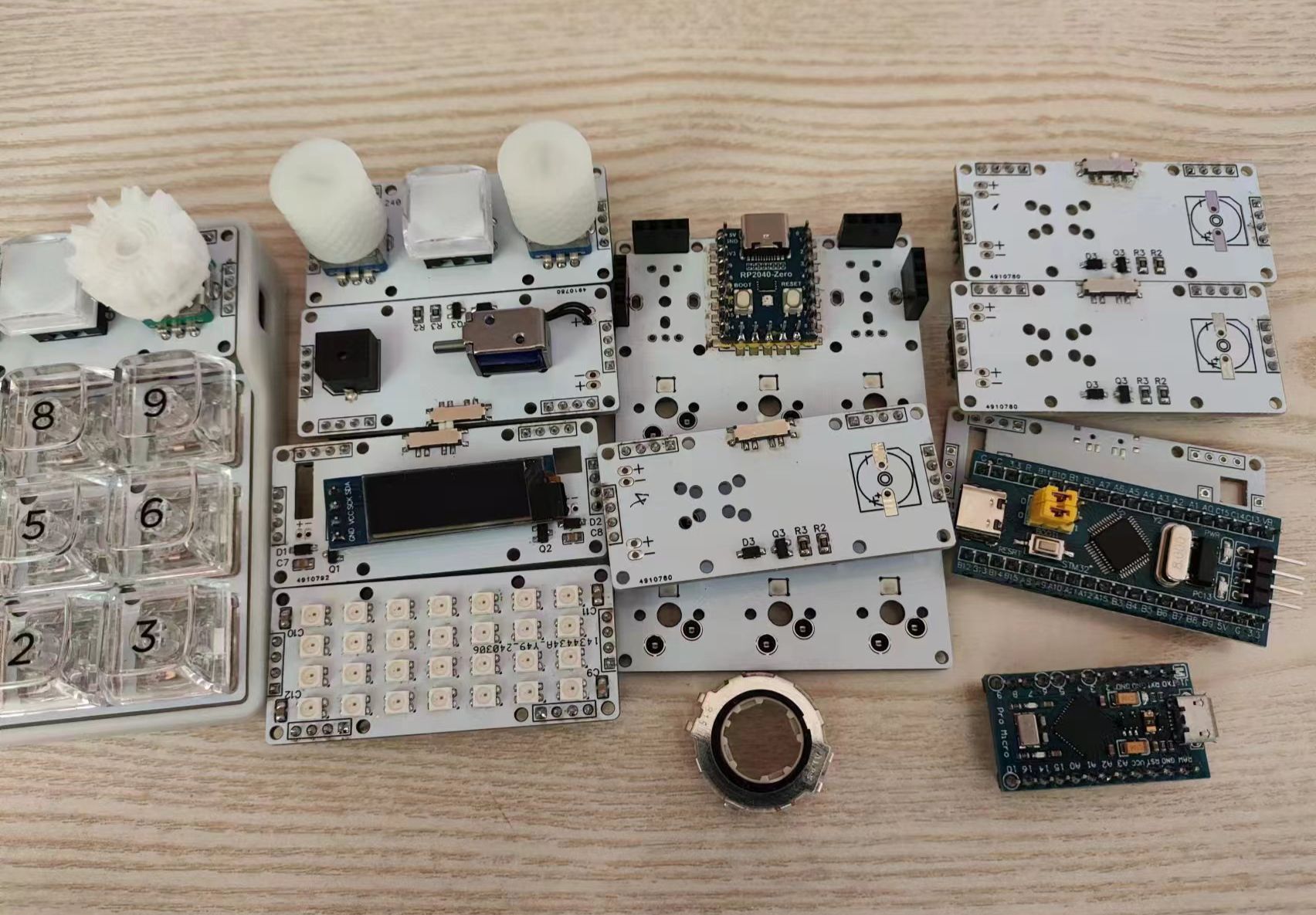

This project mainly includes some special functions of the keyboard, making it convenient for keyboard enthusiasts to find components and for reference, such as knob encoders, solenoid valves, buzzers, vibration motors, small screens, joysticks, and HUB expansion docks. Please read the notes carefully before use! Feedback is welcome in the comments section. This project is open source and will be updated periodically.
I. Attachments: The
attachments include an APM manual and bootloader file
; a table of commonly used capacitors and resistors; a recommended list of special components;
and corresponding firmware and source code for reference.
All keyboards use QMK firmware and support VIA and Vial software. The KFC keyboard uses an STM32F103CBT6 chip, and the ZERO keyboard uses a MicroSnow RP2040-ZERO development board. You can use a ready-made development board from Taobao for programming and testing.
II. Other Notes:
The joystick section has not been verified and may have issues. Please check it yourself, and feedback is welcome in the comments section for correction. All other parts have been verified (the code for the vibration motor and screen is very basic and doesn't have any fancy features).

☆☆☆ First, when you are a beginner and don't understand the schematic diagram, please just copy and paste! Do not attempt to create your own if you lack sufficient knowledge! Do not make arbitrary modifications!
☆☆☆ Second, when you are a beginner and learning to draw diagrams from open source projects, do not modify them randomly! Do not stitch things together randomly! Do not delete things randomly! Some circuits cannot be modified randomly! For example, the C port can only be connected to the D+ and D- pins of the main controller; DP can only be connected to D+, and DM to D-. For example, the STM32 programming interfaces—SWDIO and SWCLK—can only be connected to the B13 and B14 interfaces respectively. The screen can only be connected to specific pins with I2C functionality, and the joystick can only be connected to specific pins with ADC functionality. The HUB chip can support four devices simultaneously, but the right-side bus interface needs to be connected to a computer, and the keyboard controller can only be connected to one of the four sets of interfaces on the left. Also, things like programming interfaces, RESET switches, BOOT switches, and external crystal oscillators cannot be deleted arbitrarily. Having a backup plan is crucial; don't regret it when you're forced to redesign the board after a problem occurs! ☆☆☆The F103 series controller requires a programmer; it's recommended to purchase the PW link V2, which costs 9.9 RMB including shipping and includes video tutorials and a service group. ☆☆☆Regardless of the controller chosen, it's recommended to buy a development board with the same controller; this is very useful for troubleshooting hardware and firmware issues.
