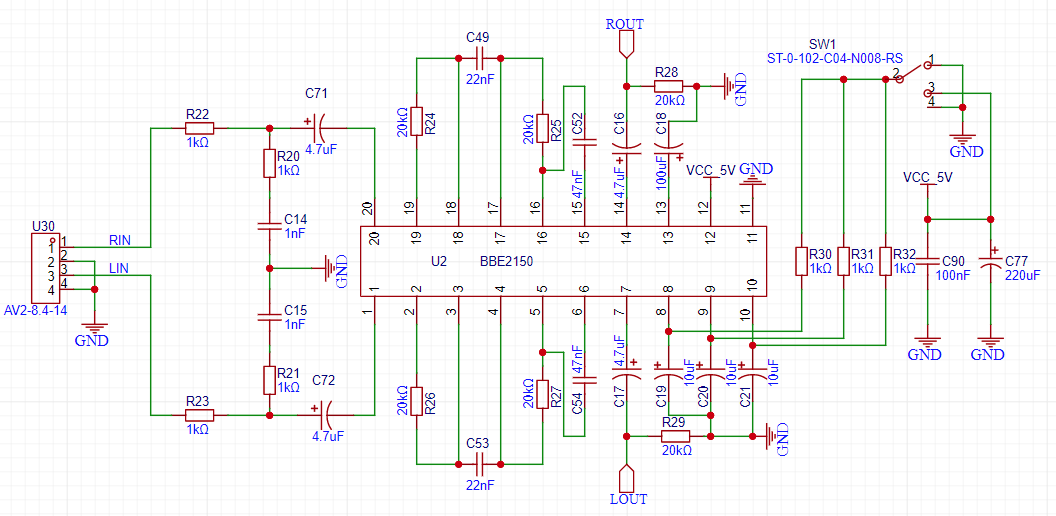

(2) The veteran audio processing IC BBE2150 is used as the audio input preprocessor.

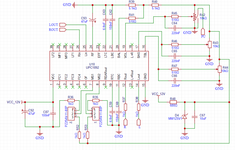

(3) UPC1892 is used as the pre-stage tone processor, which has bass adjustment and surround sound processing.

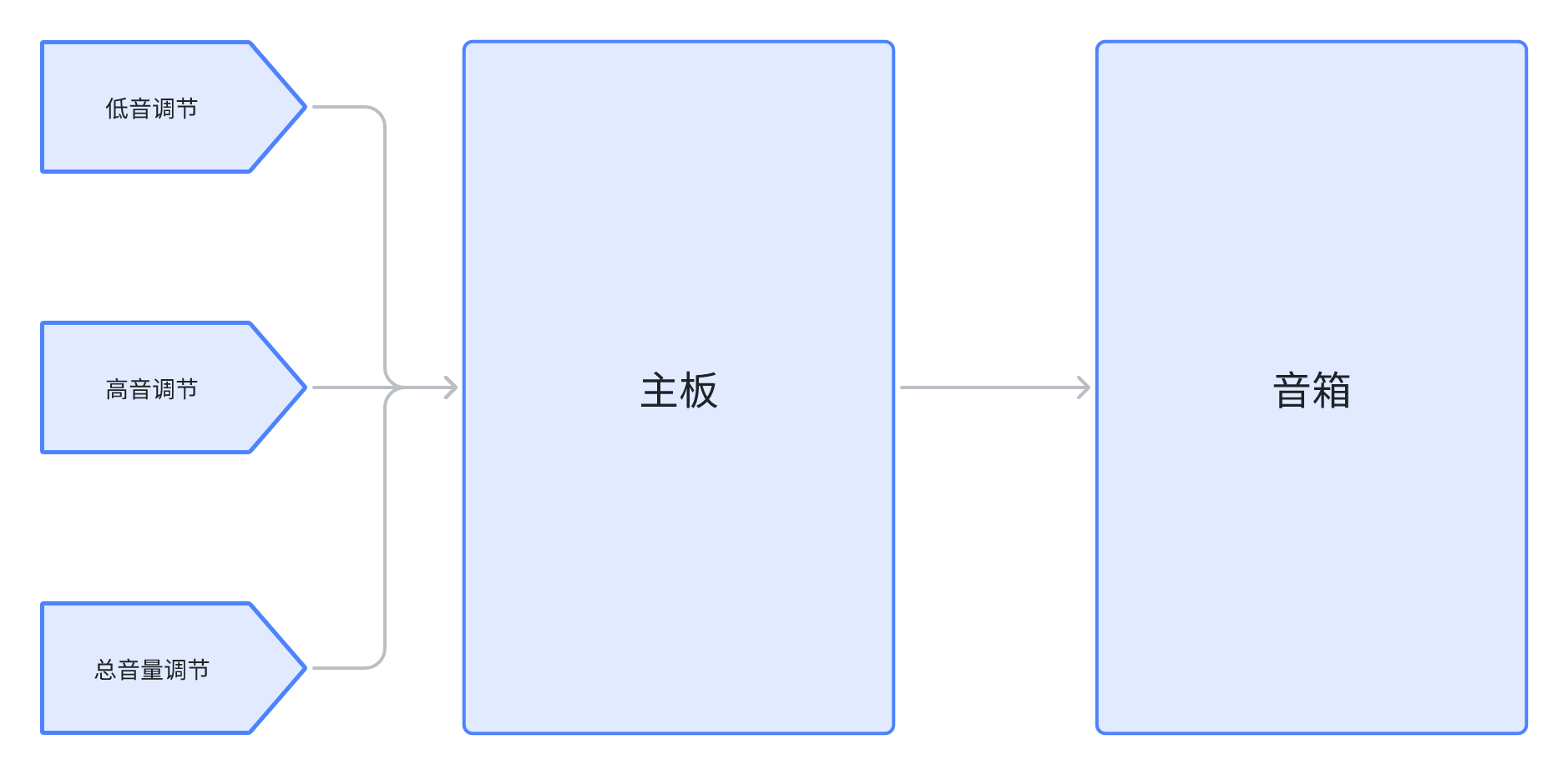

(1) To realize the bass adjustment function, the power amplifier must have 3 adjustable resistors, which are responsible for bass adjustment, treble adjustment and overall volume adjustment respectively, as shown in the figure below:

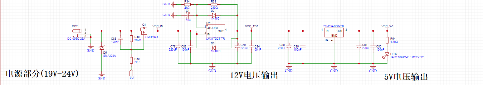

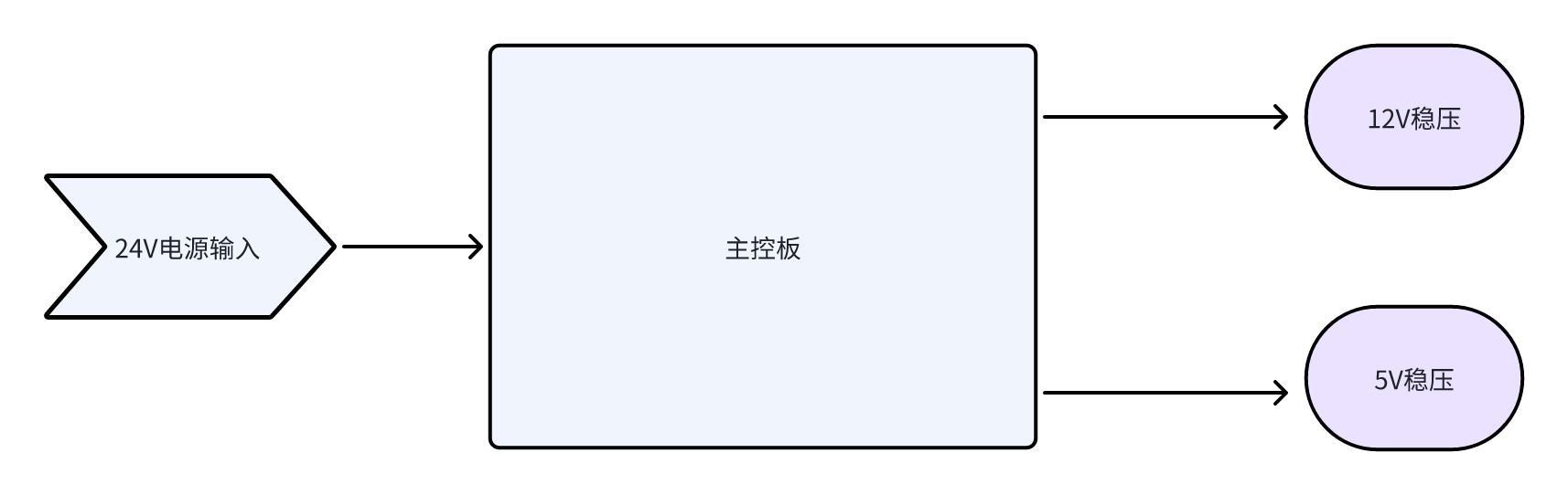

(2) Using the common 24V power input, the main control board must have the functions of step-down and voltage regulation. The specific power supply framework diagram is as follows:

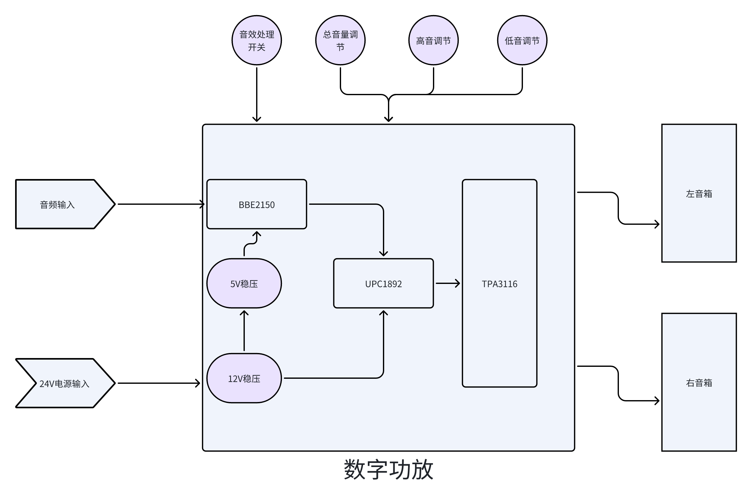

V. Overall Design Block Diagram

(1) Power supply circuit
(2) Audio input preprocessing circuit
(3) Bass adjustment circuit

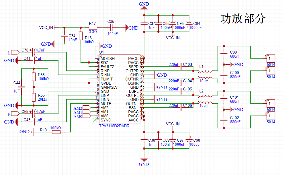

(4) TPA3116 post-stage driver circuit

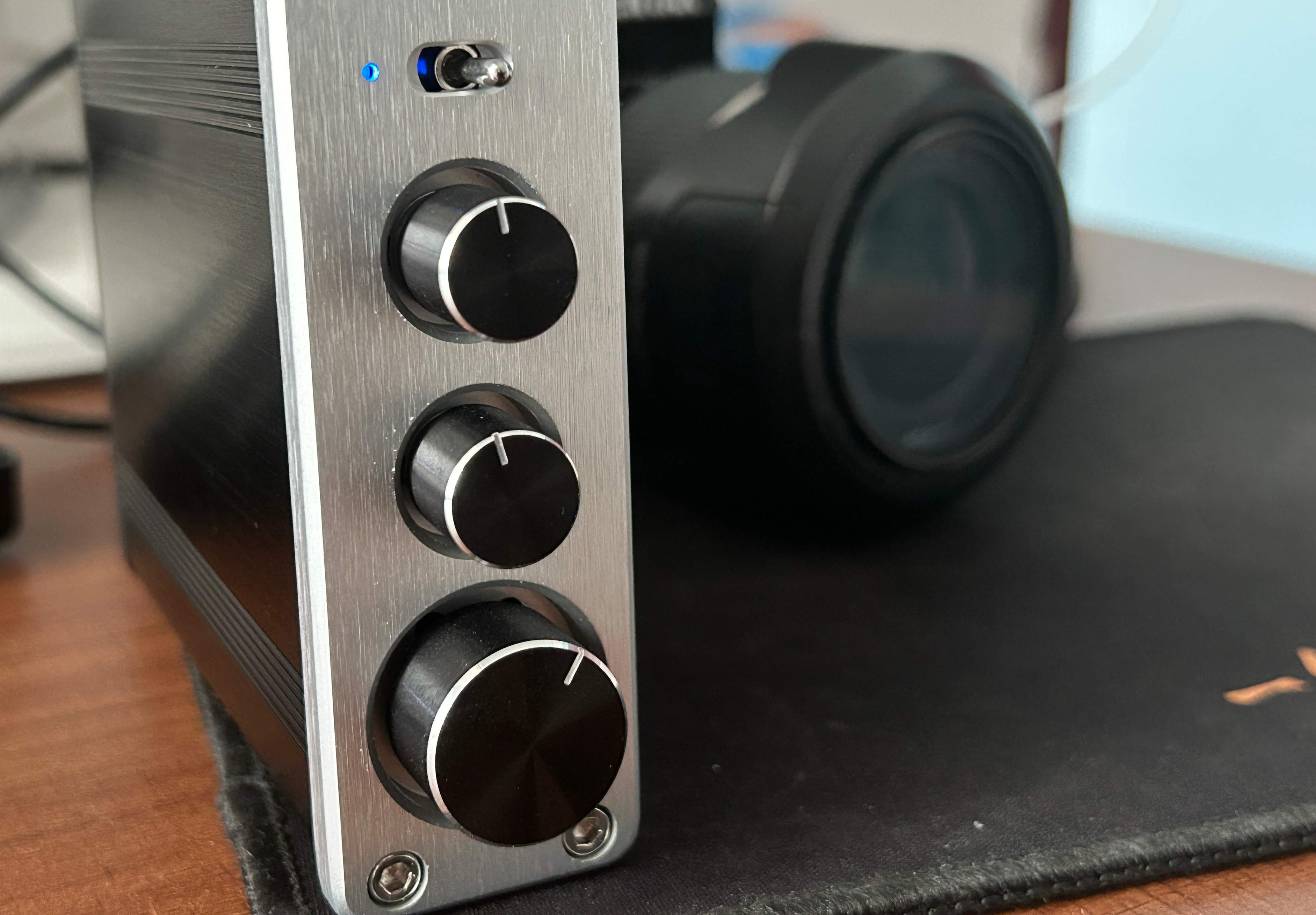

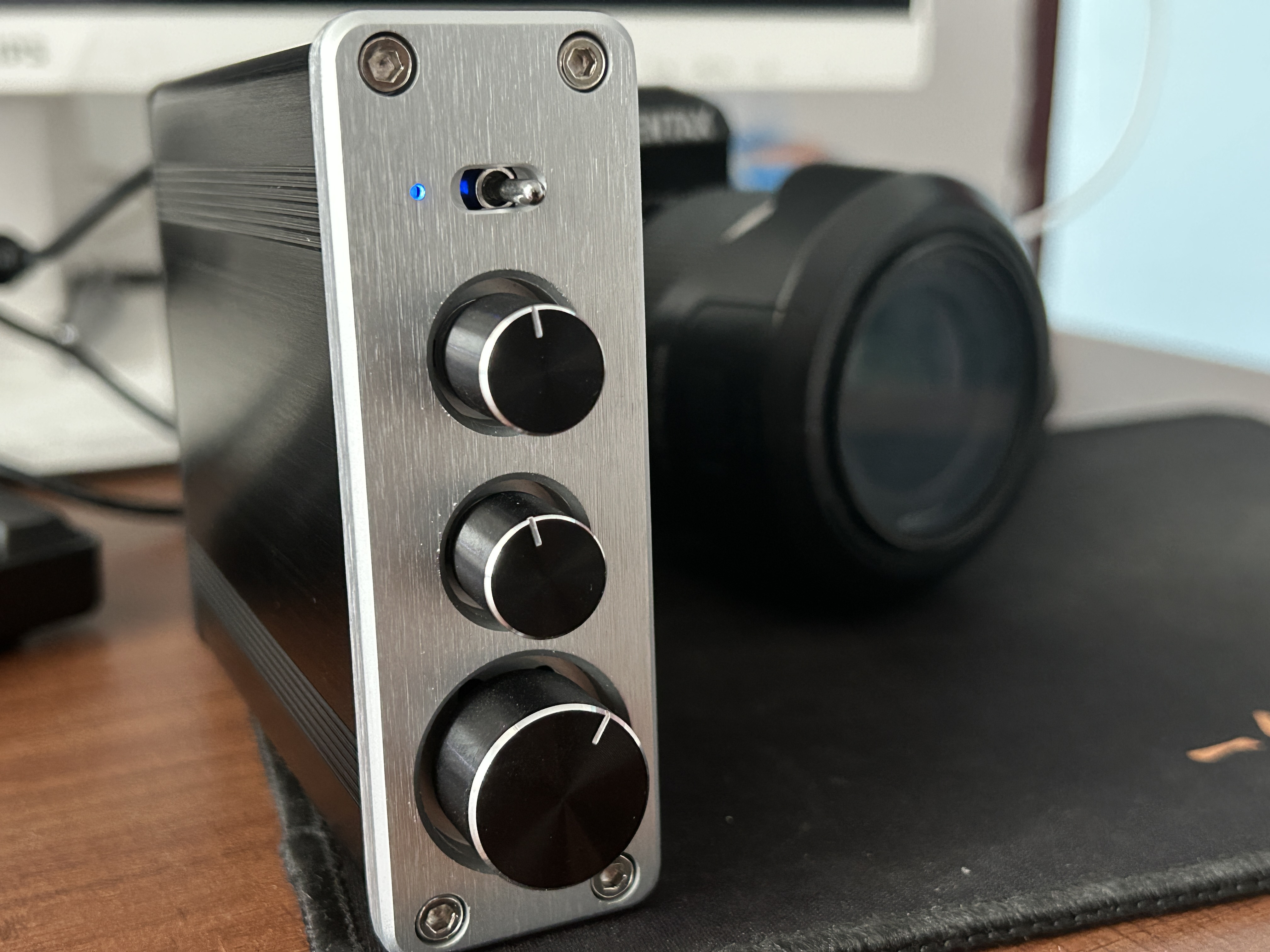

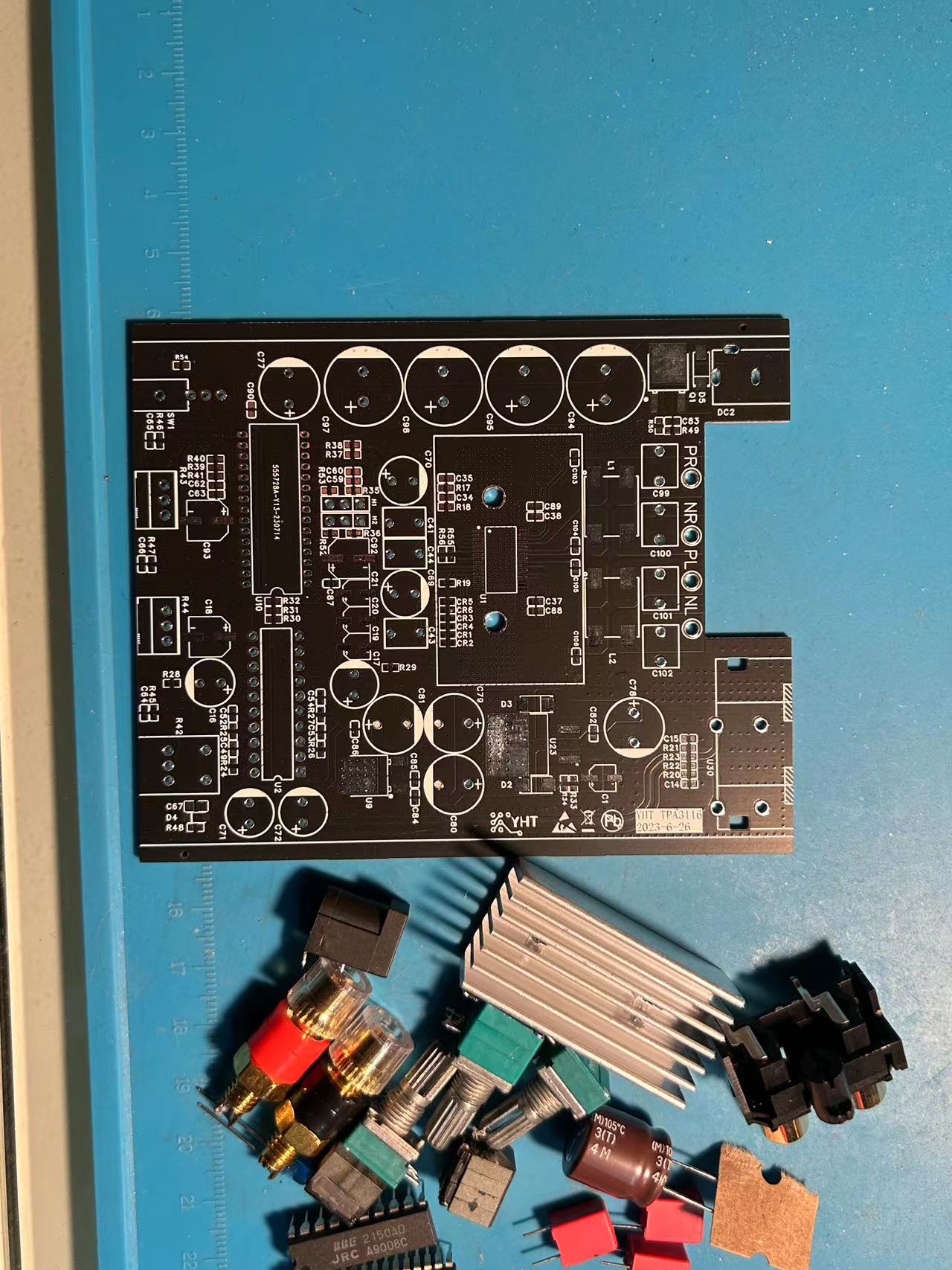

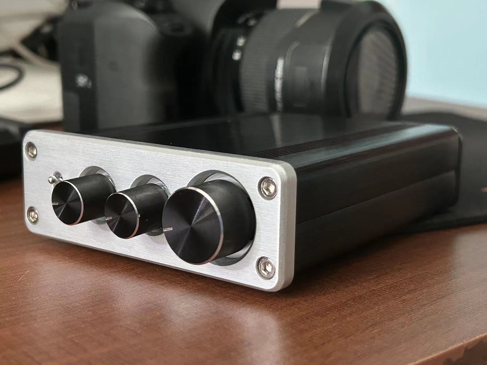

VIII. Physical Display
