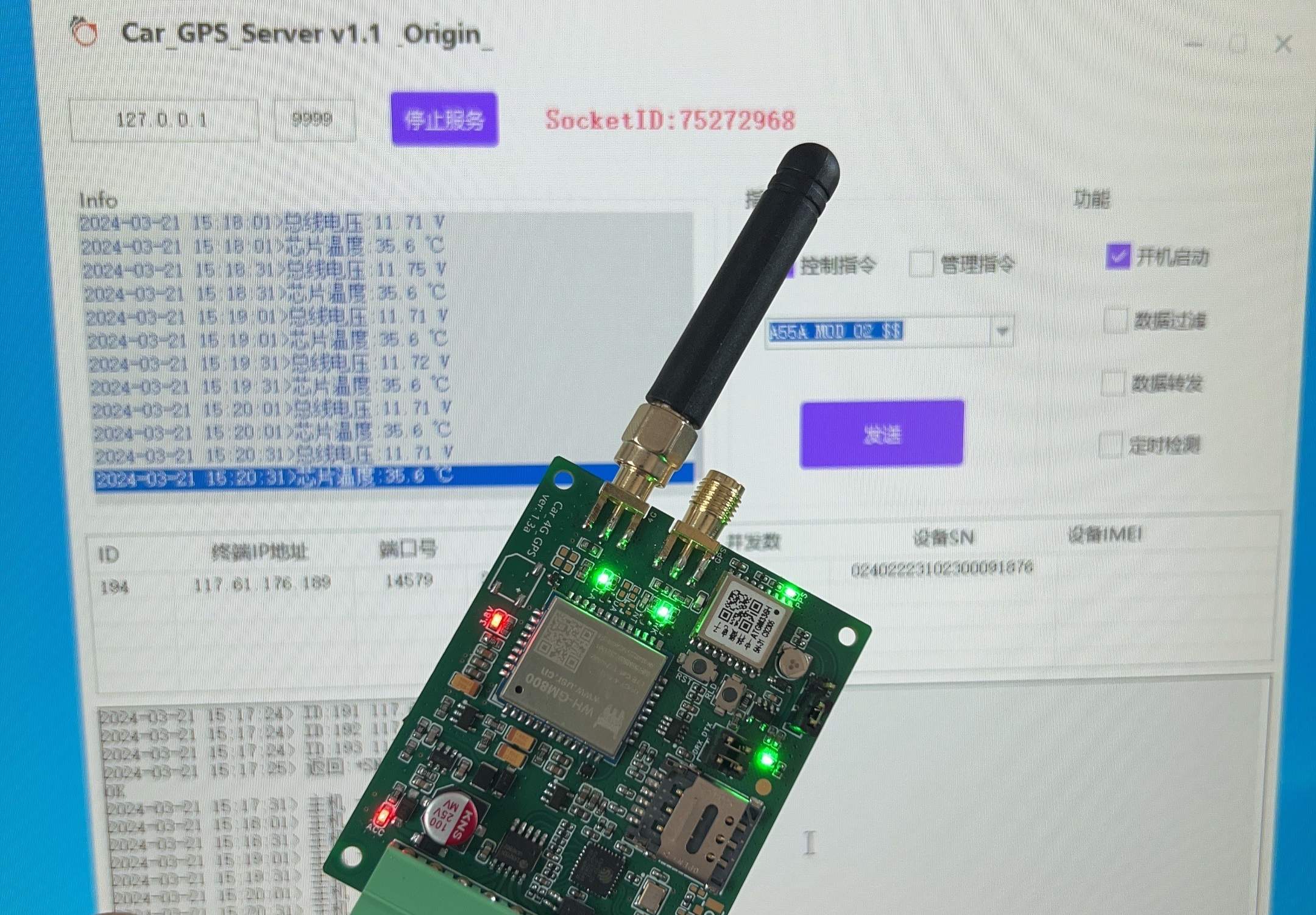

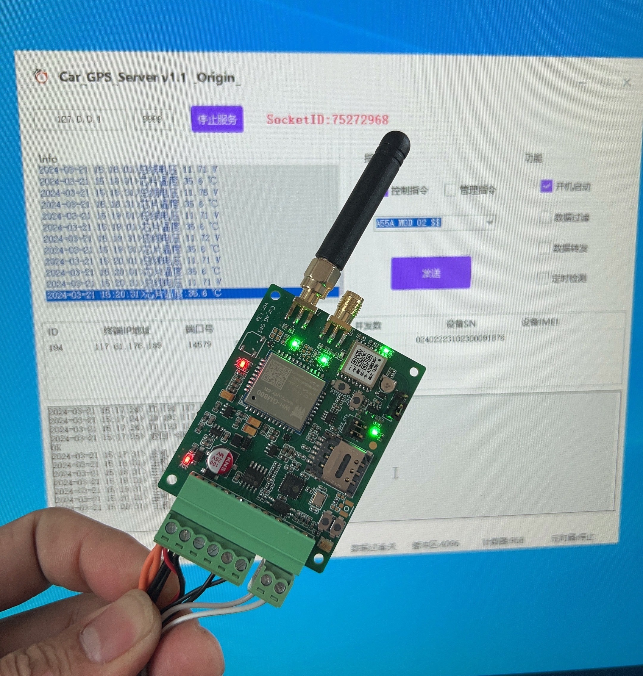

4G IoT Positioning and Control Box (Hardware + Server + APP)
The less text, the more informative... A complete in-vehicle IoT device solution.
Like this post to stay on track! BF
product features
include an IoT positioning module with remote control. This solution is also compatible with various communication protocols such as 485, Modbus, MQTT, TCP, and UDP. It features
vibration sensing, automatic sleep mode when stationary, and automatic wake-up upon vibration. When
the power supply voltage drops below 10V, it will automatically shut down 4G communication and GPS power supply, and the load will also be turned off to protect the vehicle battery. Upon voltage recovery, it will automatically connect to the network and send its location.
It includes GPS signal loss detection and cloud data feedback.
Vehicle control functions include remote start, remote unlock, remote fuel cut-off, power cut-off, etc.
The load can control multiple lighting modes (strobe, breathing, navigation, single flash, double flash, etc.).
It can be expanded with the CAN protocol for advanced remote vehicle control functions (protocol requirements analysis required).

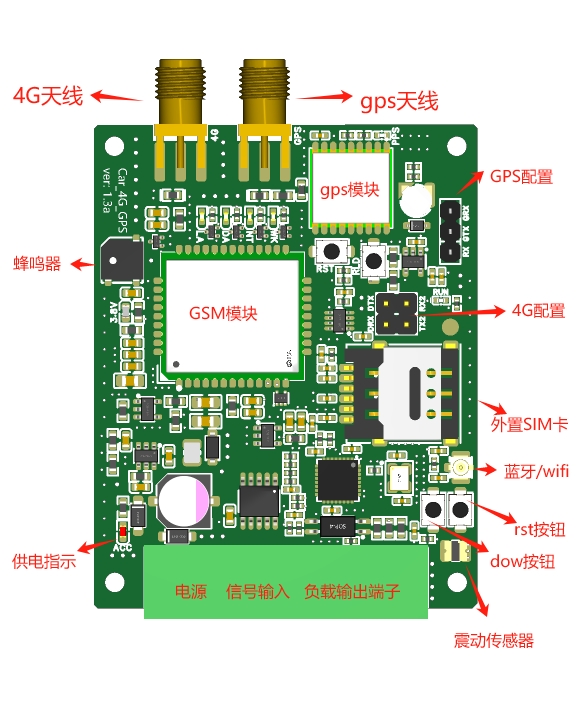

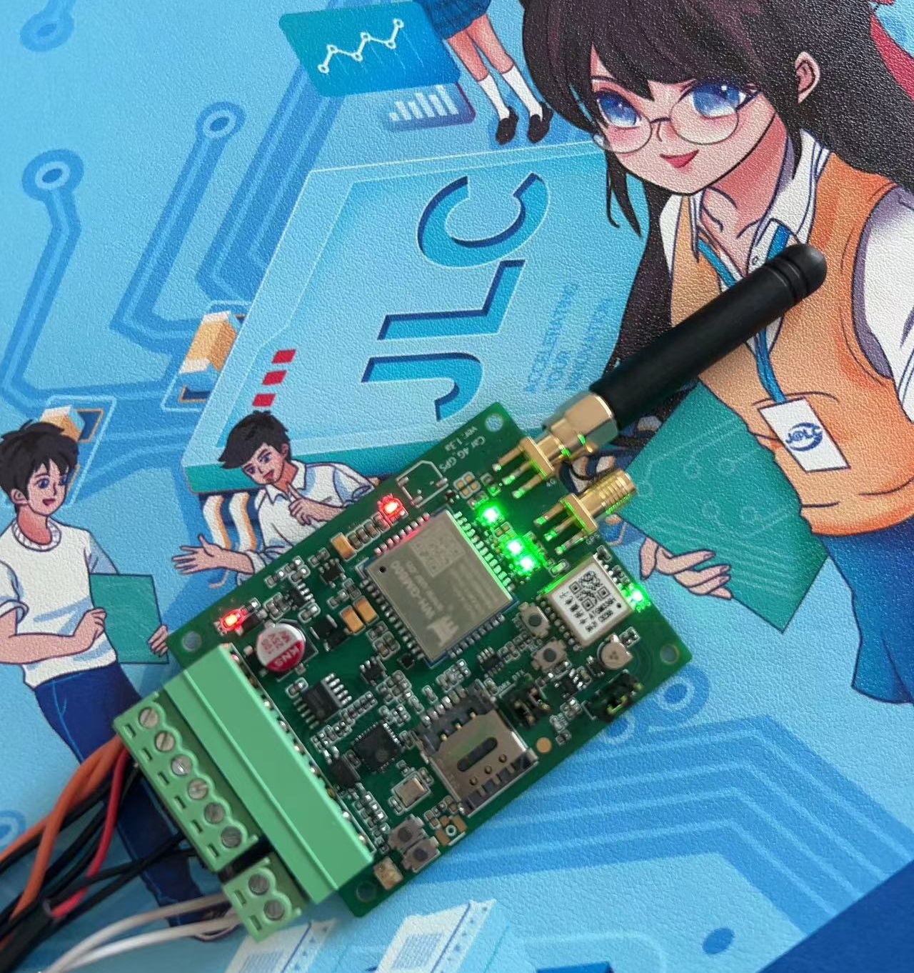

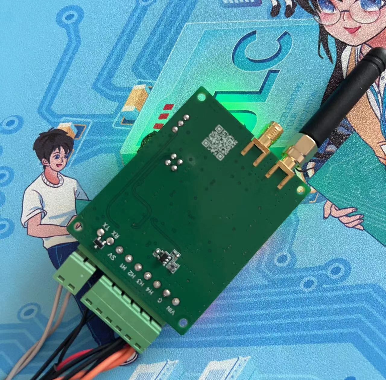

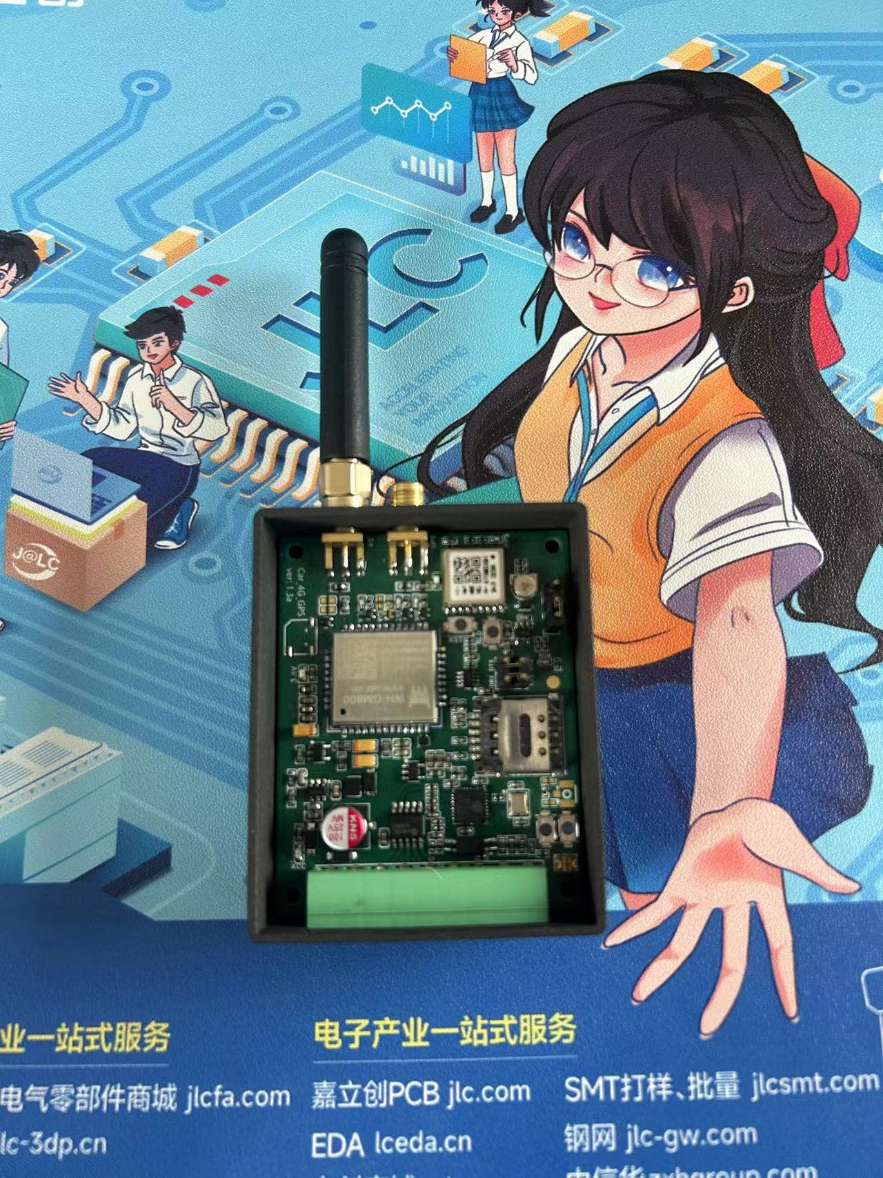

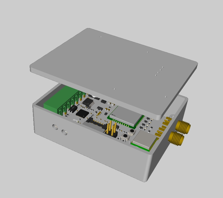

Project Parameters
: PCB: 4-layer board, 1.2mm thick;
Dimensions: 47.54mm x 59.9mm;

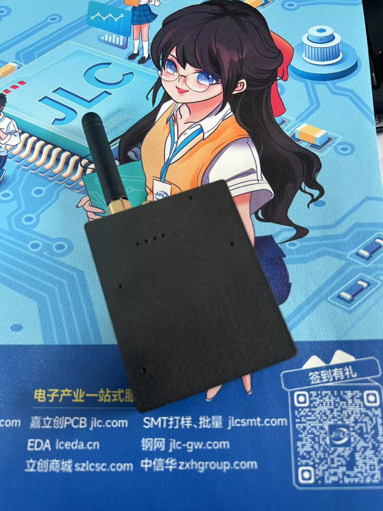

Housing: 3D (internal)
; Interaction Method: Windows UI + APP;
Power Input Interface: 6V-30V;
Load Output: 4 low-load loops
; Communication Method: 4G LTE;
Module Drain Current: 15mA;
Module Normal Current: Maximum 80mA;
Total Load Current: Maximum 3.2A;

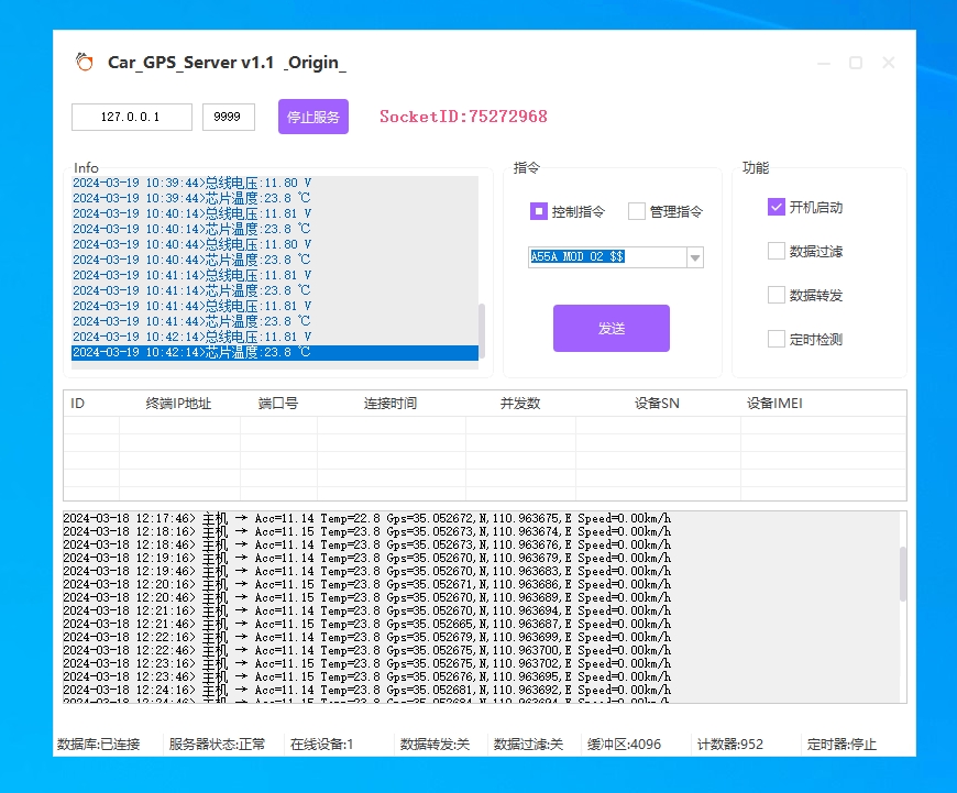

Win Server (Implemented)
: Basic Command Issuance,
Management Command Issuance,
Boot Startup ,
Data Forwarding,
Data Archiving (Local Database),
Function Restart Memory,

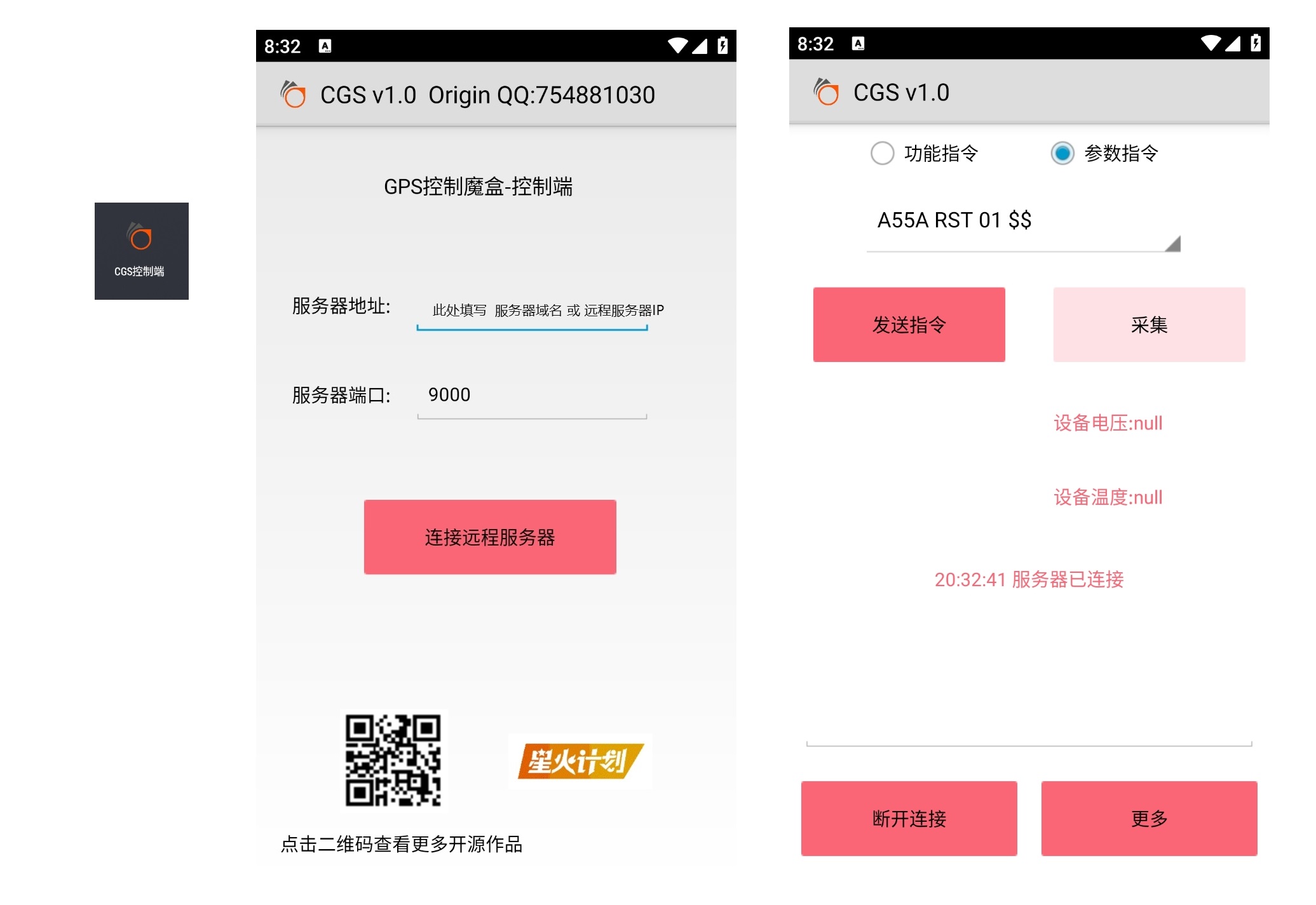

Mobile APP
Communication Prompt Sound,
Server Reconnection
, Exit Confirmation (2 Returns),
System Settings Interface Call,
Bluetooth Short-Range Communication

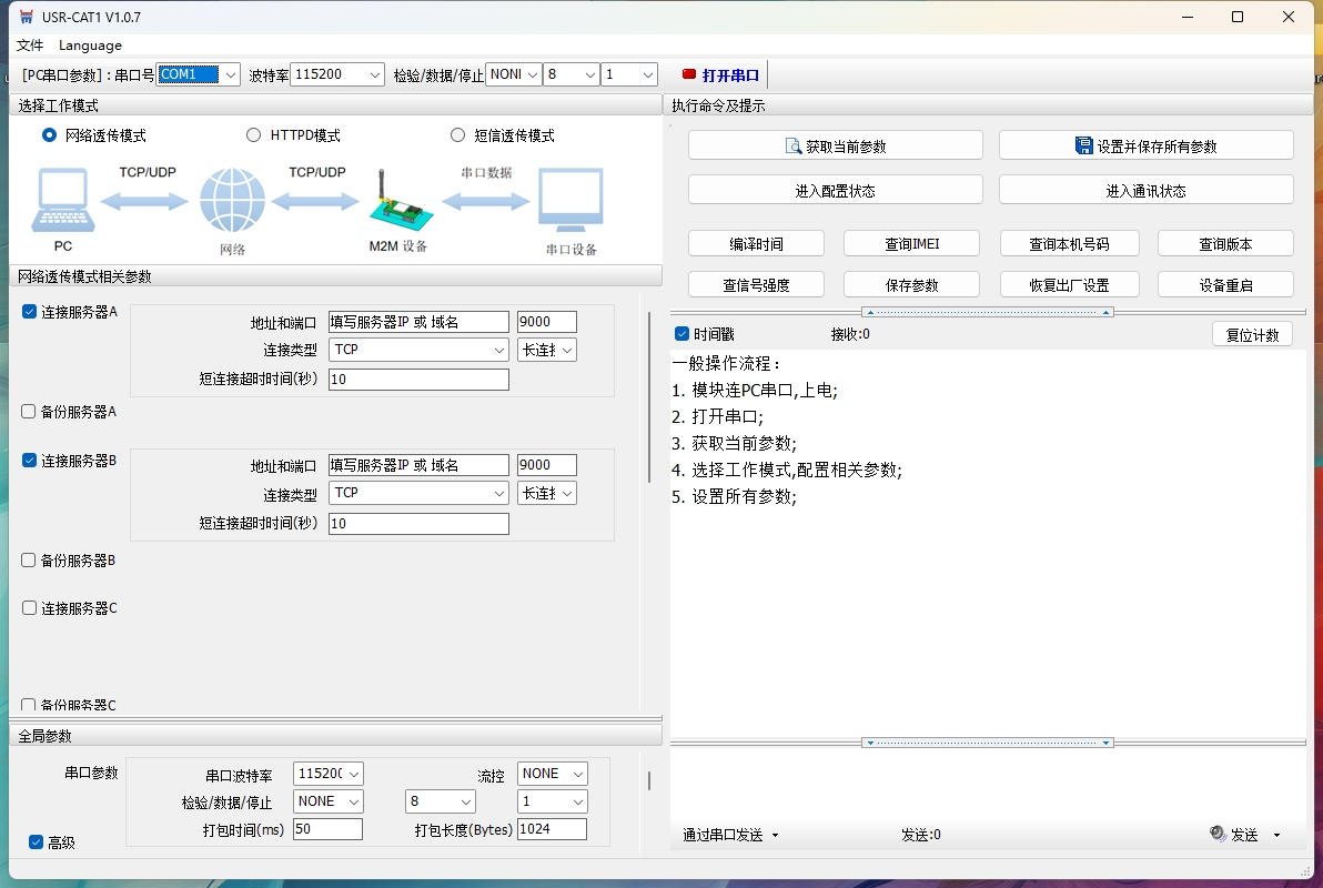

. 4G Module Configuration: Data being compiled...

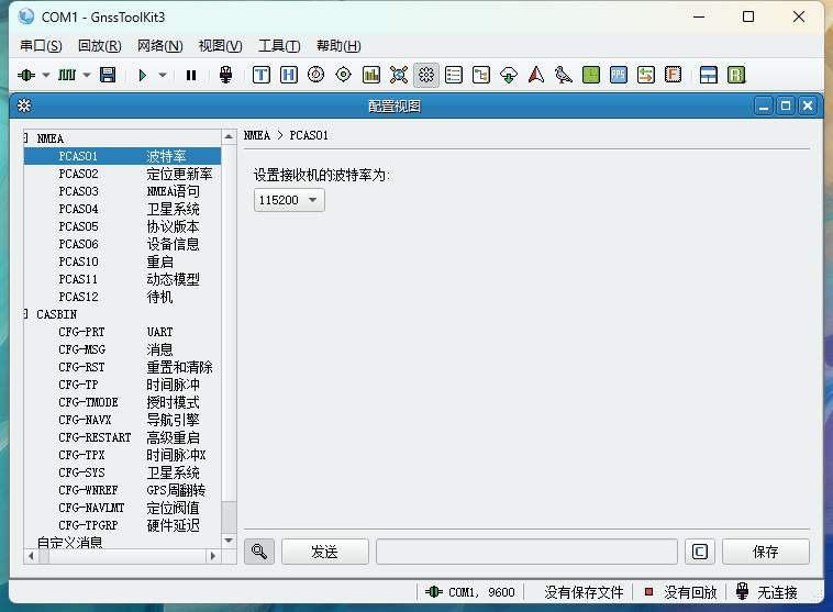

GPS Module Configuration: Data being compiled...
