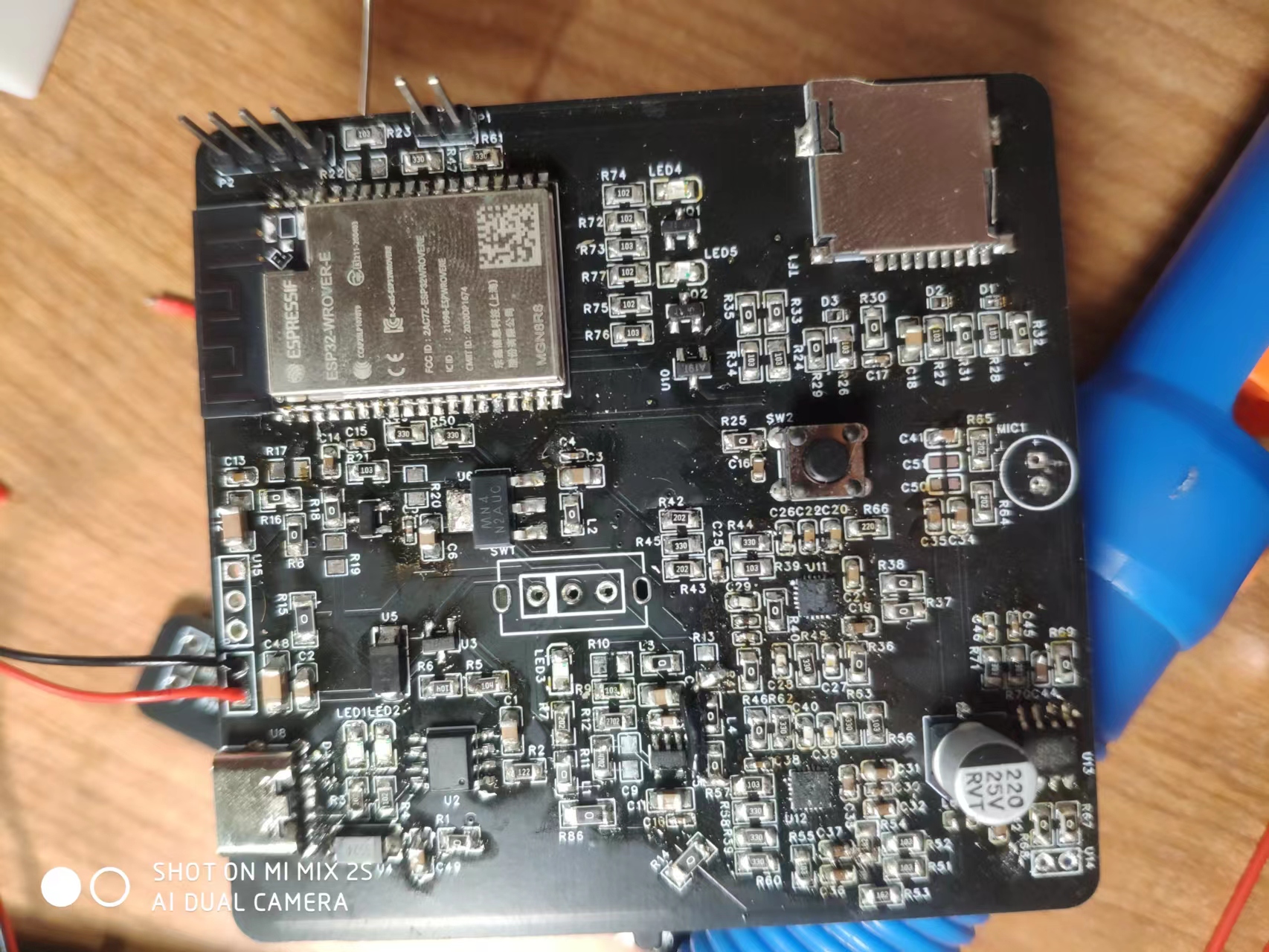

Completed PCB design and prototyping (September 20, 2023).
PCB Testing 2023/9/29

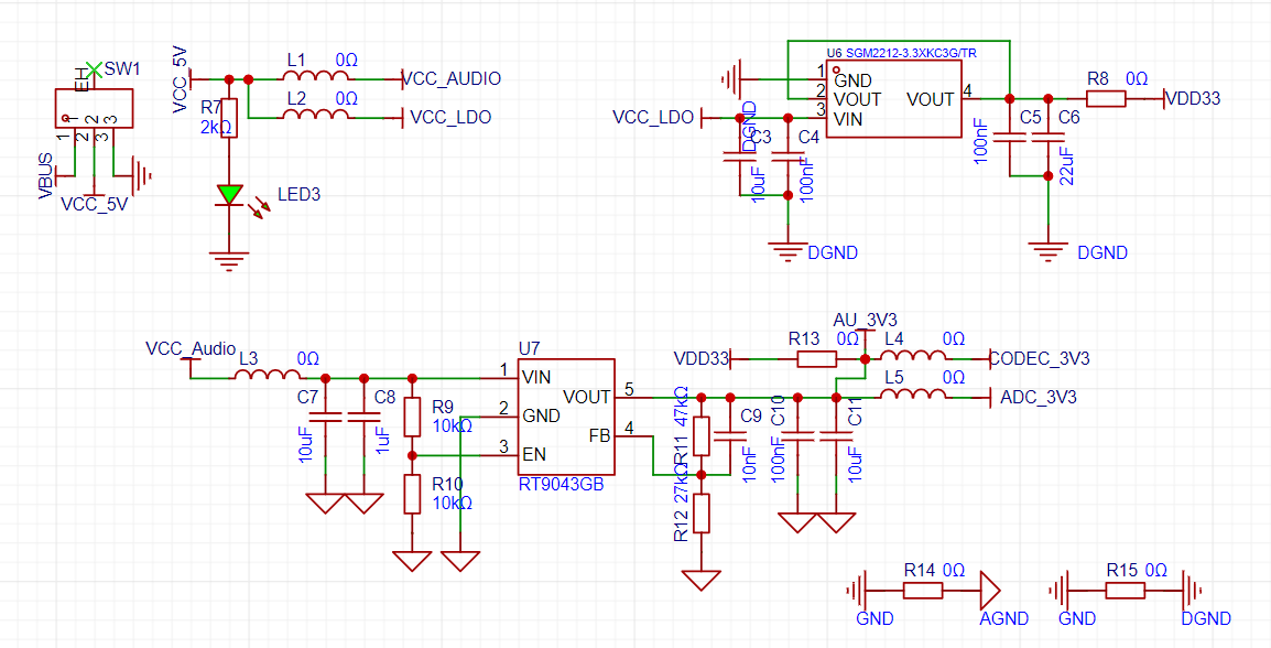

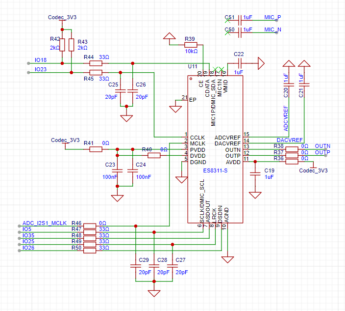

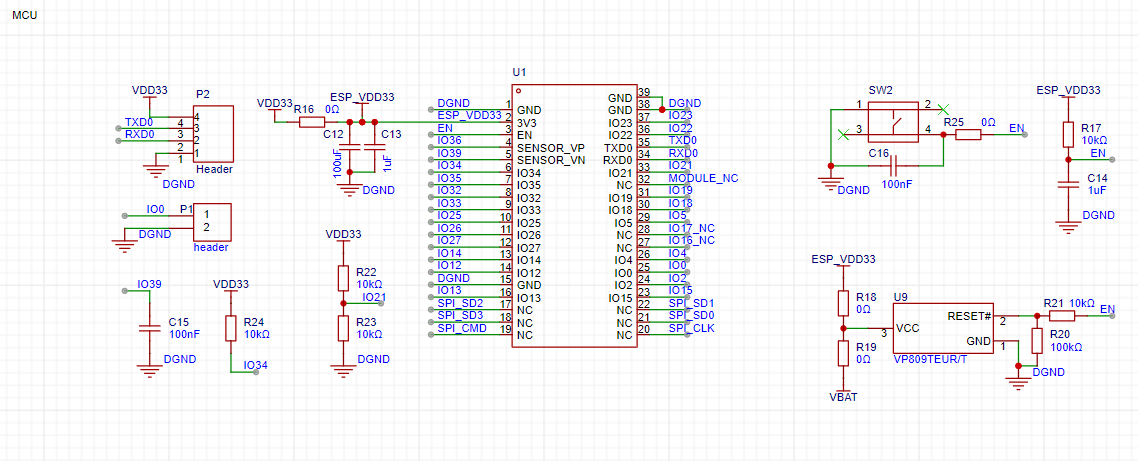

1.2 Hardware Description
The main control chip is the ESP32-WROVER-E, a general-purpose Wi-Fi + Bluetooth + Bluetooth LE MCU module. It is powerful and versatile, suitable for low-power sensor networks and demanding tasks such as voice encoding, audio streaming, and MP3 decoding. The ESP32-WROVER-E-N8R8 has 8MB of SRAM and 8MB of Flash, sufficient for voice recognition.

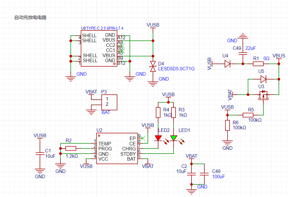

For power supply, it can be powered by USB or battery, with AP5056 for battery charging and discharging management. Two voltage regulators are used to power the ESP32 and audio chip respectively. The audio codec chip used
in the power supply circuit

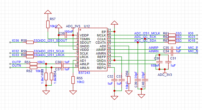

is the ES8311. The ES8311 is a widely promoted CODEC chip from Shunxin, offering high cost-effectiveness. Its main applications include portable audio devices, network cameras, and wireless audio. The ES8311 supports I2S communication with I2C-free configuration (MCLK/BCLK=64Fs), supports full-range input of ±1Vrms, and has low power consumption.
The ES7243E ADC chip is used to transmit the signal from the microphone to the ESP32. The ES7243E is a high-performance, advanced multi-bit Delta-sigma audio ADC chip widely promoted by Shunxin, featuring distortion up to -90dB THD+N, 24-bit, 8~48 kHz sampling rate, and automatic level control (ALC) and noise gate, offering excellent cost-effectiveness.

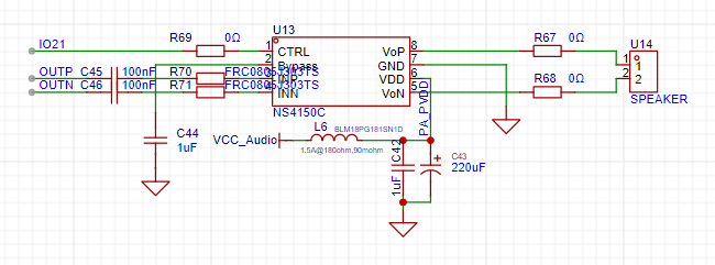

The audio amplification section uses the NS4150B chip. The NS4150B is an ultra-low EMI, filterless 3W mono Class D audio power amplifier. The NS4150B employs advanced technology to significantly reduce EMI interference across the entire bandwidth, minimizing its impact on other components. The NS4150B features built-in overcurrent, overheat, and undervoltage protection, effectively protecting the chip from damage under abnormal operating conditions. Furthermore, it utilizes spread spectrum technology to fully optimize the new circuit design, achieving an efficiency of up to 90%, making it ideal for portable audio products. The NS4150B's filterless PWM modulation structure and built-in gain reduce external components, PCB area, and system cost.
The PCB uses a double-layer design, with copper plating on the top for GND, DGND, and AGND respectively.

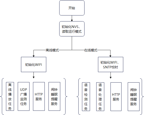

1.3 Code Flowchart
1.4 Software Code Description
On the hardware side, the performance of the ESP32 is fully utilized. Wake-up word detection and voice activity detection are implemented using the ESP32; only speech recognition and text-to-speech are implemented using the Baidu API.

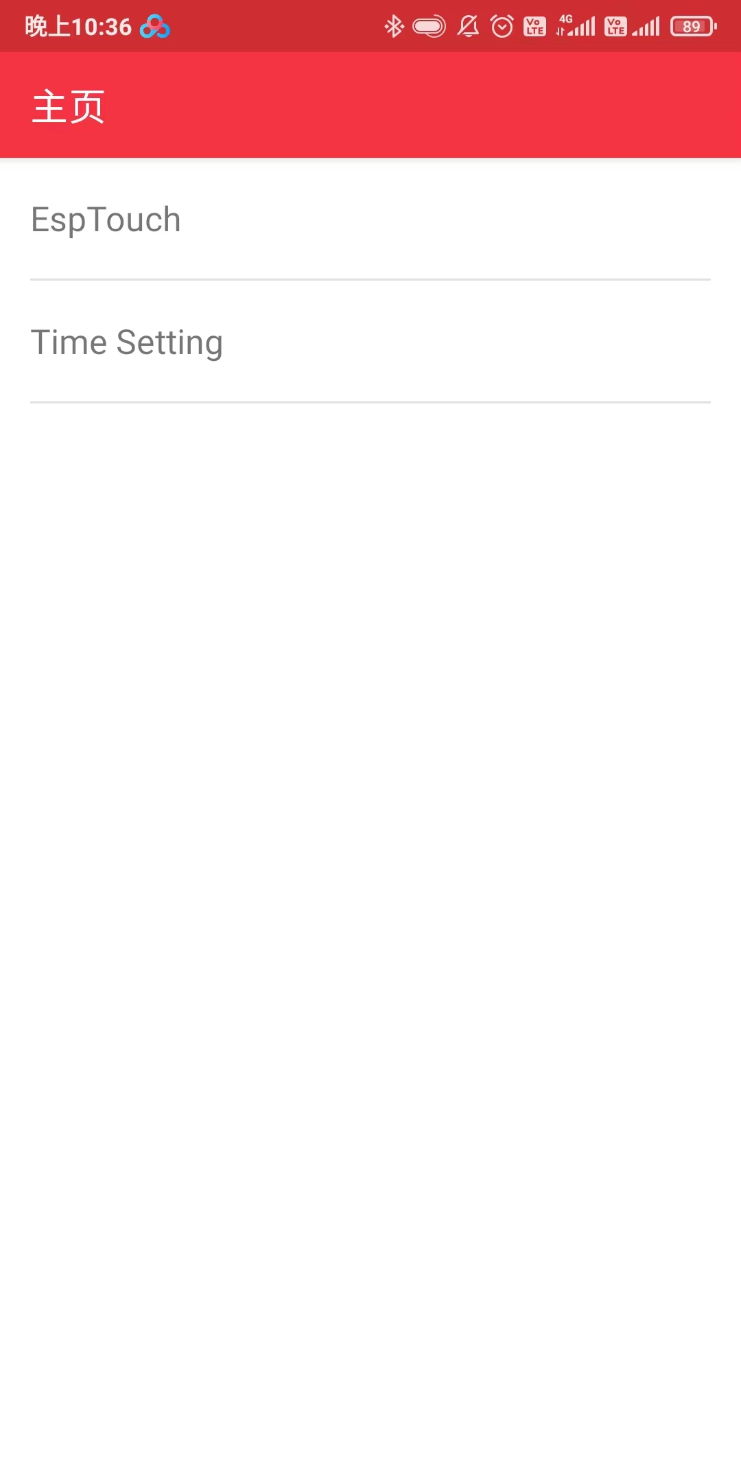

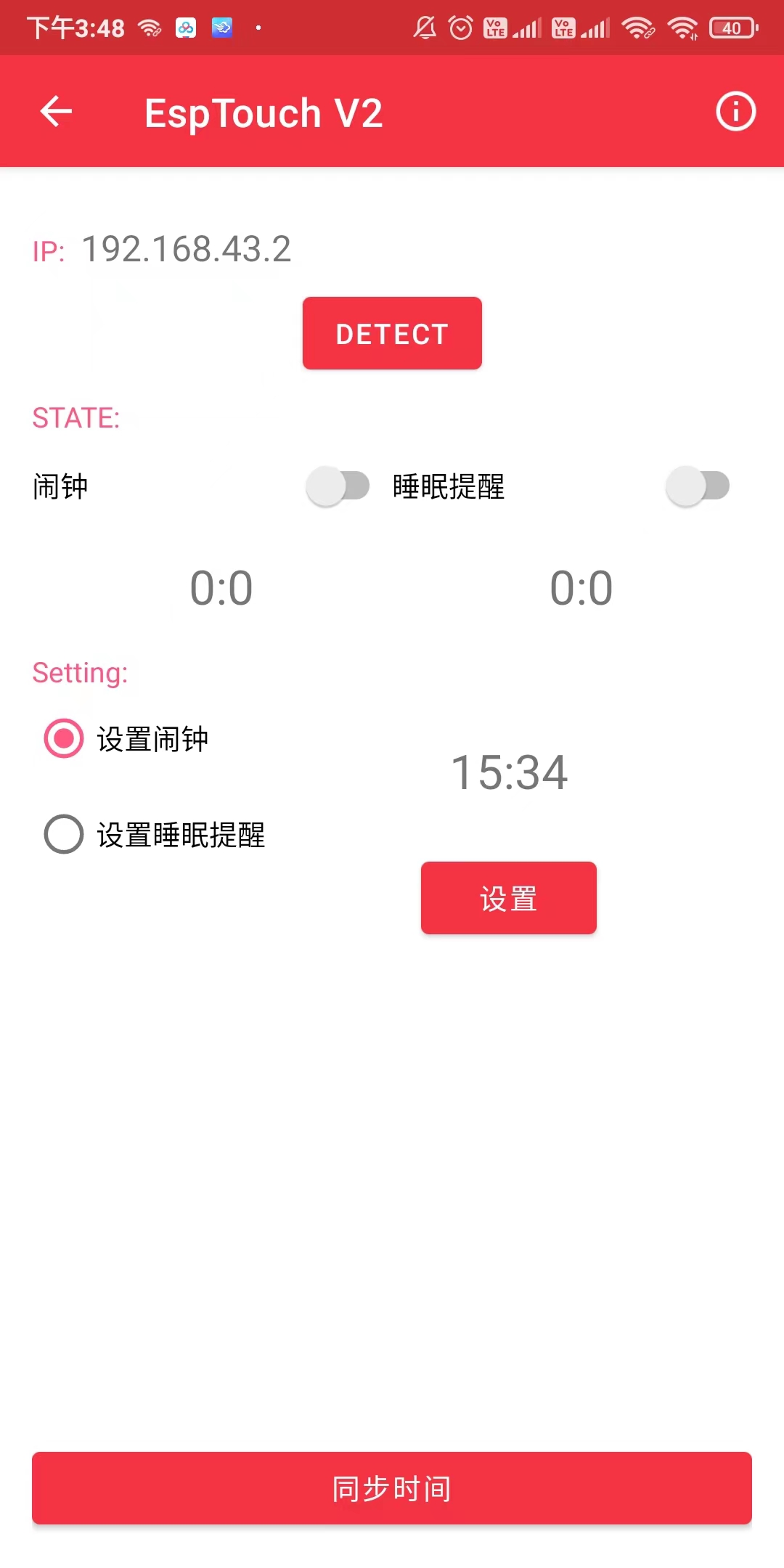

2. Mobile App
2.1 Software Block Diagram
2.2 Software Functions

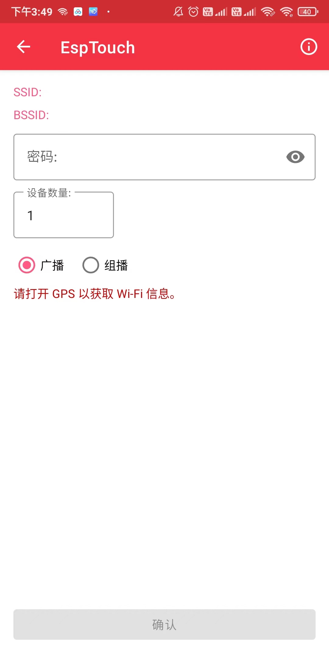

2.2.1 Network Configuration
The network configuration code refers to the open-source code of EspressifApp / EsptouchForAndroid and modifies it accordingly.

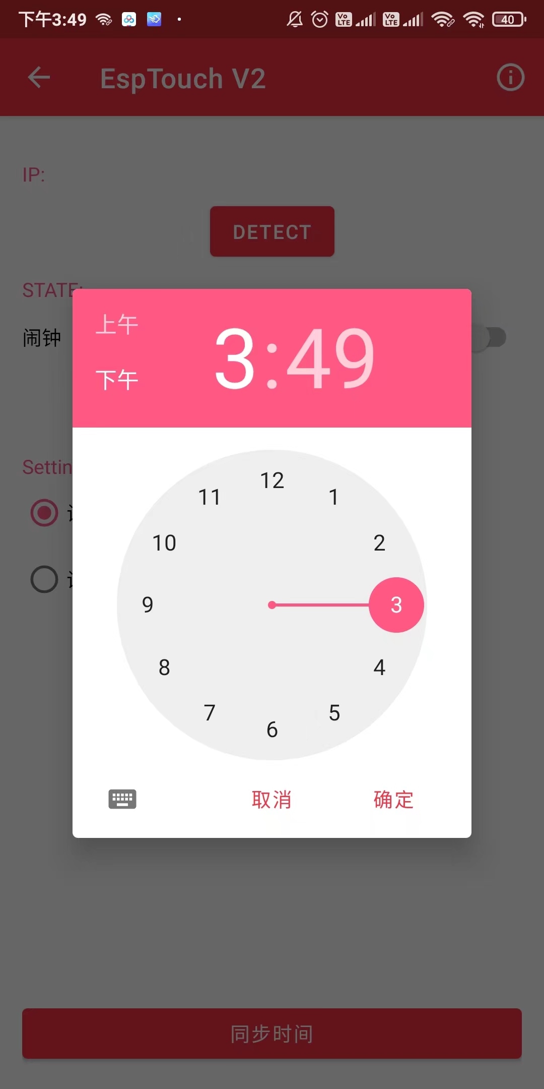

2.2.2 Alarm and Sleep Reminder Settings
Device detection uses a LAN UDP broadcast method. By sending specific data to the broadcast address of the subnet and listening to the received data, the IP address of the target device is identified and obtained. This method does not require group management, which greatly simplifies complexity, but may increase the burden on LAN bandwidth.
Time Synchronization The timestamp of the Android phone is obtained and sent to the ESP32 device to achieve time synchronization on the device side.
In addition, since the ESP32 device enables multiple HTTP server functions, sending corresponding data and requests to different HTTP interfaces using POST or GET methods can achieve the setting of different functions and the reading of the current status.

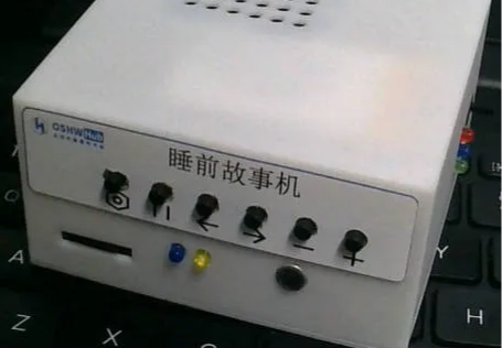

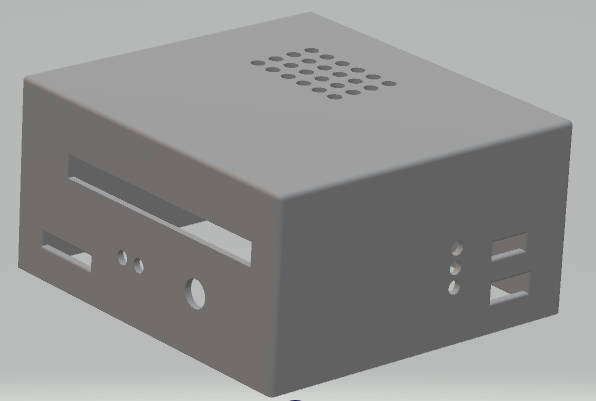

4. Shell Design
The shell was designed using Fusion360. This software provides excellent version management, facilitating model modification and rollback, and offers a free educational version for university students. Although it is somewhat similar to Inventor, I personally feel it is not as user-friendly as Inventor, perhaps because I am more accustomed to using Inventor.
3D model printing was done using LCSC's 3D Monkey, which produces a finer print quality than my own 3D printer and is cheaper.

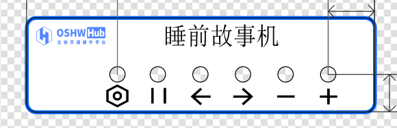

A simple panel was also designed in this project as follows:
The ability to design and print panels directly in LCSC EDA is very convenient and user-friendly.

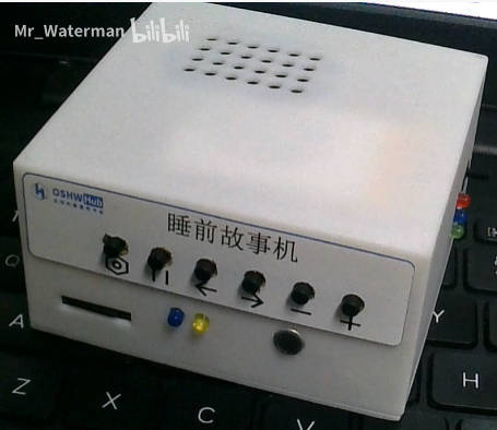

5. Physical Demonstration

Note that the ADC chip is ES7243, not ES7243E. If the wrong chip was purchased, it needs to be changed from ES7243 to ES7243E. The specific files to modify are bord.c and bord_def.h.

Since the ESP touch cannot transmit the password for the phone's own hotspot, if you only have one phone and there is no available Wi-Fi nearby, you need to first create a Wi-Fi network with the same SSID and password using a computer, and then connect the phone to this network before performing smart configuration. Finally, turn off the computer hotspot, turn on the phone hotspot, reset the hardware, and then connect it to the phone hotspot
board. The board was hand-soldered, and the package mainly uses 0805, which makes the board size slightly larger. In the future, smaller packages and JLCPCB SMT surface mount technology can be used. The ES8311 and ES7243 are QFN packages, and this is the first time I have soldered QFN packaged chips (I initially tried to solder with a soldering iron, which resulted in the failure of two boards). I recommend using a hot air gun. I used low-temperature lead-free solder and a small DIY hot air gun.

Some components are redundant and do not require soldering, specifically:
       R13 R17 R19 R20 R22
       C9 C50 C51 D1 D2 D3.
