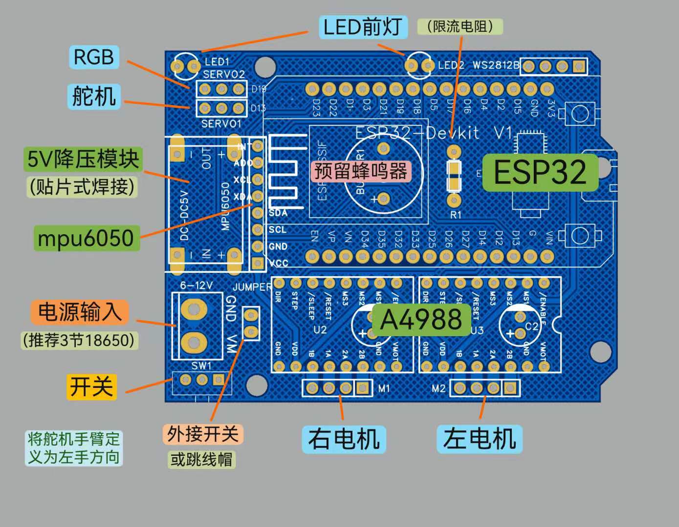

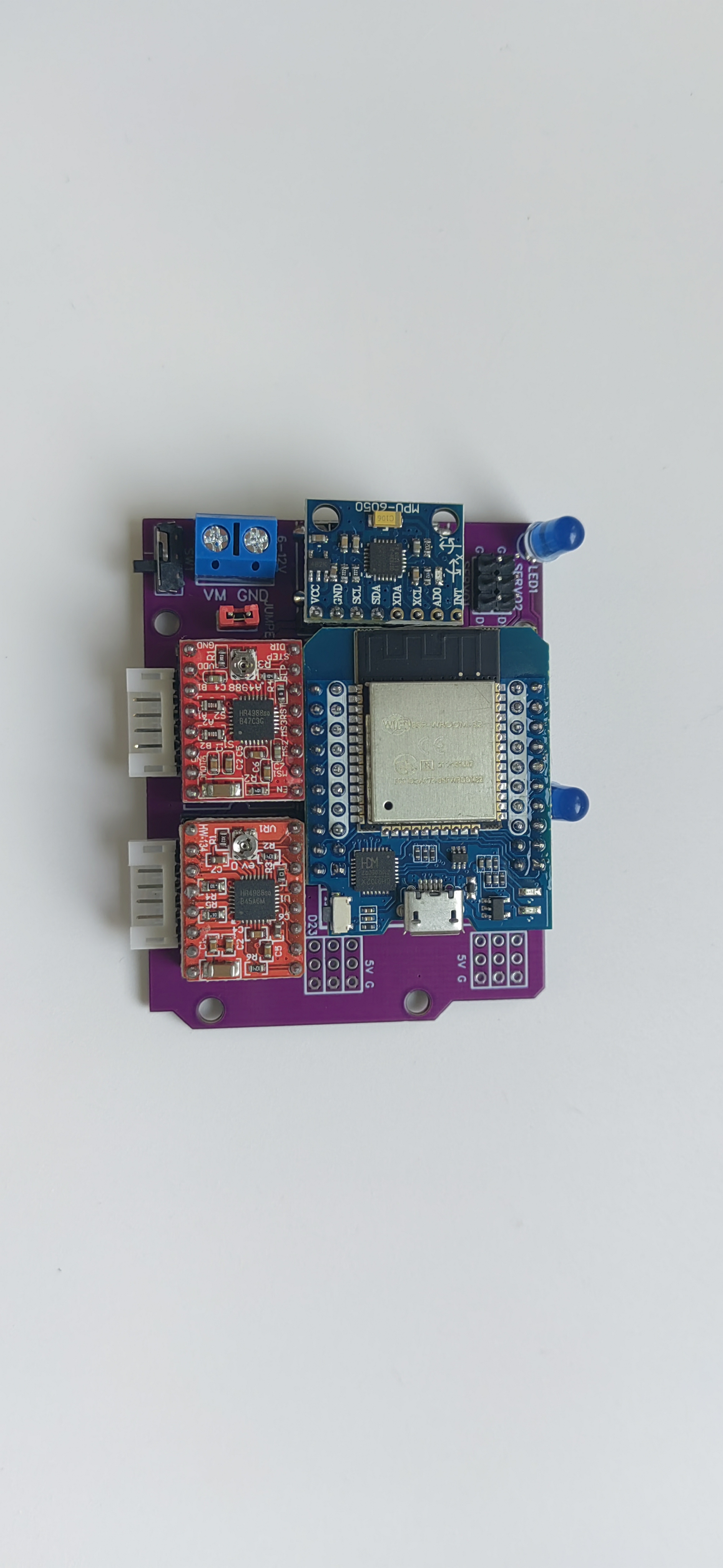

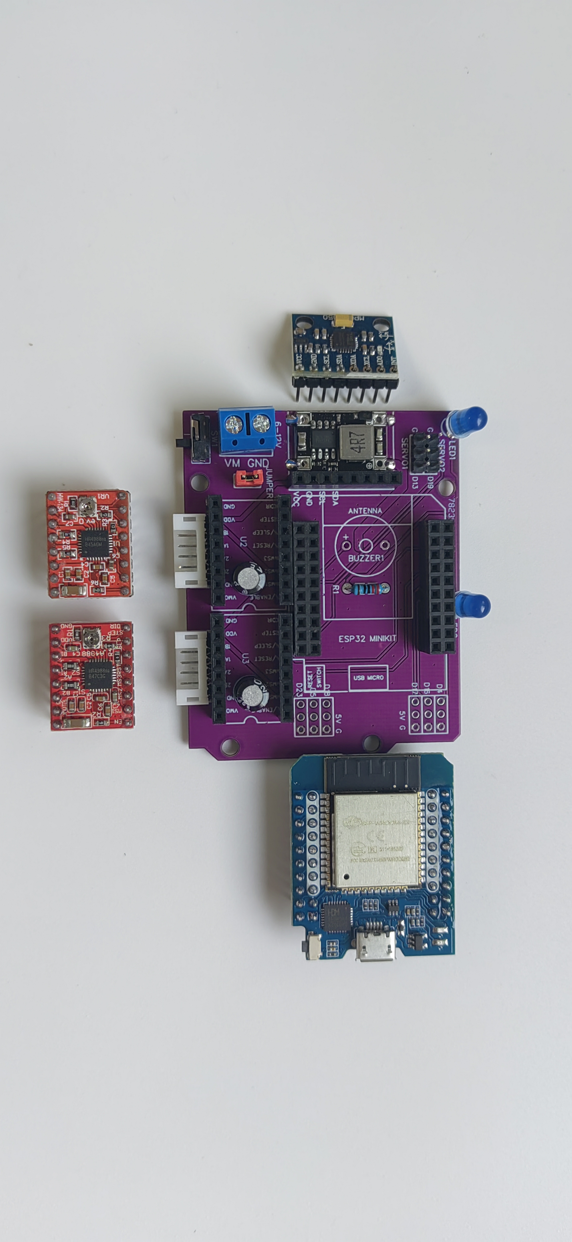

    This project requires controlling two stepper motors (5 I/Os), one servo, one RGB motor, one MPU6050 (I2C), and an unnecessary LED front light. The total number of I/O ports required is not large, and a modular design facilitates soldering and is convenient for beginners.
The PCB schematics for both versions are basically the same, except that version V2 has some additional I/O interfaces that can be used for other purposes. It features
a fully modular design, using the A4988 stepper motor driver. For ease of routing, a design using header pins and jumpers to switch microstepping is not used; the wiring is directly fixed to 1/8 microstepping of the A4988. If you want to change to a different microstepping setting, you need to make simple modifications to the wiring.

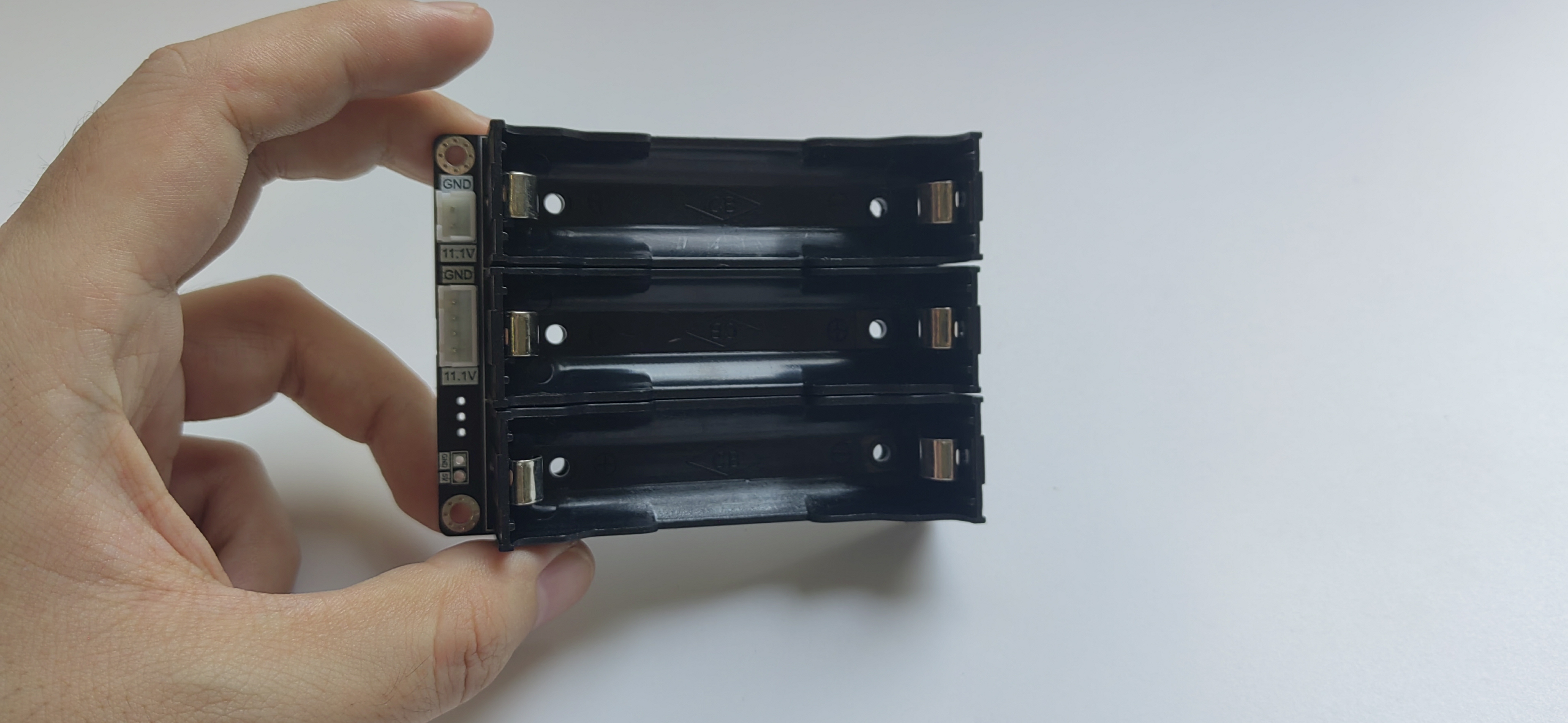

I also made a simple 3S battery box PCB with two XH2.54 connectors. The 2-pin connector connects to the expansion board, and the 4-pin connector connects to a plug, allowing direct charging of the battery with a balance charger (I used a regular B3 balance charger; make sure the wiring sequence matches your charger).
Alternatively, you can use a regular 3-cell series battery box and modify it by adding a 4-pin plug for the same effect, although soldering is more difficult.

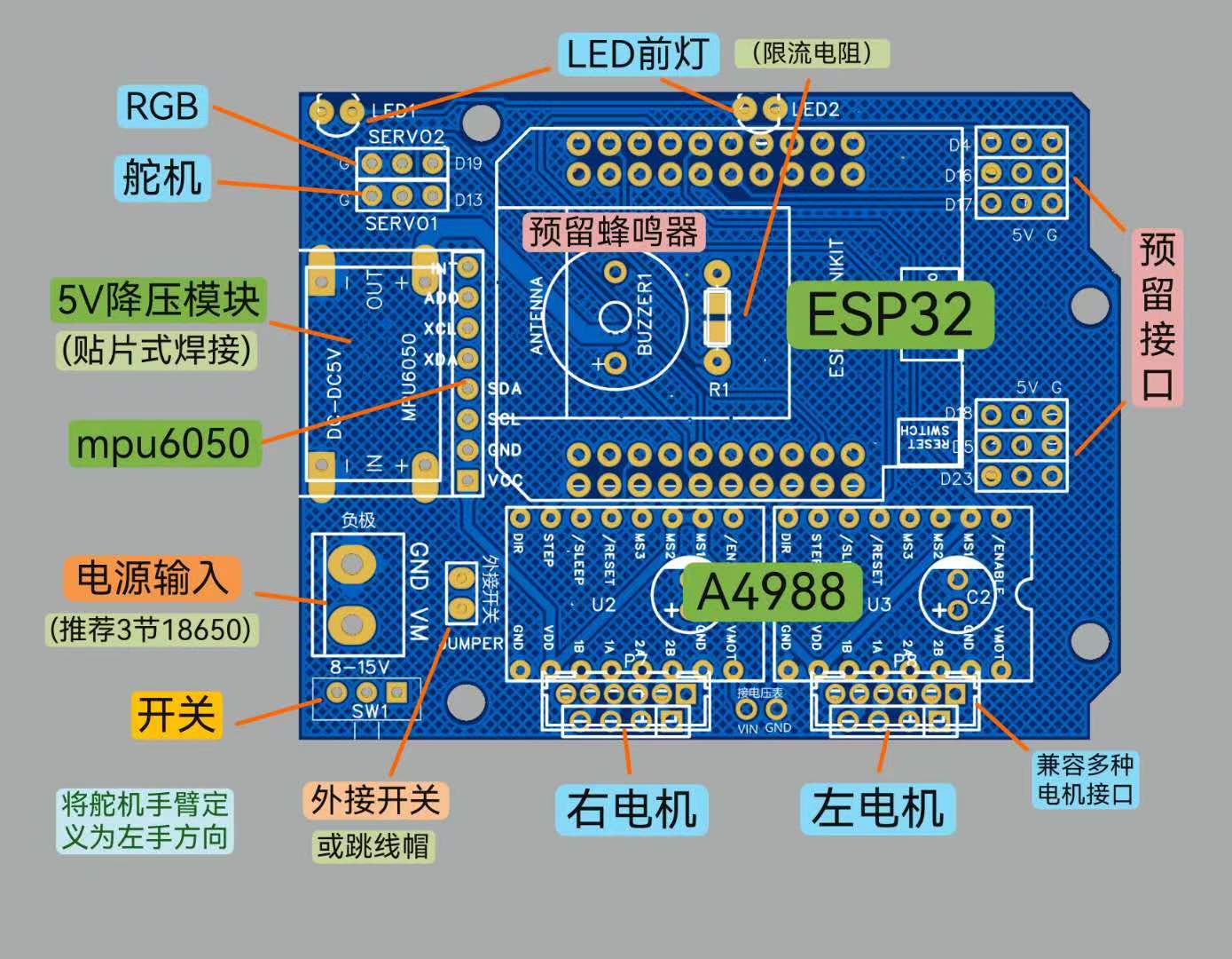

Because it consists of various modules, the PCB design is relatively simple, using the same UNO shape as the original author. All modules are arranged compactly. The following two images are schematics of the two versions: The
"external switch or jumper cap" in the image refers to the use of an external switch fixed to the right side panel of the balance scooter. The switch wire is plugged in here as the balance scooter's power switch. If this expansion board is used for other purposes, a jumper cap is plugged in here, and the small switch on the edge of the expansion board acts as the power switch.
The LED headlight and current-limiting resistor (any few hundred to 1K ohms) are only for easy identification of the front of the scooter while playing and can be left unsoldered. Pay attention to the positive and negative polarity when soldering.
As you can see, the V2 version has some extra interfaces. The motor interface can use 4-pin connectors or headers with a 2.54mm pitch, or 4-pin or 6-pin connectors with a 2.0mm pitch, to accommodate various common stepper motors. Solder the appropriate connectors or headers according to your connector type.

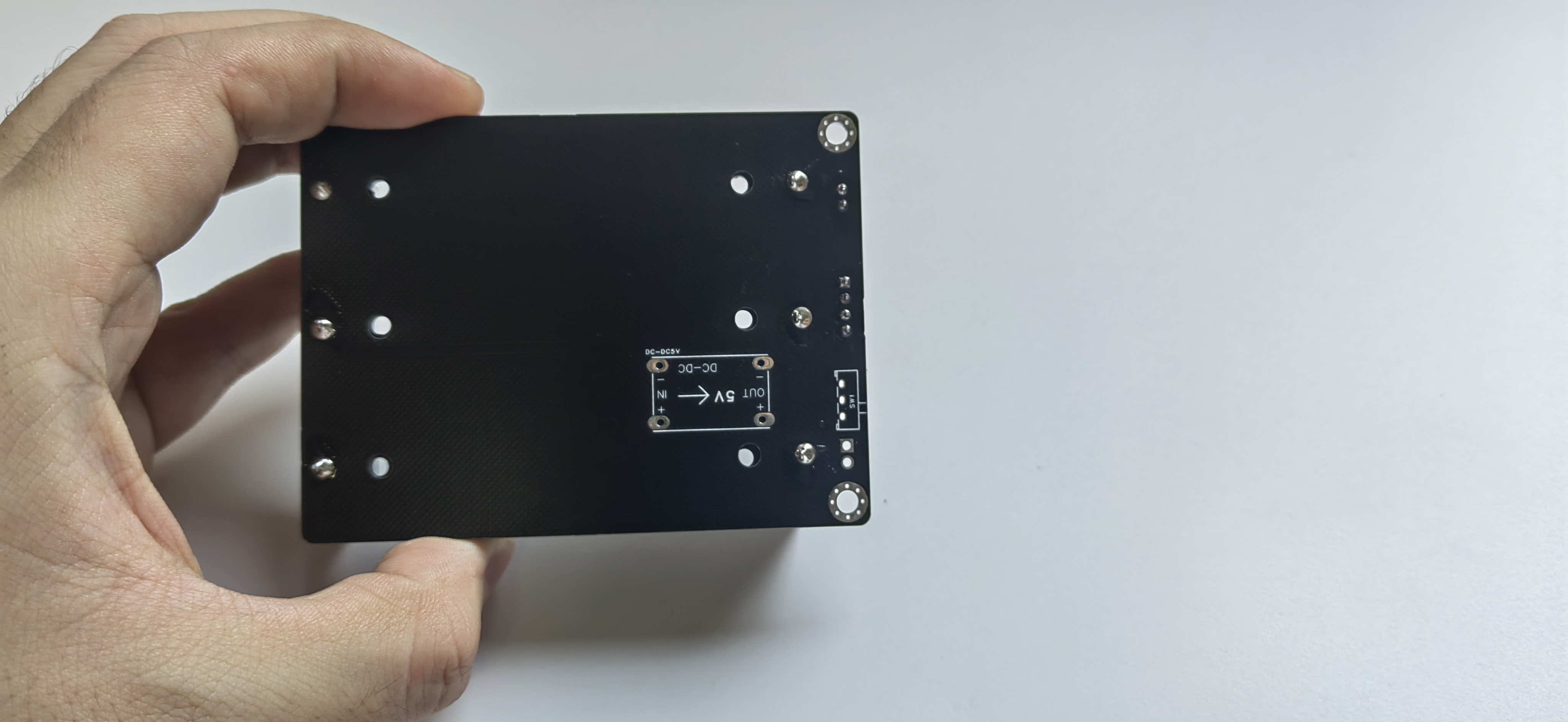

The simple battery box PCB has two XH2.54 interfaces (or headers or female connectors). The 2-pin is for power output, and the 4-pin is for the balanced charger. Be sure to connect the positive and negative terminals correctly to prevent reverse connection or short circuit.
The back of the battery box has a reserved space for a 5V step-down module and a small switch; soldering these on will provide an additional 5V output power.
Of course, a regular 3-cell series 18650 battery box can also be used. You can modify the battery box by adding a 4-pin plug to connect a balance charger.

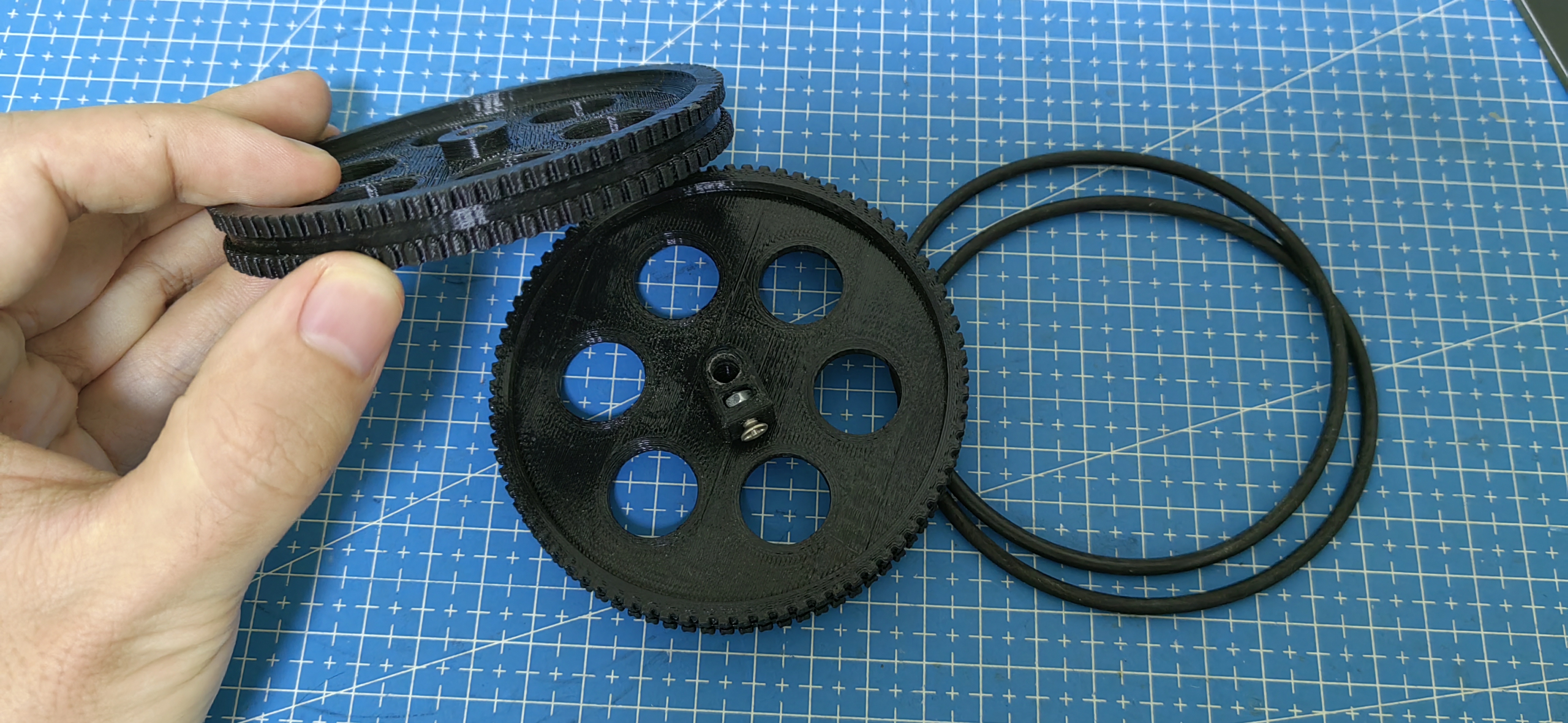

    Because the axles of the wheels in the original author's and other versions are fixed holes, the motor is either too tight to install or too loose to slip. Even if it works during installation, it will slip after a while.
Therefore, I redesigned several types of wheels with a fastening function, similar to couplings, and selected the most suitable version after testing.
The construction is relatively simple: print it out, clean the support, install M3 screws and nuts, and install O-rings for both anti-slip and quiet operation.

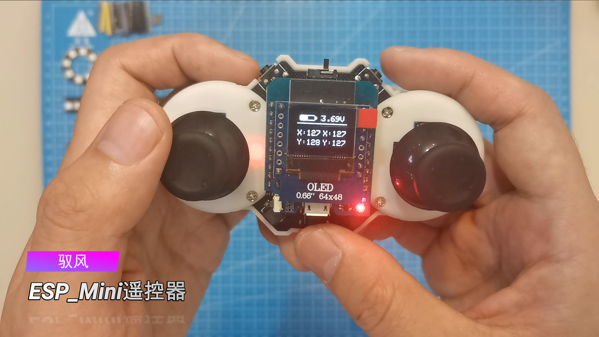

However, I prefer using my self-designed ESP-NOW remote control, which also supports my favorite Bluetooth app, so I rewrote the program. The main PID control part is the same as the open-source program (actually, I lack the skill to rewrite it), with added RGB effects and modified control methods to suit my preferences. You can watch this video demonstration: https://www.bilibili.com/video/BV17c411Z7N3/?spm_id_from=333.999.0.0
Both the remote control and the app have switches to toggle between normal (slow) and advanced (fast) modes. The app supports gyroscope motion control. Both left and right joysticks can be used for full-proportional differential control, resulting in smooth movements. The controls from both joysticks can also be combined, which can be understood as having four speed levels: single joystick control in slow mode, combined control with both joysticks, single joystick control in fast mode, and combined control with both joysticks.
The video demonstrates the use of various remote controls. You can also use my open-source Yufeng ESP_Mini remote control basic version. Those interested can learn to make one: Yufeng ESP_Mini Remote Control - JLCPCB EDA Open Source Hardware Platform (oshwhub.com)

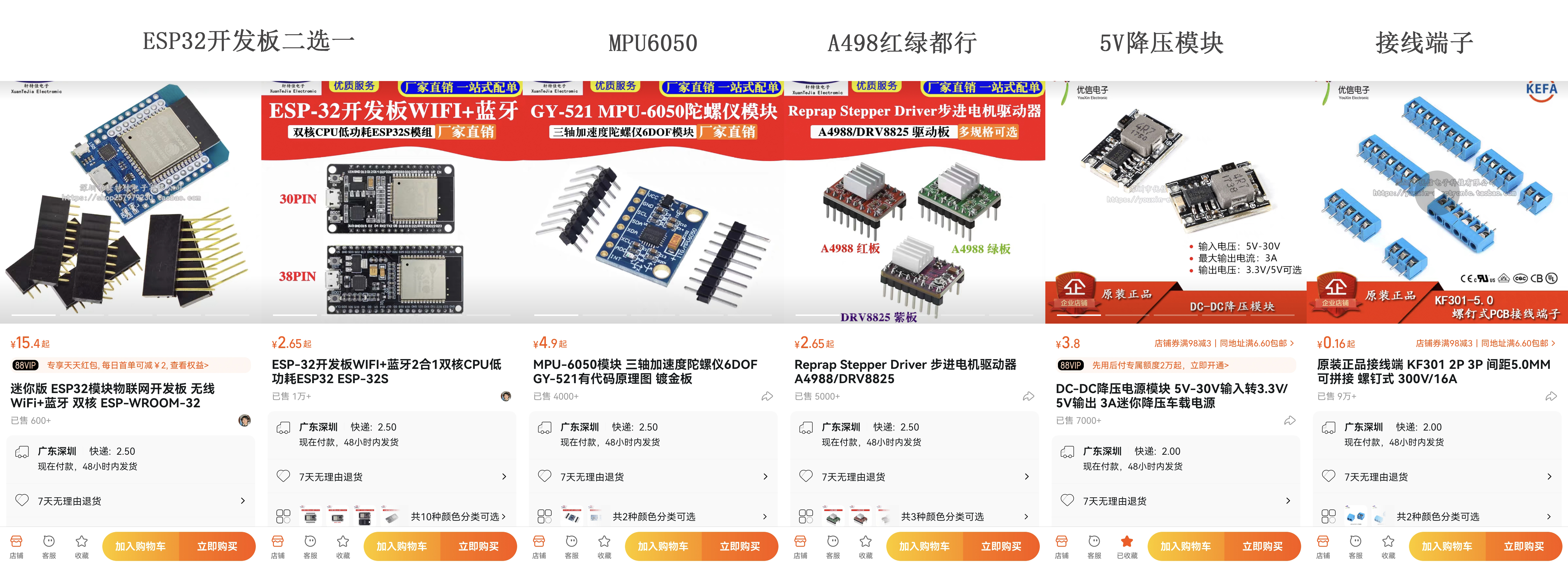

For materials, use
a modular PCB. The main component materials are listed below. Other components such as pin headers, sockets, small switches, LED resistors, connectors, wires, and battery boxes are not listed individually. I personally use three 2000mAh 5C power-type 18650 batteries.
Control board materials:
Balance scooter body materials:

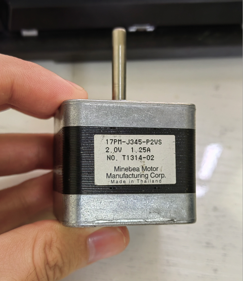

Note: There are many models of 42-stepper motors with different parameters, including two-phase four-wire and two-phase six-wire models. Some motors I've tested work perfectly fine in 3D printers, but vibrate and stop rotating at high speeds when used on a balance scooter. Therefore, I'm providing photos of motors that work correctly for your reference when purchasing.
Also, the wiring may vary between different 42-stepper motors. Those unfamiliar with this can search for 42-stepper motor usage tutorials.

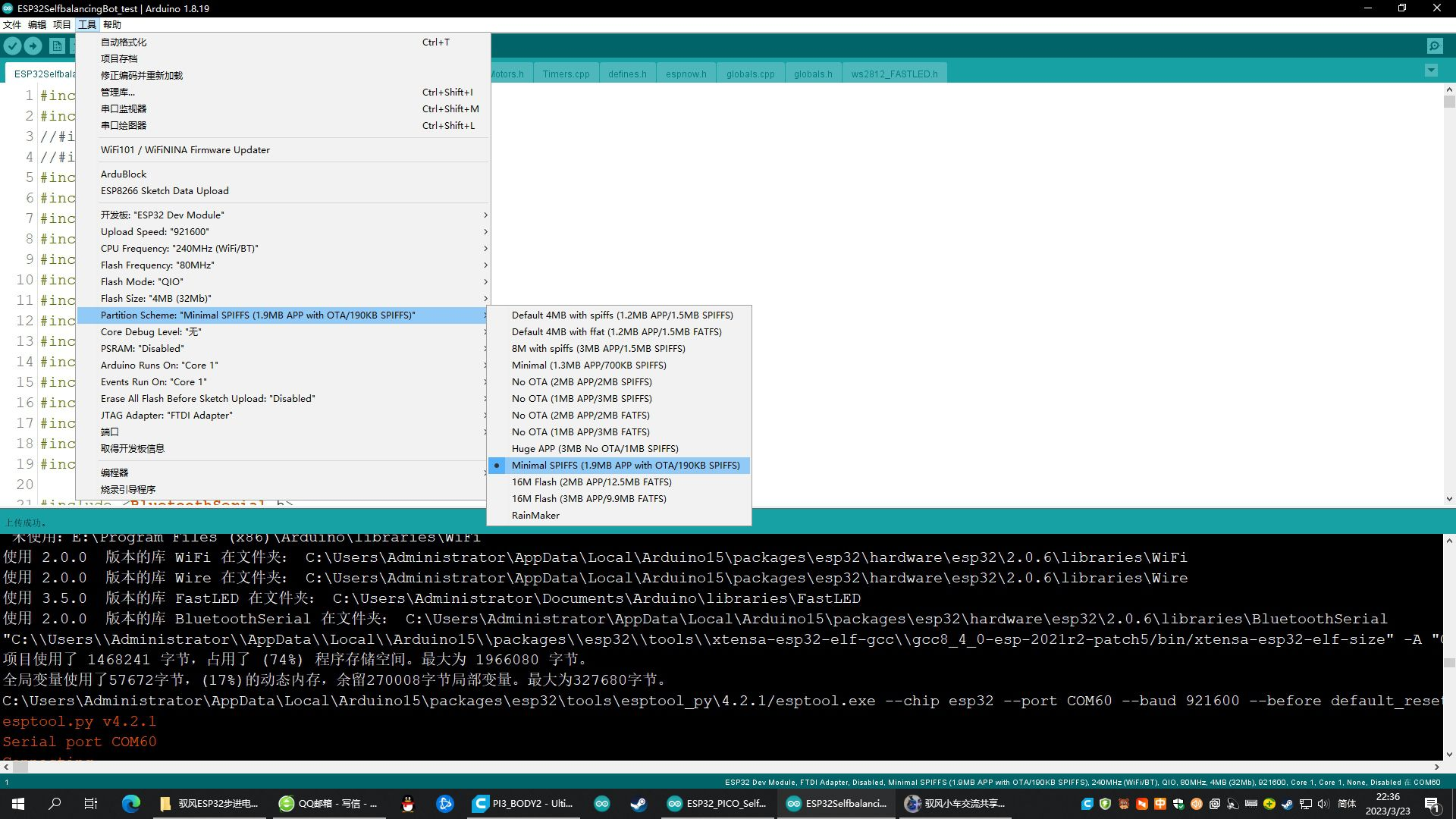

After installing the Arduino IDE, you also need to install the ESP32 environment. The installation method for this is constantly being updated, so it's recommended to search for tutorials yourself.
When compiling and uploading programs that communicate via Bluetooth and ESPNOW, the default settings will prompt that the space usage exceeds the limit. Simply select a larger APP space in the upload settings' partition scheme,
such as: Minimal SPIFFS (1.9MB APP with OTA/190k SPIFFS), as shown in the image below.
