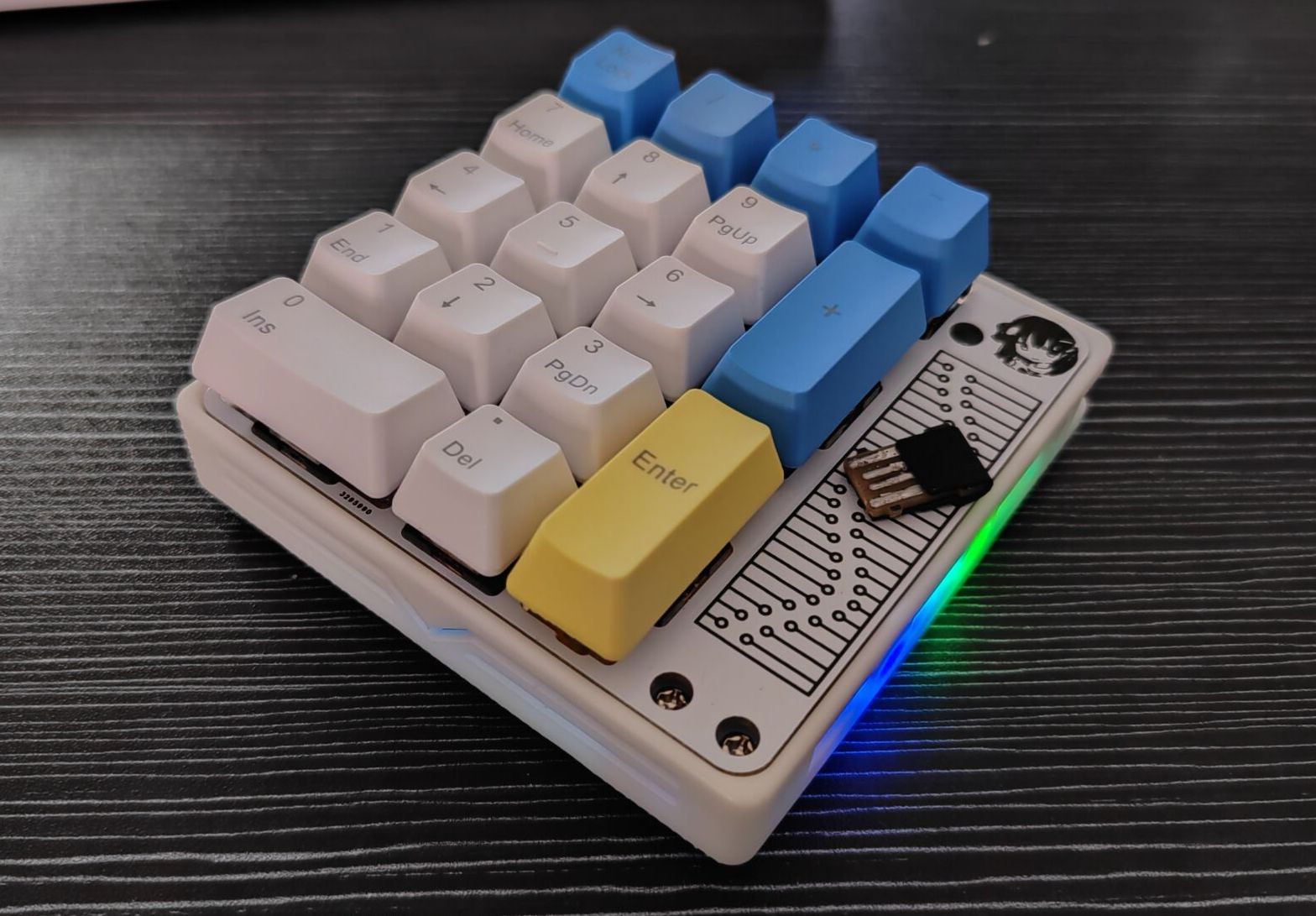

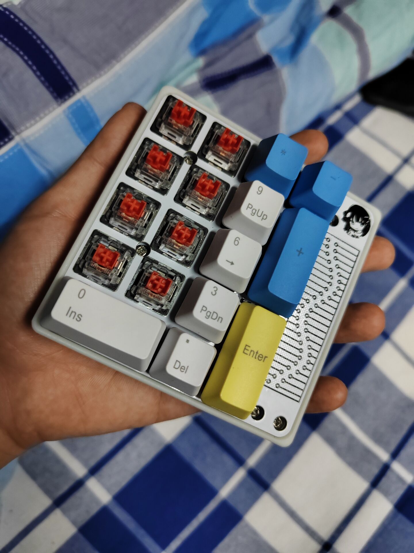

This is a tri-mode version of the most basic keyboard
(though it lacks touch functionality).
It is perfectly compatible with the basic 17+4's shell and mounting plate, retaining the valuable free shell and mounting plate.

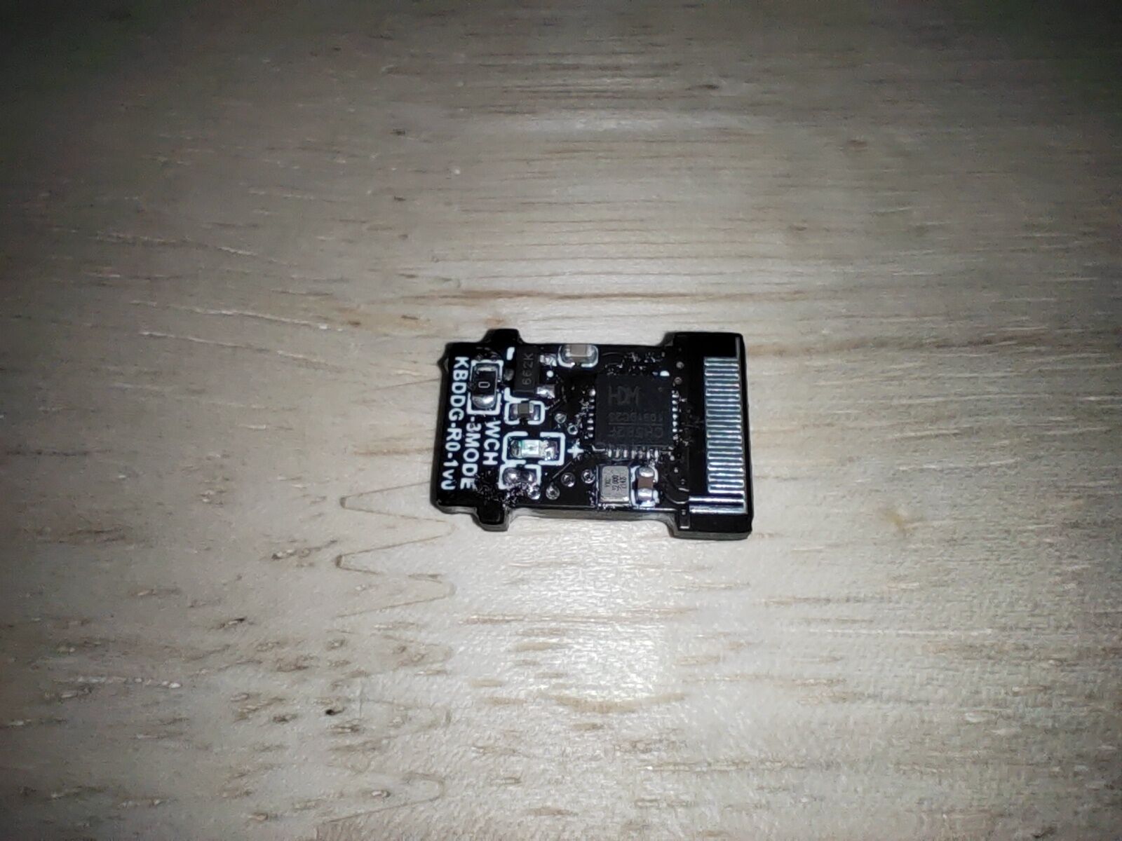

. CH582 is in QFN package. Soldering is relatively difficult, so it is recommended to solder the receiver first. Observe for any bridging or cold solder
joints before soldering other components.
For receiver prototyping, be sure to choose 0.8mm thick, green solder mask (non-green thickness is not free). The software used for programming is Qinheng's WCHISPTool (attached).

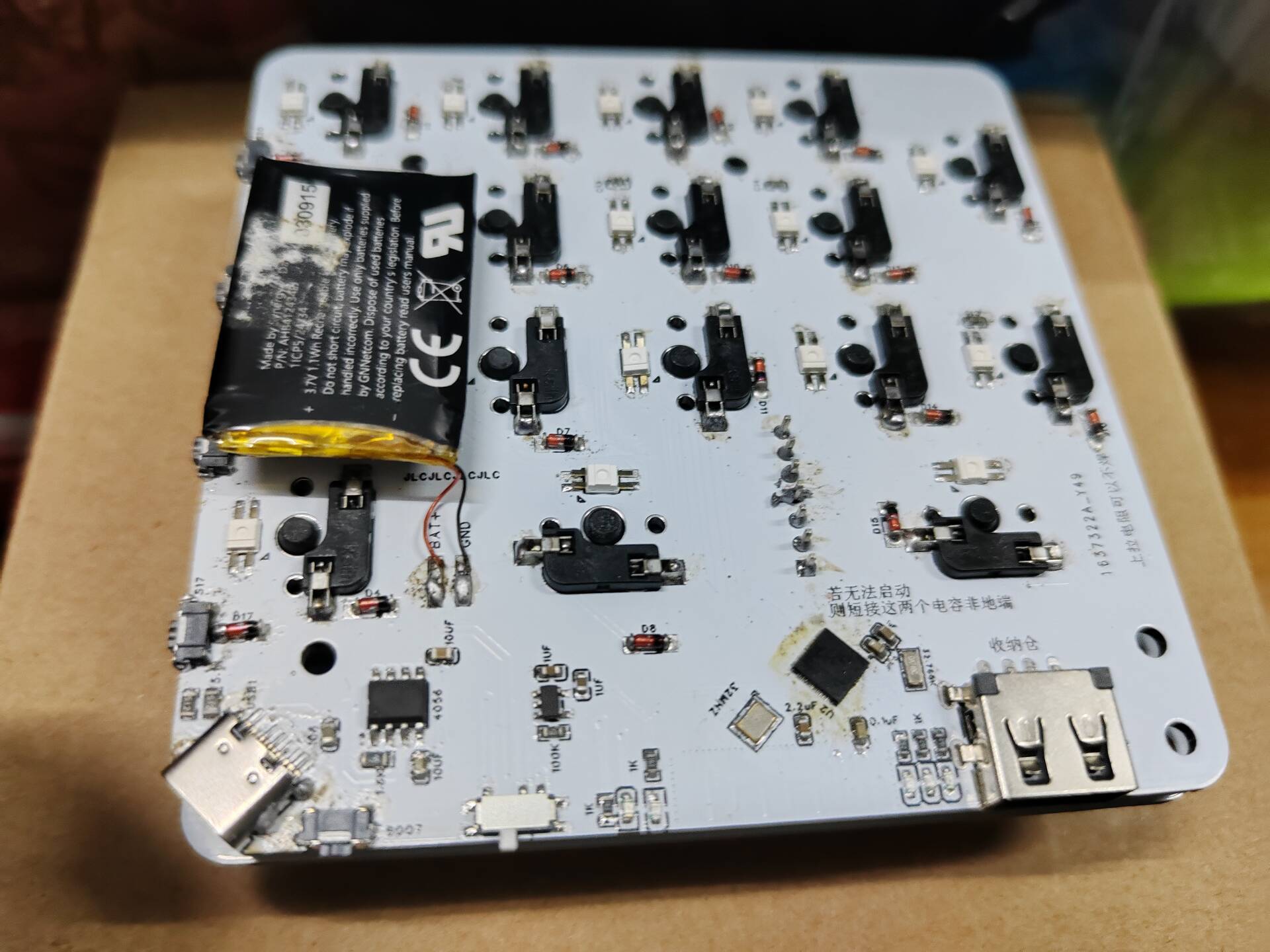

Component purchasing matters:
Do not purchase according to the automatically generated BOM at the bottom of the webpage! I've silkscreened
the names, packages, and purchase links for most of the important components on the keyboard PCB (links to my purchases are provided):
    1. Battery Management Chip: TP4056 SOP8 package
    2. High-Speed ​​Crystal Oscillator: 32MHz 3225 package
    3. Low-Speed ​​Crystal Oscillator: 32.768KHz 3215 package
    4. Voltage Regulator Chip: RT9193-33GB SOT-23-5 package
    5. Storage Compartment: Recessed USB Female Connector https://m.tb.cn/h.UqIMYwu?sm=b4ca00?tk=EI0PdQn604S
    6. Recessed Tactile Switch: https://m.tb.cn/h.UrUsDE8?sm=f4b7fc?tk=iCZhdQni3p6
    7. Toggle Switch: 7-Pin Toggle MSK-12C01-07
Important component names, packages, and purchase links for the receiver PCB (link provided for my purchases): 1.
    Crystal oscillator: 32M 2016 package
    2. Voltage regulator chip: XC6206P332MR SOT-23 package

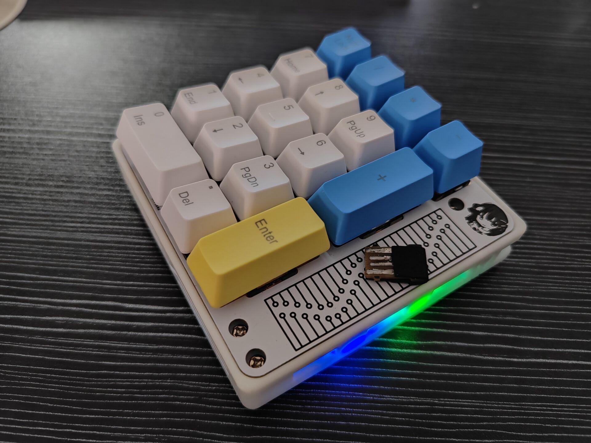

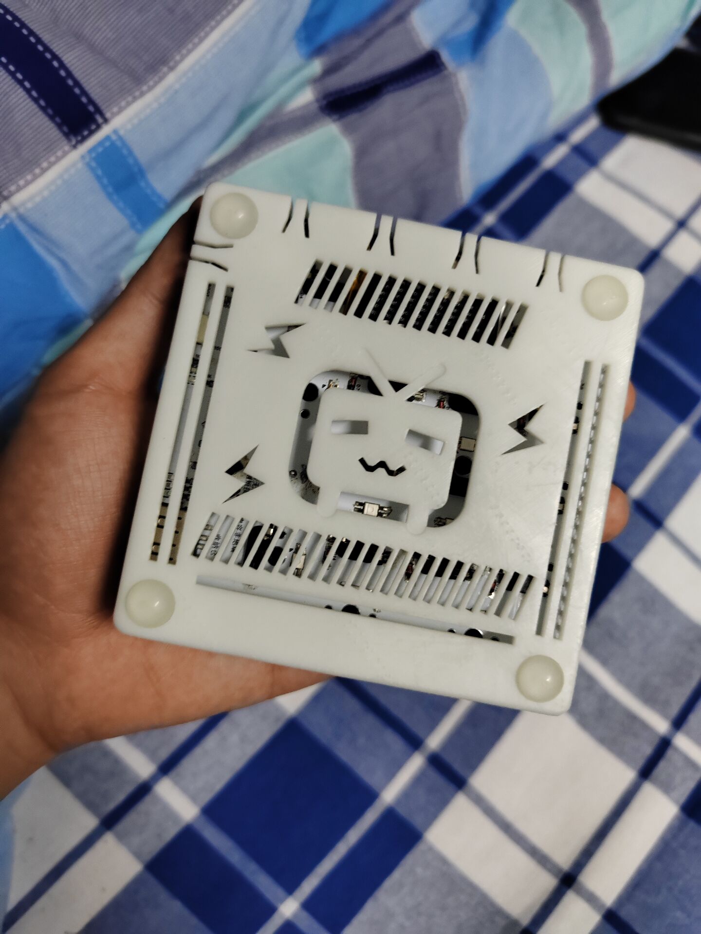

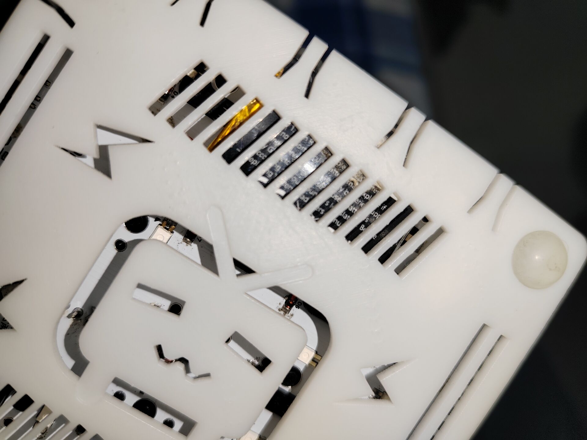

Finished product image:
Perfectly compatible with the basic 17+4 casing and positioning board.
The remaining space on the bottom shell can only accommodate a thin battery of about 500mAh.
The receiver is difficult to solder (it's very small and has two surface-mount capacitors on the back).
This keyboard is currently just a pure tri-mode PAD
, but the hardware has reserved a touch area, which may be added in a future update (creating a new folder).
