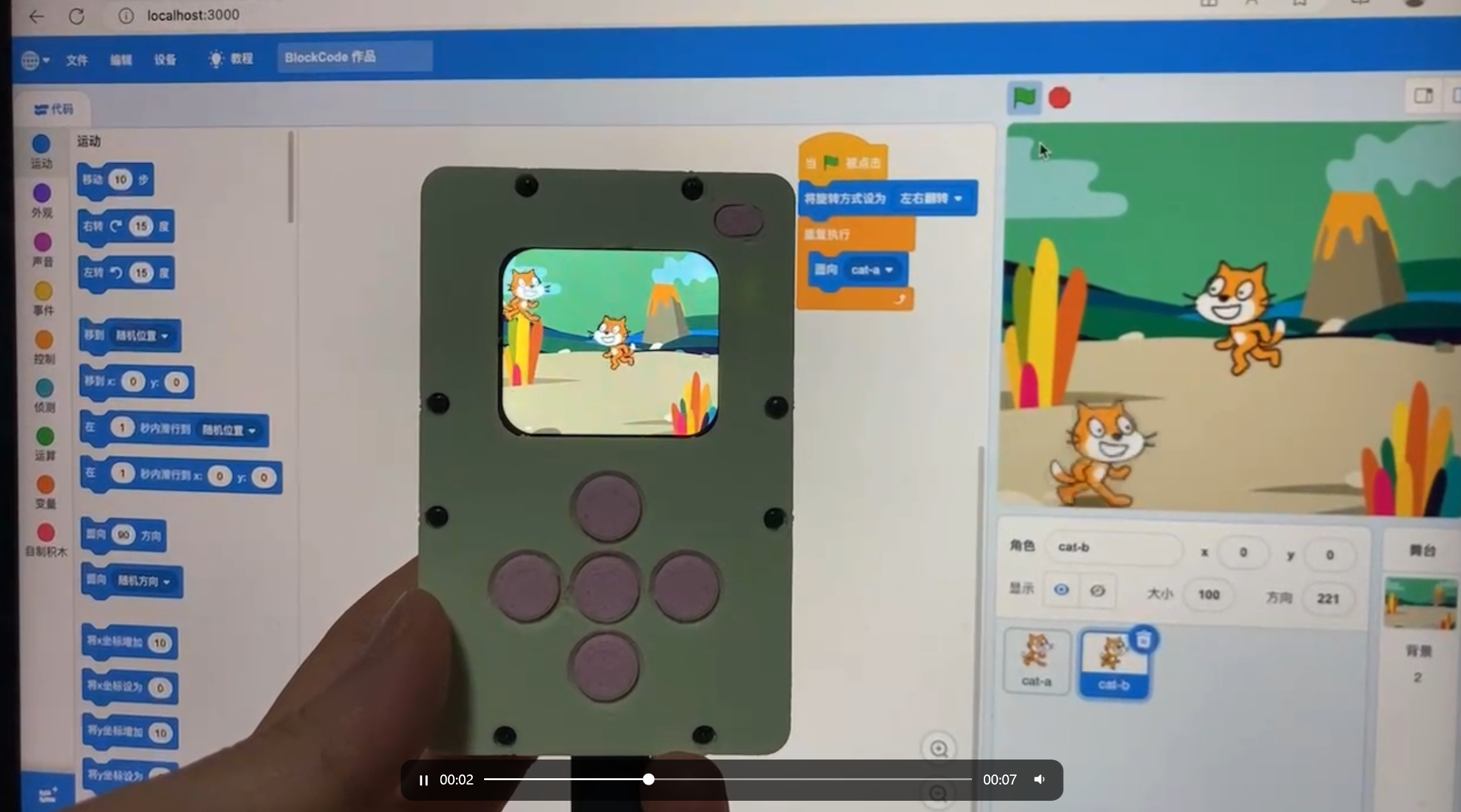

Additionally, people generally prefer the native Scratch UI and programming style; similar software is easy for everyone to adapt to. Therefore, we only need to maintain the Scratch programming style as much as possible. I can also do secondary development based on Scratch without changing the programming style; it seems easier to implement without insisting on running native Scratch sb3 format files.

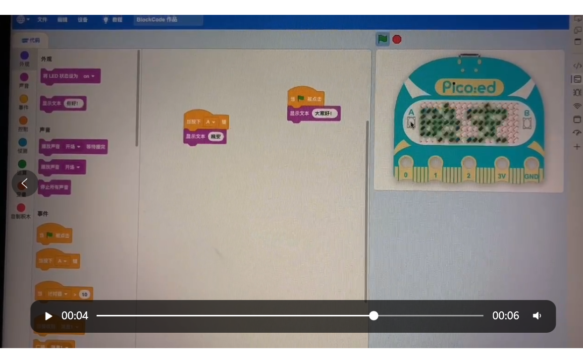

With the previous summary, I quickly found inspiration in the microbit motherboard emulator within Makecode software. Could I treat the Scratch stage as an emulator? This way, my hardware's game running could be a hardware emulator within the Scratch software. In this way, the Scratch software would be almost identical to the native one, except for some changes to the stage.
At the time, I had a Pico:ed motherboard (based on the RP2040 controller) on hand. I created a Scratch program to simulate Pico:ed buttons and display functions.

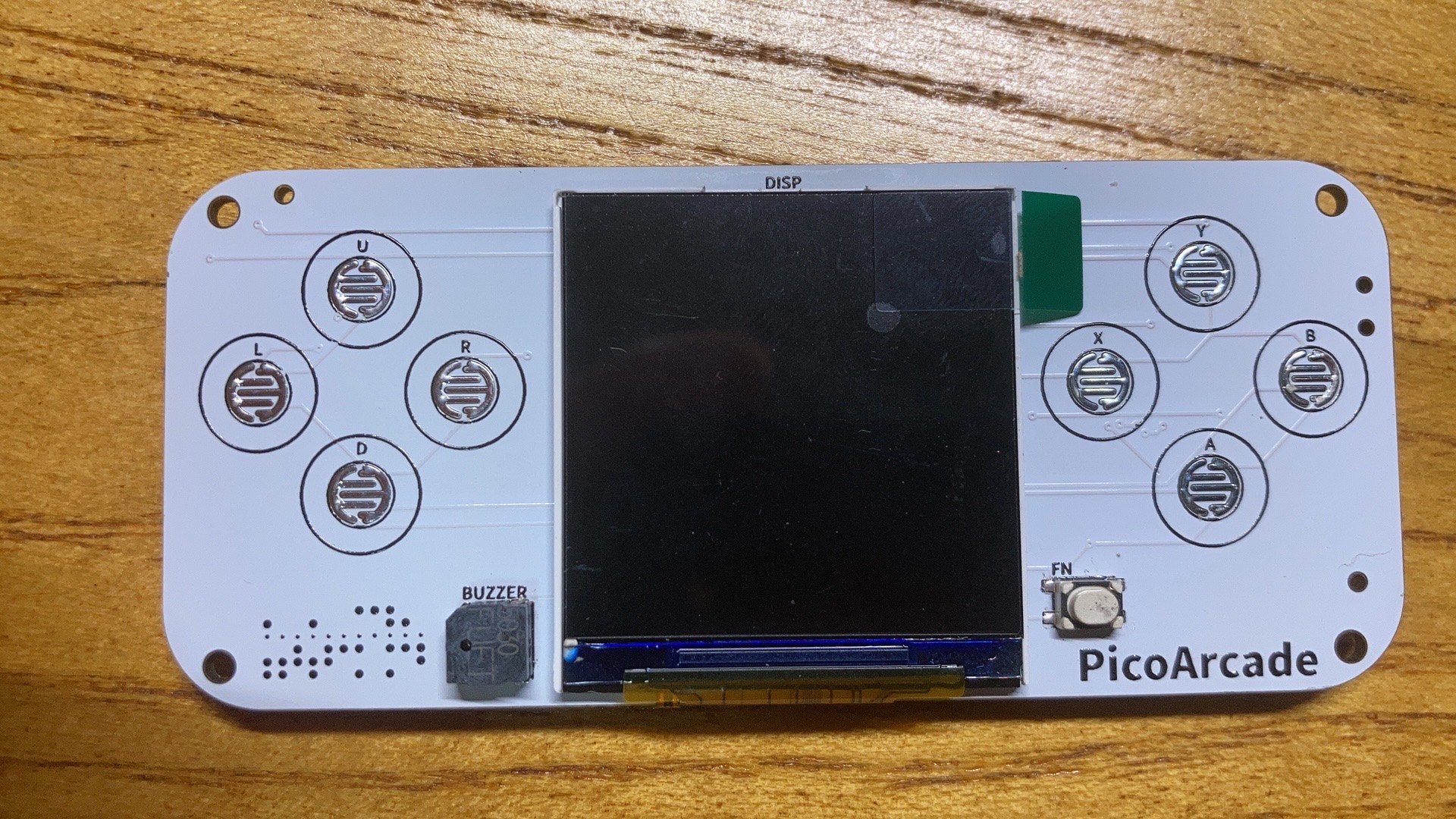

However, since we were making a game, a screen was essential. So, I built a hardware device with an LCD screen based on the RP2040.
This project was also open-source: https://gon.gyeq.in/#/2023/0617/.
While using the RP2040 as the controller, I quickly encountered new problems. The RP2040's clock speed was only 133MHz, which struggled with image refresh. There wasn't much open-source documentation on peripheral expansion for the RP2040, making further expansion difficult. Therefore, I turned my attention to the ESP32S3, with its 240MHz clock speed, support for Wi-Fi and Bluetooth, and ample expandability.

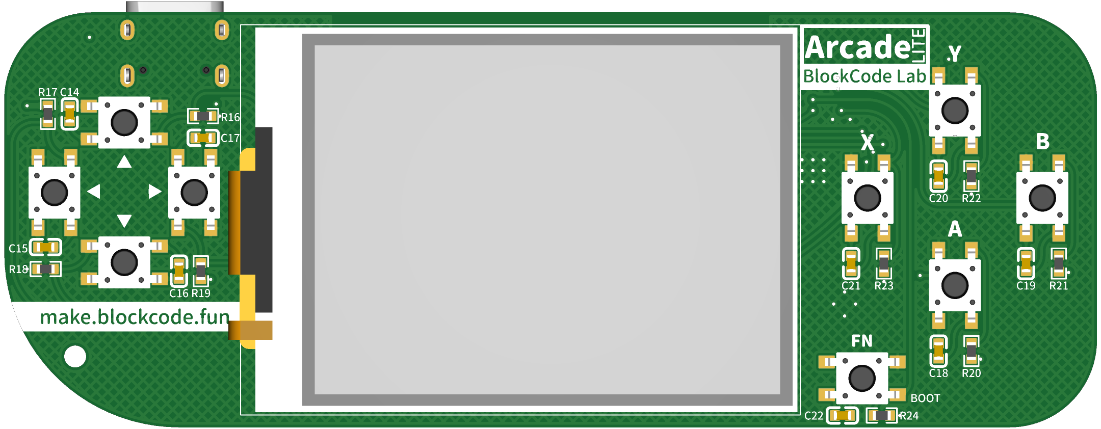

I then rebuilt the hardware based on the ESP32S3, which
took about six months to implement the core functions. However, it still didn't feel like a game console, so I enlarged the LCD screen, reverting to the original game console design. The final product is the open-source version you see today.

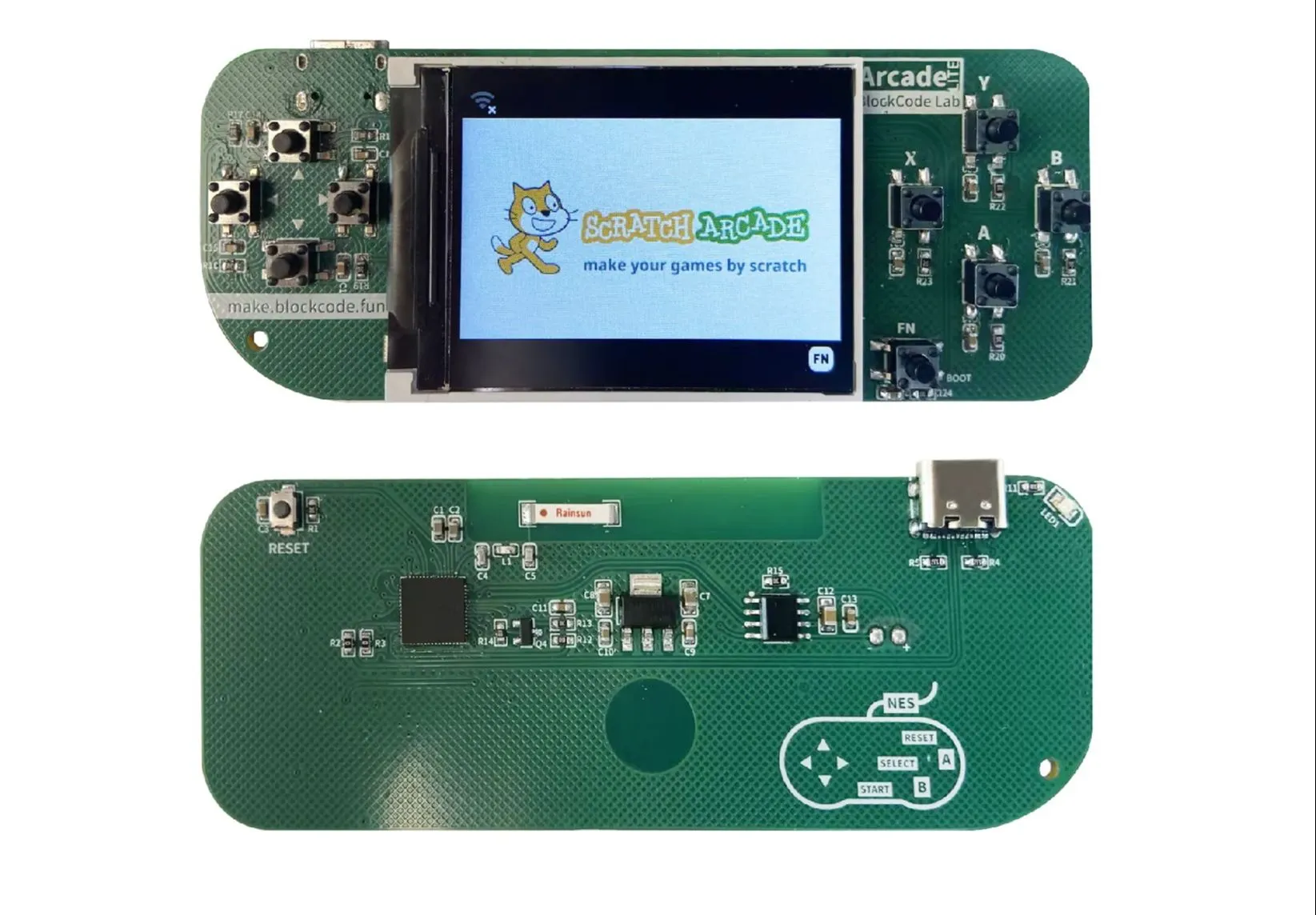

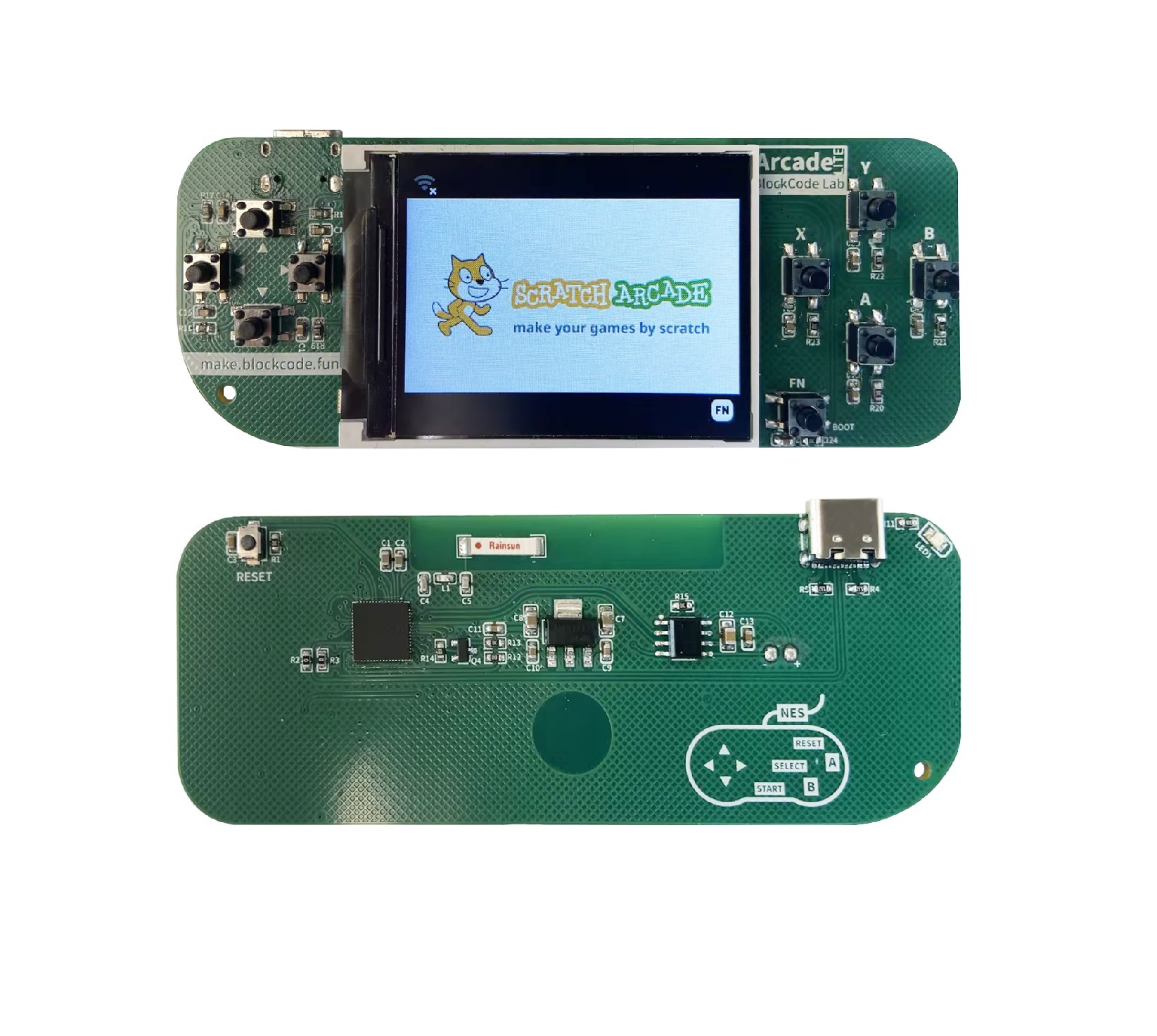

Hardware Features
Hardware
Chip:
ESP32-S3 Xtensa© Dual-core 240 MHz 8MB SPI flash 8MB PSRAM
Screen
: 2.0-inch 320×240 HD color screen
Network:
802.11b/g/n Wi-Fi Bluetooth 5 (LE)
Button
Programming Buttons × 9
Sound
Speaker × 1
100mm × 38mm
) This is the hardware configuration for the open-source version. For the educational version, click here (arcade.blockcode.fun) to view the hardware introduction.
Screen:
A large 2.0-inch TFT color screen supporting up to 65,536 rich colors (16-bit color) with a resolution of 320×240 pixels, capable of presenting a vast game stage. Combined with TileMap (coming soon), it can realize a huge 2D game world.
Network:
Powered by the powerful networking capabilities of the ESP32-S3, supporting 802.11b/g/n Wi-Fi and Bluetooth 5 (LE). Multiple consoles can also interconnect for maximum online interaction.
Interaction :
Nine buttons—eight standard game buttons (up/down/left/right/A/B/X/Y) and one function (Fn) button. Different functions can be assigned to the buttons through programming to realize various gameplay and enrich the program's interactive capabilities. Programming: Program using
graphical (Scratch) or MicroPython in BlockCode Playgrounds. The graphical (Scratch) interface is identical to Scratch, and most of the programming blocks are also the same, with only a few differences due to hardware features (the missing parts will be gradually added later to more closely resemble the original Scratch blocks and functions), making it easier for teachers familiar with Scratch to teach. The stage aspect ratio remains consistent with the original Scratch, but the resolution is reduced—320×240, with the x-coordinate changing from -160 to 160 and the y-coordinate from -120 to 120. Variables are not displayed; their content will be displayed in the newly added "Data Monitor" (stay tuned). Shapes are only available in bitmap mode; vector mode is not supported. Shapes from Scratch can be used. Backgrounds include bitmap backgrounds from Scratch, as well as TileMap backgrounds and AI backgrounds (stay tuned). TileMap backgrounds use tile maps to create a very large game map; AI backgrounds use generative AI to generate a bitmap background from text. Sound can only use WAV format audio files, with a length not exceeding 10 seconds or a size not exceeding 200kB, and must be mono. The MicroPython firmware is compiled based on MicroPython version 1.2x, adding unique packages for easier game and app development. The MicroPython programming platform is coming soon, and we also recommend using Arduino Lab for MicroPython, a lightweight MicroPython editor, for programming. Project external links : GitHub: https://github.com/BlockCodeLab/arcade-lite Gitee: https://gitee.com/blockcodelab/arcade_lite Firmware download : Download the latest version. Hold down the BOOT key (FN key) while connecting the hardware to the computer, and flash the firmware in the terminal using the following command: esptool.py --chip auto --port "serial port number" write_flash -z 0 arcade_lite.v0.9_mpy_v1.23.0.bin NES emulator: Please wait a moment. Thank you to EasyCreation Space for their production support of the educational version product. Welcome to join our group for discussion. This open-source project has undergone a year and a half of development and optimization. Its biggest achievement is validating the feasibility of the initial idea. Currently, it's just an open-source version. The educational version has many interesting and surprising features, such as voice intercom, AI, FPV image transmission remote control, and a hardware lab. However, there are still many areas that need improvement and optimization. We welcome everyone to join our group to offer suggestions and exchange ideas. Please add me on WeChat first, and I will add you to the group.
