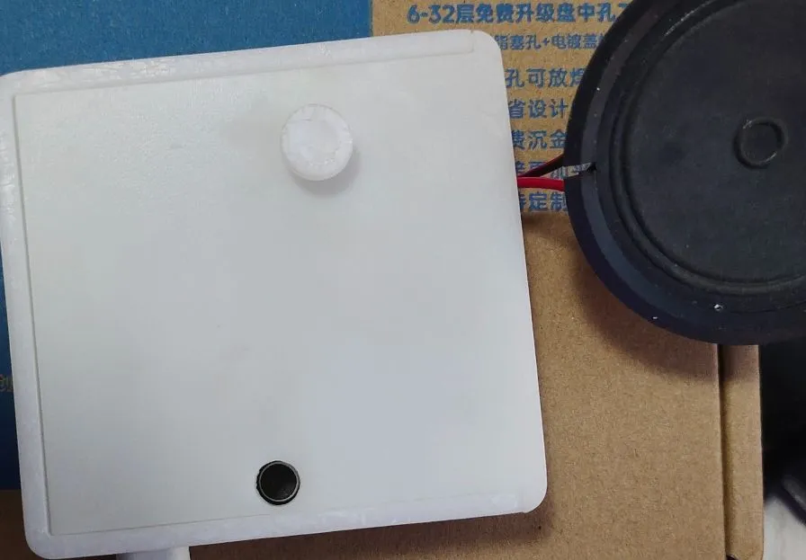

Design Steps
: 1. Connect your computer or mobile phone via Bluetooth to enable audio playback.
2. Use WiFi to access your favorite radio stations on Dragonfly FM.
3. Simple chatbot steps:
3.1 Acquire sound via microphone and upload it to Baidu Voice-to-Text.
3.2 Transmit the converted text from Baidu to the Xunfei Xinghuo Dialogue Service
. 3.3 Receive the returned dialogue text from the "Xinghuo" platform.
3.4 Use TTS to convert the text of the dialogue content into speech. Use a speaker to achieve voice output.
Schematic Design Notes:
1. Note that RXD0 and TXD0 must be swapped in the automatic download circuit.
2. Use a 5-way switch button as the input operation.
PCB Design Notes:
1. Use a 4-layer board, separating the ground plane of ES8311 from that of ESP32 and connecting them with a 0Ω resistor.
2.5 Silkscreen markings around the switch button: M: MODE, S: SET, -: low volume, +: high volume. Press: Pause or play.
Software description:
Developed using Espressif's open-source ESP-IDF+ESP-ADF framework.
S: Pressing switches from smart dialogue mode to Bluetooth playback.
M: In Bluetooth mode, switches between Bluetooth and internet radio.
Press: Smart dialogue mode for dialogue, Bluetooth mode for pause, radio mode for switching stations
You can read the source code yourself
. Notes:
1. Most of the above text is written in AI.
2. You need to draw the 3D printing of the button yourself.
3. The hole for the button on the shell needs to be adapted to your own button.
4. Remember to change the Wi-Fi account and password in my_wifi_and_ble.c.
5. The button may encounter pin mismatch issues; please use a multimeter to determine which pin is 5.
