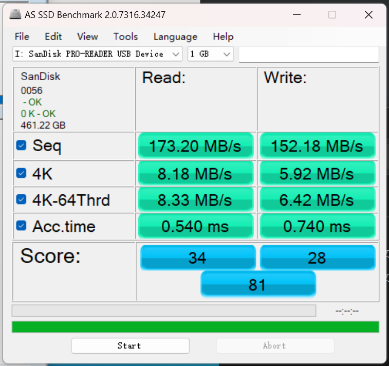

The image below shows the speed test results of the SanDisk Pro-Reader card reader; the following text shows the test results of a custom-made card reader.

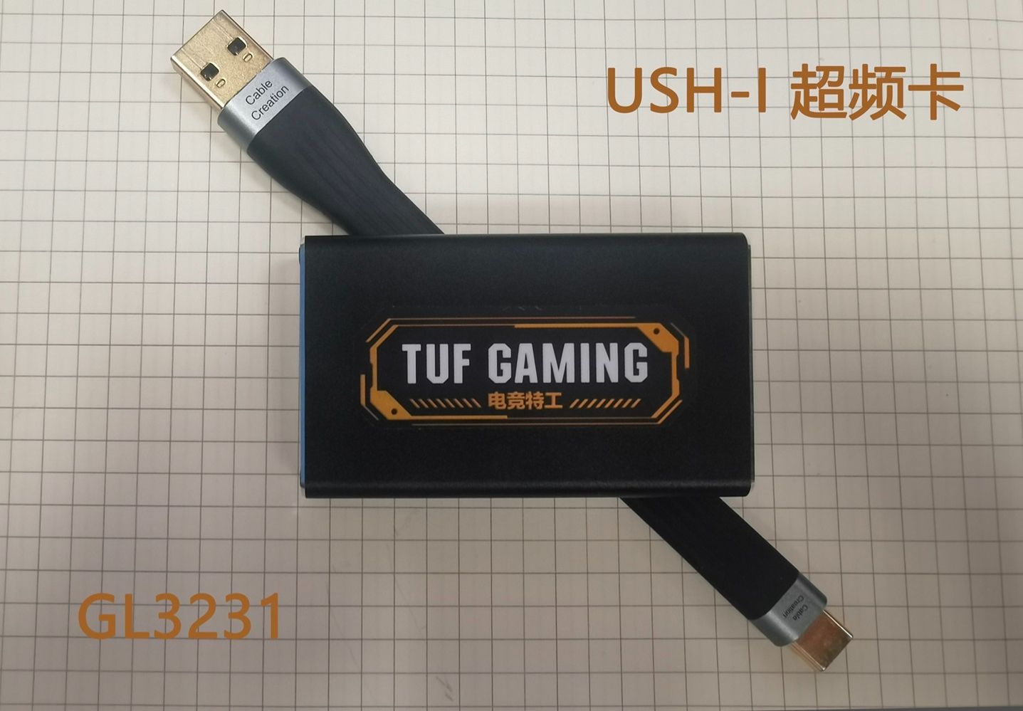

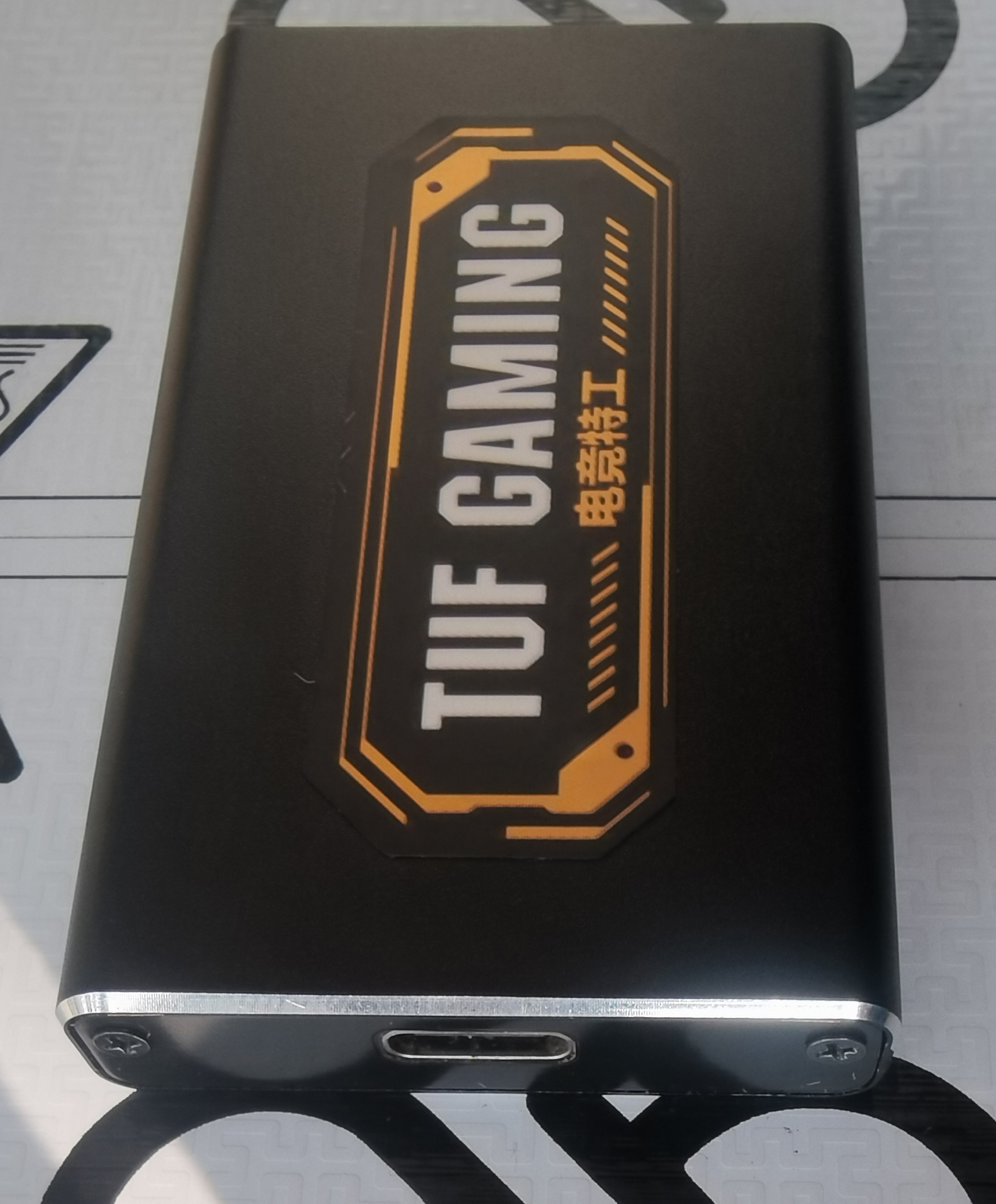

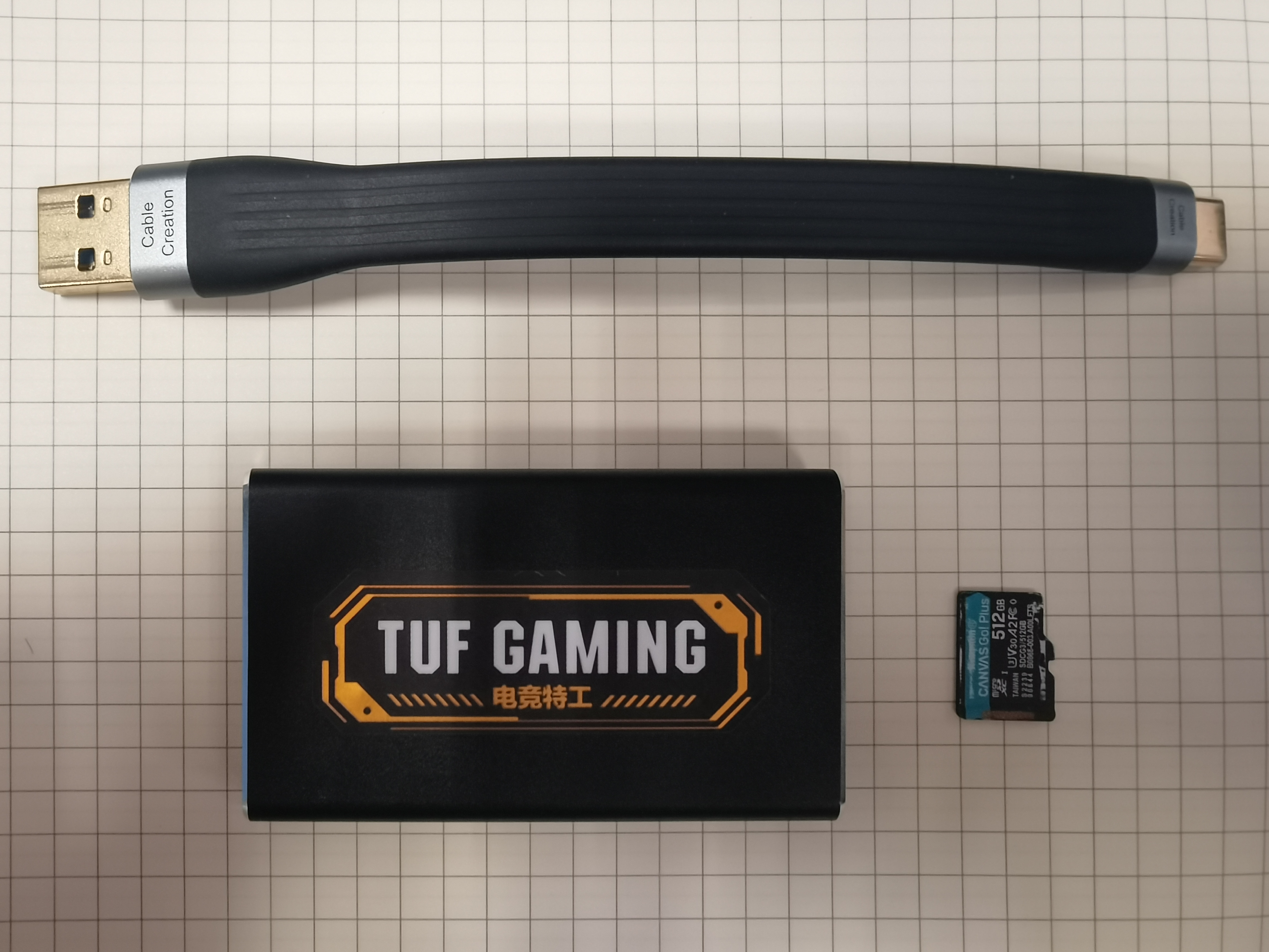

The custom-made card reader
features a modified side panel and a hidden SD/TF card design, resembling an Msata hard drive enclosure.

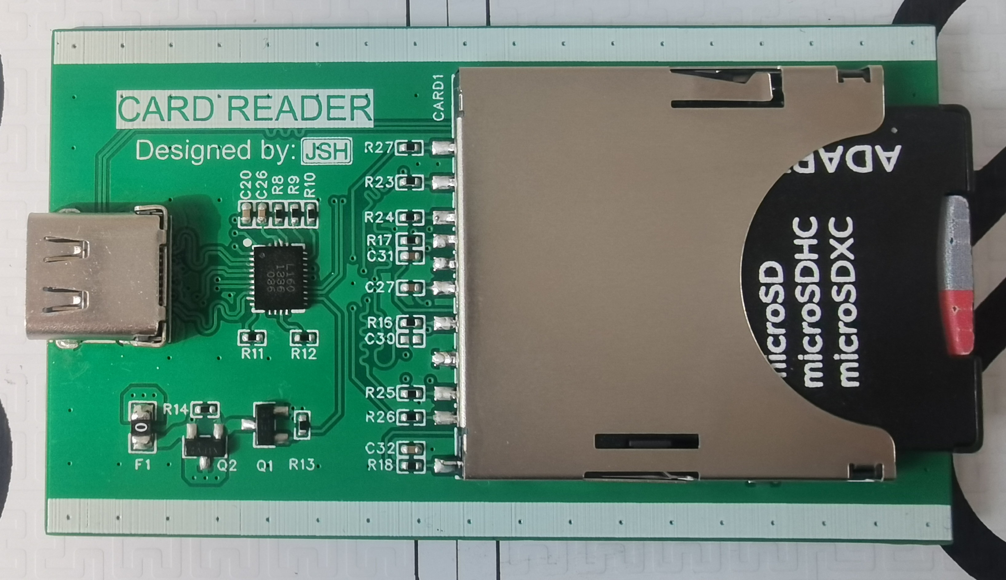

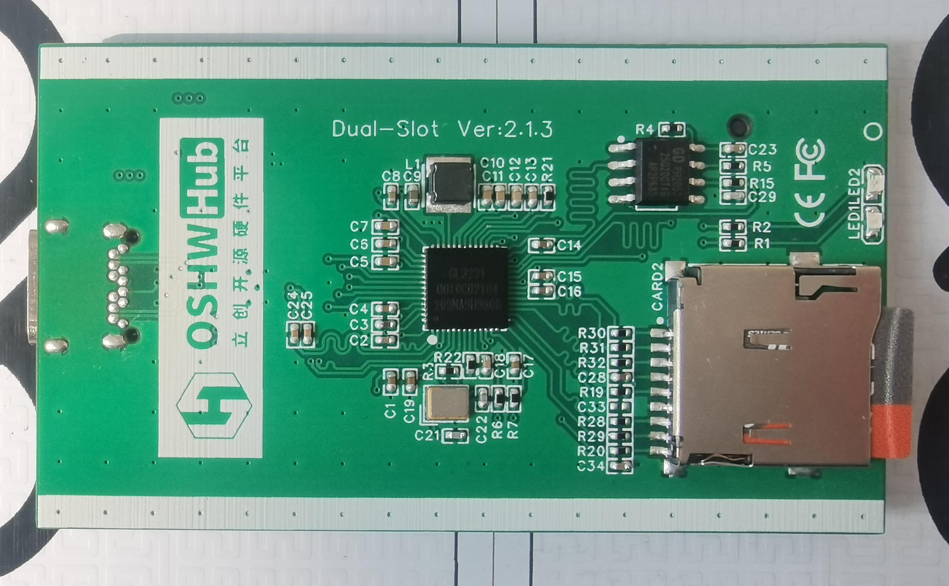

The PCB is shown in the image; the Type-C female connector is front-mounted and rear-mounted for a more secure fit, and all card slots are spring-loaded.

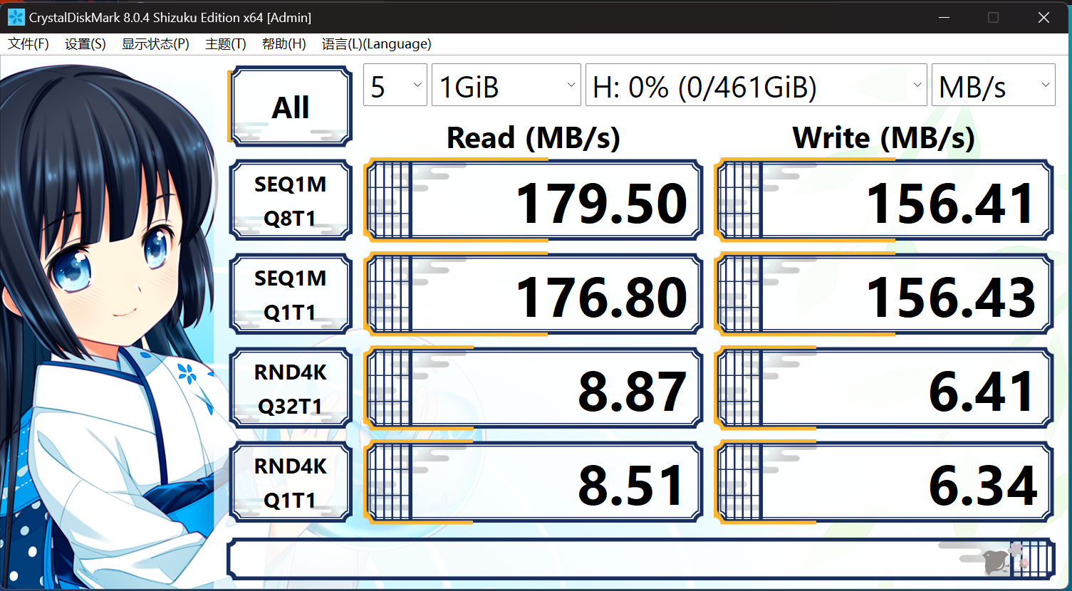

Test Conditions: Kingston Blue Stripe SDCG3 512G TF card, exFAT format; thermal paste was applied to both the controller chip and the TF card slot, allowing for close contact with the aluminum alloy casing; ambient temperature around 25℃, no active cooling.

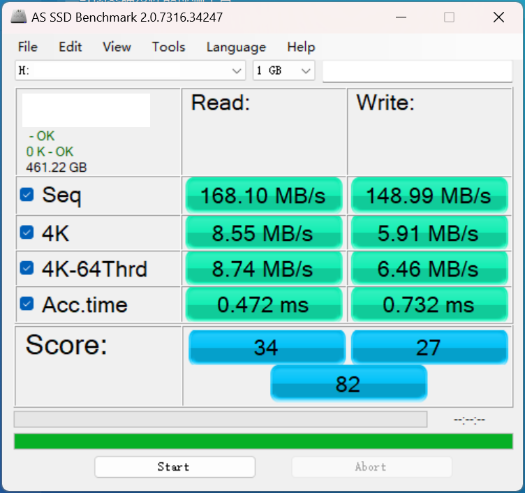

1. AS SSD test
2. CrystalDiskMark test
Evaluation: Performed normally, as these are peak speeds.

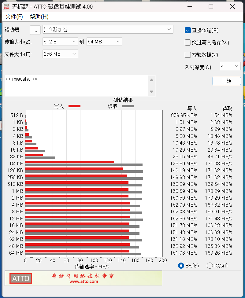

3. ATTO test

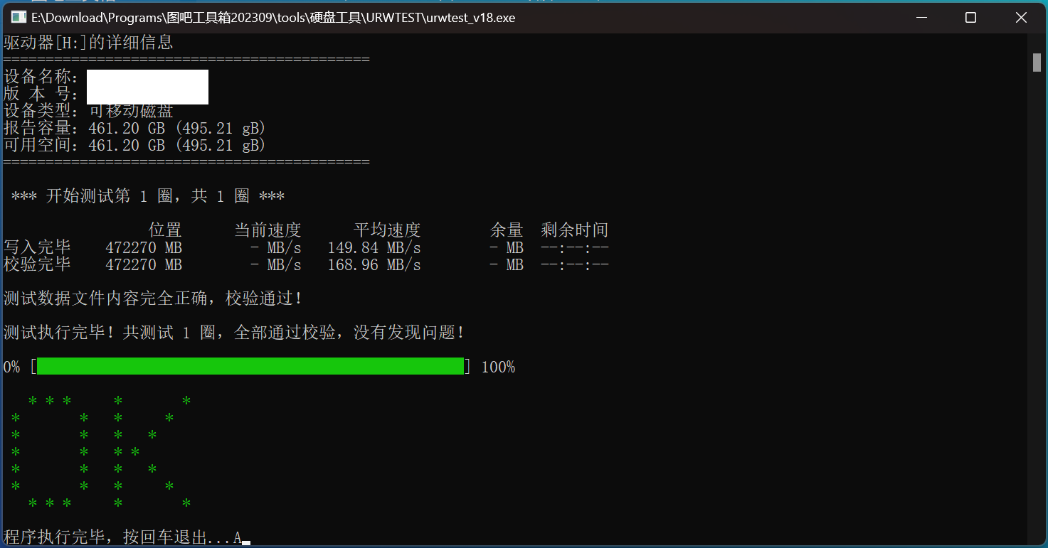

4. urwtest full disk read/write test
Evaluation: Notably, there was no heat or speed reduction during full disk read/write, although the card reader casing became warm.

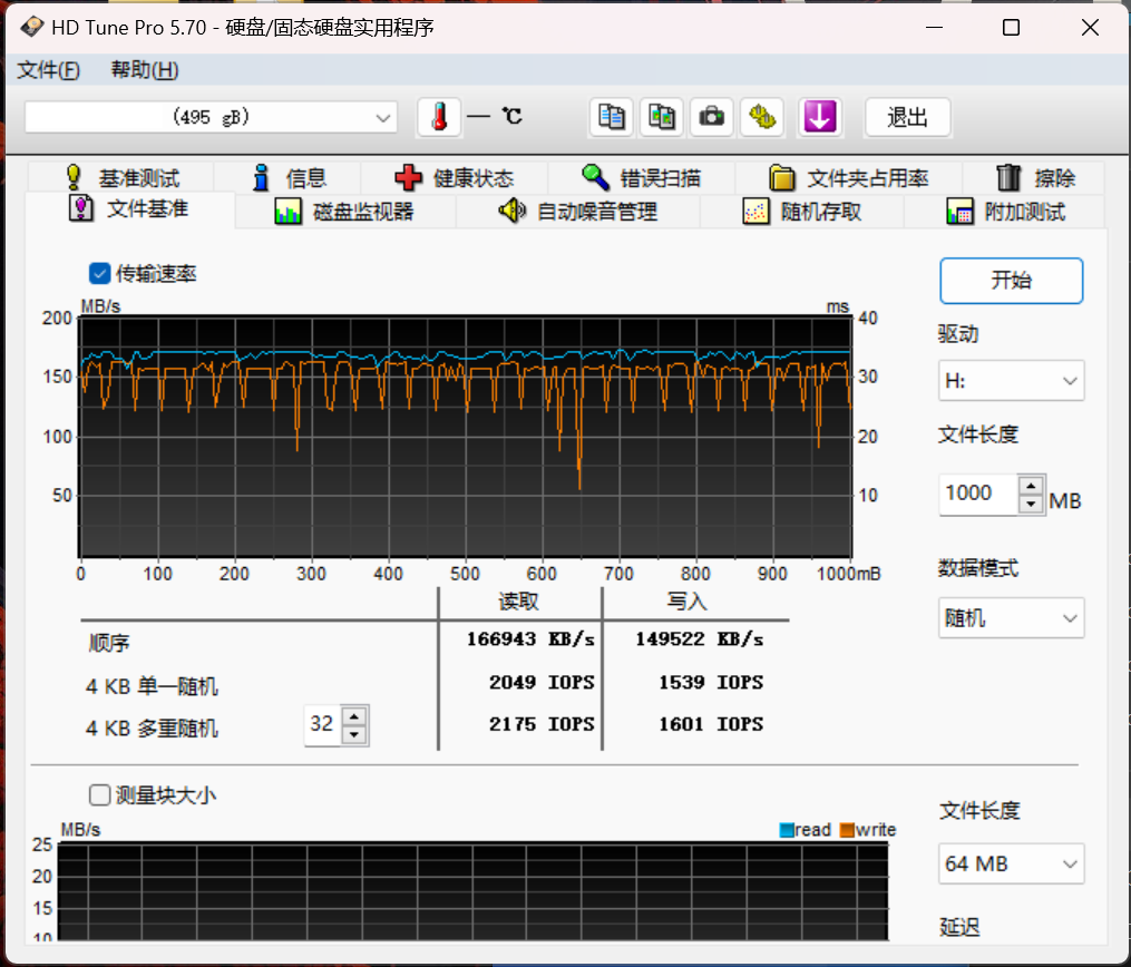

5. HD Tune 1G read/write test
Evaluation: The 1G write speed appears somewhat volatile; only one test was performed, so this is just for reference.

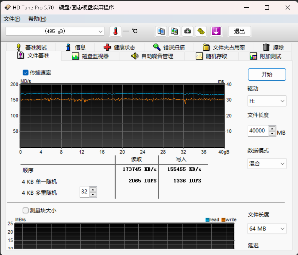

6. HD Tune 40G read/write test
Evaluation: The 40G read/write speed appears very stable with minimal fluctuations.
