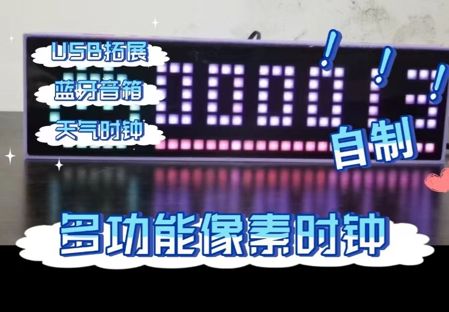

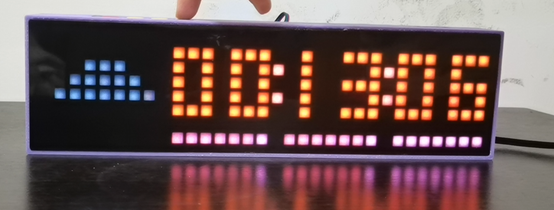

This project was done in my spare time to improve desktop tidiness by integrating multiple functions. The main functions include the following:

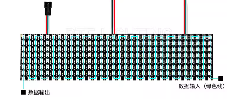

For time display, I used a WS2812 pixel screen.
Of course, you can also choose four screens like the one shown below, which are much smaller and cheaper.

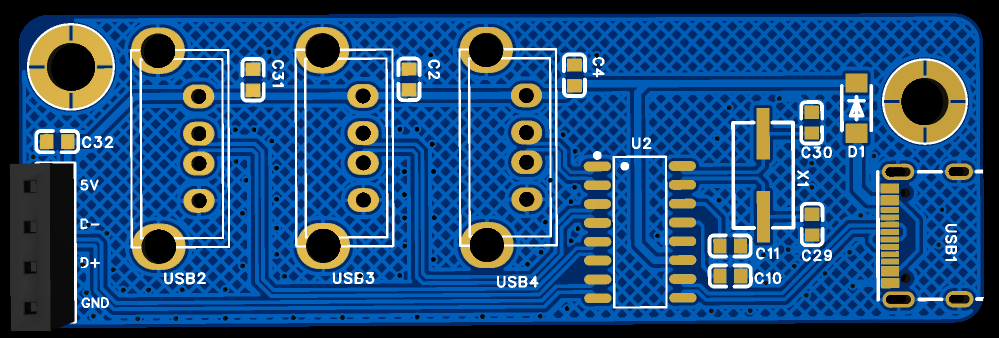

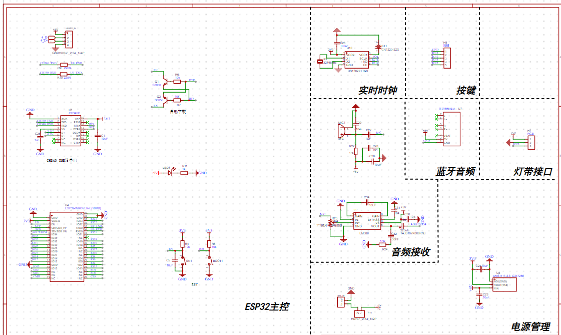

I chose an ESP32 as the main controller, and other circuits mainly include an audio acquisition circuit, a USB expansion circuit,
a DS1302 clock circuit, and Bluetooth audio.
The hardware design is as follows:

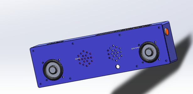

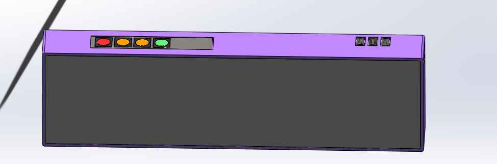

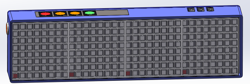

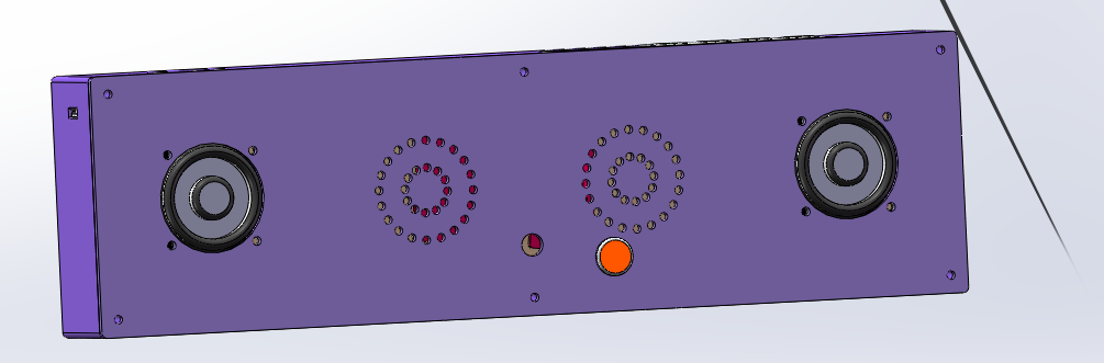

Structurally, because of the two different screen sizes, I designed two different sized models for easy replication.

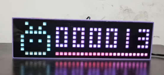

The assembly effect is shown below.
The software was written using VSCode + PlatformIO,
and the effect is shown below.
