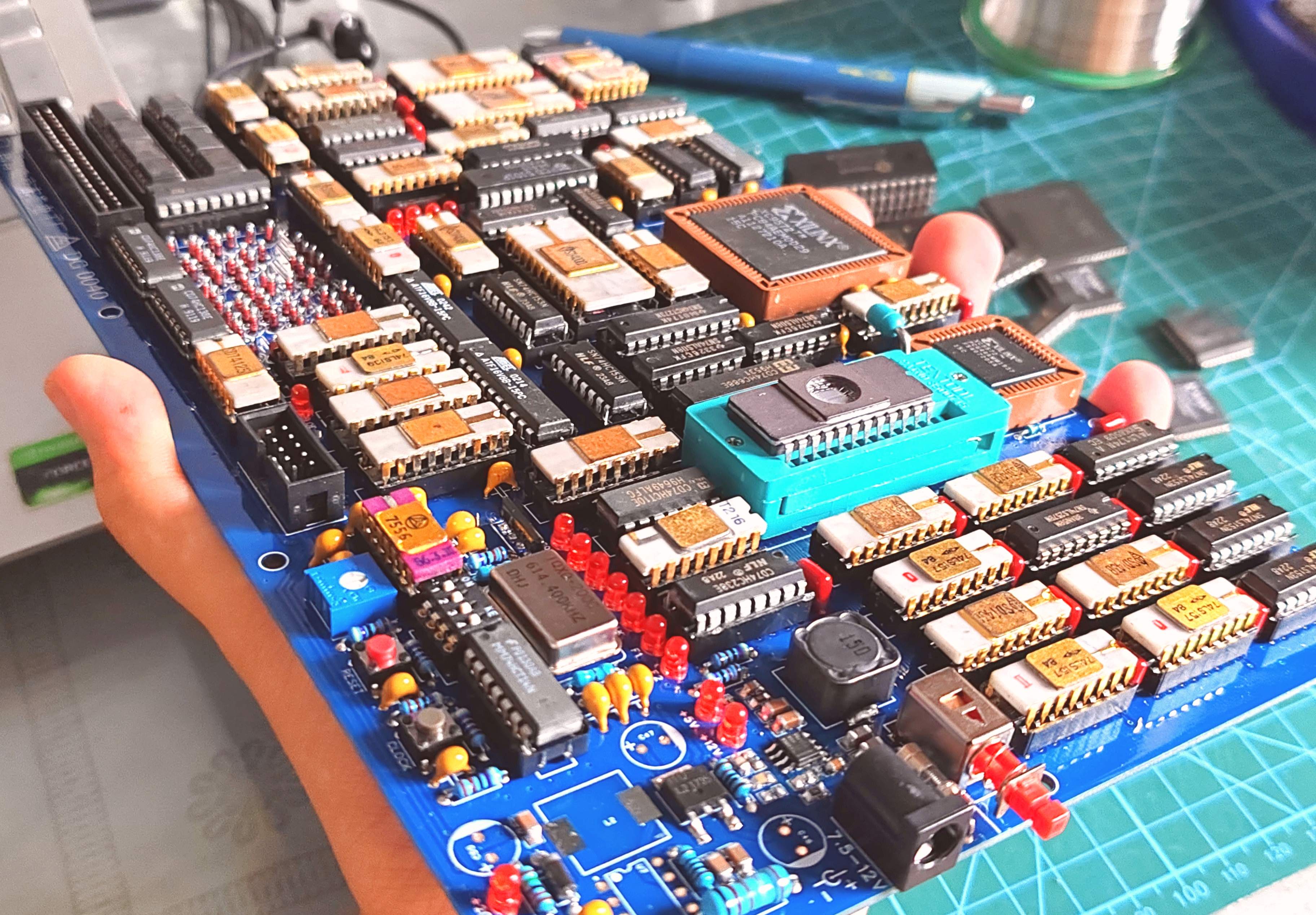

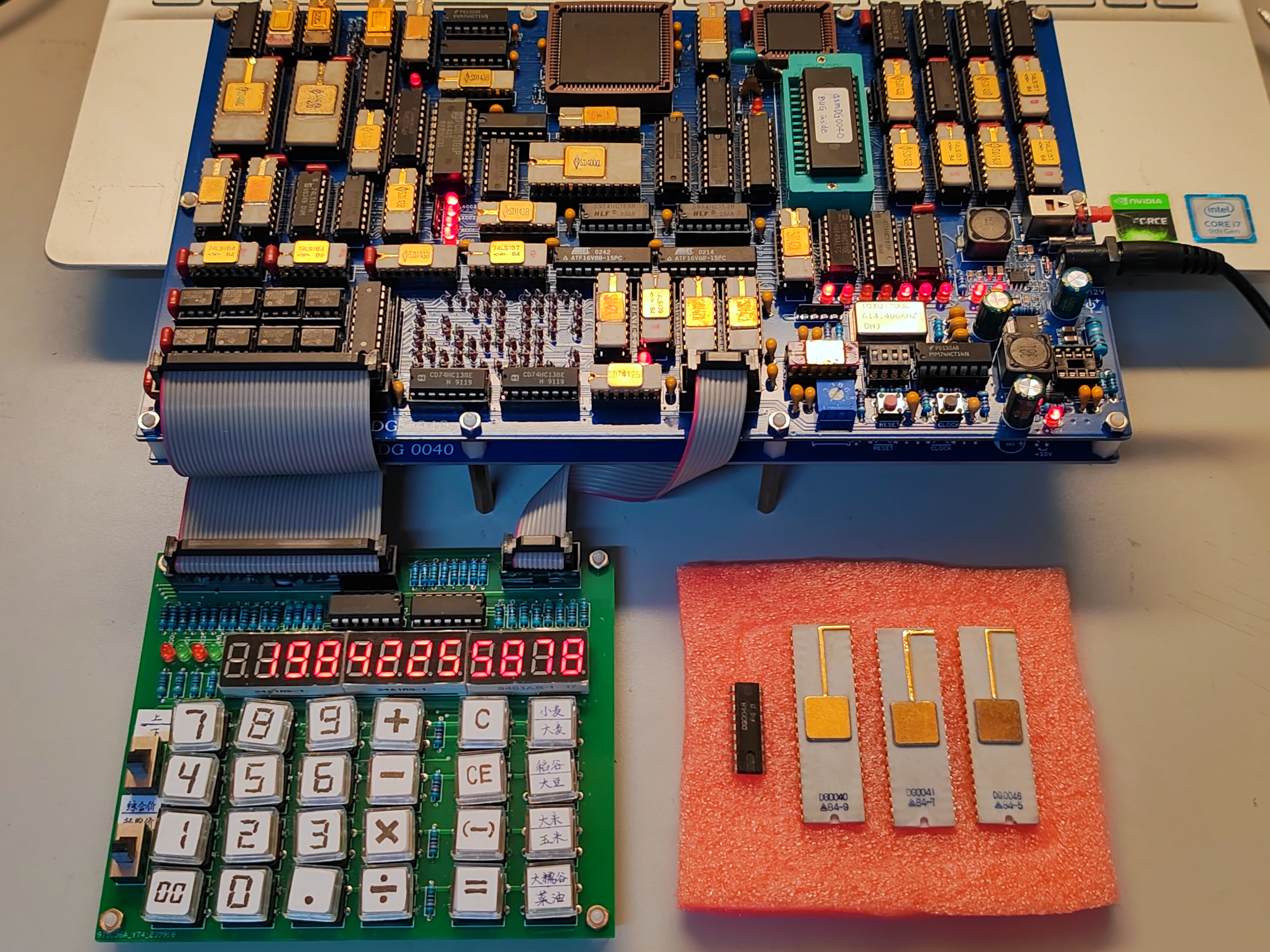

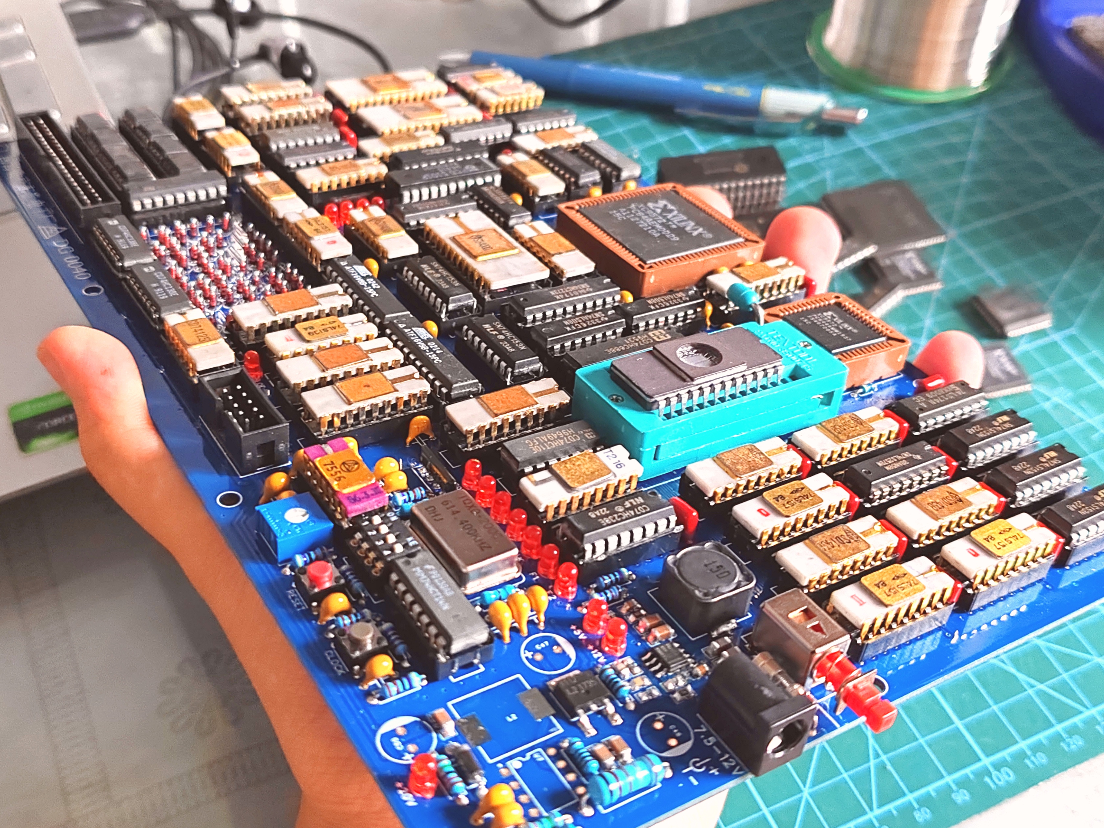

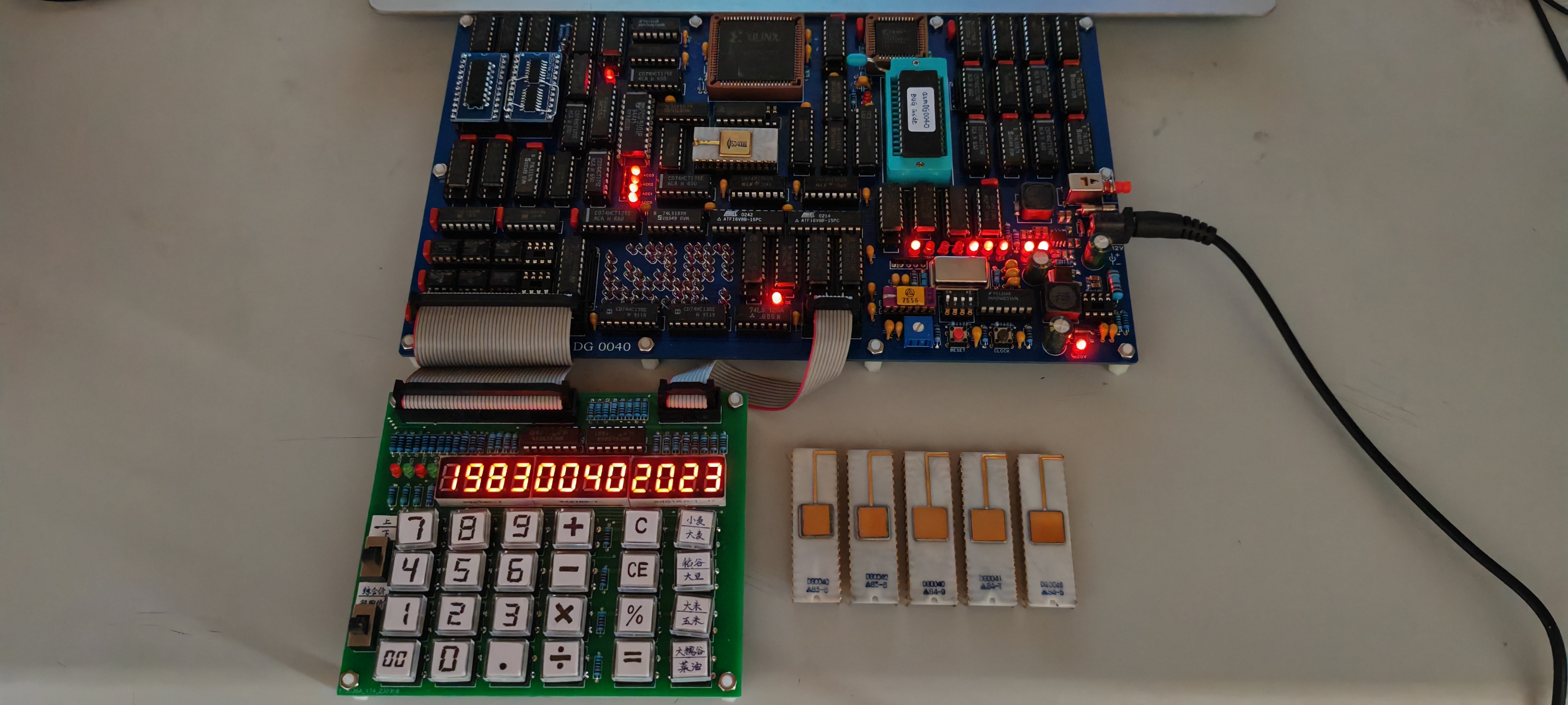

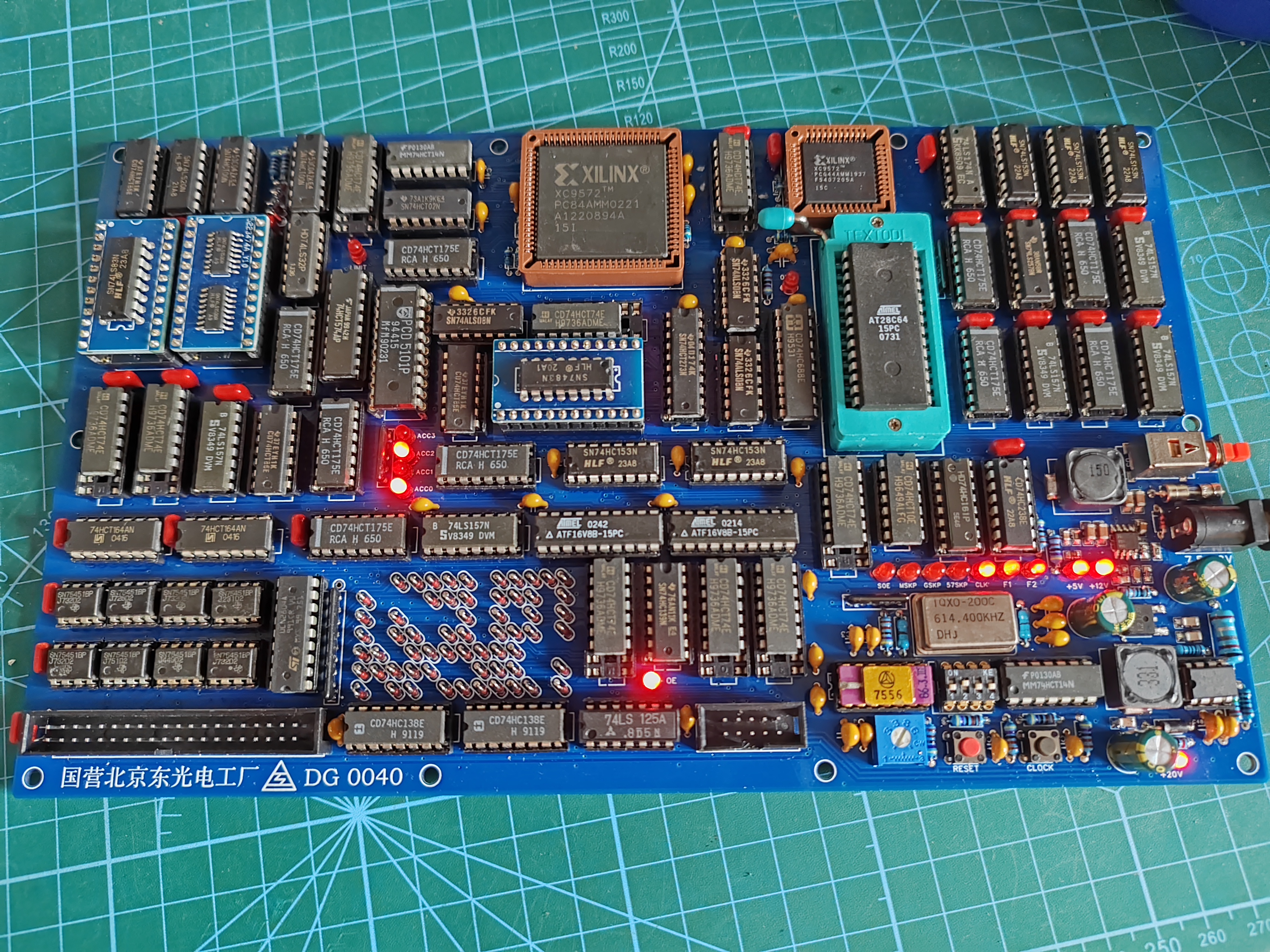

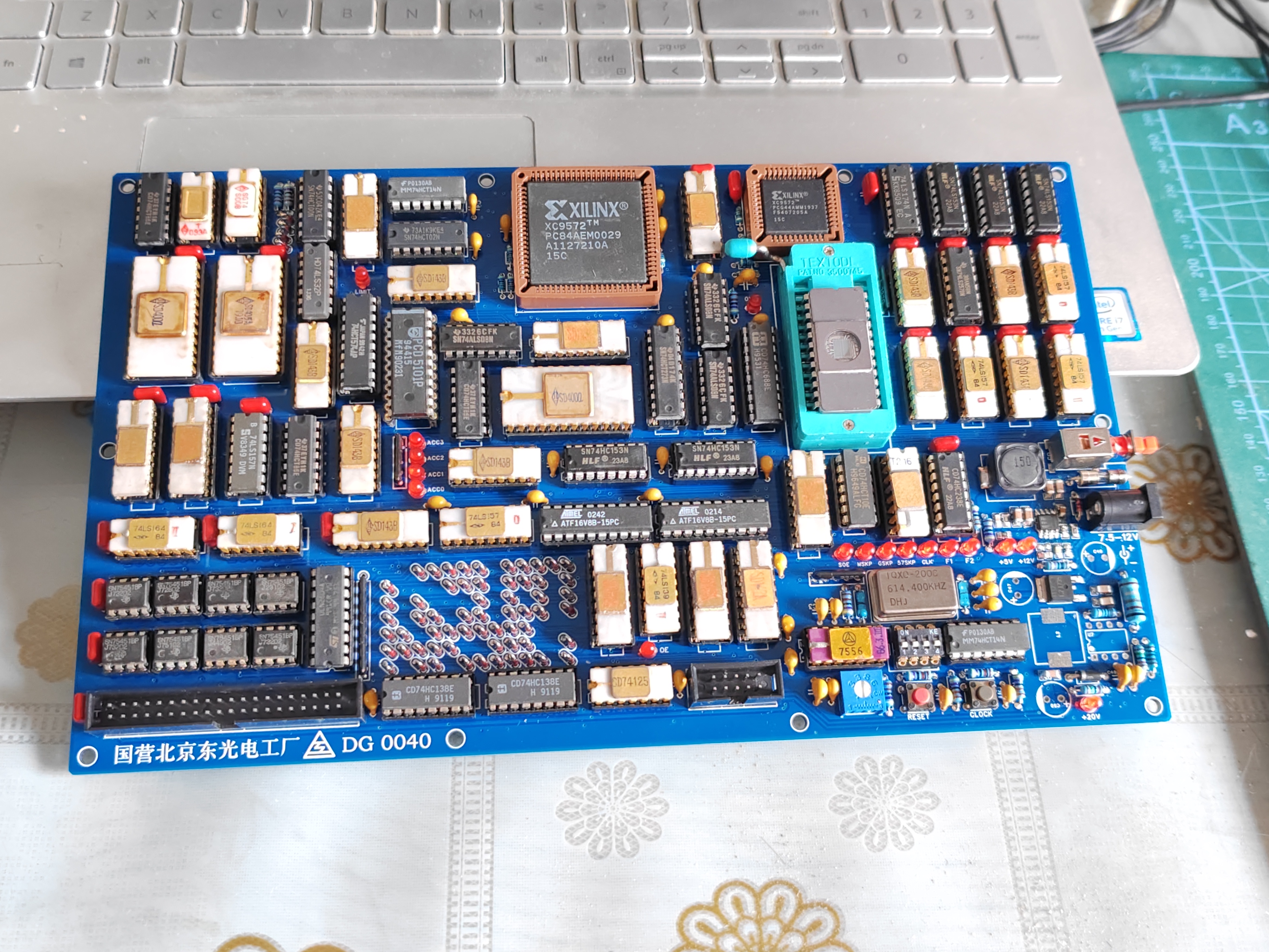

This design primarily consists of a 74LS chip, a small number of GAL16V8 chips, and a small number of XC9572s. All the logic of DG0040 and DG0041 is placed on a single circuit board, ensuring full compatibility with the original DG0040 and DG0041 instructions. It does not support the DG0046 instruction in double-byte sequences, nor does it support connecting to DG0046.
The internal code and netlist files of the GAL chip and XC9572 will be released upon the final completion of this project.
Some physical photos are shown below:
