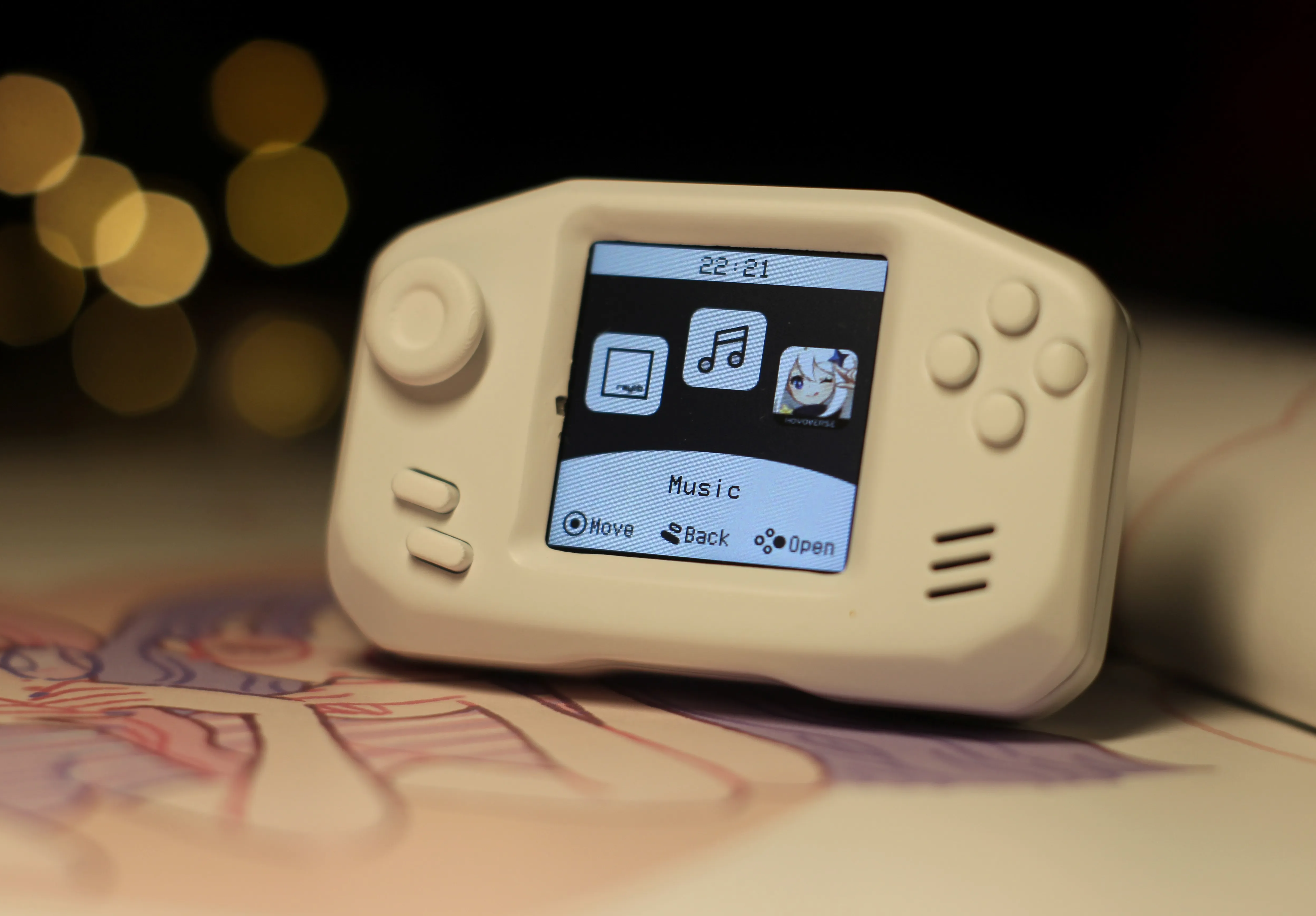

【Rachel】Mini Game Console~
Rachel

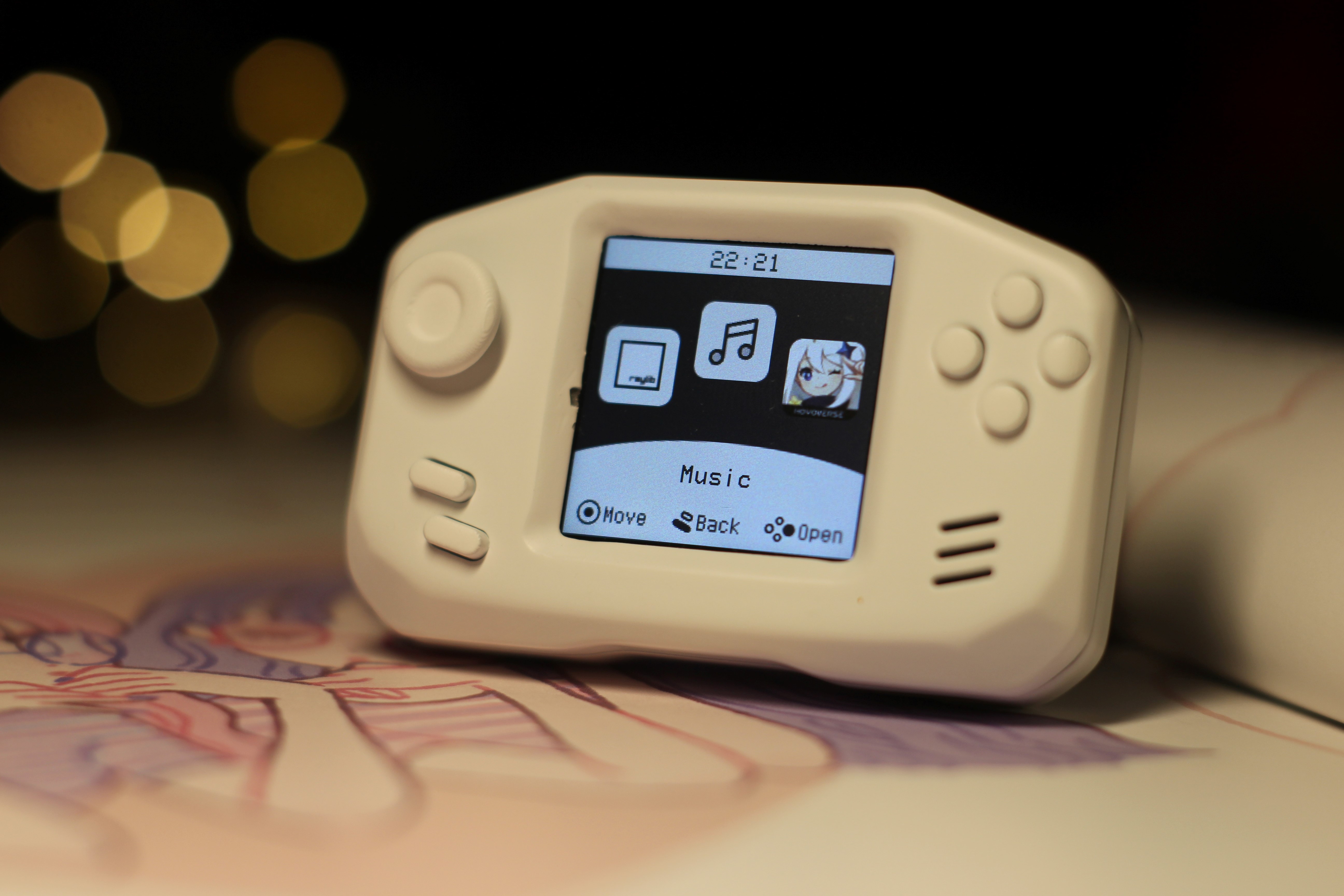

ESP32 Mini Game Console, great feel
and retro vibe, but it can't do anything (sad).
Project purpose: Cute.
All components are 0603, so you can solder them on a teppanyaki grill.
Project link: https://github.com/Forairaaaaa/Rachel
Video introduction: https://www.bilibili.com/video/BV1Ga4y1f7d3/ To compile the Rachel

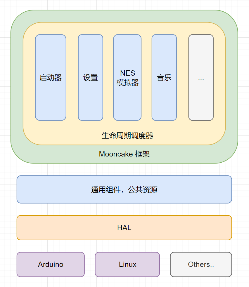

The Mooncake framework integrates the spdlog logging library. Of course, you can also continue to use cout, printf, Serial...

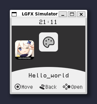

Manually create
and copy src/rachel/apps/app_template to the same directory and rename it: src/rachel/apps/app_hello_world
Rename app_template.cpp and app_template.h to app_hello_world.cpp and app_hello_world.h
Open app_hello_world.cpp and app_hello_world.h, and replace all AppTemplate with AppHello_world
Open src/rachel/apps/apps.h
and add #include "app_hello_world/app_hello_world.h"
Add mooncake->installApp(new MOONCAKE::APPS::AppHello_world_Packer);
Compile and upload

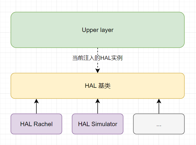

The HAL
(Hardware Abstraction Layer)
is a singleton; an instance of HAL is injected during SDK initialization.
For HAL Rachel, holding down button A to power on will pause the initialization screen, where you can view detailed HAL initialization logs.
If there are different underlying hardware requirements, simply derive a new HAL object, override the API methods, and inject them during initialization.

dive into the specific framework and implementation, you can check out HAL Rachel if you can't sleep. HAL Rachel is derived from HAL and provides a directory tree of the specific implementations of HAL's APIs on Arduino-ESP32 . ├── components Initialization and API implementation of each peripheral │ ├── hal_display.cpp │ ├── hal_fs.cpp │ ├── hal_gamepad.cpp │ ├── hal_i2c.cpp │ ├── hal_imu.cpp │ ├── hal_power.cpp │ ├── hal_rtc.cpp │ ├── hal_sdcard.cpp │ └── hal_speaker.cpp ├── hal_config.h Pin definitions, internal log definitions, etc. ├── hal_rachel.h Class declaration └── utils └── m5unified Some very useful ESP32 peripheral abstraction initialization process : HAL calls init() when injected. The init() overridden by HAL Rachel is the initialization process: inline void init() override { _power_init(); // Power management initialization _disp_init(); // Display initialization _gamepad_init(); // Gamepad button initialization _spk_init(); // Speaker (buzzer) initialization _i2c_init(); // I2C initialization _rtc_init(); // RTC initialization _imu_init(); // IMU initialization _fs_init(); // Internal Flash file system initialization _sdcard_init(); // SD card file system initialization _system_config_init(); // System configuration initialization _sum_up(); // Summary } The internal Flash file system uses LittleFS. Currently, it's only used for saving system settings, so the partition is only allocated to 256 kB. The `loadTextFont24()` API is designed for better-looking (supports Chinese) text display. It's implemented by reading the vlw font from the SD card, so using this font will increase rendering time. Of course, there are many ways to make this API also suitable for fast-refreshing screens, but for me, this built-in font is sufficient. The launcher and selection menu both use this. Both the RTC and IMU peripherals can find readily available drivers and abstractions in the M5Unified library; I simply extracted them and integrated them according to my needs. HAL Simulator: Because LovyanGFX supports SDL as the display backend, implementing a HAL implementation on a PC basically requires nothing (I'm sure), just one header file. The RachelSDK simulator project is here. RachelSDK initialization process.
With HAL abstracting the underlying layers, the rest is up to C++ developers (of course, some apps still directly use platform-specific APIs, such as the NES emulator using the ESP32 partition read/write API; abstracting all of these would be a waste of time—conditional compilation is sufficient and doesn't hinder the overall framework's versatility).
RachelSDK initialization is as follows:
// Inject the specific HAL based on the platform
#ifndef ESP_PLATFORM
HAL::Inject(new HAL_Simulator);
#else
HAL::Inject(new HAL_Rachel);
#endif

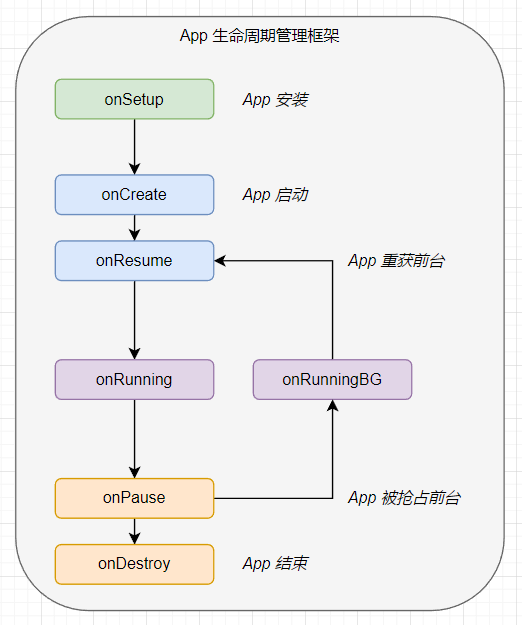

After initialization, the Mooncake framework takes over, handling the lifecycle scheduling of each app. Here's a simplified lifecycle diagram:

Open launcher.cpp:
`onCreate`, this is only called once when the launcher is created, so it's responsible for configuring its properties and allocating resources: `
void Launcher::onCreate()
// Allow background running
setAllowBgRunning(true);
//` Allow automatic startup after creation:
`startApp();
` // Create menu (this menu is an abstraction of the list of installed apps, which will be explained in detail in the rendering section later)
`_create_menu();
onResume` is called when the launcher is first created or when it switches from the background to the foreground, so it contains some pre-rendering preparations, such as refreshing control information... `
void Launcher::onResume()
// Change font...
HAL::LoadLauncherFont24();
HAL::GetCanvas()->setTextScroll(false);
// Update the time text in the status bar
_update_clock(true);
onRunning`, when no other apps are open, the launcher reads input... refreshes the menu, controls... renders the screen...
`void Launcher::onRunning()
_update_clock();
_update_menu();
Let's sneak a peek into `_update_menu()` and see what happens when the launcher needs to open an app:
