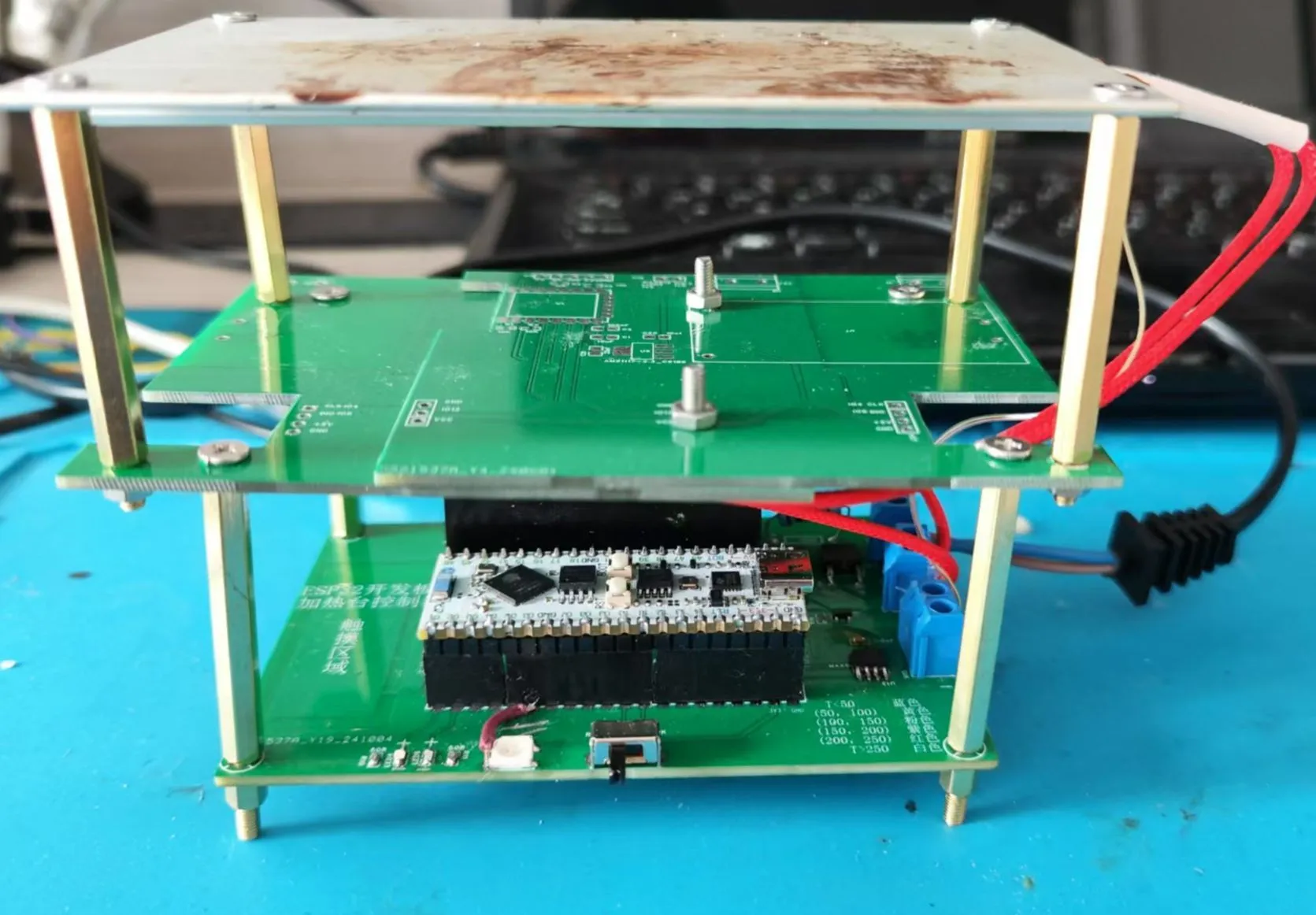

I. Project Description
This project, based on the LCSC ESP32-S3 development board, created a simple controller for a heating plate, allowing it to operate in two phases: low temperature for melting solder paste and high temperature for soldering. A WS2812 microcontroller is used to monitor the heating plate temperature in real time.

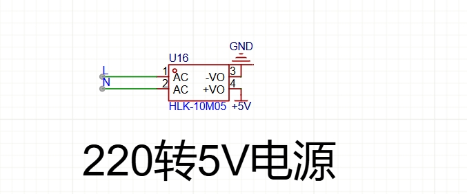

The power supply section
uses an HLK 220V to 5V module.

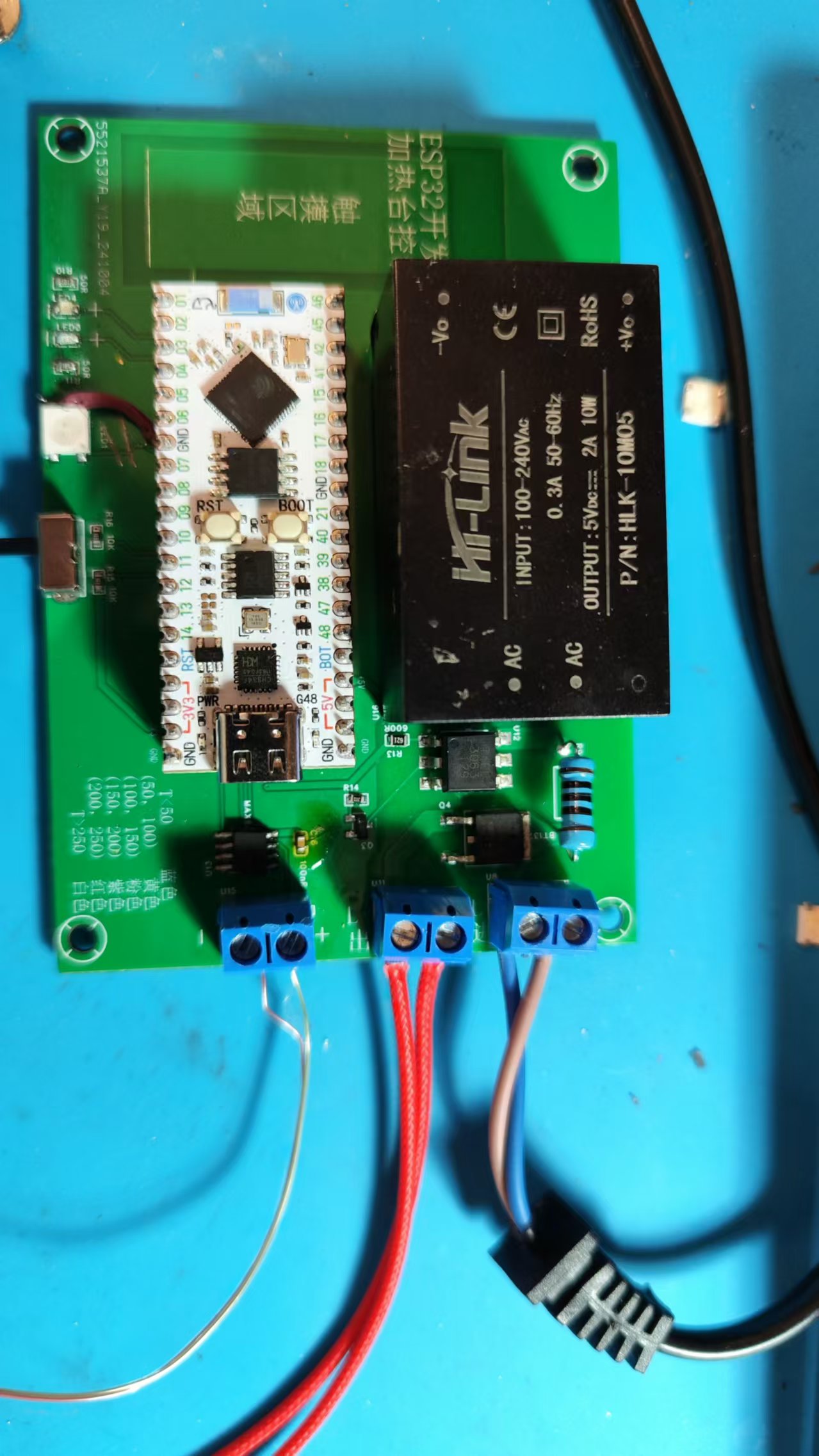

The main control section uses
the ESP32-S3 development board.

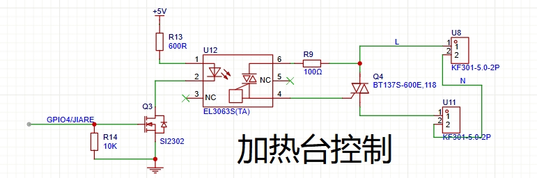

The heating plate control section uses
the ESP32-S3 development board's I/O ports connected to NMOS transistors to control optocouplers and SCRs, thus controlling the heating plate's power supply. The

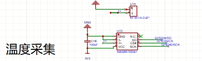

temperature acquisition section
uses a MAX6675 microcontroller with a K-type thermocouple to acquire temperature data . The

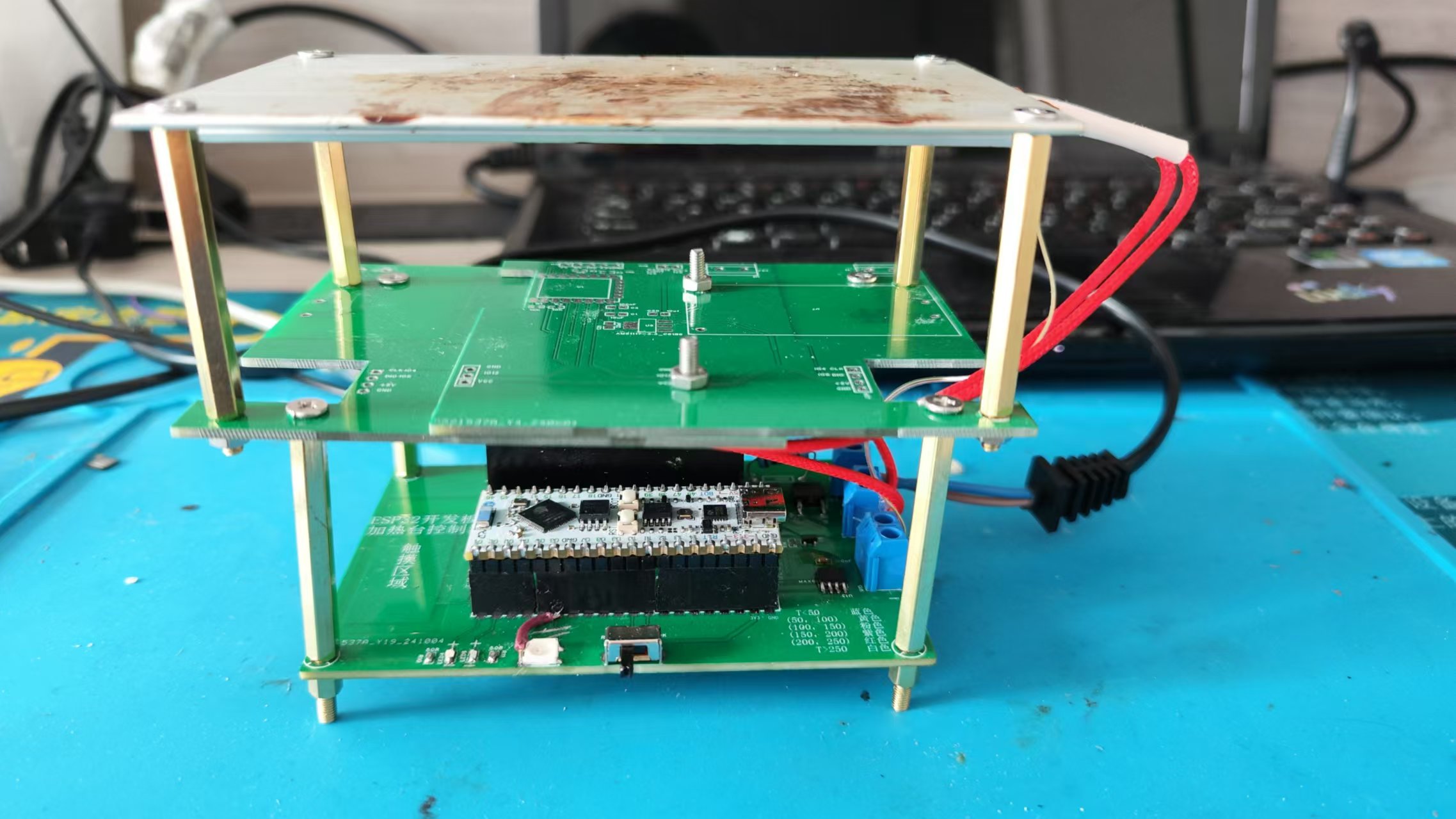

IV. Physical Demonstration Instructions
and Precautions
: This project involves high-voltage electricity, please handle with caution!
