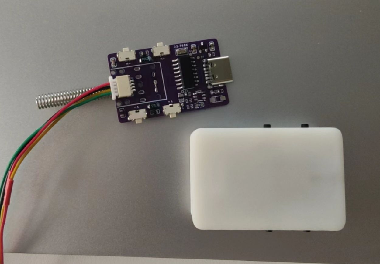

The radio uses a TP4059 to charge the lithium battery and an XC6206P332MR for step-down power. It features a headphone jack with a switch for automatic power-on when headphones are plugged in. The 320mAh lithium battery provides over 10 hours of battery life.
3D casing instructions: It fits a 502035 polymer lithium battery perfectly. Buttons must be soldered during casing assembly; otherwise, they won't fit.
