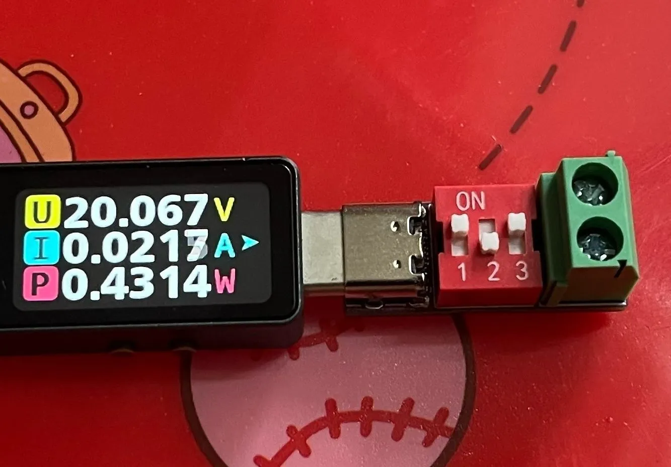

PDSink -- Adjustable PD decoy based on CH224K
The PD decoy, based on the CH224K design, allows real-time voltage adjustment via DIP switches, supporting five voltage levels: 5/9/12/15/20V.

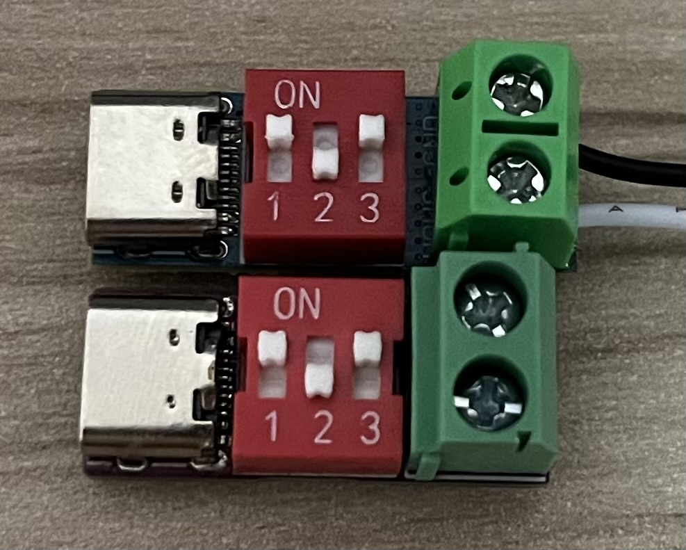

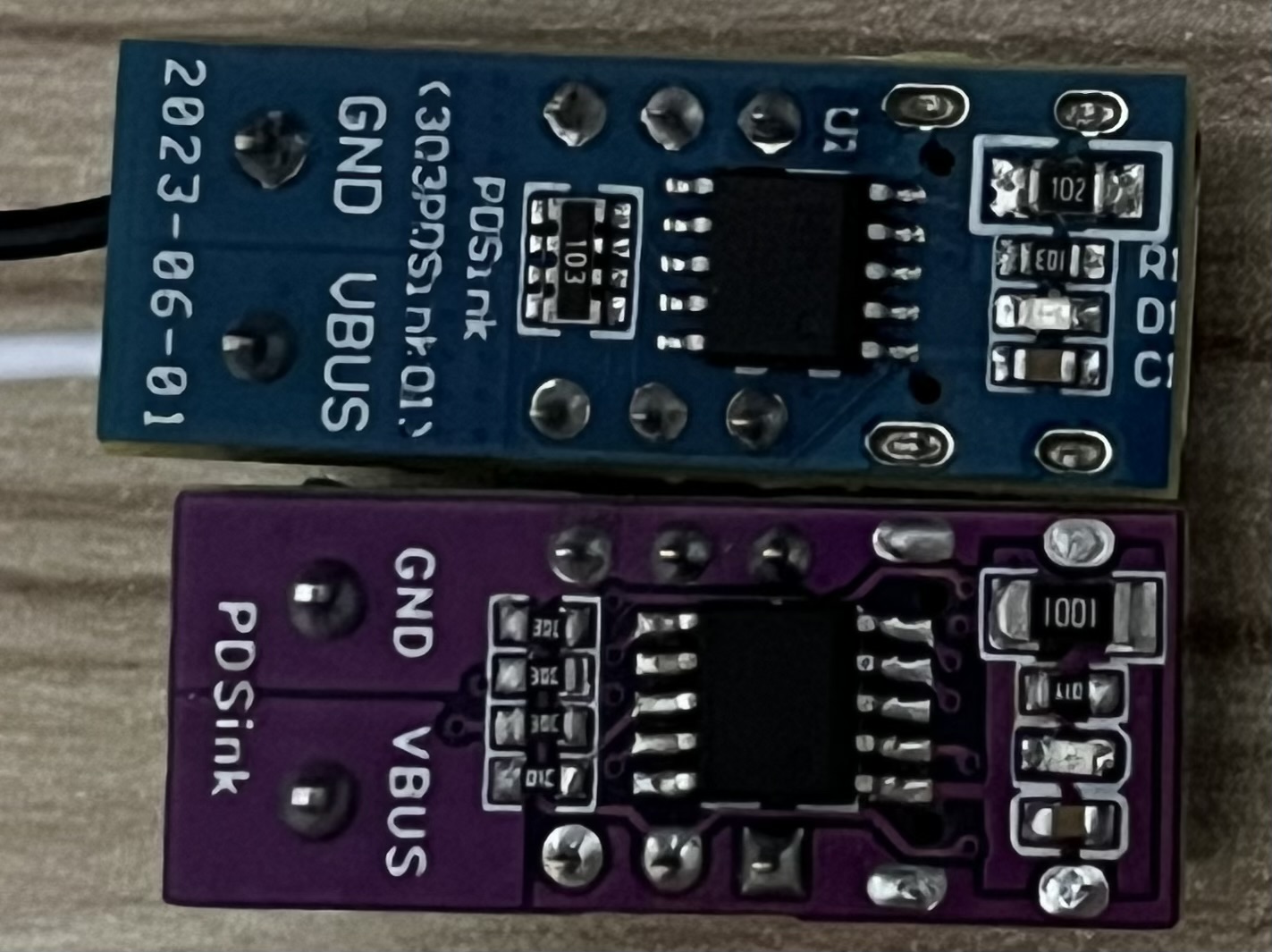

It boasts a very compact design, inspired by PDSink modules sold on Taobao (nearly 1:1 replicas; the top image below shows the module purchased from Taobao, and the bottom image shows the module soldered in this project).
The 1K resistor for VDD power supply uses a 1206 package (consistent with the official verification board), and the copper foil on both the top and bottom layers of the pads is enlarged to enhance heat dissipation (actual heat generation is significantly less than that of the Taobao purchase). Instructions
CFG1 corresponds to DIP switch 1;
CFG2 corresponds to DIP switch 2;
CFG3 corresponds to DIP switch 3.
Flipping it down results in 1, and flipping it up results in 0.
A successful decoy will illuminate the LED (if the LED does not light up, check if it is soldered backwards).
