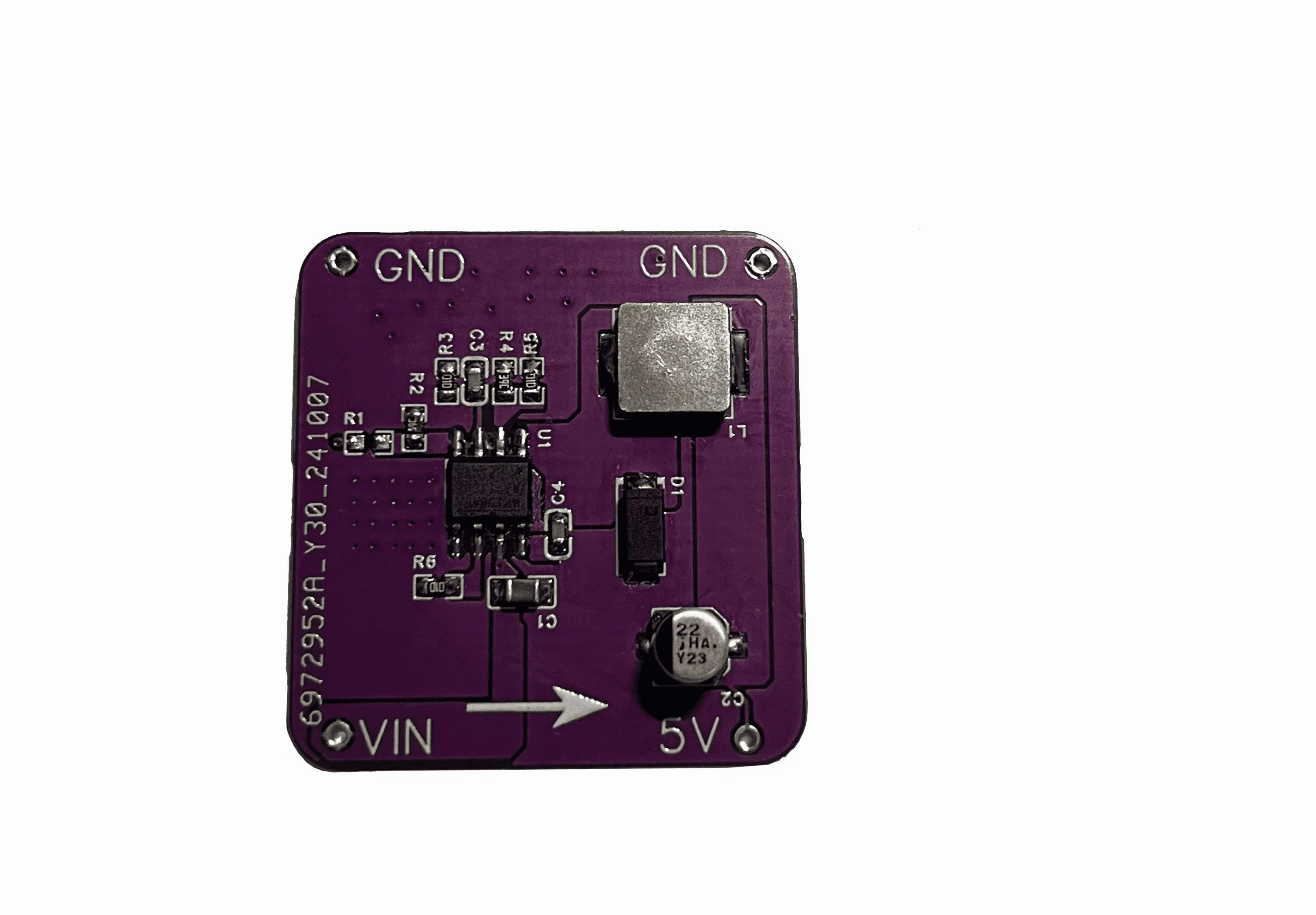

MP1584 step-down module - 5V output (verified)
For circuit design, you can refer to this article
: 5V Output Circuit Design - CSDN Blog.
The output voltage is changed by altering the value of resistor R1; the specific formula is mentioned in the article. R1 is not shown in the picture because the wrong resistor was purchased. Soldering a 10k resistor resulted in a stable output of 0.99V, conforming to the formula
. Changing the resistor to 210kΩ resulted in a stable 5V output, which has been verified.
