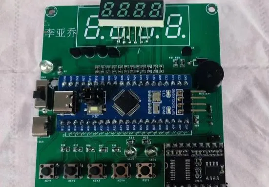

Project Overview:
This project is based on a 32-core board + baseboard temperature and humidity alarm expansion board. The temperature and humidity alarm expansion baseboard uses a DHT11 temperature and humidity sensor, voice control via an ASRPRO module, a 4-digit 0.56-inch common cathode digital tube, a buzzer, a power indicator light, and two temperature and humidity mode indicators.
Project functions
include increasing the threshold temperature via buttons and voice control
of project parameters
. Project Instructions:
LED1: Power indicator; LED2:
Temperature mode indicator;
LED3: Humidity mode indicator
; KEY1: Single click: Temperature mode;
Double click: Set upper and lower limits for temperature alarm;
KEY2: Single click: Humidity mode;
Double click: Set upper and lower limits for humidity alarm;
KEY3: Alarm value +, valid in alarm mode;
KEY4: Alarm value -, valid in alarm mode;
RST: Reset mode.

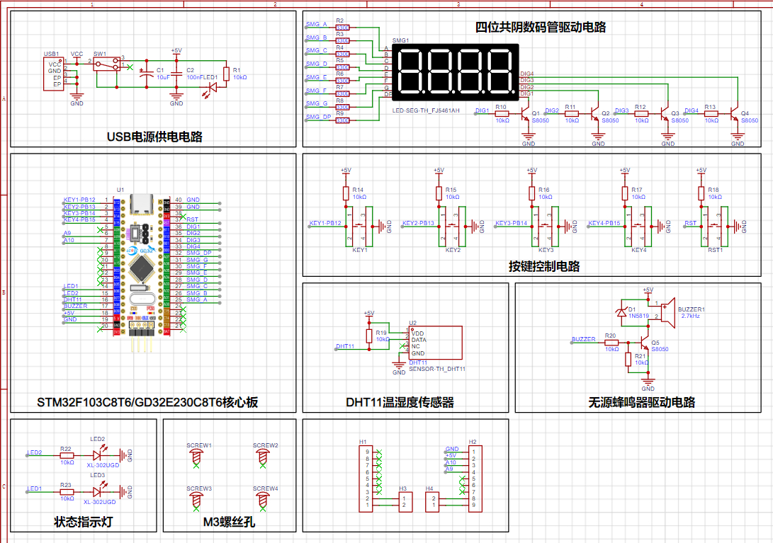

Principle Analysis (Hardware Description)
and Precautions:

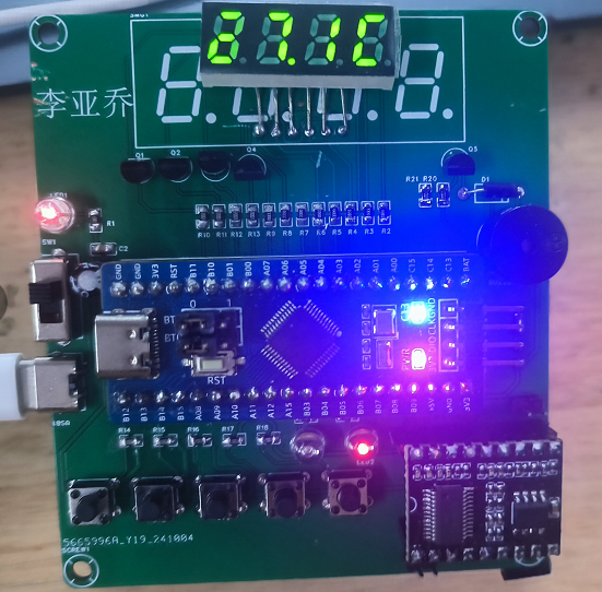

During the debugging process of the assembled board, a problem arose where the digital tube did not display anything,
while other functions such as buttons and LEDs worked. A multimeter test showed that the high and low levels of the pins were normal. Further investigation revealed that the supplier had sent a common anode digital tube instead of a common cathode one. After replacing it with a correctly packaged common cathode digital tube found at the supplier's facility, the display worked correctly. (
Image of the actual product)
