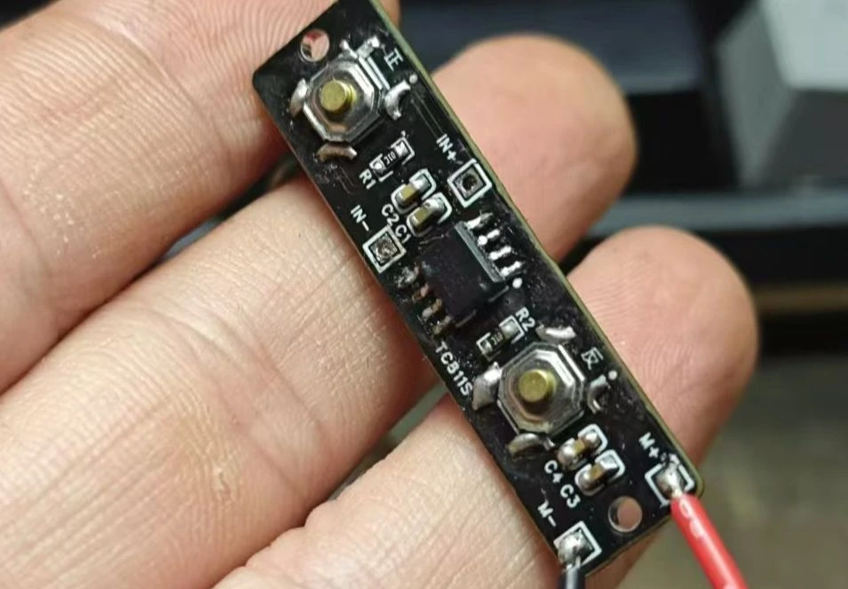

DC motor forward and reverse control board based on TC118S low current
The TC118S datasheet specifies a maximum continuous output current of 1.8A and a peak current of 2.5A.
During testing, it operated normally with a geared motor powered by an adjustable power supply at a current limit of 1A.
