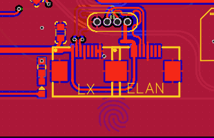

The fingerprint module also supports multiple modules, including Lenovo Goodix, Lenovo Synaptics, and Elan (all have reserved interfaces on the PCB board). The fingerprint modules natively support Windows Hello without any extra settings.

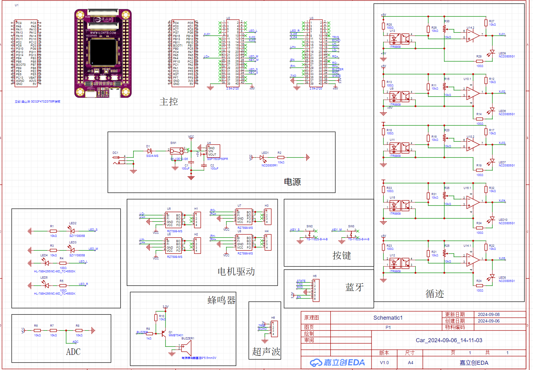

: 1. The first problem was not being able to find the corresponding schematic for each component when drawing the schematic. This stumped me for a long time until I searched online this morning and learned that components can be packaged themselves, which solved the first problem
. 2. I used too many vias during routing. I feel my component placement is still problematic and I should pay attention to this issue
. 3. The difficulty lies in writing code. I can write individual low-level drivers, but once they are integrated, it becomes difficult and I'm completely lost. I can only look at how LCSC (Lixin Technology) writes them. I feel my comprehensive thinking is still lacking, and I should cultivate meticulous logical thinking.
4. The soldered boards look terrible; I need to practice how to solder more neatly.
5. I thought the Bluetooth host computer would require Android. Written in Studio, I didn't expect it to be directly graphical programming.
The simple demo video
has many functions, and I'm still fixing bugs.
Principle analysis (hardware description):
This project consists of the following parts: power supply, LED lighting, main control, ultrasonic circuit, Bluetooth, line tracking, ADC, and buttons.

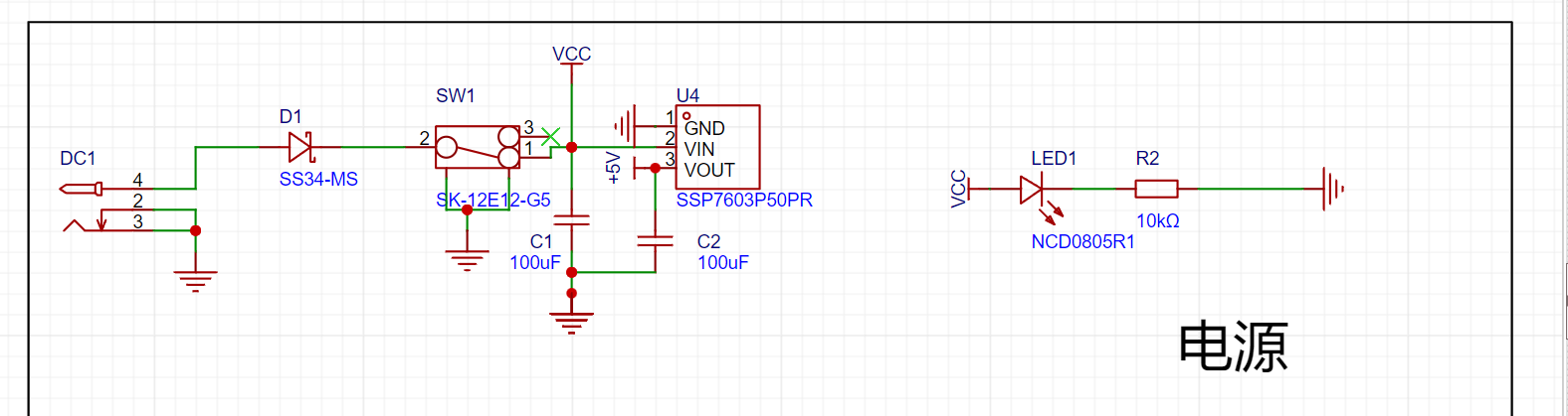

1--Power supply circuit:

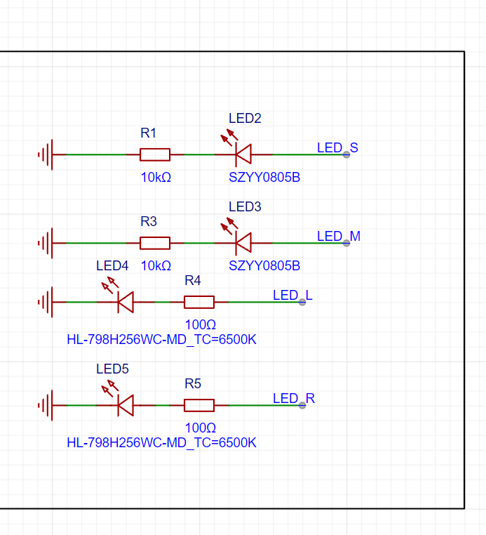

2--LED

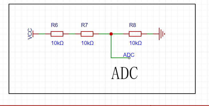

3--ADC

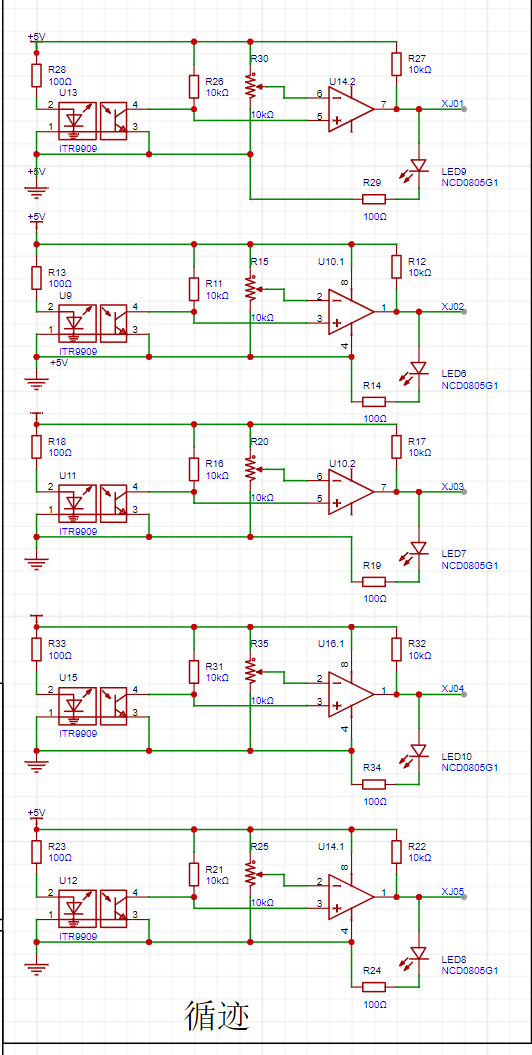

4--Line tracking

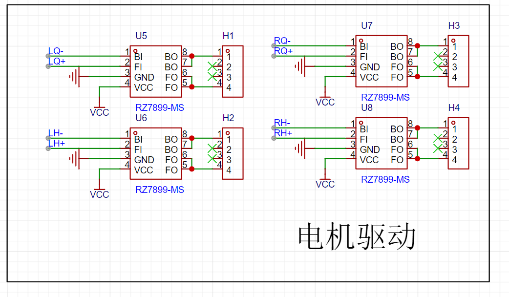

5--Motor drive

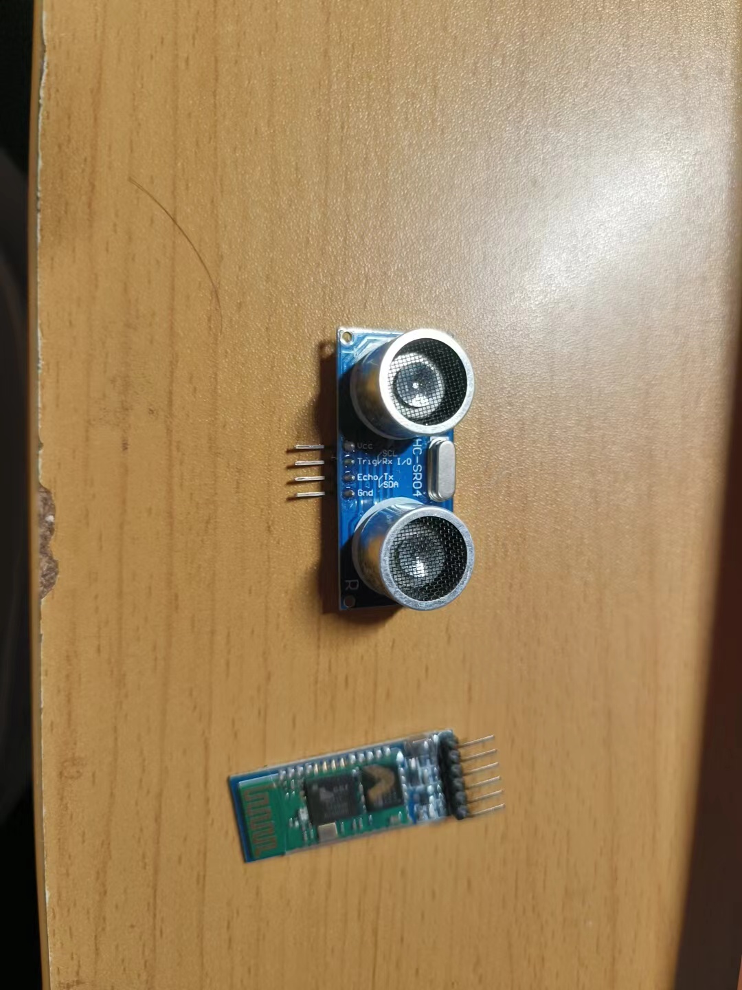

6--Bluetooth and ultrasonic
circuits (these two are ready-made modules).

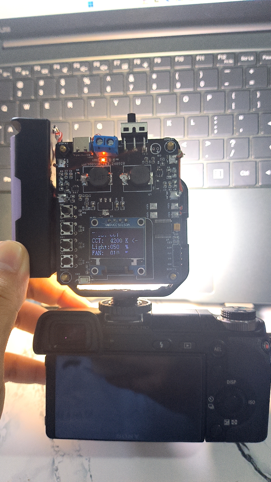

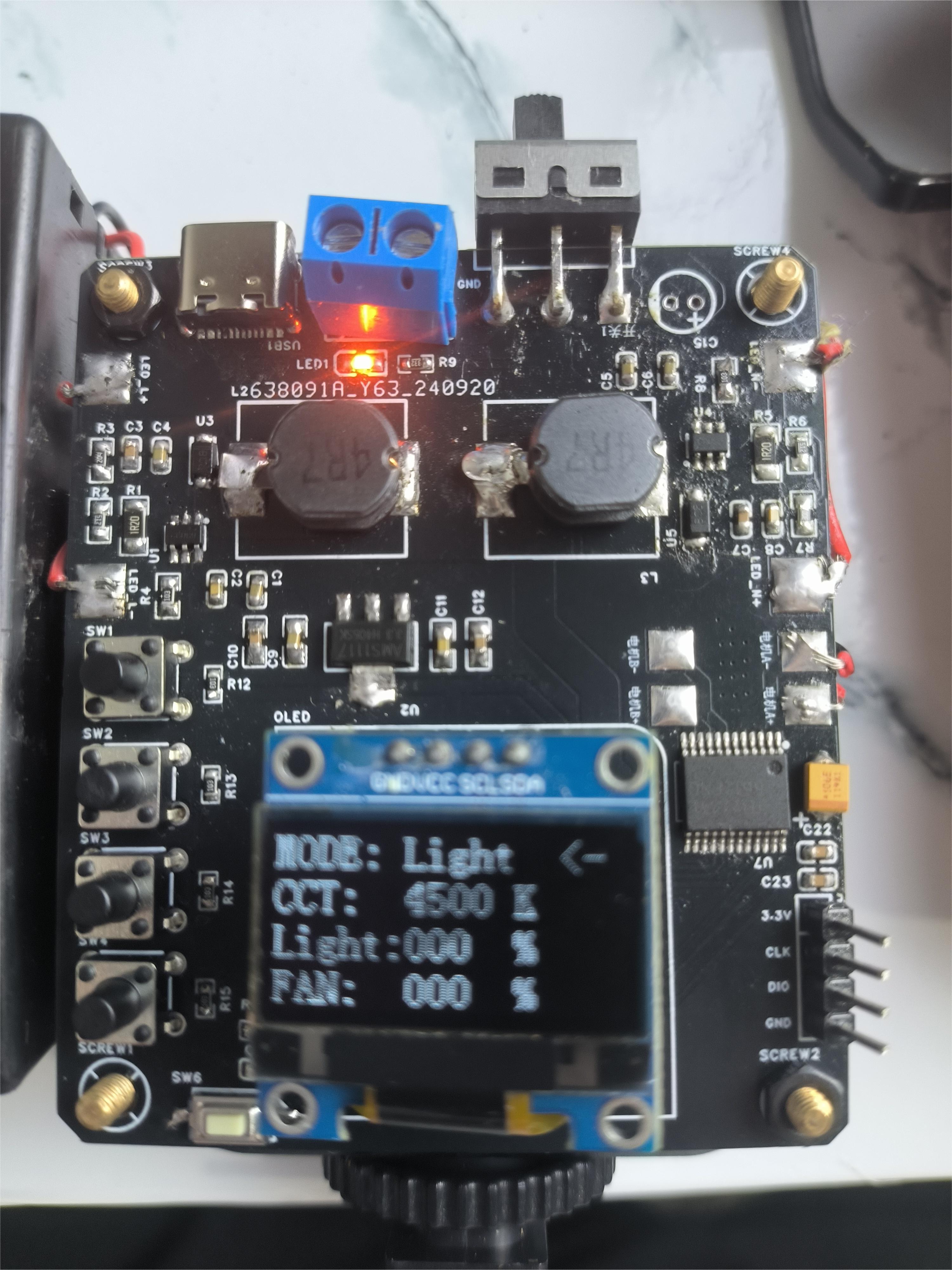

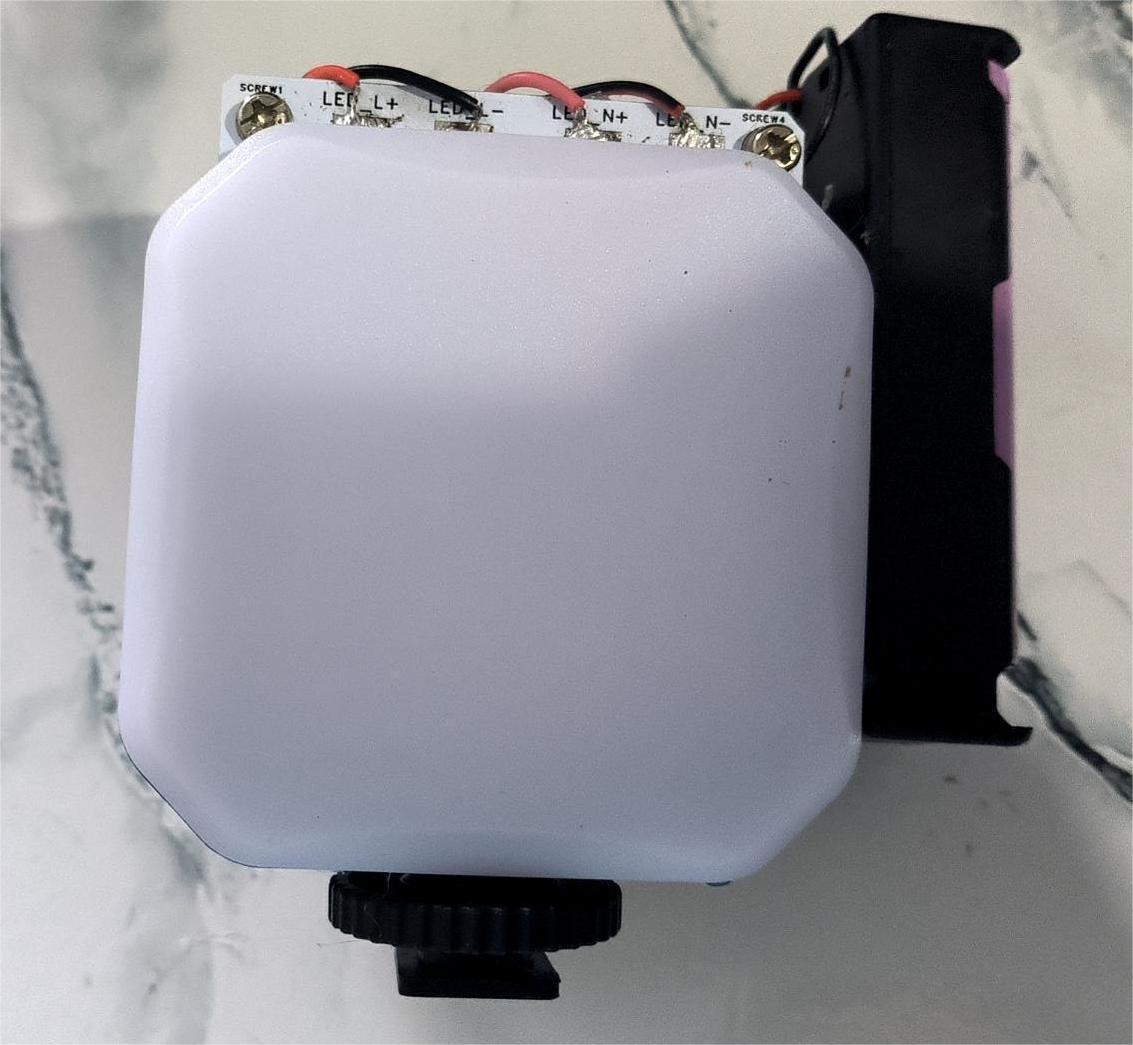

STM32-based fill light
The STM32F103C8T6 is used as the main controller, and the constant current driver chip is the LGS6303X.
Project Overview:
This project is a fill light based on the STM32F103C8T6 microcontroller. It uses the LGS63032 boost converter constant current driver chip and has an onboard TB6612 chip to drive two fans for heat dissipation.
Project Functions:
This fill light design is based on the STM32F103C8T6 microcontroller. It features four independent buttons with functions for up/down selection, and increase/decrease settings, allowing for color temperature adjustment, brightness adjustment, and fan speed adjustment.
[Image]

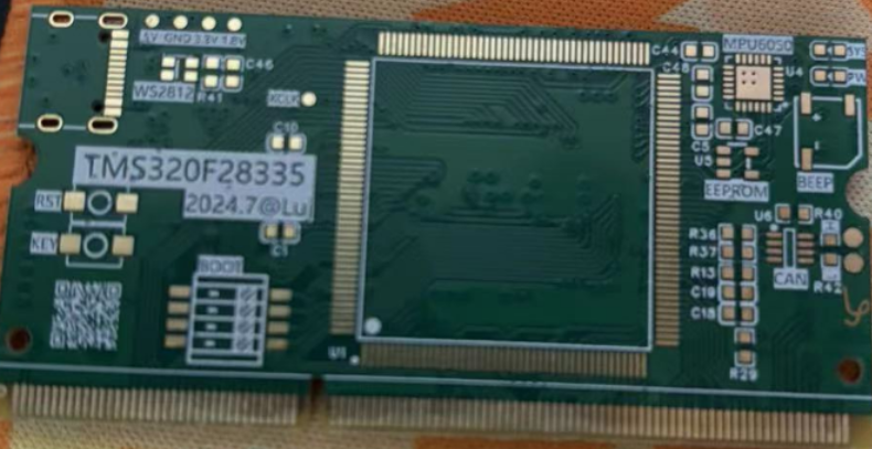

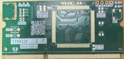

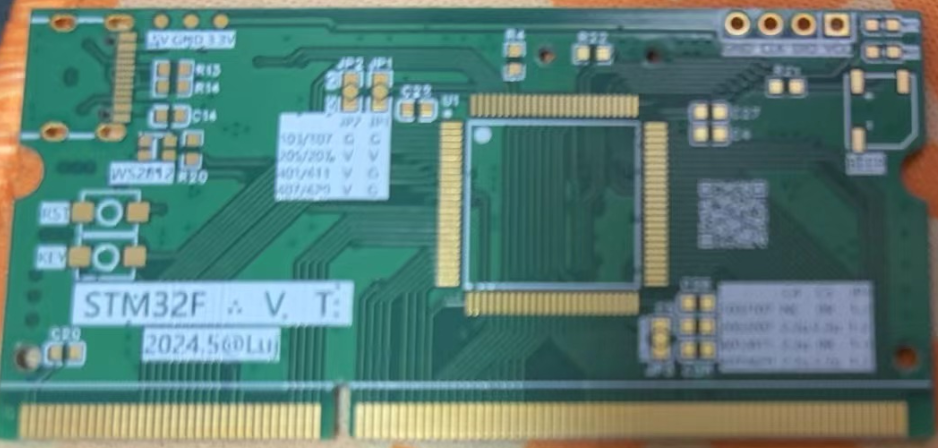

Project_DDR3 Core Board
The core board is manufactured using DDR3 dimensions. Subsequent core boards will use various mainstream MCU layouts with different core boards, including STM, GD, DSP, PIC, ESP, etc.;
it is used in conjunction with the IO expansion board, with all the IOs of the core board brought out.
Onboard modules include TYPEC, EEPROM, SPI FLASH, SRAM, MPU6050, WS2812, buzzer, and buttons; board
thickness 1.0mm, immersion gold finish; compatible with STM32F103Z and STM32F407Z chips via jumpers;
suitable for use with DDR core board I/O expansion board.
