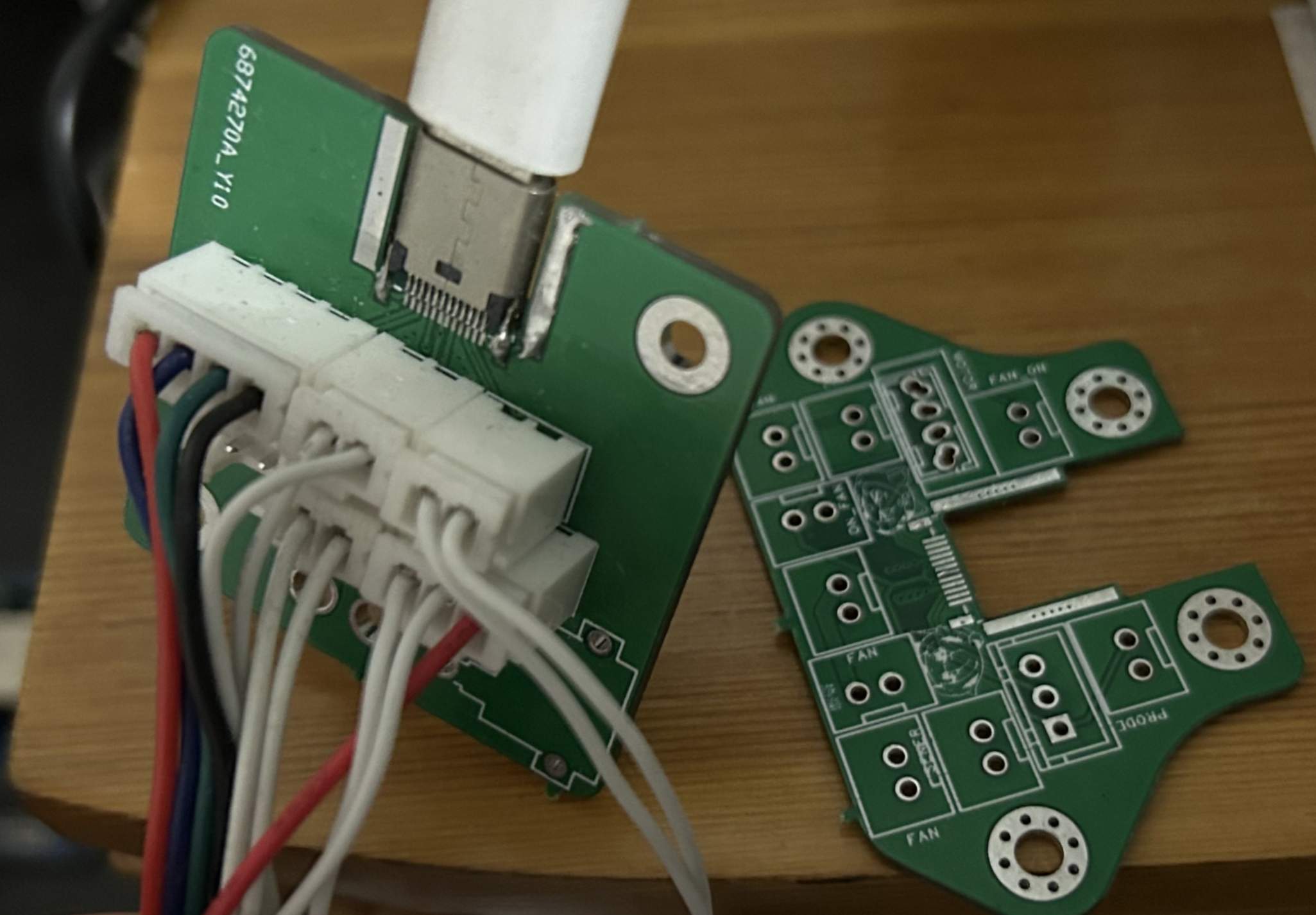

TYPE-C hub board 36 motor
TYPEC hub board
requires full-function typec cable 16p cable Xianyu 13.9 Dell 1.8m 16 Luxshare Huawei 1m
updated to V3
interface (3)
one thermistor
one heating port
one 3P limit (+2P limit)
two channels three adjustable fans
two normally open fans (- one)
one 2.54/2.0 motor position (2.54 only)
(+ one USB)
Please use the same serial number to make board
1/3 clamp board making board thickness 0.8 or 1mm see clamp board TYPEC size
2 no special requirements
3 can be matched with USB devices
[3D printer 36 motor TYPEC hub board open source - Bilibili] https://b23.tv/6dNHC7A
https://www.bilibili.com/video/BV1Si421R7Rv
Version 1/2/3 fixes the problem of burning emarker, adds one adjustable fan
3 Added one limit switch and one USB cable
24/8/25: Updated PCB labeling, updated schematic
24/9/23: Updated schematic, switched I2C to USB
