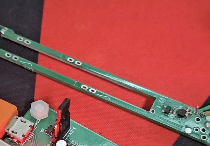

I directly replicated a T12 soldering iron using an open-source solution found online (https://github.com/wagiminator/ATmega-Soldering-Station), specifically version V1.7. The
existing sleep mode implementation using Arduino employs a vibration switch to detect handle vibration, with the main program supporting a minimum time of one minute.
This one-minute inactivity timeout seems excessive to me, and the vibration switch isn't very sensitive.
Therefore, I designed a new soldering iron stand that is compatible with the original design. I added an STC8G microcontroller and an SC7A20TR accelerometer to the handle to detect its movement,
improving sensitivity.
I slightly modified the main program, adding a quick sleep menu, "QC Sleep Timer," which allows setting the sleep timeout from 0 to 60 seconds (0 for off).
This way, when you put the soldering iron down, it quickly enters sleep mode after the set number of seconds.
Principle: When the sensor in the handle detects movement, the microcontroller inside the handle repeatedly changes the level state of SW to notify the main controller.
Arduino uses ISP to program and write the EEPROM without erasing (retaining) the file
SolderingStation2_u8glib_v1.7.ino.hex without erasing the EEPROM

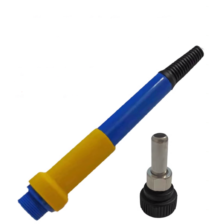

1. One blue handle as shown in the picture (you can buy the handle separately (two parts shown).

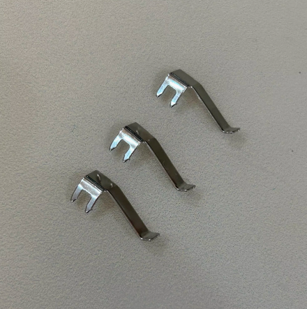

2. Soldering iron contact springs

electronic components according to the PCB diagram : Please refer to the STC official documentation. Use a USB to serial port tool to connect to the TX and RX pads reserved on the bracket PCB, and ground the program from the GND pad. This will allow you to successfully program the SC7A20TR rack-mount sleep program. (hex gamepad test video)
