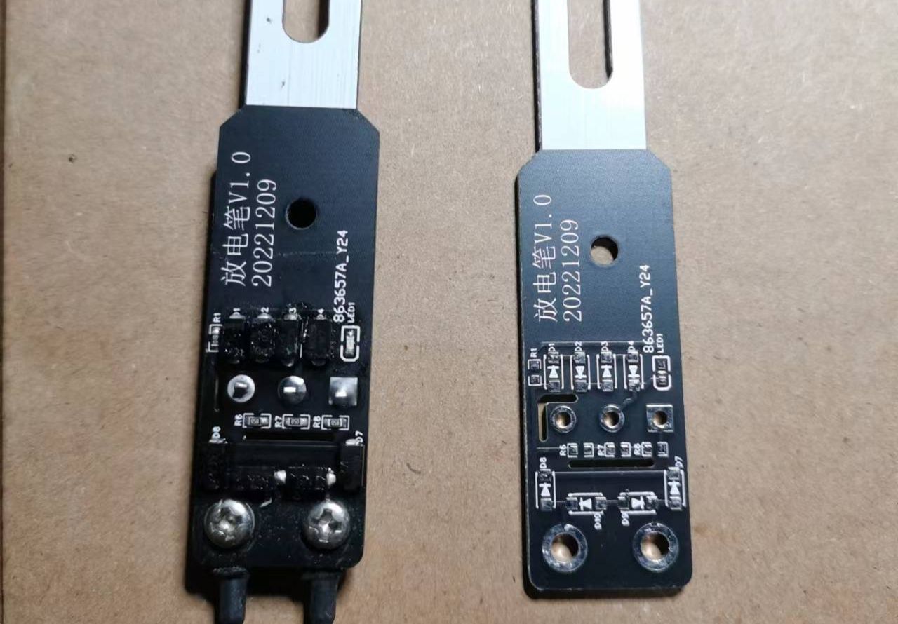

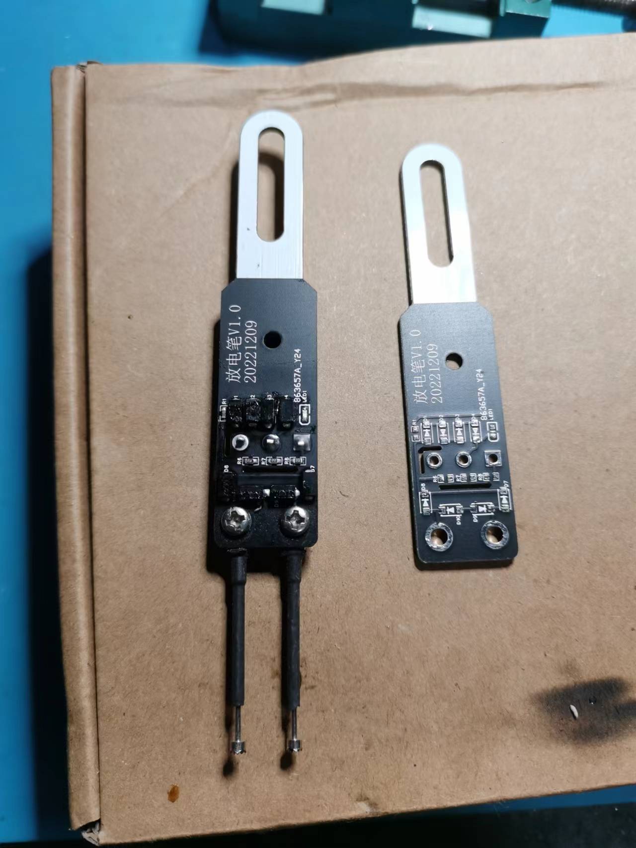

Electric discharge pen (verified)
1000V internal capacitor discharge
