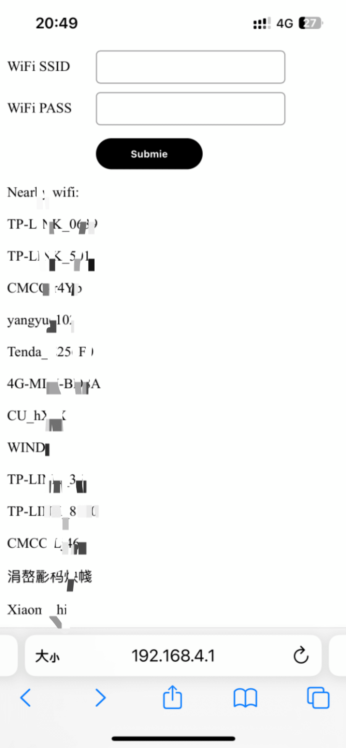

1. Implementing the `WEBService`: This service is used for network
configuration, configuring the homepage to scan surrounding network SSIDs
, configuring a page service to connect to the SSID, and enabling ESP32 to connect to the corresponding network via the SSID

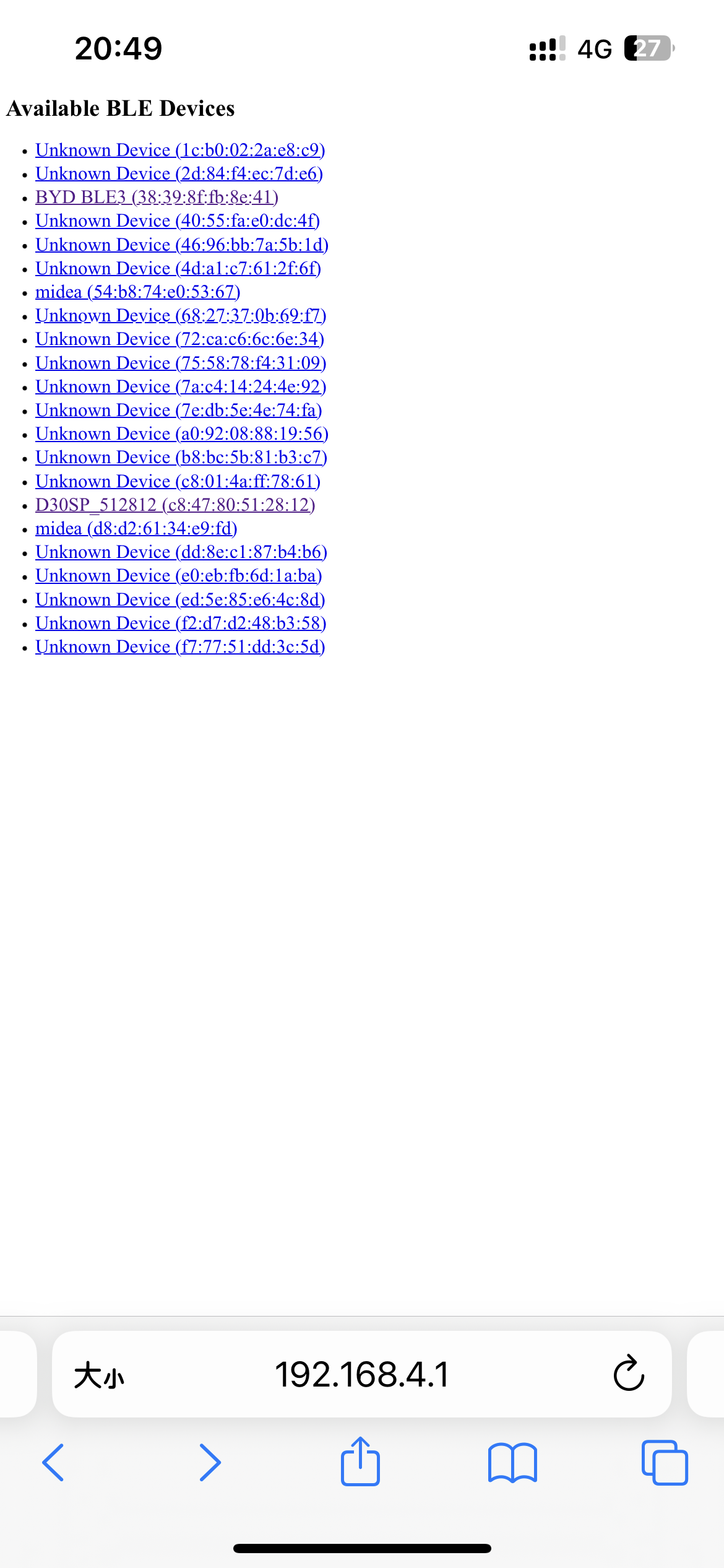

3. BLE
network : Through the `WEBService` configuration page, the scanned surrounding BLE devices are printed to the page
configuration page `/bleconfig`. The page receives the MAC address of the BLE module and enables the ESP32's Bluetooth to connect to that MAC address.

Wi-Fi configuration interface ,
Bluetooth configuration,

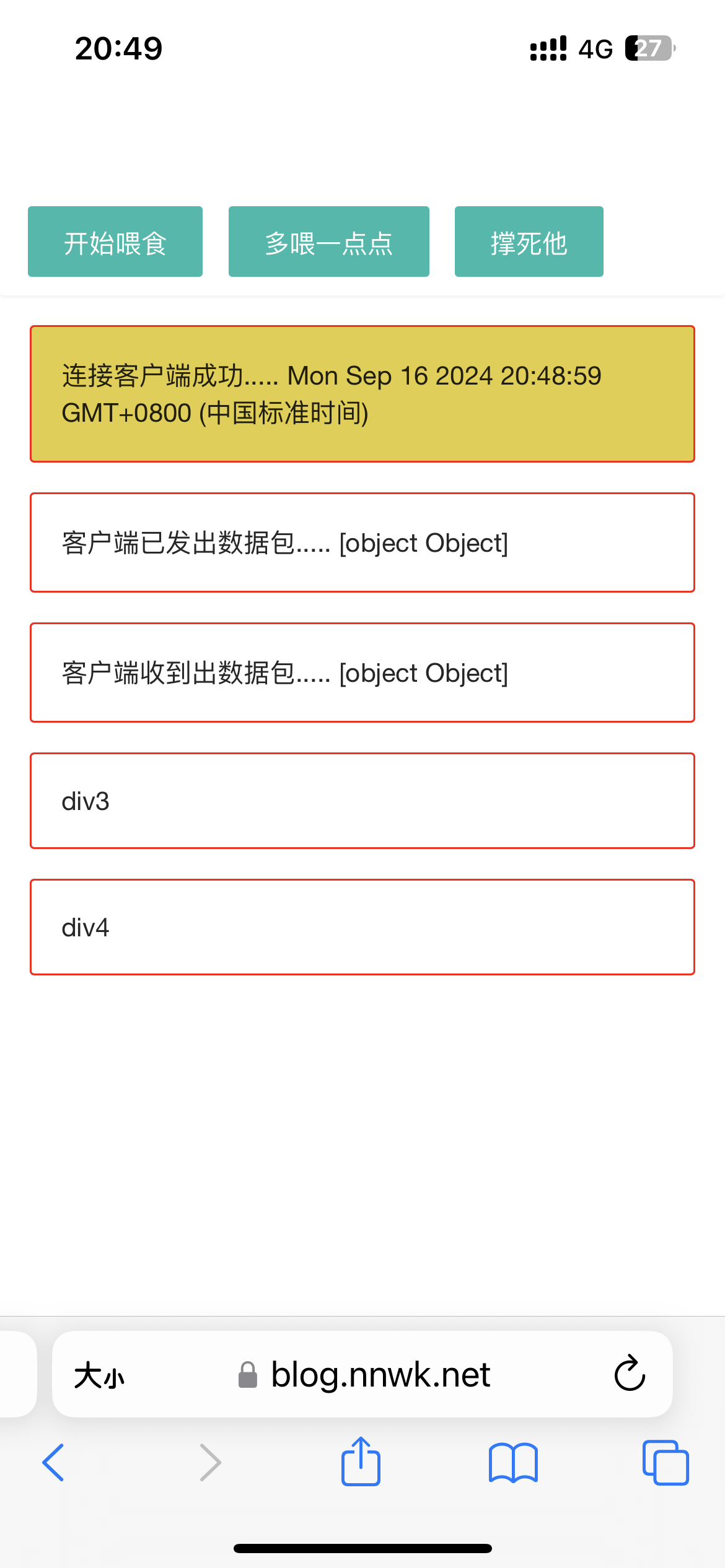

MQTT feeding,

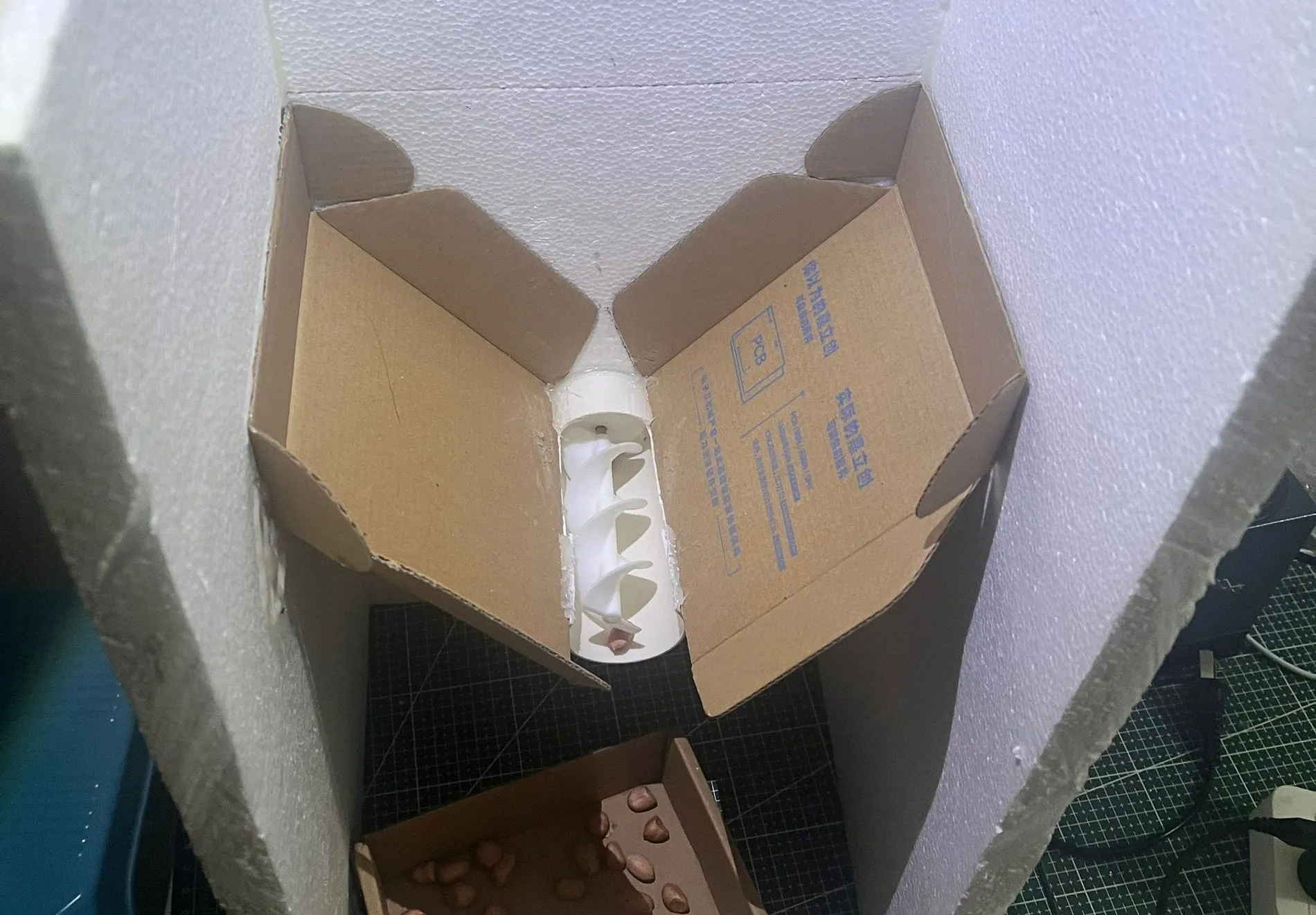

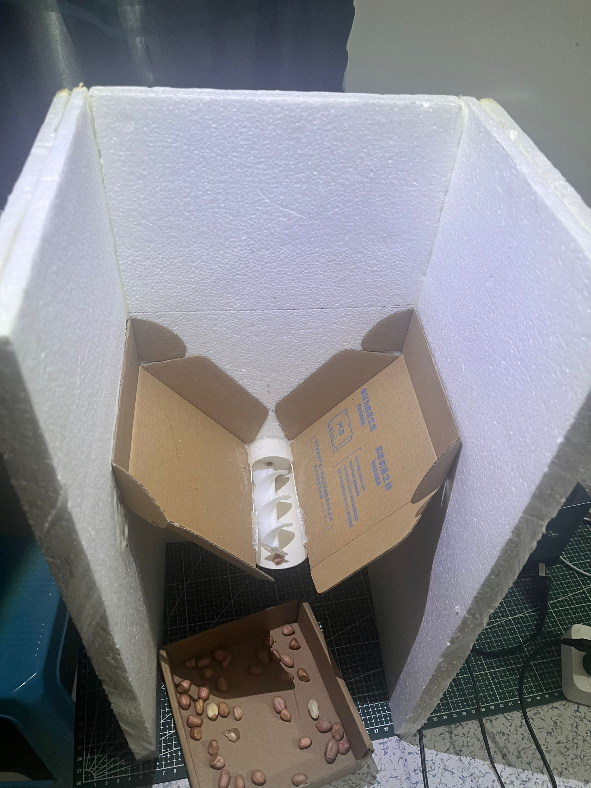

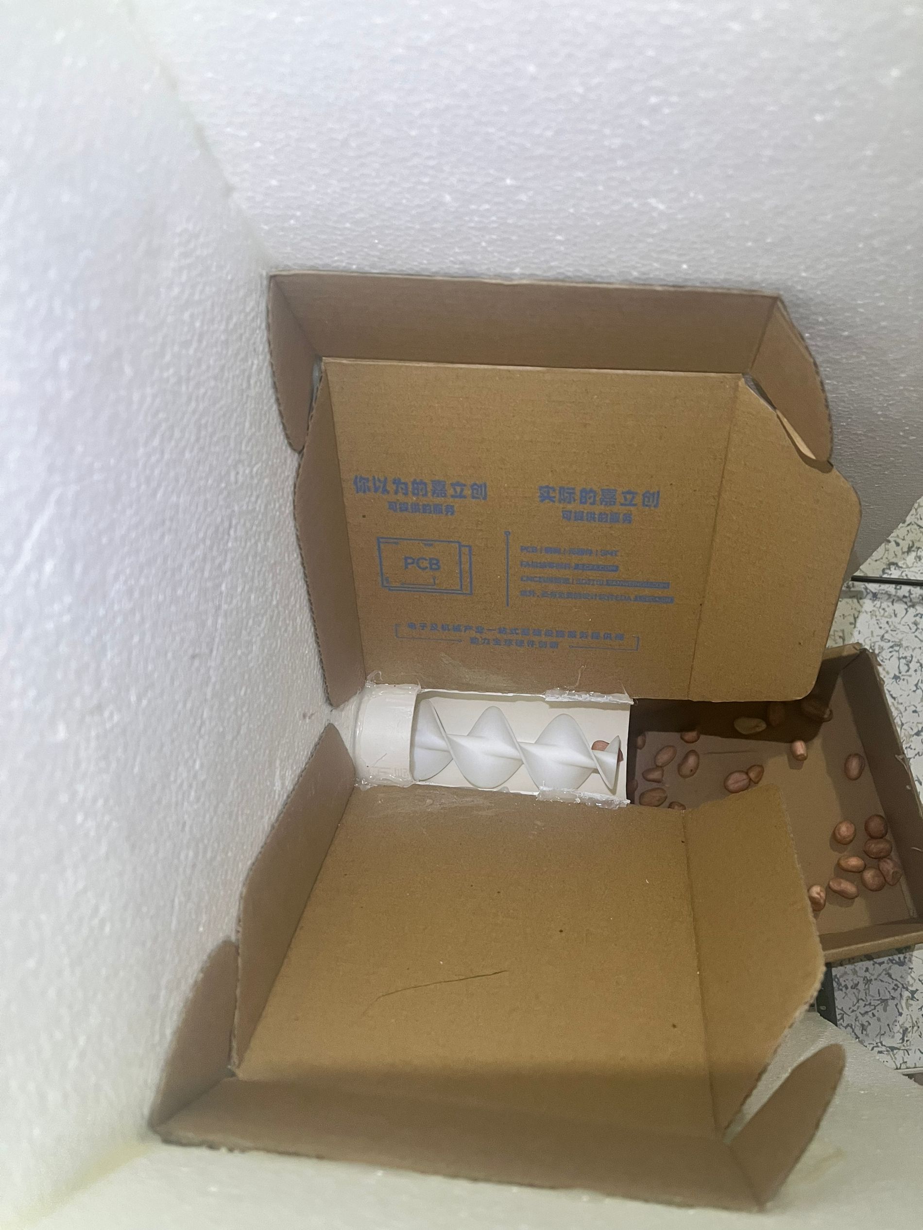

ugly framework,
JLCPCB's cardboard box, not to be wasted.
