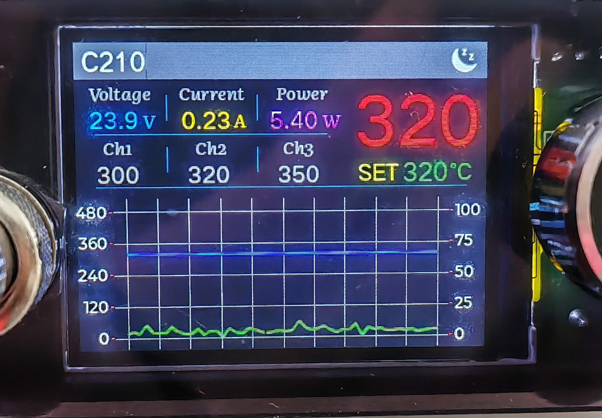

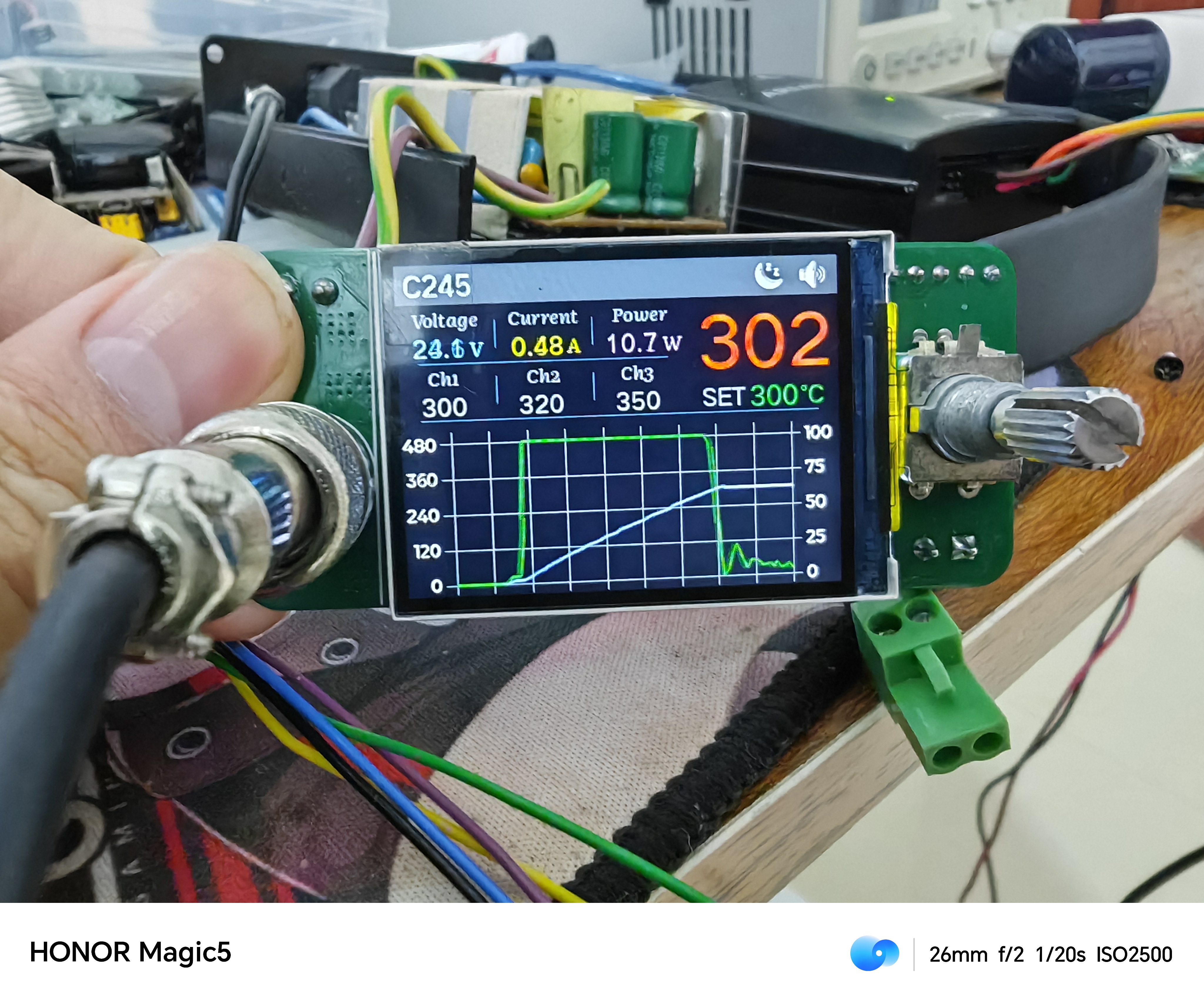

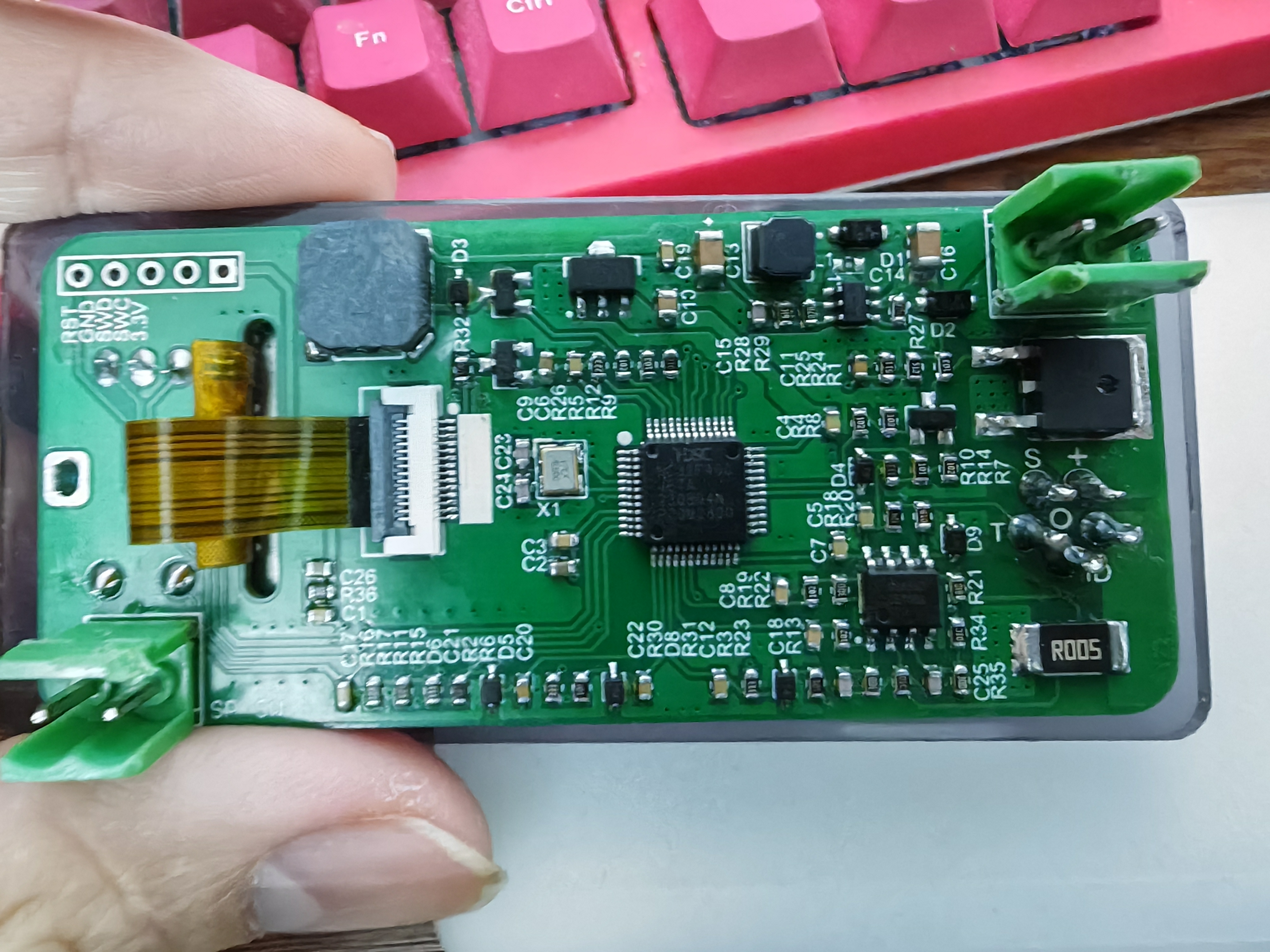

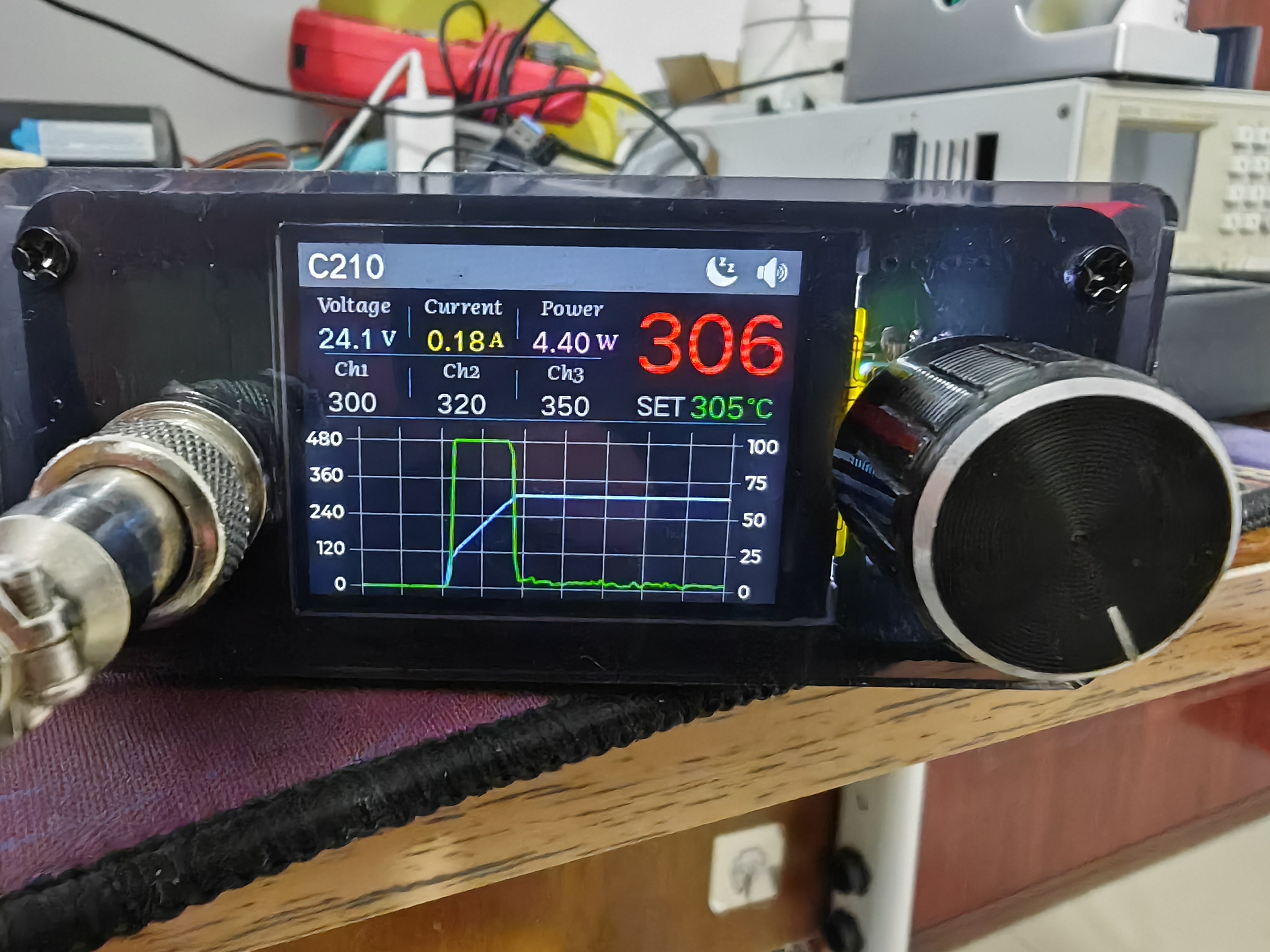

soldering station features:
            supports JBC245, JBC210, T12
            ; theoretically supports 2.0, 2.4, 2.8, 3.2 IPS, ST7789V2 SPI interface screen; 2.0 screen connection;
            JBC210 supports 24V power supply

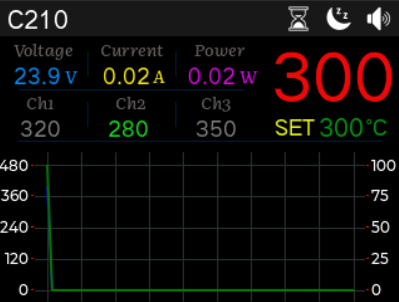

            ; real-time temperature and power curve display;

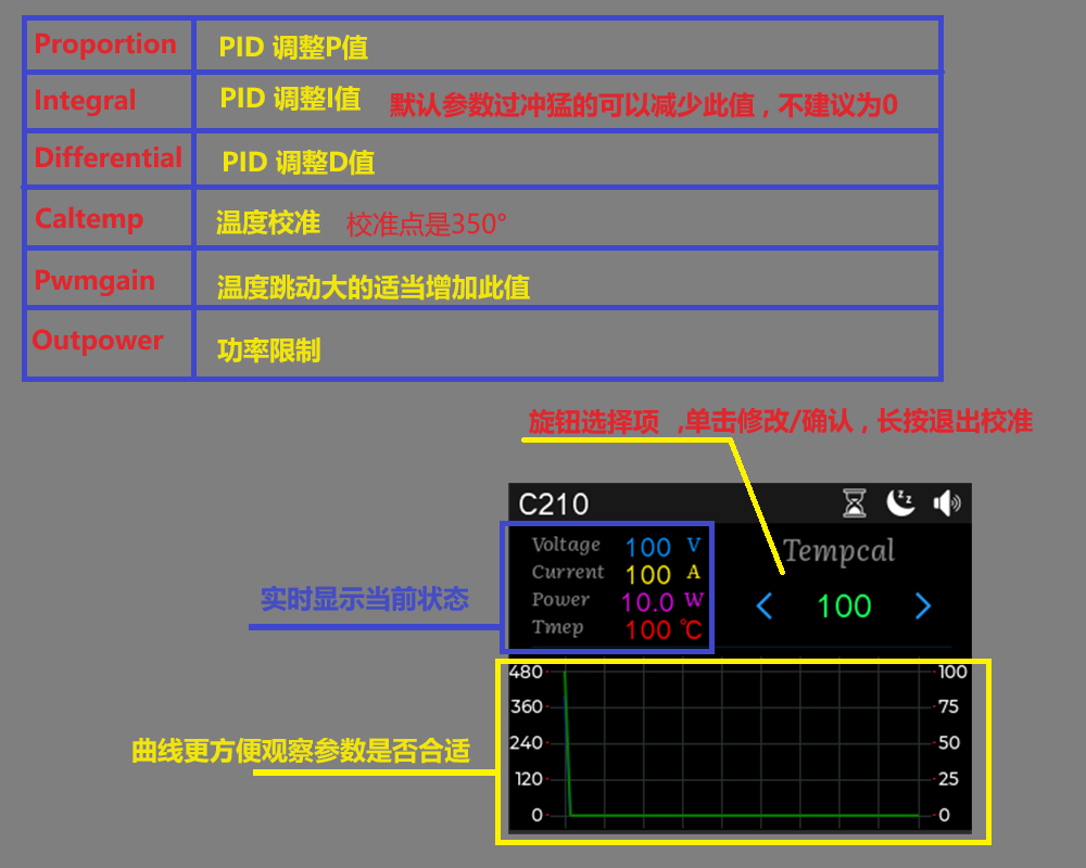

            full PID temperature control; supports custom parameters
            ; rapid temperature recovery
            ; current detection; overcurrent protection;
            visual calibration;

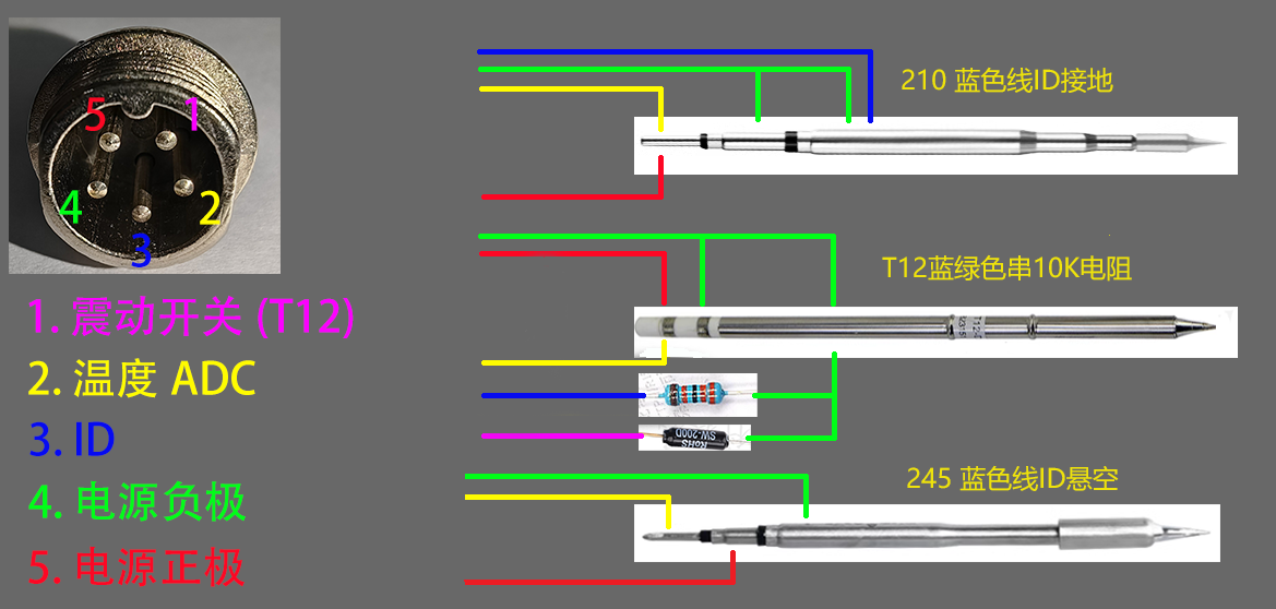

wiring diagram;
PCB is imported via AD. Those who want to use it for free should find their own way.
Update progress
  2023.12.18: Considering the AT32F403A is not cheap and does not include shipping, it has been changed to HC32F460JETA. Xiaohua had very little technical support and limited documentation, encountering many problems and severely impacting progress. Firmware is complete.) The final prototype included some I/O modifications. The goal is to
  release the first firmware update before Christmas, on December 22, 2023. The firmware will be programmed using J-Link; the official firmware is available for serial port download. I don't have the tools to test it, so this only guarantees successful programming via J-Link. Version
  2024.1.04 adds a white theme. The updated program can be found in the group
chat.

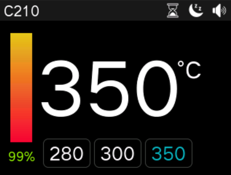

Two interfaces will be displayed.
