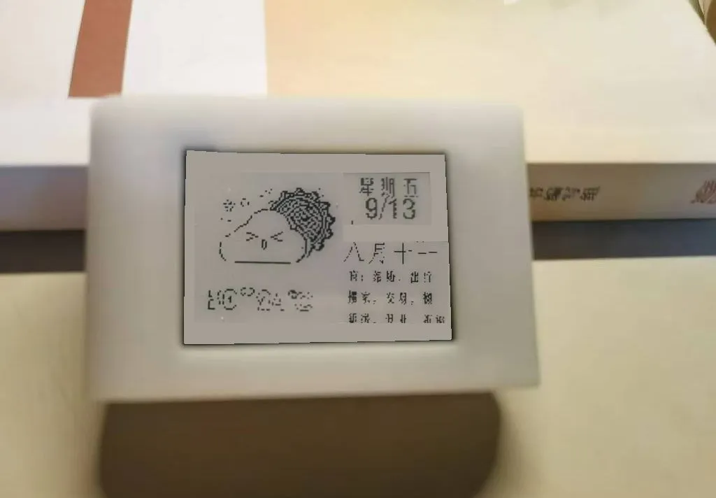

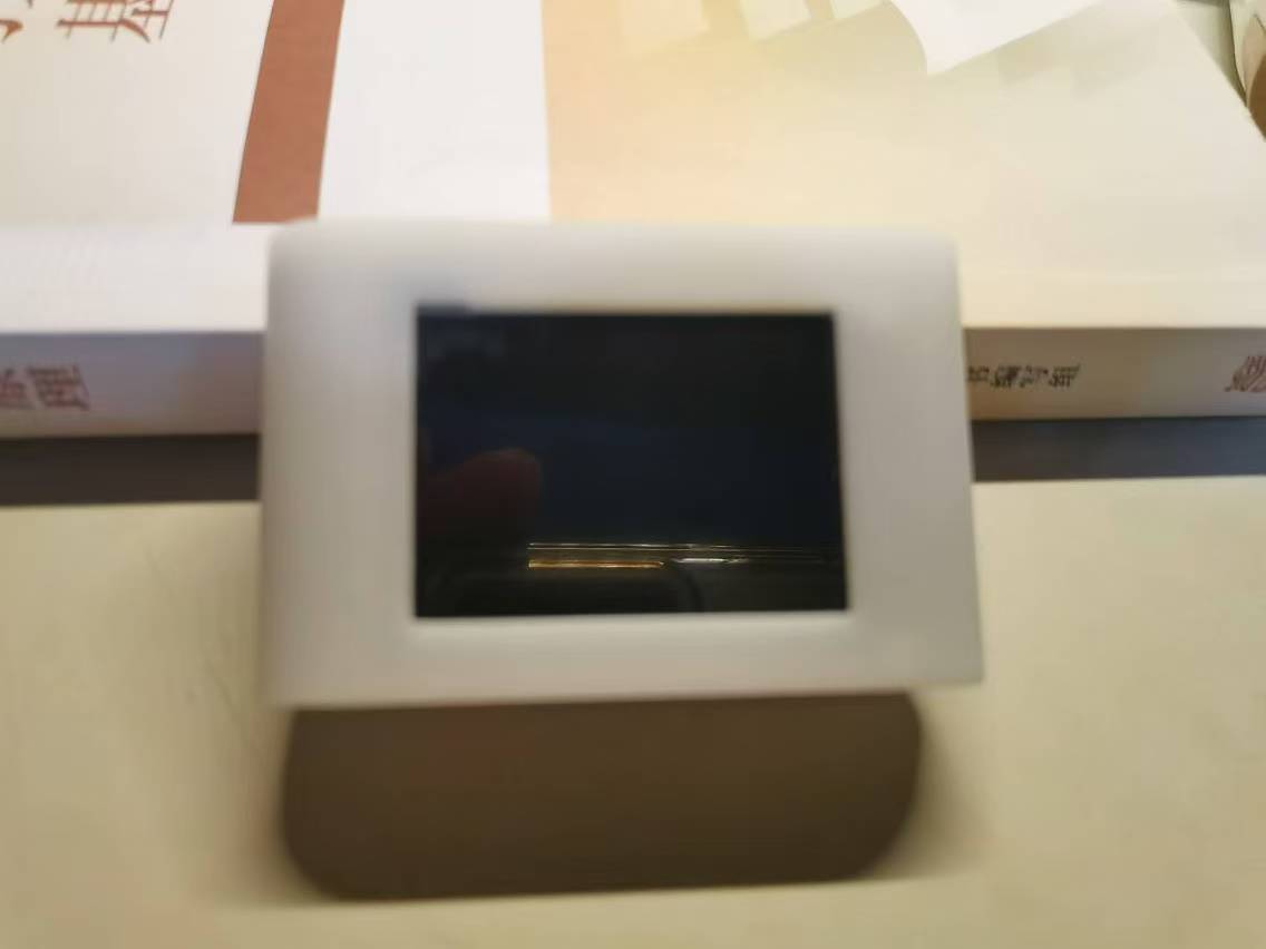

ESP_32 Desktop Ornament
Project Introduction:
This project is a desktop widget based on the ESP32S3R8N8 development board, featuring the ability to display weather temperature and images.
Project Functionality:
This design is a weather forecast system based on the ESP32S3R8N8 development board; it accesses the "Xinzhi Weather" platform via Wi-Fi to obtain weather information; it displays the current weather on the screen; and it uses the built-in MPU6050 sensor to switch interfaces.

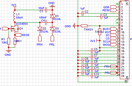

Principle Analysis (Hardware Description)
: Screen:
The connector used here is a 0.5mm 24P flip-type. Different screen models have different drivers; TXKG1 and 2 should be soldered according to their corresponding models.

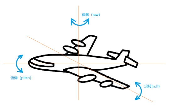

Control:
The MPU6050 can detect the current status in real time and trigger corresponding events by selecting appropriate parameter changes.
Weather Vector Icons: Sourced from the internet.
Software Code :
The code is from the ESP32S3R8N8 development board module porting section of the LCSC development board.
Link: https://wiki.lckfb.com/zh-hans/esp32s3r8n8/module/
Notes:
The 3D shell file is designed in LCSC EDA; it can be seen by opening the schematic.
The buttons can be selected according to your needs and the MPU6050 interface.
(Actual product image)
