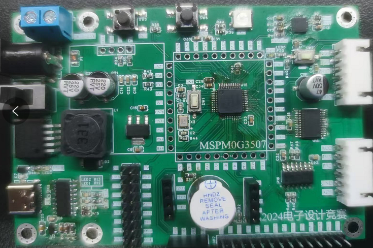

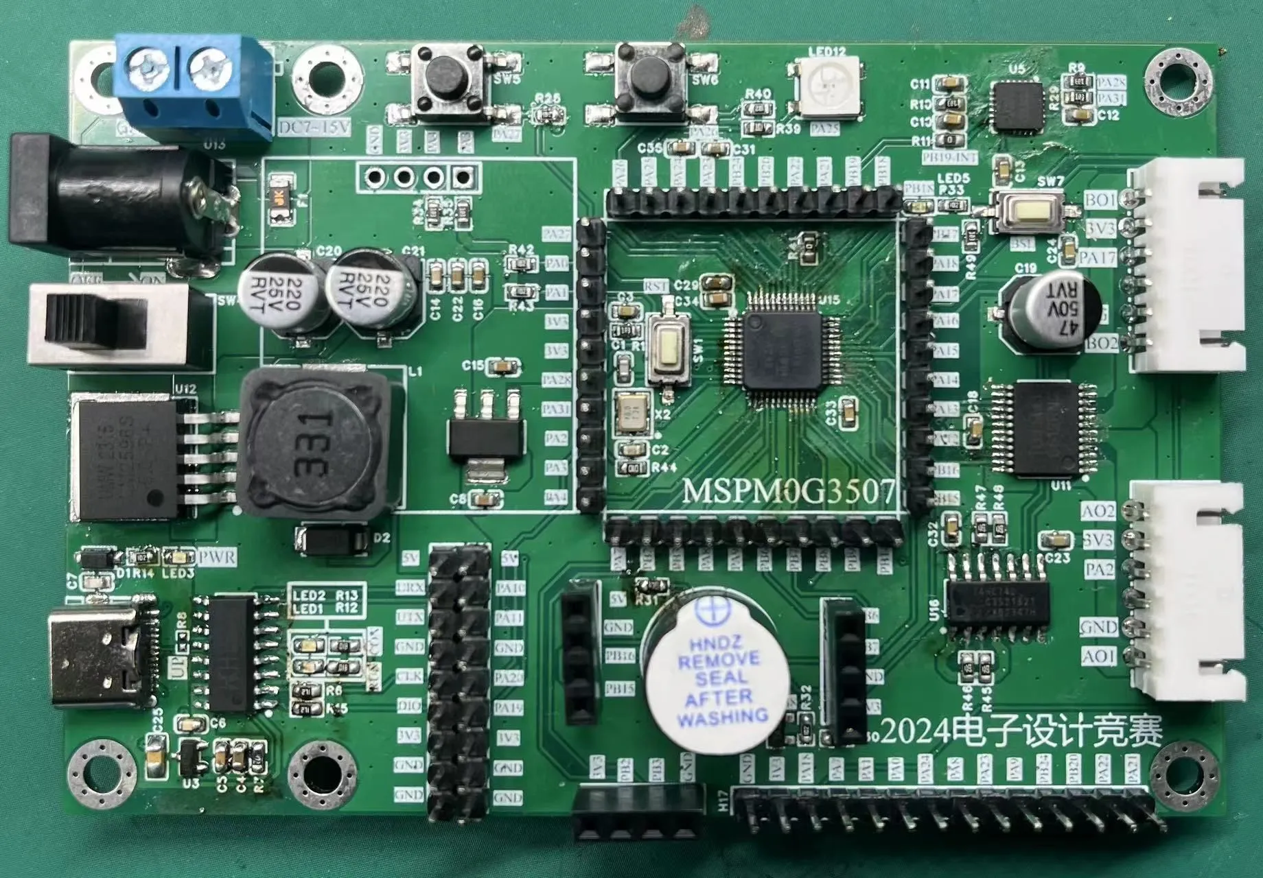

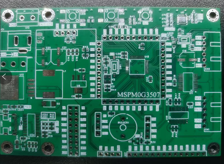

Introduction:
This project uses the M0G3507 48-pin chip. The board supports DAPLINK programmer for downloading and debugging programs, and supports wireless download and debugging serial ports. The board is equipped with peripherals including an HC-06 Bluetooth module, an OLED display, an MPU6050 gyroscope module, a TB6612 driver, and a 74HC74D bidirectional pulse counter. It basically meets the peripheral requirements of a basic car-themed project.
Post-soldering image:

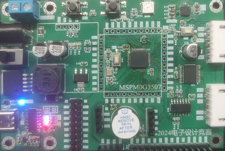

After power-on, DAPLINK firmware was programmed:
The DAPLINK programming test was successful. Subsequently, the serial port was debugged, and characters were printed normally in the serial port assistant, indicating that the board has been successfully debugged (see attached video for details).
