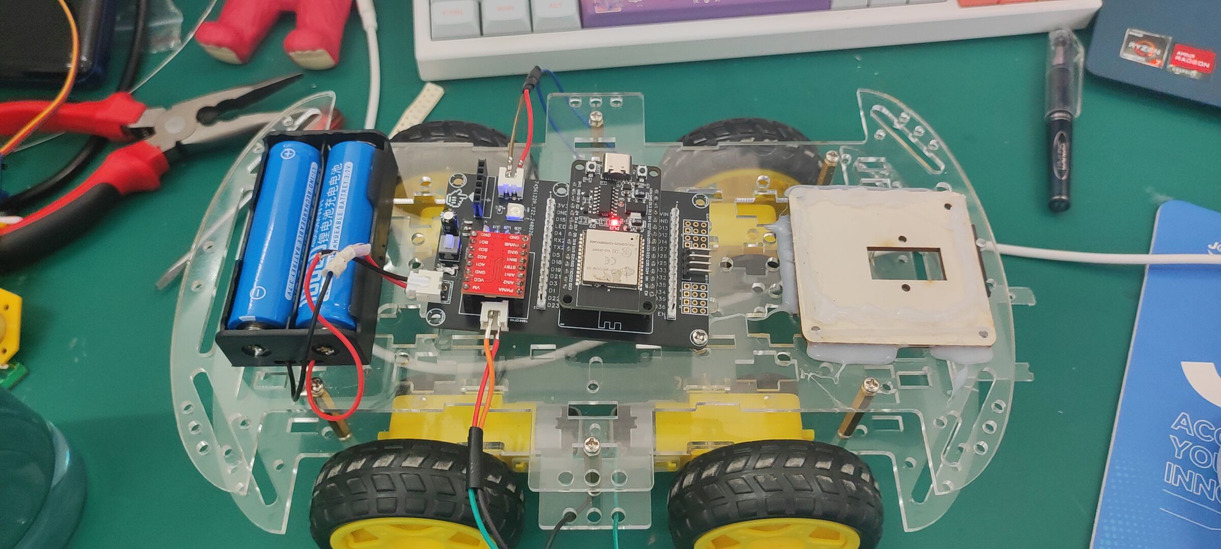

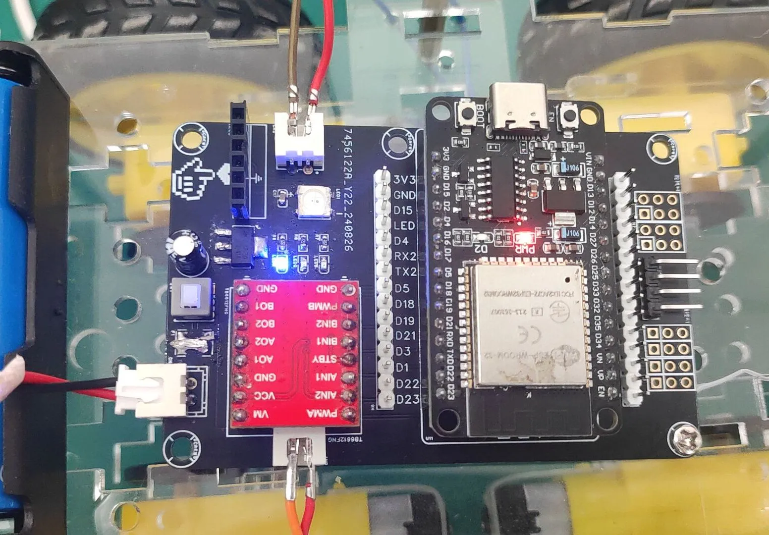

uses an ESP32 module as the main controller and
a TB6612FNG motor drive module. It
communicates with a mobile phone via Bluetooth through the ESP32 and
controls the car's movement via a mobile app. The car
includes a motion status indicator light, a buzzer,
and can be expanded with ultrasonic sensors, servos, cameras, etc.

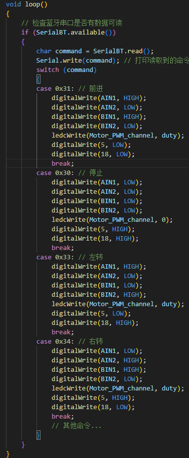

2. Key code:

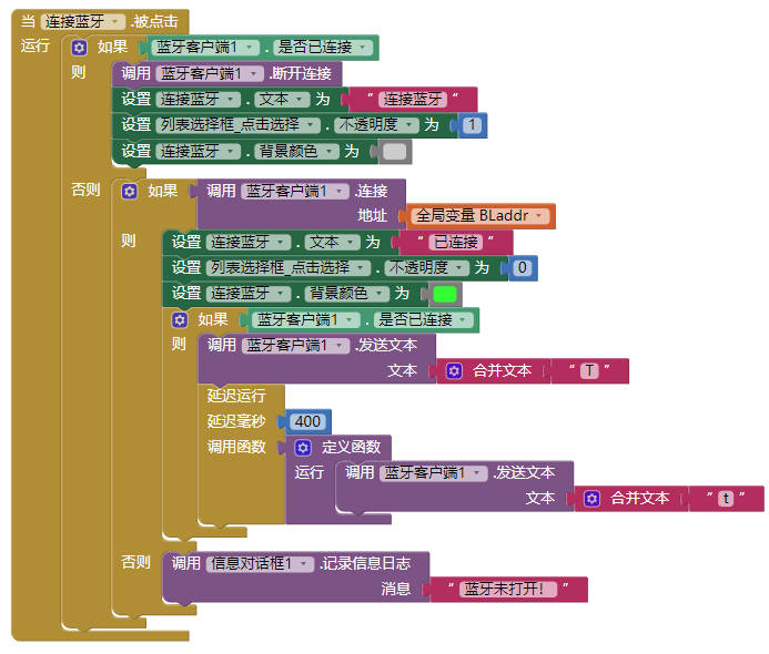

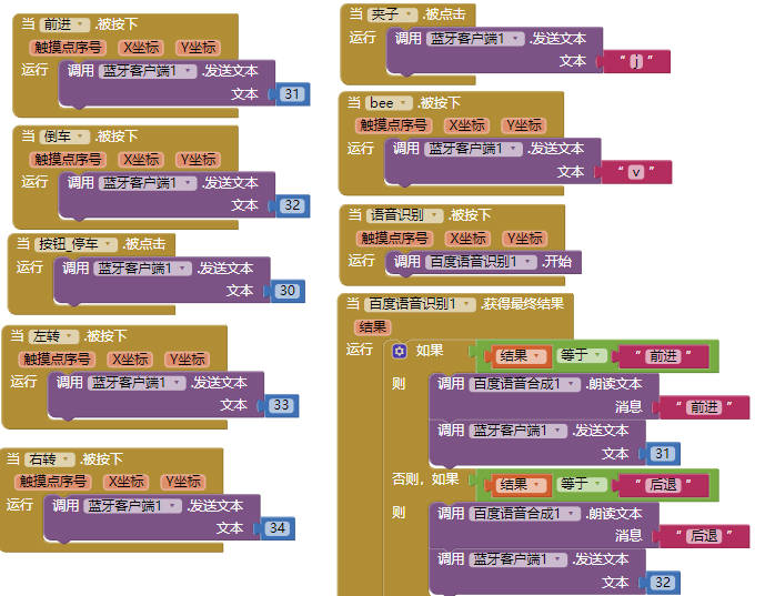

Mobile app section:

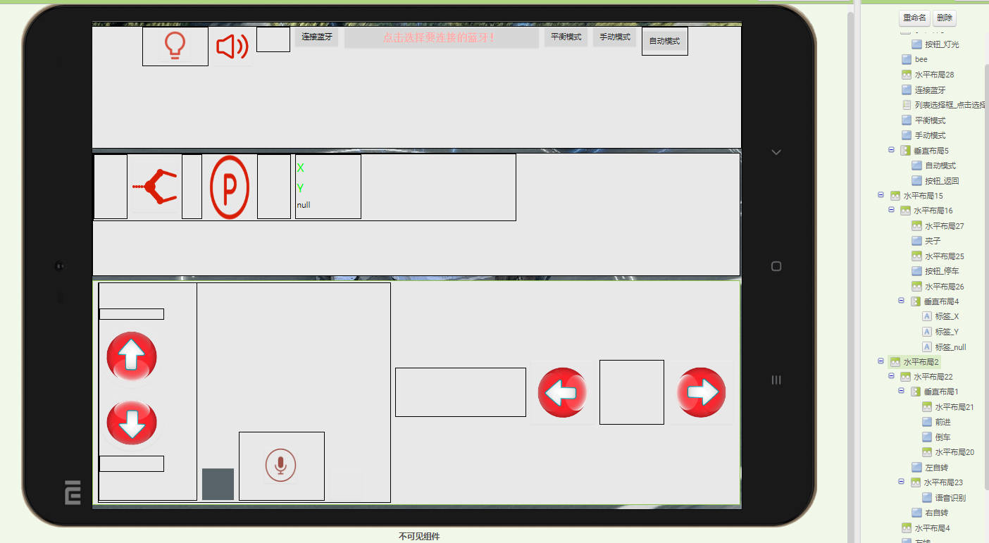

app interface
, button control,
Bluetooth connection.
