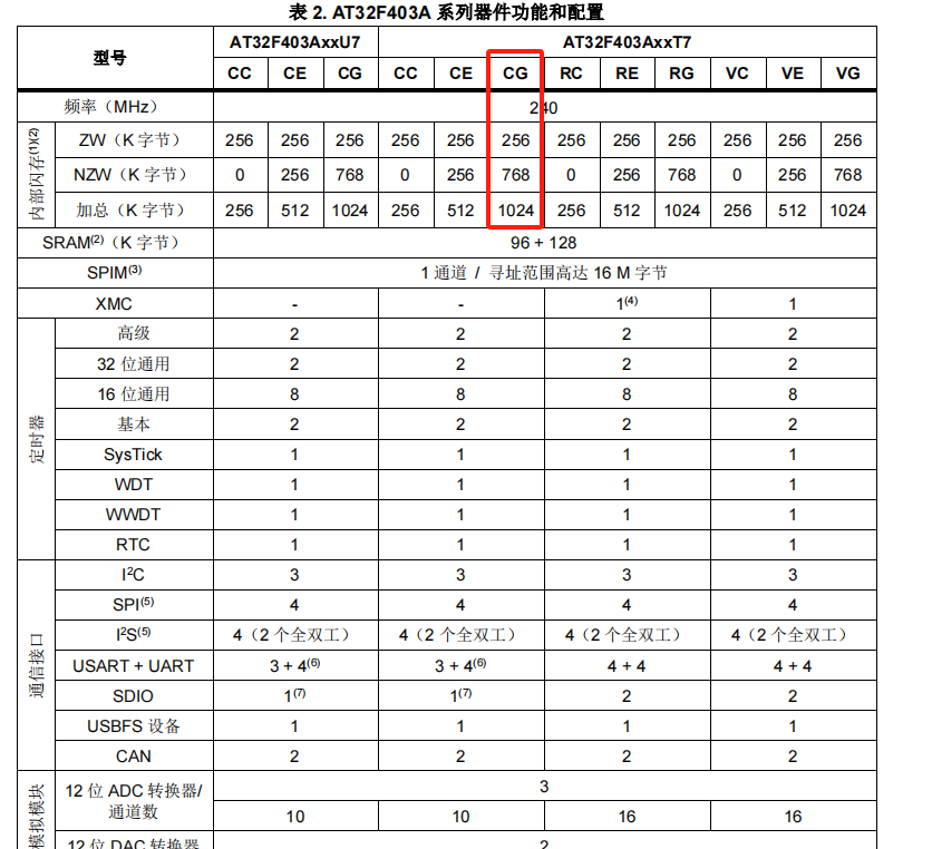

, ZW = zero wait-state, up to SYSCLK 240 MHz,
NZW = non-zero wait-state
(2) supports internal flash memory and SRAM allocation through user system data settings. Taking AT32F403AVGT7 as an example, the internal flash memory and
SRAM can be configured as follows:
ZW: 256 K bytes, NZW: 768 K bytes, SRAM: 96 K bytes;
ZW: 128 K bytes, NZW: 896 K bytes, SRAM: 224 K bytes.
(3) SPIM = External four-wire SPI Flash memory extension (program execution/data storage/program and data can be encrypted).
(4) LQFP64 package XMC only supports driving 8-bit mode LCD screen.
(5) Half-duplex I
2S and SPI functions are multiplexed.
(6) LQFP48 and QFN48 packages do not have UART8, and USART6 can only be used as UART because it lacks the CK pin.
(7) LQFP48 and QFN48 packages only have SDIO2, which supports up to 4-bit (D0~D3) mode.

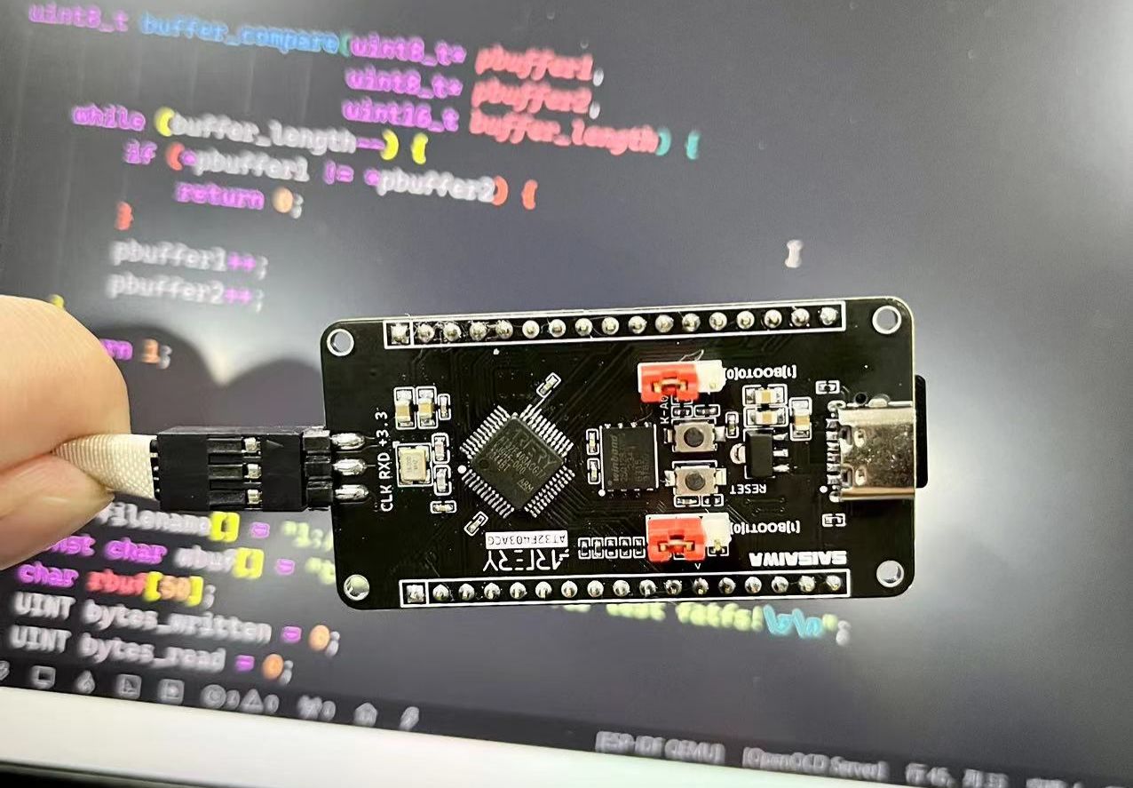

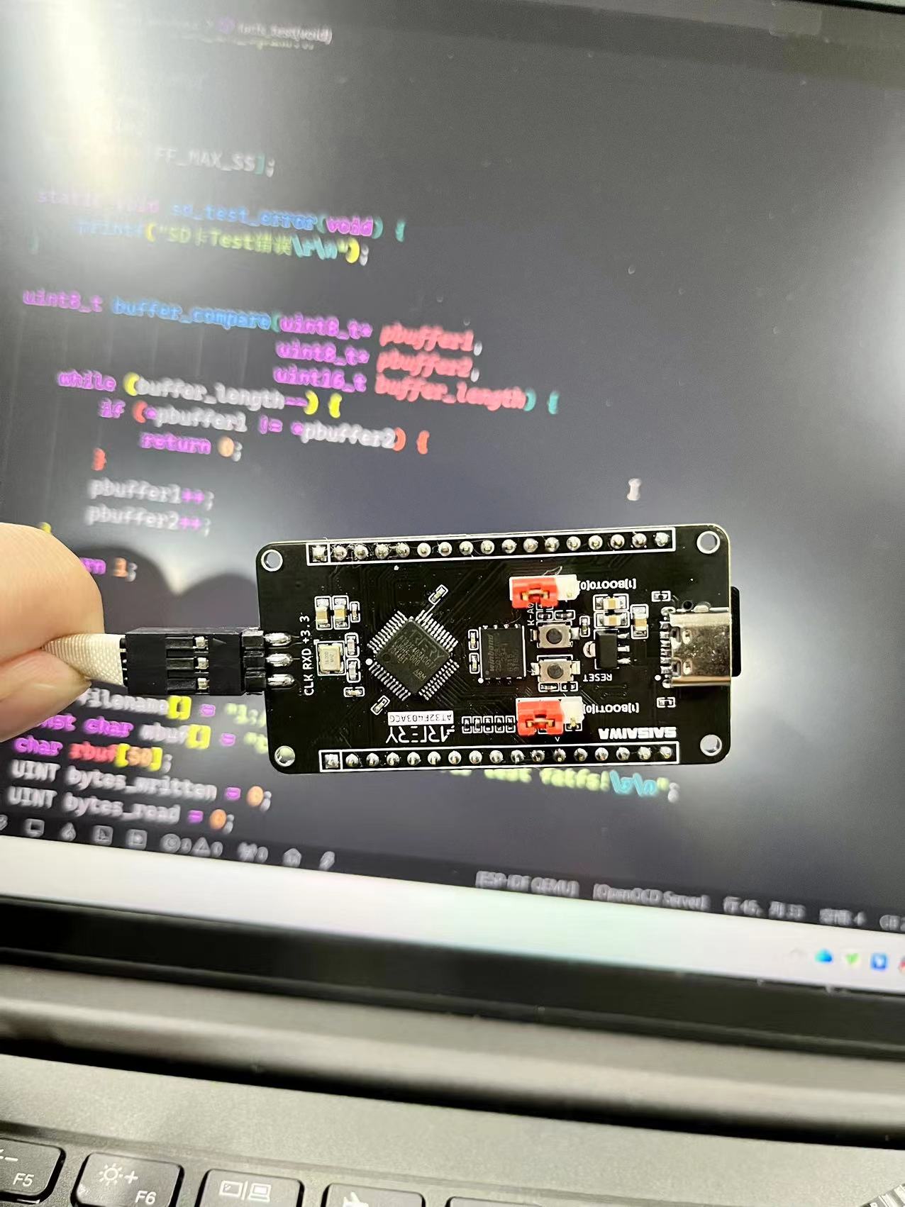

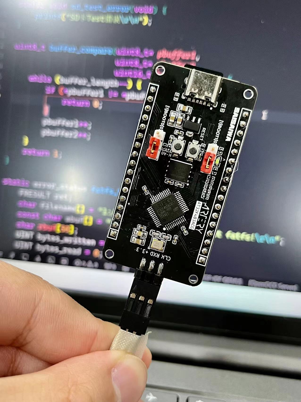

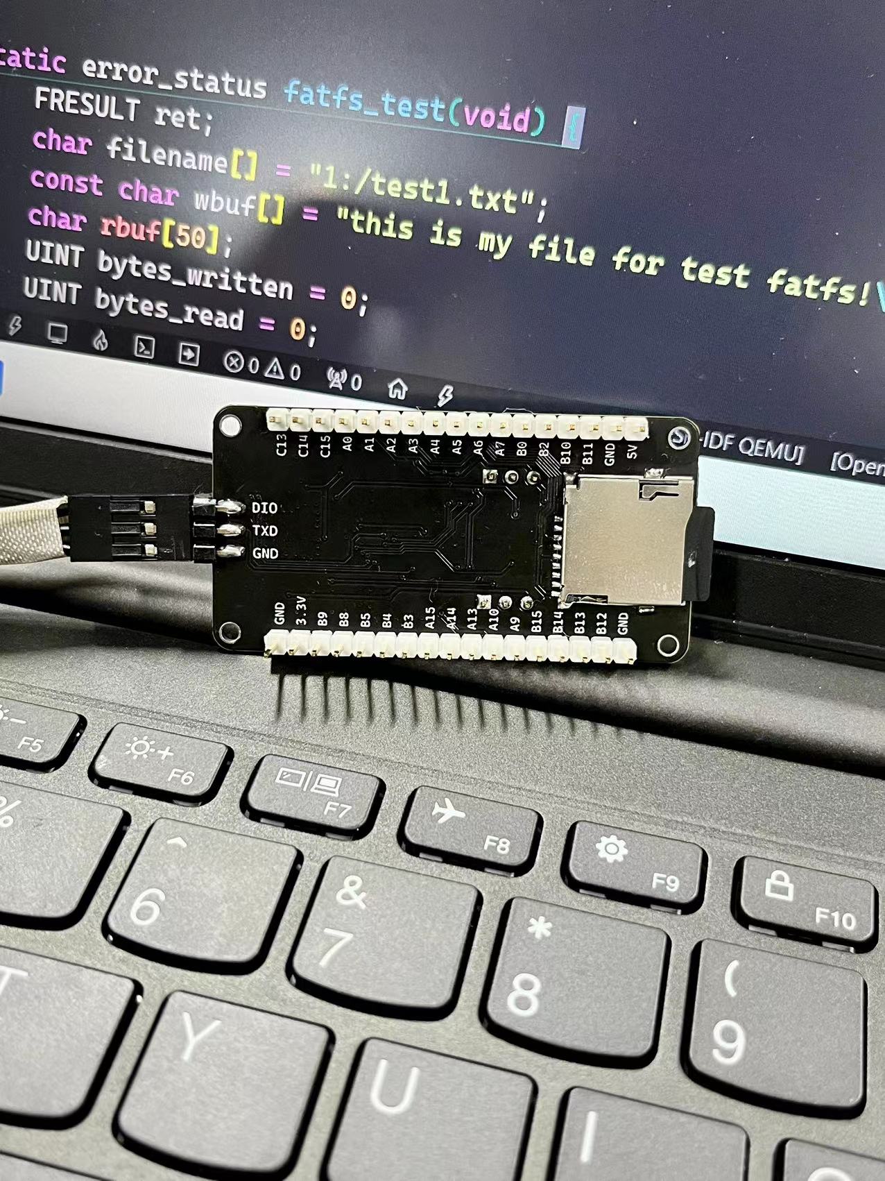

Onboard peripherals include an
external 16M SPIM four-wire SPI flash memory, an
SD memory card with SDIO protocol
, an LED controllable by GPIO
, a user button,
a system reset button,
and two jumper pins (Boot1 and
0). The crystal oscillator is selectable up to 25M, but 8M is recommended.
An SWD download port is provided, supporting DAP-LINK, JInk, and the official ATLINK
serial port.
The bundled example code package shows
that all peripherals on the development board have been successfully verified.
