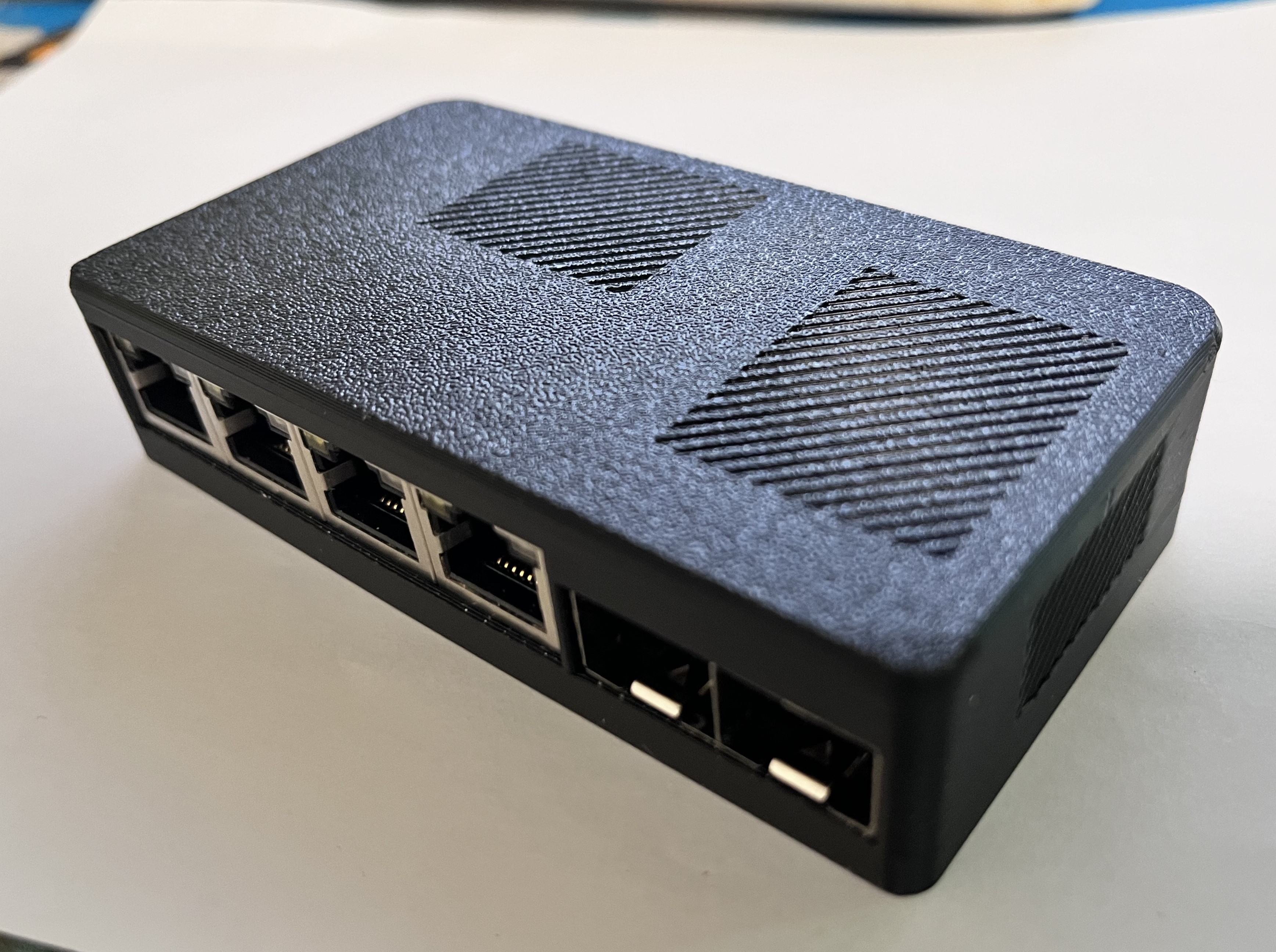

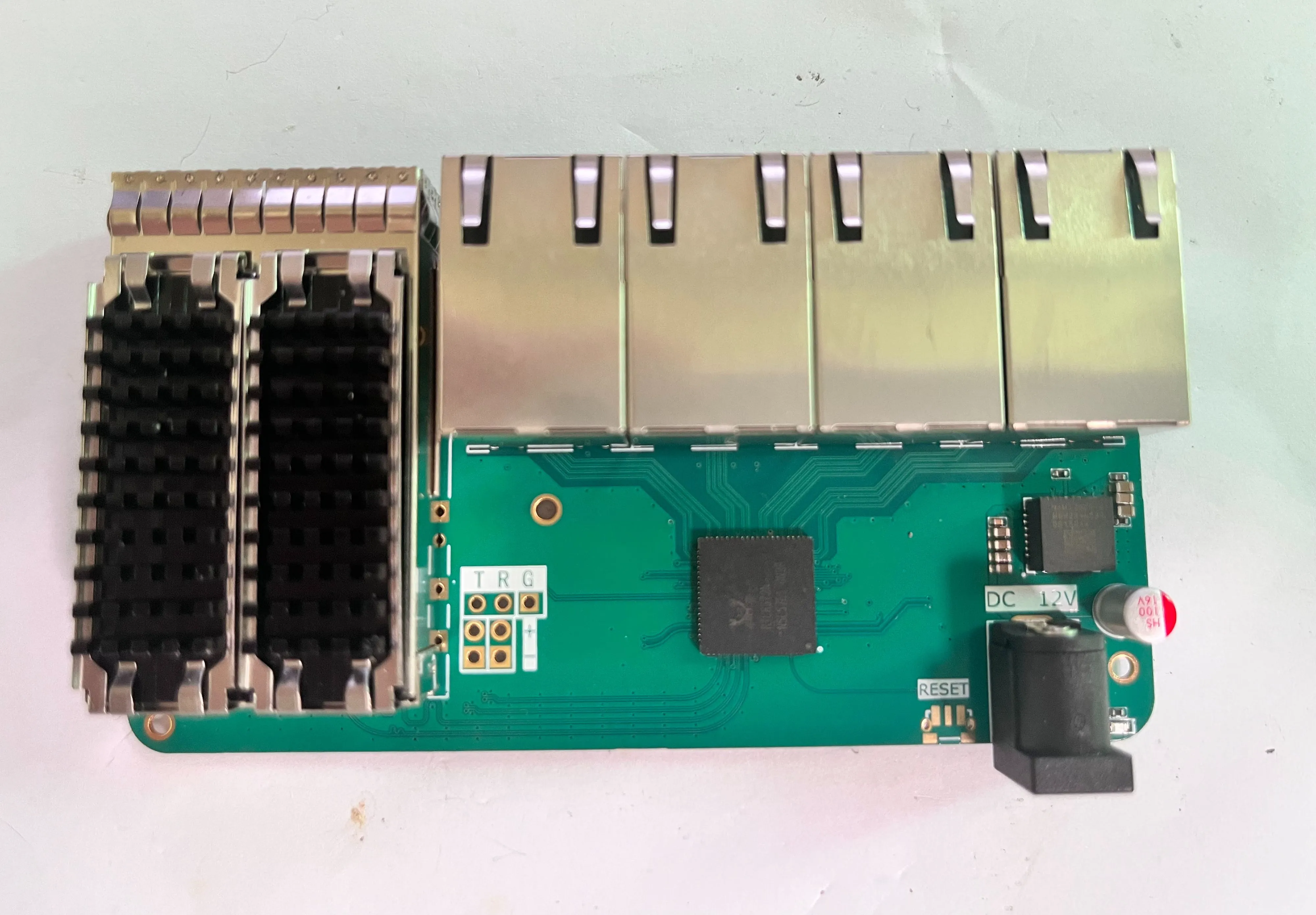

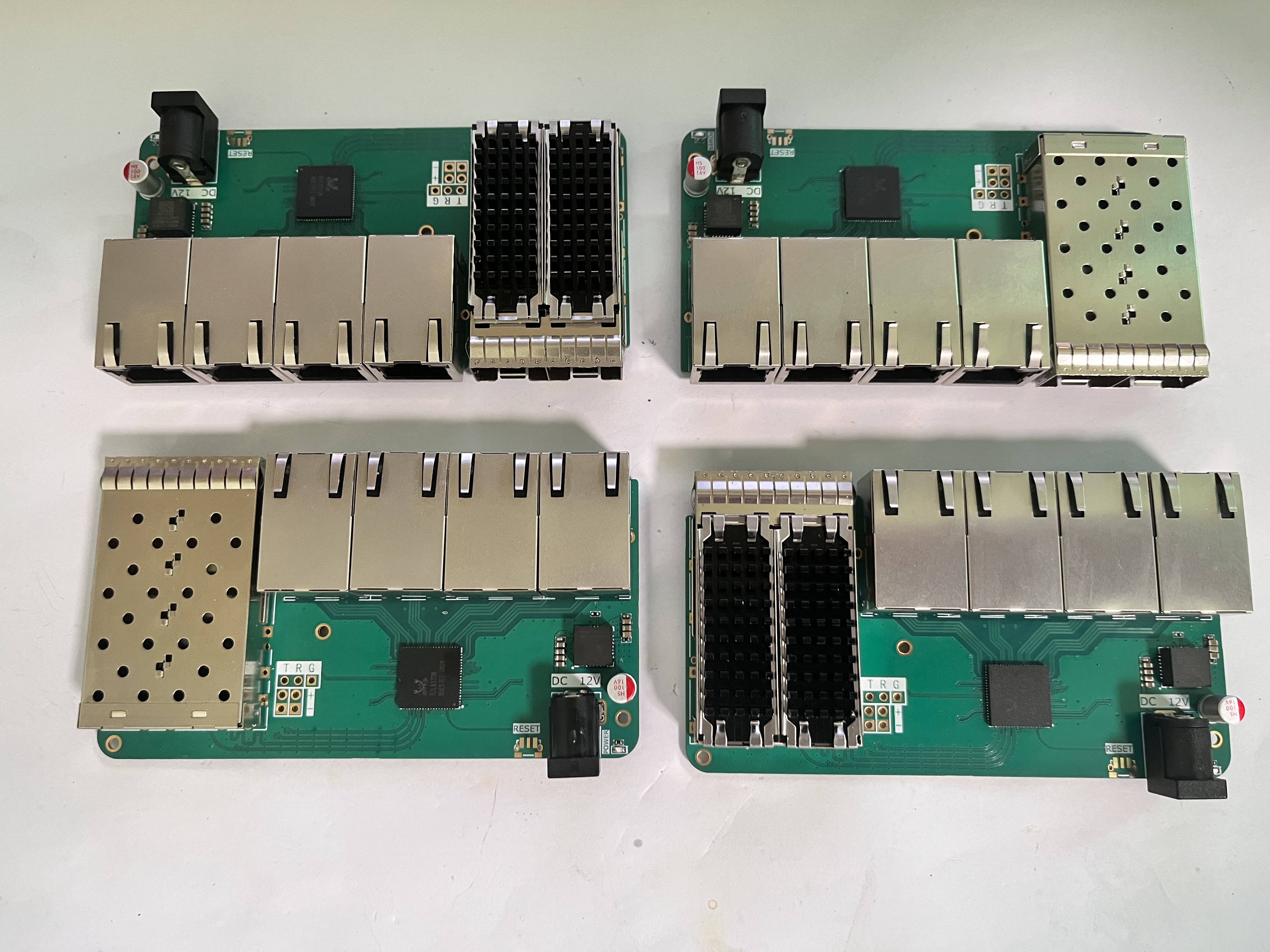

2.5G managed switch

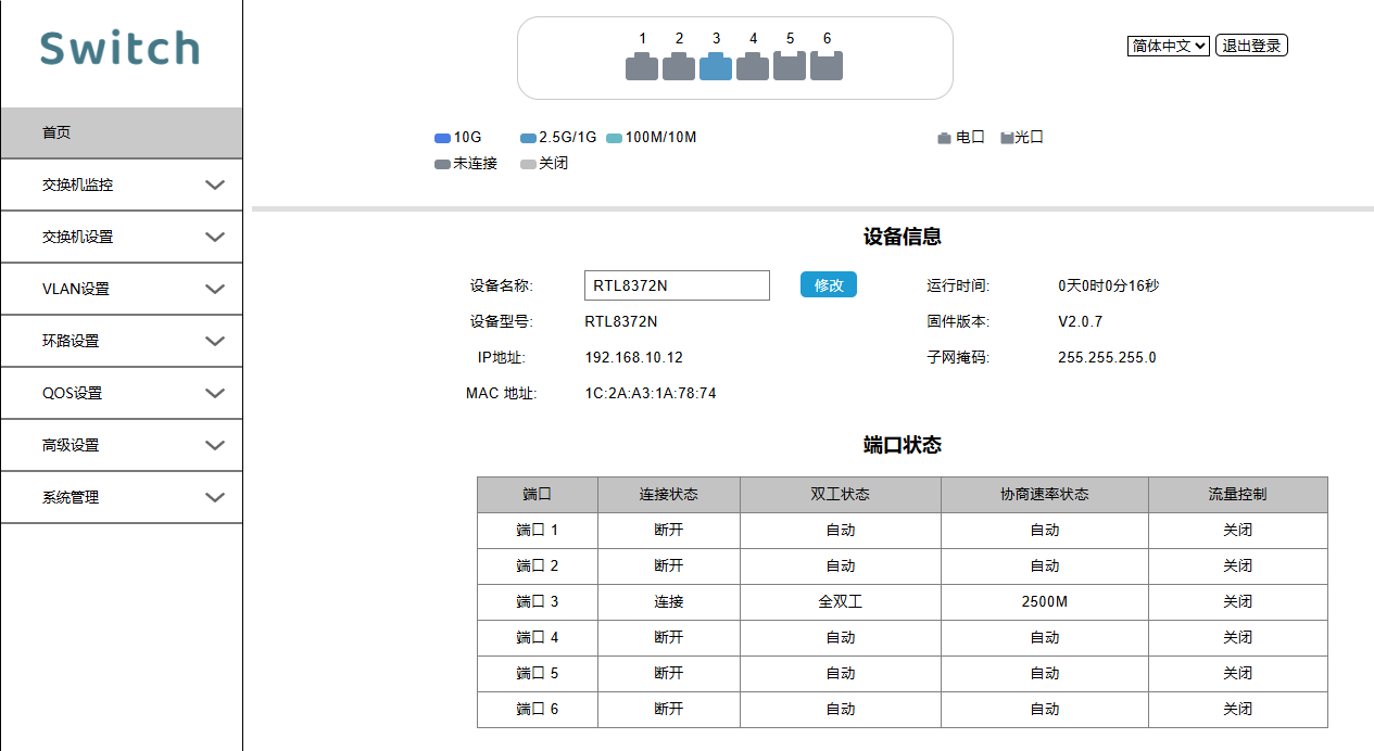

Management IP: 192.168.10.12 Username/Password: admin
Board thickness 1.0, Stack-up 3313 Firmware MAC modified 1FC000
Firmware has two versions; the upgradeable version is limited to the flash model and cannot be upgraded to any other model. It is recommended to use a cracked version, as this is difficult to update.

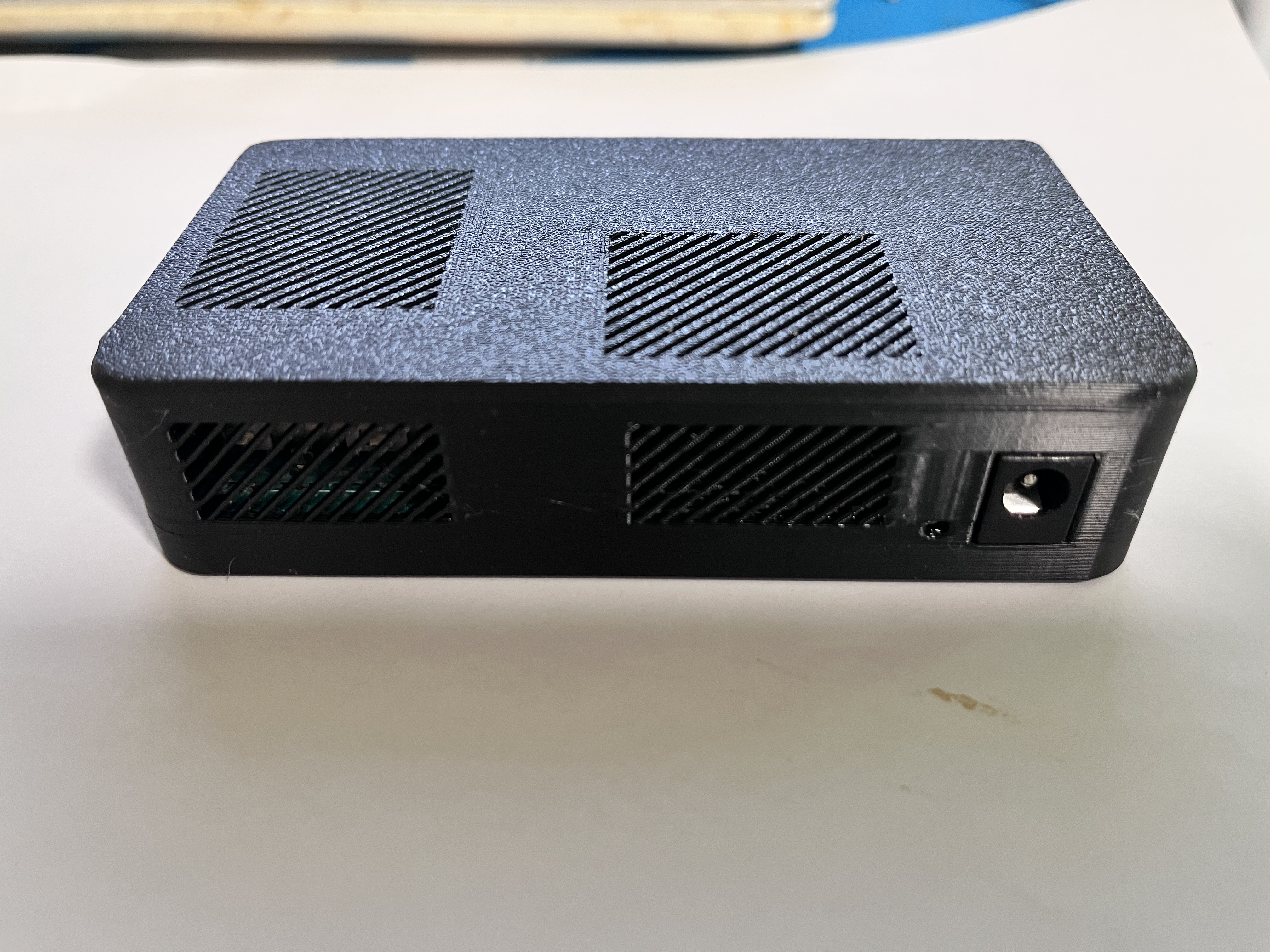

3D shell model files: https://makerworld.com.cn/zh/models/475670
