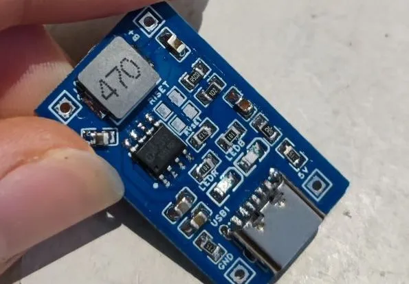

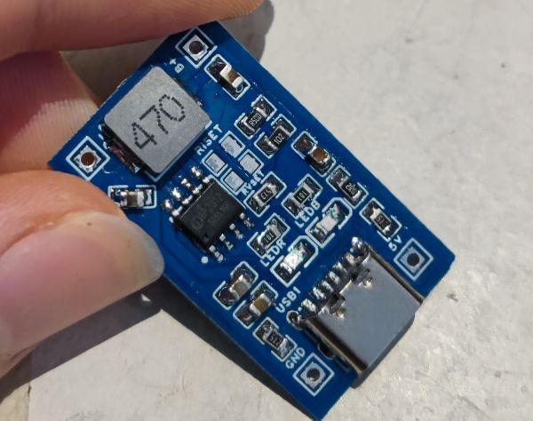

IP2312 Lithium Battery Charging Module - 0805 Package, a Must-Have for Those with Clumsy Hands
The IP2312 lithium battery charging IC supports 4.20V/4.30V/4.35V/4.4V lithium batteries, with a maximum current of 3A
for easy hand soldering. All capacitors and resistors are in 0805 packages. Compared to the traditional TP4056, it offers higher current and lower heat generation. The charging
cutoff voltage and constant current charging current are adjusted via the RISET and RVSET pads.
The charging cutoff voltage is adjusted as follows:
4.2V 43K 1% 4.3V 75K 1% 4.35V 100K 1% 4.4V.
The constant current adjustment is: I=135000/Ri (Ri∈45KΩ-170KΩ)
135K-1A
91K-1.5A
NC-2.1A
45K-3A
