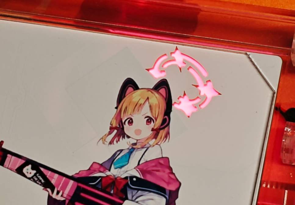

1. Introduction:
The night light using TTP223 for touch, DY-SV17F for voice output, and ASRPRO for voice recognition
is basically the same as the green one, only the layout has been changed: https://oshwhub.com/aknice/azure-archives-only-feather-green

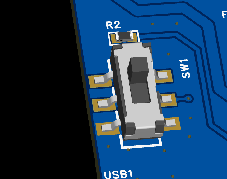

The back switch allows you to choose between constant light or a light that illuminates for a period after touch/voice activation before turning off.
Code initialization allows you to select the playback language; the default is Japanese.

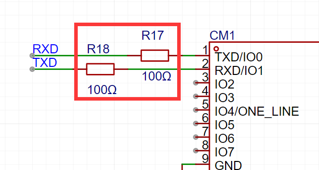

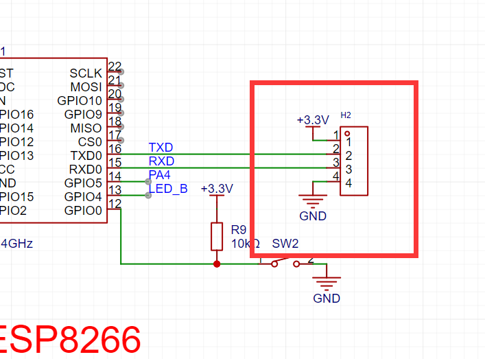

3. Code burning
for the ESP8266 main controller: For the reserved serial port burning header,
disconnect the serial port resistor connecting to the voice playback module before burning; otherwise, serial port interference will prevent input.

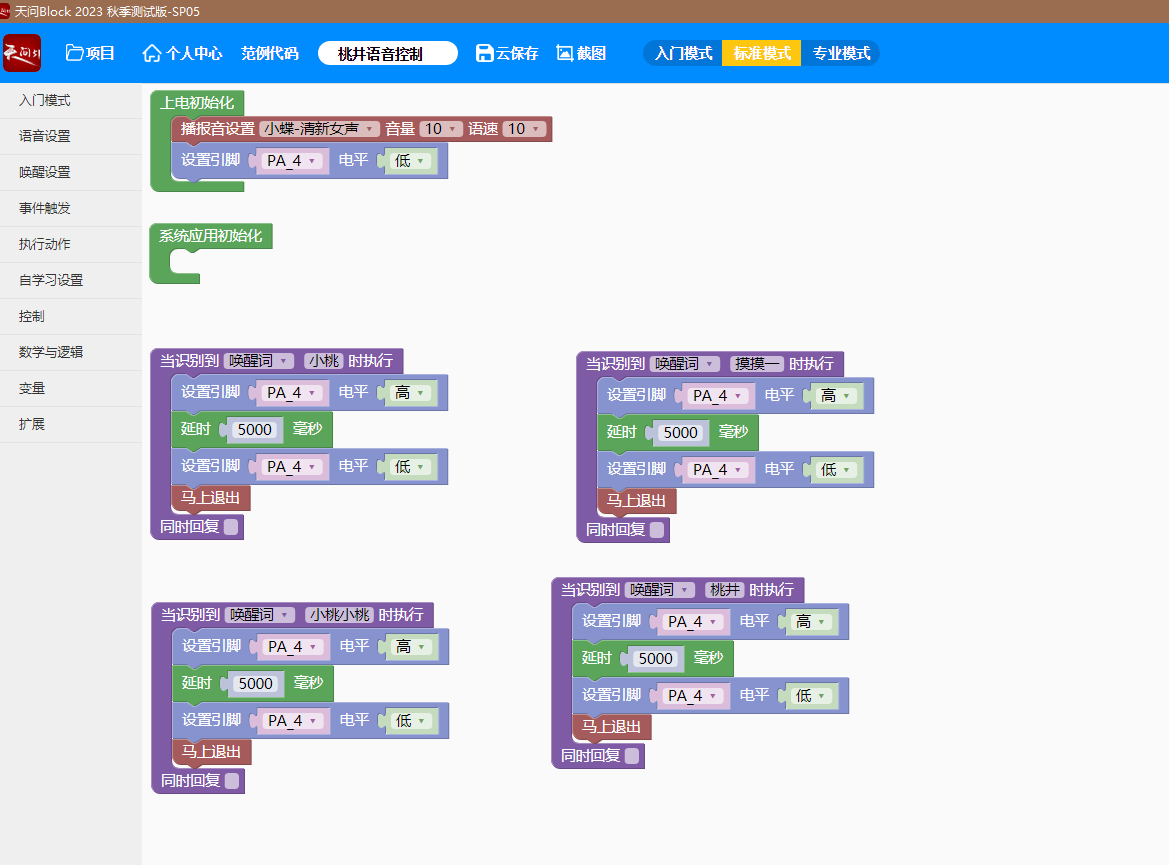

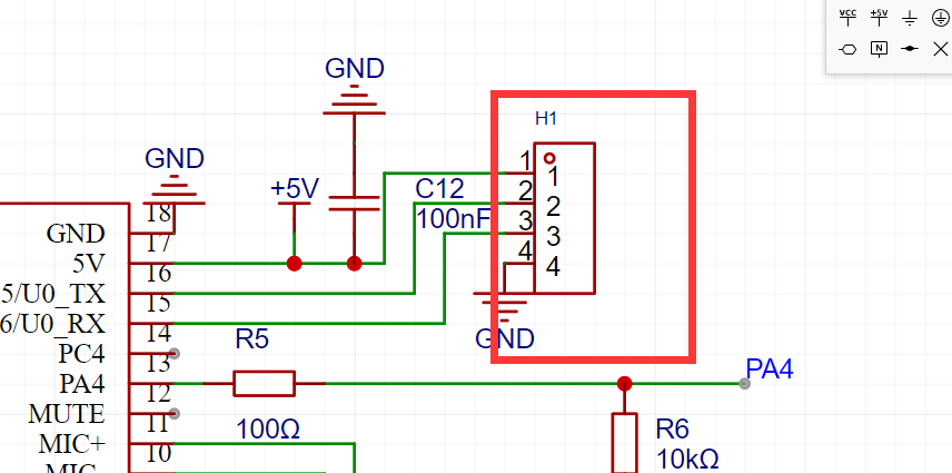

4. Offline voice burning
uses the Tianwen voice module. See the Tianwen voice module tutorial for details.
Install Tianwen Block, register an account,
open the Tao offline voice
serial port, connect to the Tianwen serial port,
and click download.

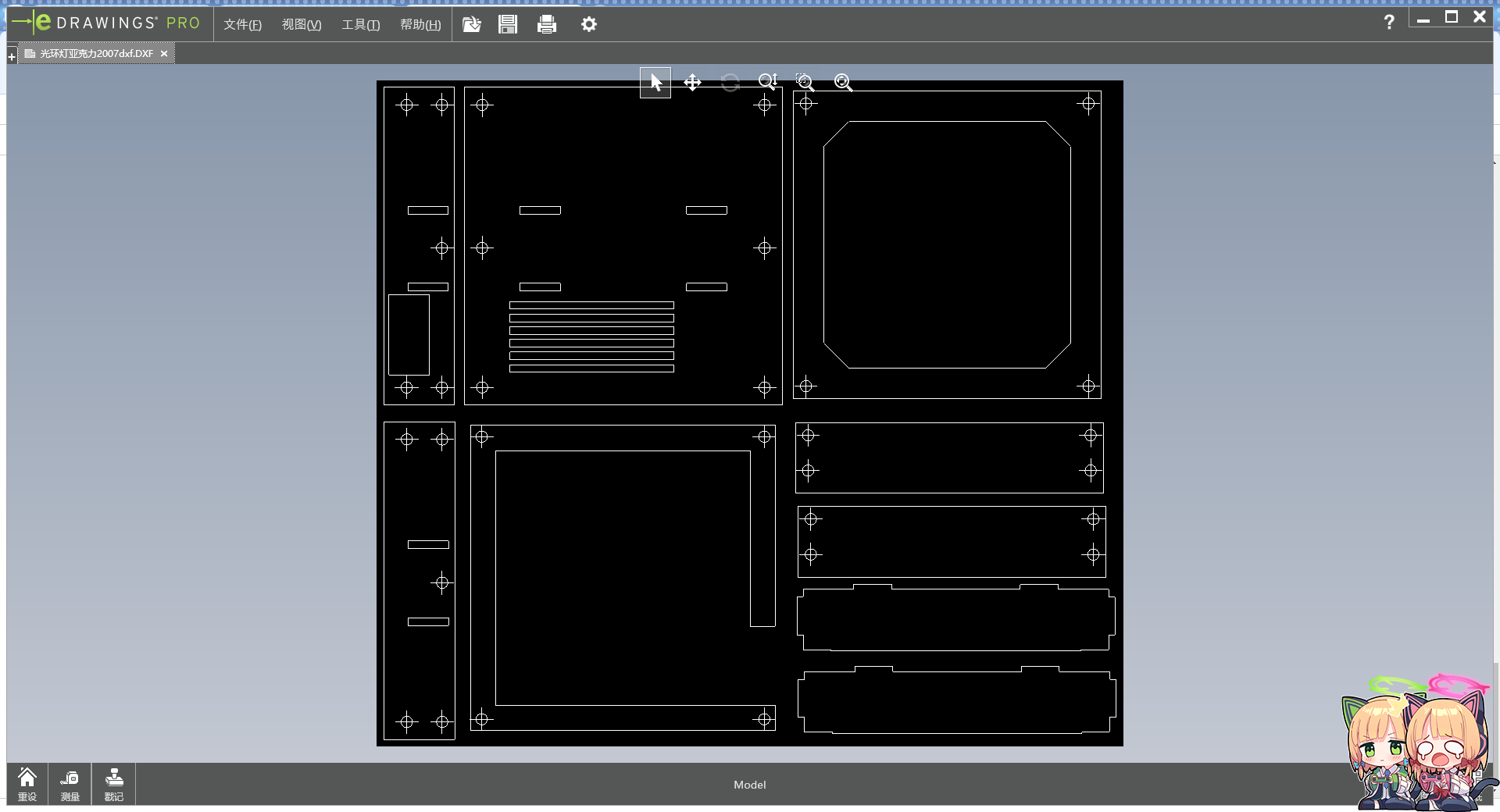

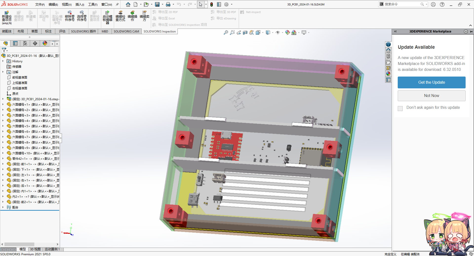

6.
Directly print acrylic with modeling files
: Acrylic six-sided nuts (10 per machine, 10x10 cm). Purchase:
https://item.taobao.com/item.htm?_u=qqavhl8f634&id=741904654013&spm=a1z09.2.0.0.67002e8dYgv4io
