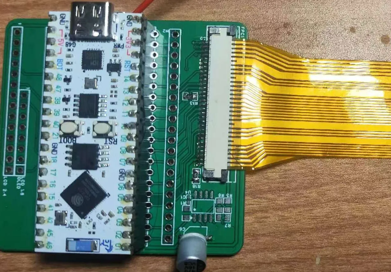

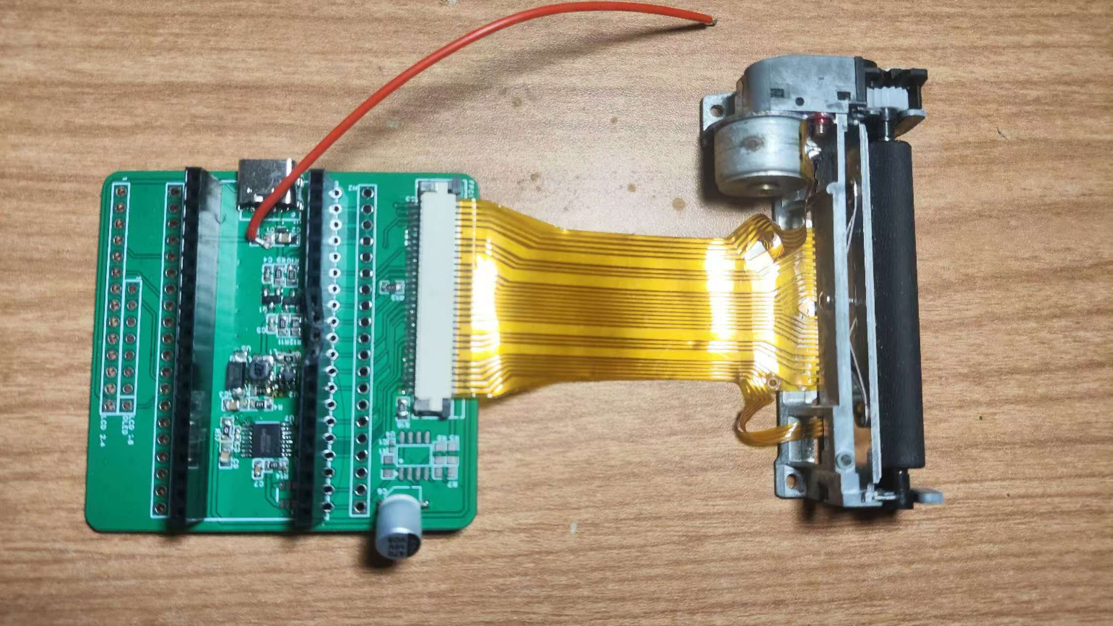

ESP32-based thermal printer

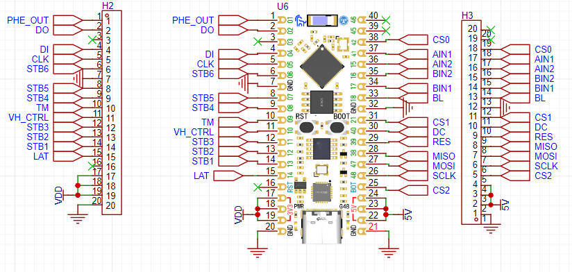

The design requirement

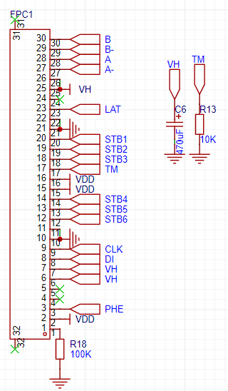

is to create a thermal printer driver board based on an ESP32 wireless module, capable of printing images and text.
The schematic diagram and design specifications are as follows:
Main
controller:
Power supply
voltage conversion;
Thermal printer interface;
Stepper motor driver.

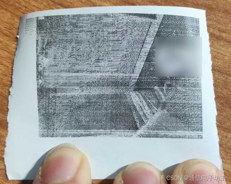

Verification results:
Soldering completed as shown
below; Power-on and driver download completed; Photo printing results as shown below .

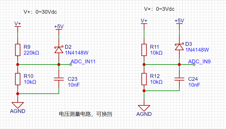

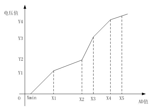

1. Voltage Sampling Circuit
Since it is a simple current and voltage meter, it must have voltage and current sampling circuits, as shown in the figure.

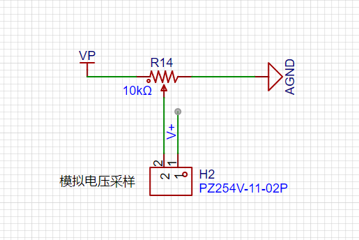

You can see that there are two voltage ranges. Here, we take the 0~30V range as an example.
V+ is the voltage input terminal. After being divided by resistors R9 and R10, it is filtered by C23 and clamped by D2, and then output to the CW32's ADC channel 11. Assuming the CW32's ADC reference voltage is 1.5V, we can calculate:
1.5/10K = Vmax / (10K + 220K), that is, Vmax = 1.5 * 23 = 34.5V is the maximum voltage.
Because resistors have a precision range, a 220K resistor may not actually be 220K; it could be 219K, 221K, etc., leading to potentially inaccurate voltage data. Therefore, voltage measurement calibration is necessary. A circuit for analog voltage measurement is designed:
by using adjustable resistors to divide the input voltage, the desired voltage value can be adjusted for subsequent software calibration.

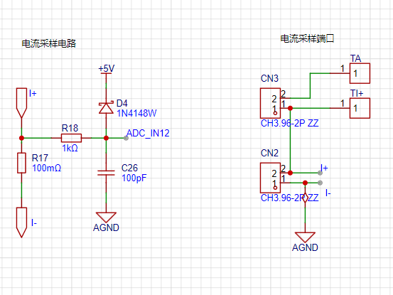

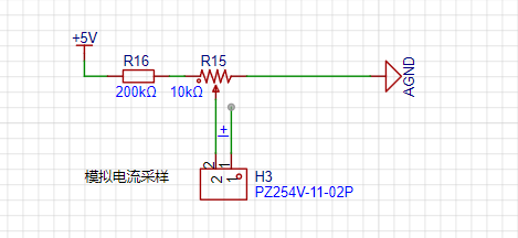

2. The current sampling circuit
is shown in the figure. Based on the physics learned in junior high school, U=IR. Given U and R, I can be easily derived. The principle of current sampling is to measure the voltage across the sampling resistor to obtain the current flowing through it.
In the figure, the current flows from I+ through the sampling resistor R17 and then to I-. The ADC ground is connected to I-, so only the voltage across I+ needs to be sampled to obtain the current data.

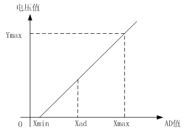

Of course, during debugging and calibration, it is difficult to obtain the desired current flowing through R17, but obtaining the required voltage is relatively simple. Therefore, a circuit for simulating current acquisition was also designed:
we first do not solder R17, and obtain the corresponding voltage value by adjusting the value of R15, thereby simulating the corresponding current.

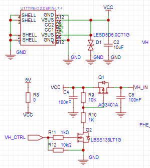

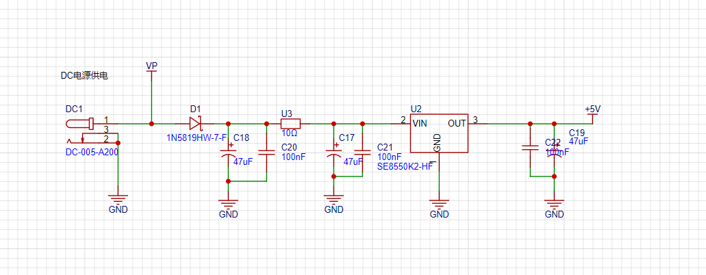

3. Power Supply Circuit:
Since the LDO on the development board does not have a very high withstand voltage, in order to work properly, we need a higher withstand voltage LDO to output a 5V voltage to the development board and some peripheral circuits.
In front of the LDO, there is a reverse connection protection circuit composed of D1, and a low-pass filter circuit composed of C18, C17, C20, C21, and U3. This circuit can filter out some high-frequency interference and increase the stability of the circuit. U3 is actually a resistor.

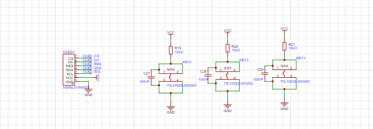

4. Control Circuit:
The control circuit mainly consists of a human-machine interaction circuit composed of 3 buttons and a 0.96-inch OLED display screen.

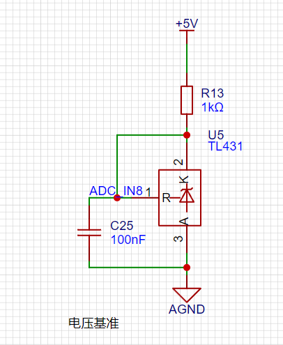

A voltage reference circuit, which can provide an additional voltage reference input to the ADC.

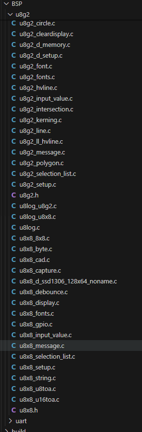

├─Board
├─BSP
│ ├─key
│ ├─log
│ ├─oled
│ ├─u8g2
│ └─uart

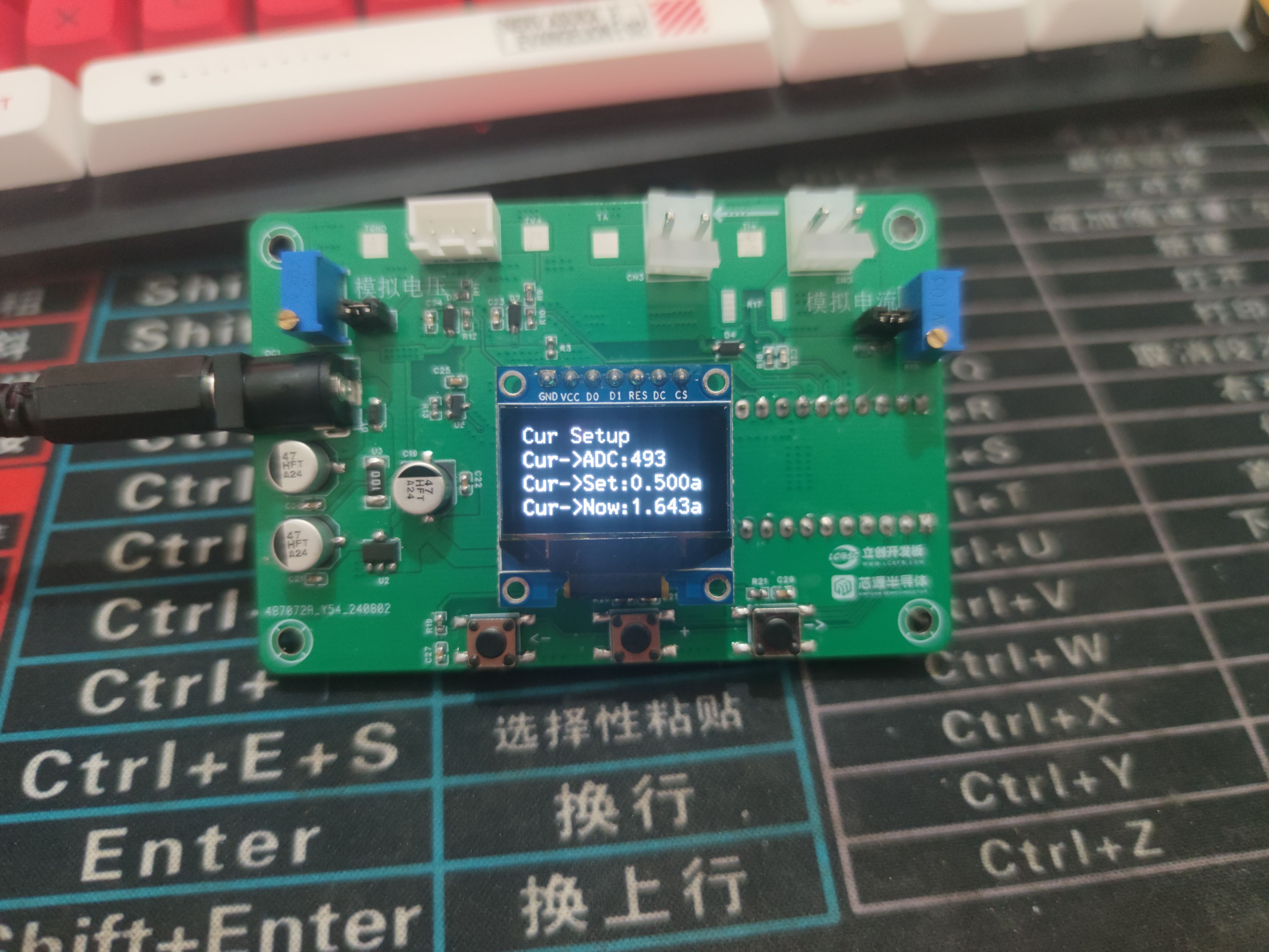

1. The display section

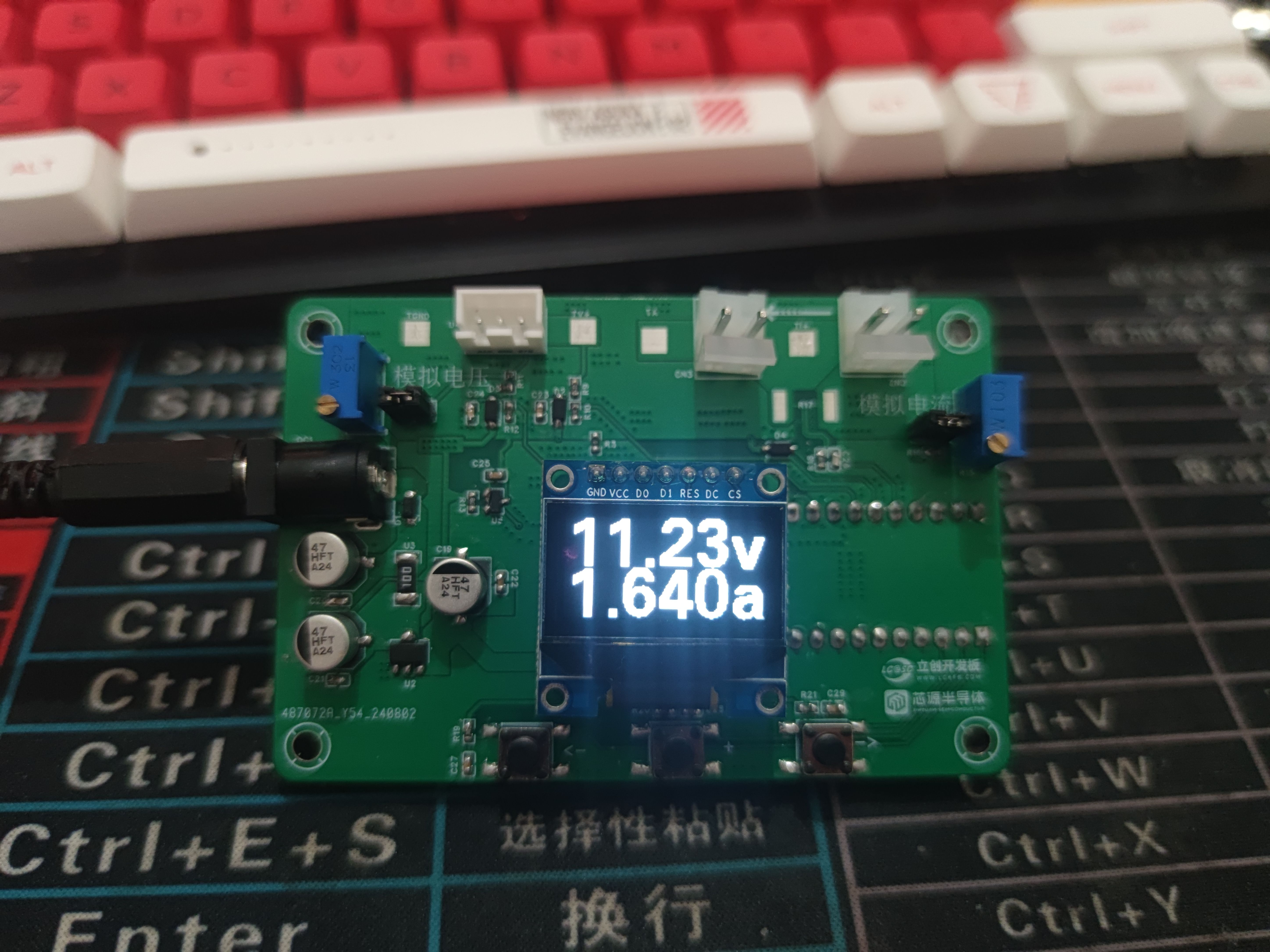

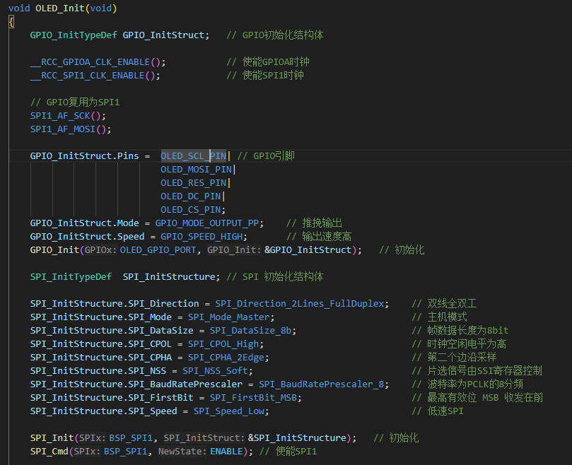

is as described above. The voltage and current data are displayed using a 0.96-inch OLED screen, so an OLED screen driver needs to be written. Here, we refer to the code from Zhongjingyuan. The GPIO pins connected to the OLED need to be initialized:
Because the u8g2 graphics library is used, the graphics library code also needs to be ported.
After porting, code needs to be written to display voltage and current data, voltage calibration, and current calibration interfaces:
void UI_main(u8g2_t *u8g2) // Main interface, displaying voltage and current information
u8g2_SetFont(u8g2, u8g2_font_fub30_tf);
Vol_ADC = mean_value_filter(VLotage_buff, ADC_SAMPLE_SIZE);
Cur_ADC = mean_value_filter(Current_buff, ADC_SAMPLE_SIZE);
if (Vol_ADC > X05)
Vol_Real = (float32_t)((Vol_ADC - X05) * K + Y05);
else
Vol_Real = (float32_t)(Vol_ADC * K);
if (Cur_ADC > IX05)
Cur_Real = (float32_t)(((Cur_ADC - IX05) * KI + IY05) / 100);
else
Cur_Real = (float32_t)(Cur_ADC * KI / 100);

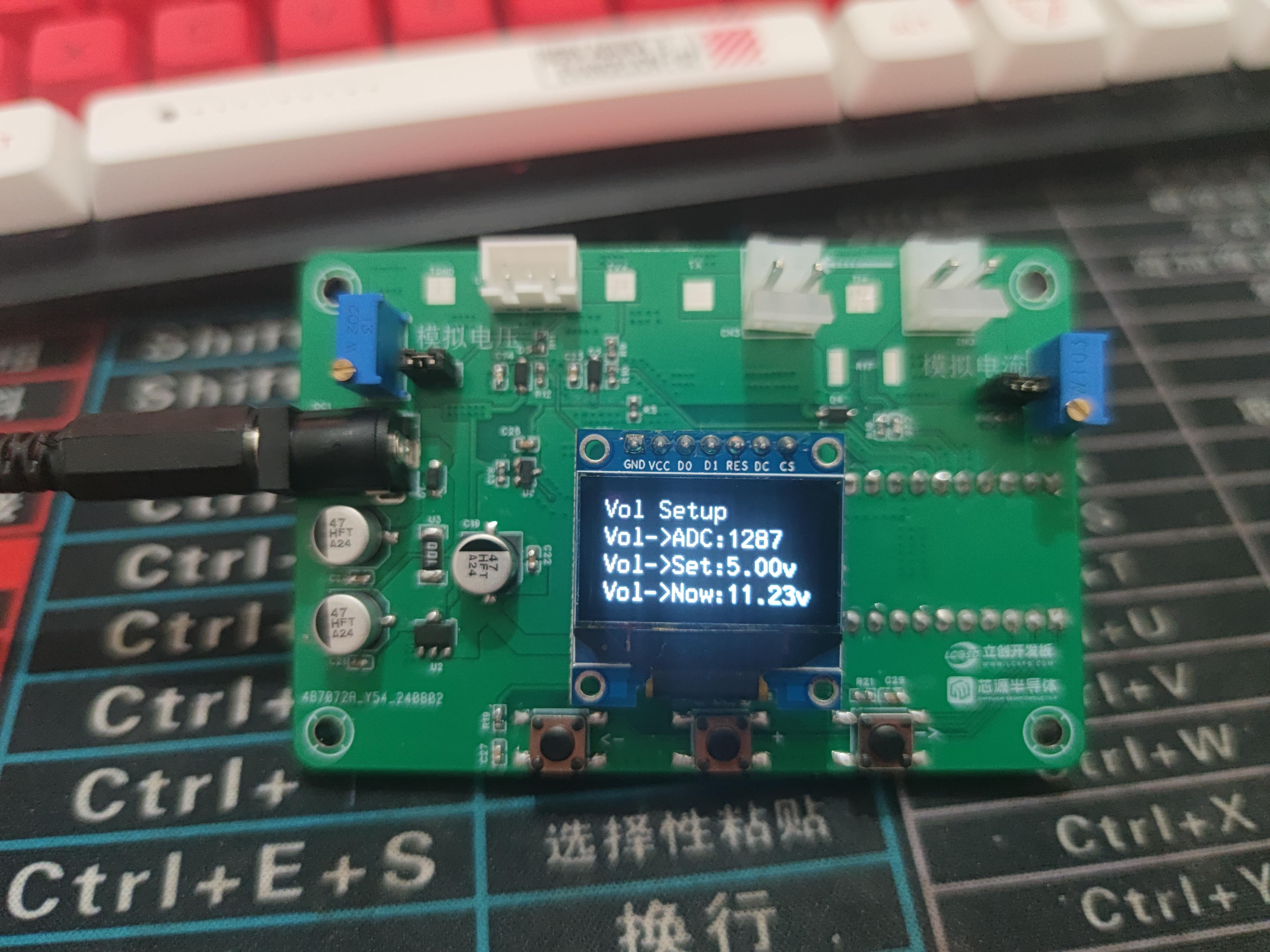

void UI_SetVOl(u8g2_t *u8g2) //Voltage calibration interface
u8g2_SetFont(u8g2, u8g2_font_t0_16_tf);
if (Vol_ADC > X05)
else
u8g2_FirstPage(u8g2);
do
sprintf(buff, "Vol Setup");
u8g2_DrawStr(u8g2, 0, 15, buff);
sprintf(buff, "Vol->ADC:%d", Vol_ADC);
u8g2_DrawStr(u8g2, 0, 31, buff);
switch (Vol_List)
case CA_Y05:
sprintf(buff, "Vol->Set:%.2fv", (float32_t)Y05);
break;
case CA_Y15:
sprintf(buff, "Vol->Set:%.2fv", (float32_t)Y15);
break;
default:
break;
u8g2_DrawStr(u8g2, 0, 47, buff);
sprintf(buff, "Vol->Now:%.2fv", Vol_Real);
u8g2_DrawStr(u8g2, 0, 63, buff);
} while (u8g2_NextPage(u8g2));

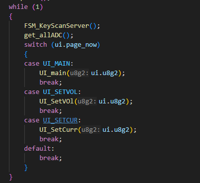

In the main function, different interfaces are displayed according to the interface variables:
2. Button control part
Because there is bouncing during the button press, it will cause errors in the MCU reading the pin level, so filtering is required. In the hardware design, a capacitor is added as a hardware filter for each button. In the software, a timer and finite state machine algorithm are used to implement button filtering.

After obtaining the smoothed ADC data, some calculations are needed to obtain the voltage or current data:
Because the CW32F030's ADC is 12-bit, the ADC data range is: 0 ~ 4095. Therefore, under a 1.5V reference voltage, the voltage value corresponding to the ADC data is (ADC / 4096) * 1.5, which is the voltage on the ADC pin. We know that
U * (R1 / R1 + R2) = UR1, so given UR1, U = UR1 * (R1 + R2 / R1).
Therefore, ideally, if the data acquired by the ADC is represented as voltage data (taking the 30V range as an example):
U = 1.5 * (ADC / 4096) * (220K + 10K) / 10K; similarly, the representation of current data can be understood.
However! Due to the error inherent in resistors, directly using this method to represent voltage and current data is inaccurate. Therefore, another method is used here, also referencing the training camp tutorial.
Suppose a sampling system where the AD converter can obtain digital quantities, corresponding to the physical quantity voltage (or current);
1. If an AD value point Xmin is calibrated at the "zero point" and an AD value point Xmax is calibrated at the "maximum point", according to the principle that "two points form a straight line", a straight line connecting the zero point and the maximum point can be obtained. The slope k of this line is easy to find. Then, by applying the equation of the straight line to solve for each point X (AD sample value), the physical quantity (voltage value) corresponding to the AD value can be obtained:
The slope k in the figure above is:
k = (Ymax-Ymin)/(Xmax-Xmin)
Therefore, the physical quantity corresponding to the AD value at any point in the figure above is:
y = k×(Xad-Xmin)+0
The above algorithm only calibrates between the "zero point" and the "maximum point". If the intermediate AD sample value is used, it will bring a large error in the corresponding physical quantity. The solution is to insert more calibration points.
As shown in the diagram below, four calibration points (x1, y1), (x2, y2), (x3, y3), and (x4, y4) are inserted.
This results in a line that is no longer a straight line, but rather a "reflected line" (equivalent to segmentation). To calculate the voltage value corresponding to a point Xad between x1 and x2:
y = k × (Xad – X1) + y1.
It can be seen that the more calibration points inserted, the higher the accuracy of the physical value.
Voltage and current measurements can be performed using a voltage and current calibration board, a multimeter, or other suitable equipment to calibrate the collected voltage and current. The more calibration points, the more accurate the measurement.
Here, voltages of 5V and 15V and currents of 0.5A and 1.5A are used for calibration .
