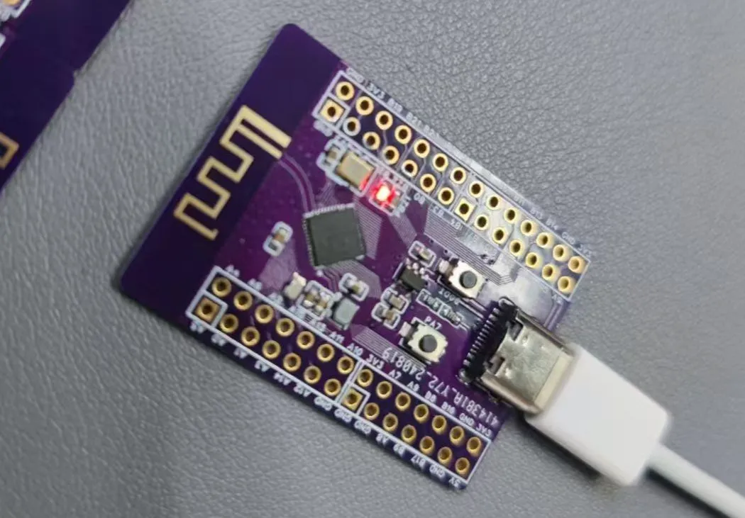

CH582M Minimum System Board
The latest PCB was selected, with a board thickness of 1.2mm.
1. The LDO on the board has a relatively high quiescent current consumption, approximately 60-90uA, which seems unsuitable for extremely low power requirements.
2. The PCB antenna was downloaded from the WCH official website and its performance is acceptable.
