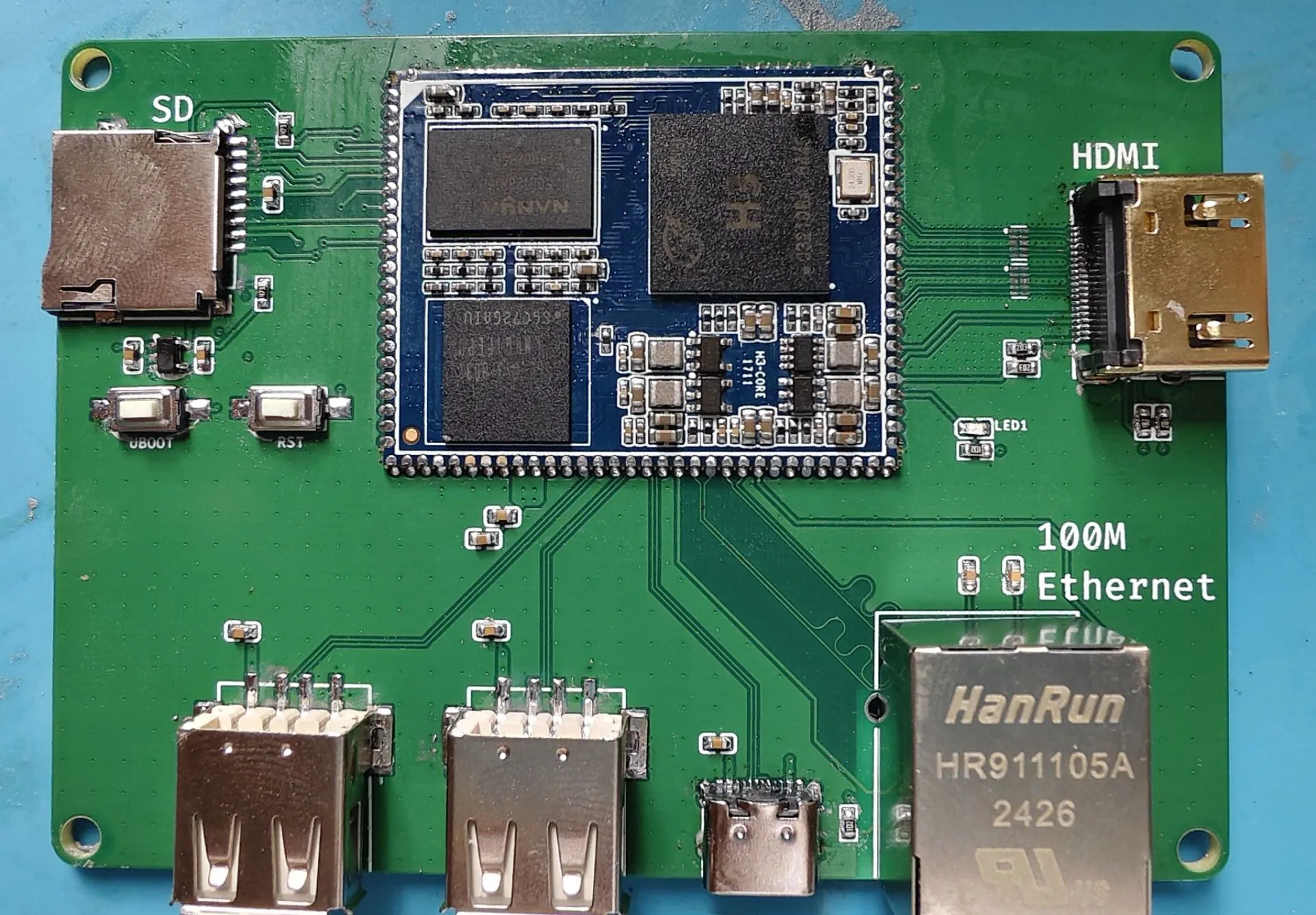

Allwinner H3 RealVision Base Plate
Cheap core boards from Xianyu (a second-hand marketplace) are often reused. There's not much to introduce here
. It's worth noting that before disassembling the core board, remember to apply a layer of low-temperature solder and then heat it with a heating pad. Never use a hot air gun,
as it will cause the solder to burst.
Defects include:
no I/O pins
and lack of wide voltage support.
