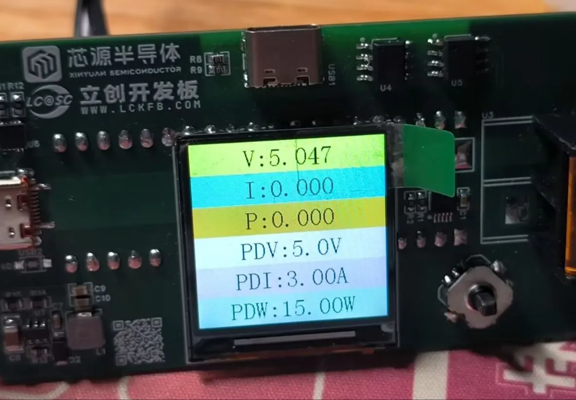

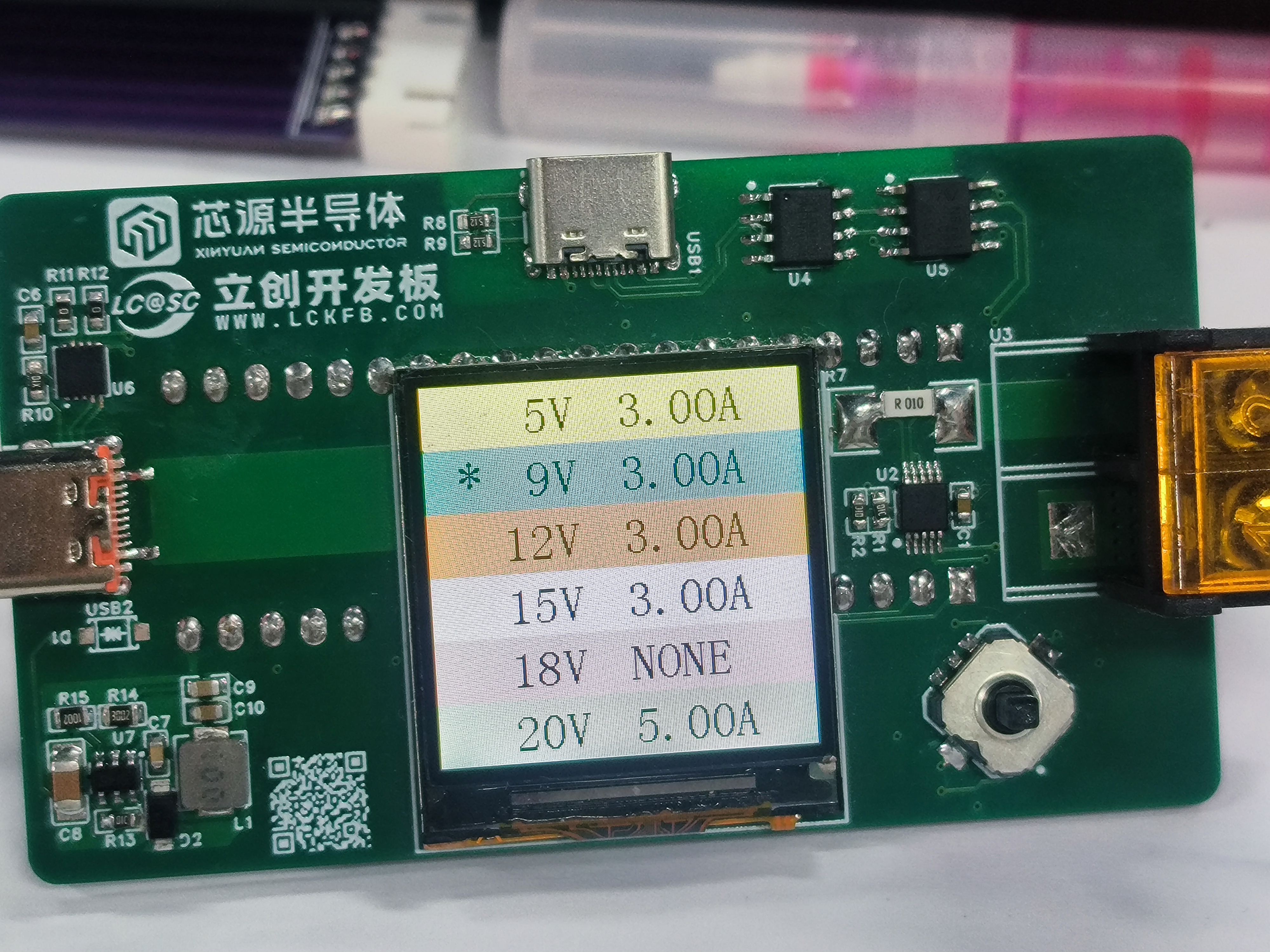

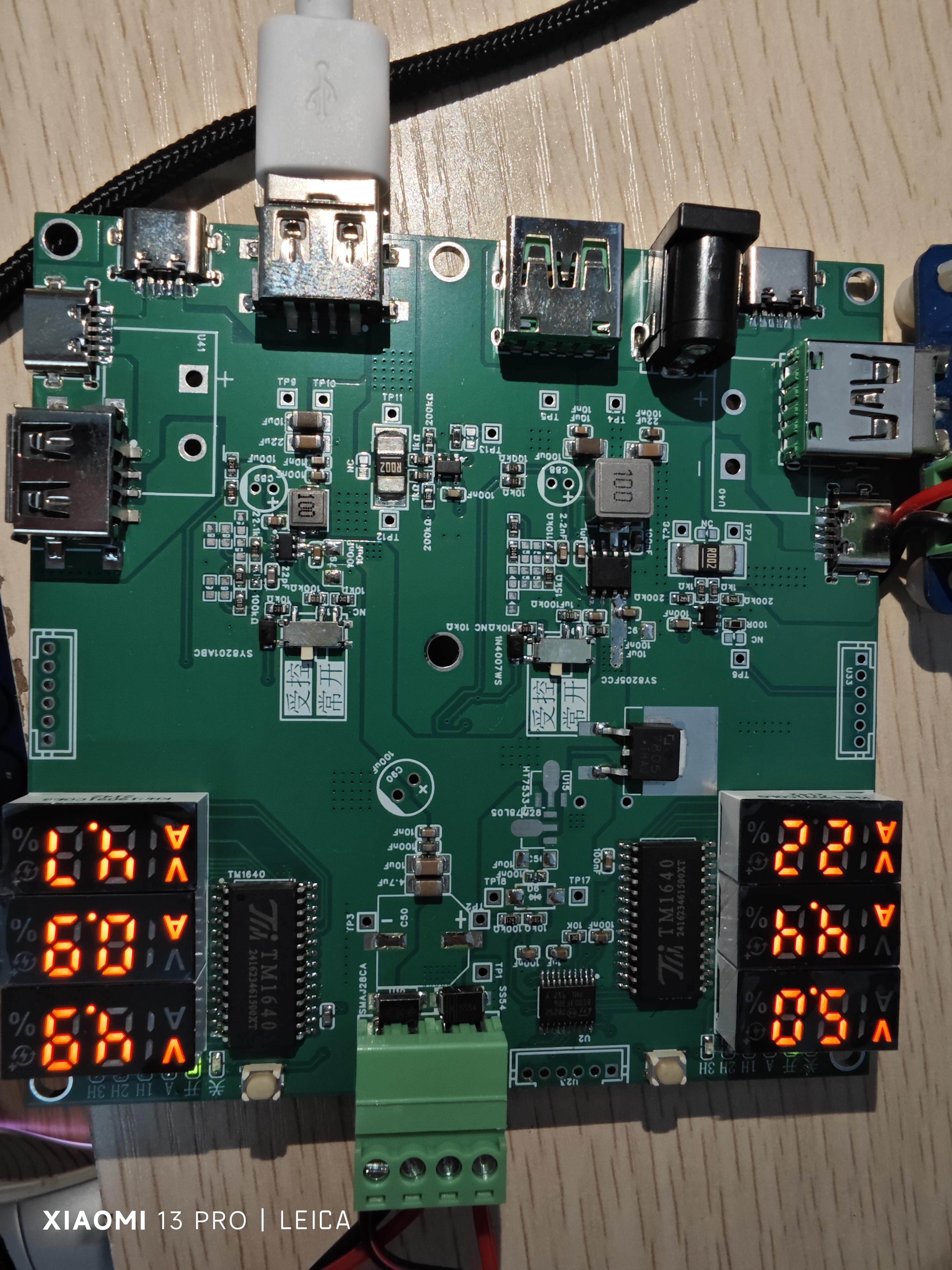

This is a meter header
update based on the CW32F030, featuring PD decoy, current and voltage acquisition, serial output, and screen display.
On October 29, 2024, firmware for a 10 milliohm sampling resistor was uploaded, supporting PD2.0 voltage level identification and switching (5V, 9V, 12V, 15V, 18V, 20V).
The core components
include the LGS5145 step-down converter, which has a wide input voltage range of 4.5V-55V, stepping the PD input voltage to 3.3V to supply external circuits.
An HUSB238 is used as the PD decoy, supporting up to 100W of decoy power, allowing adjustment of the PD level via resistors or I2C.

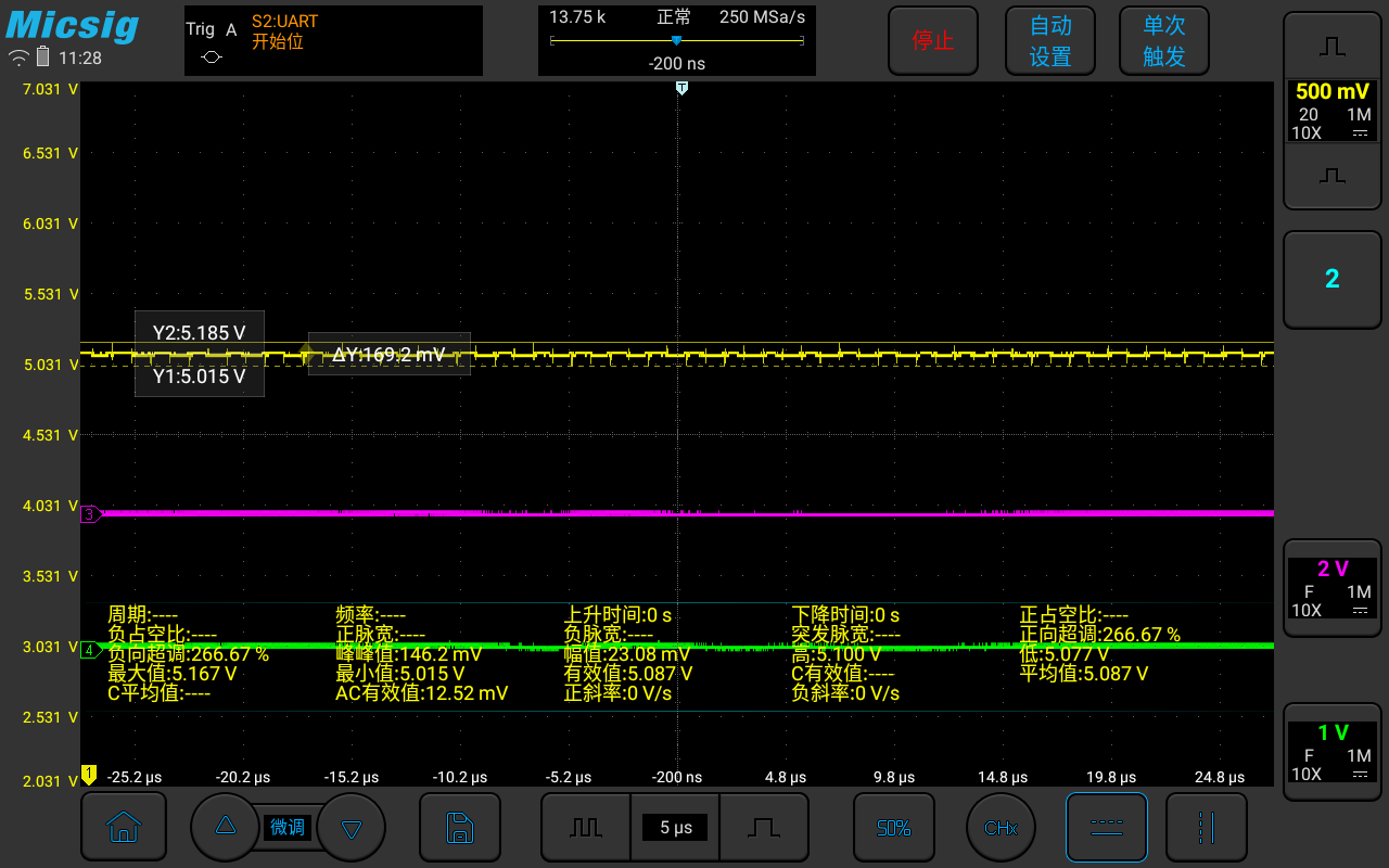

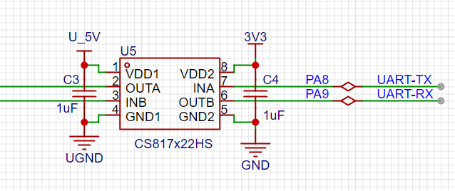

A cost-effective, low-power dual-channel digital isolator is used to meet serial communication requirements and prevent accidental power loss to the PC (
maximum data rate 200Kbps, just enough for the serial port to reach a communication rate of 115200bps).

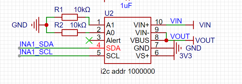

The highly cost-effective INA226 is used to achieve high-precision current and voltage sampling.

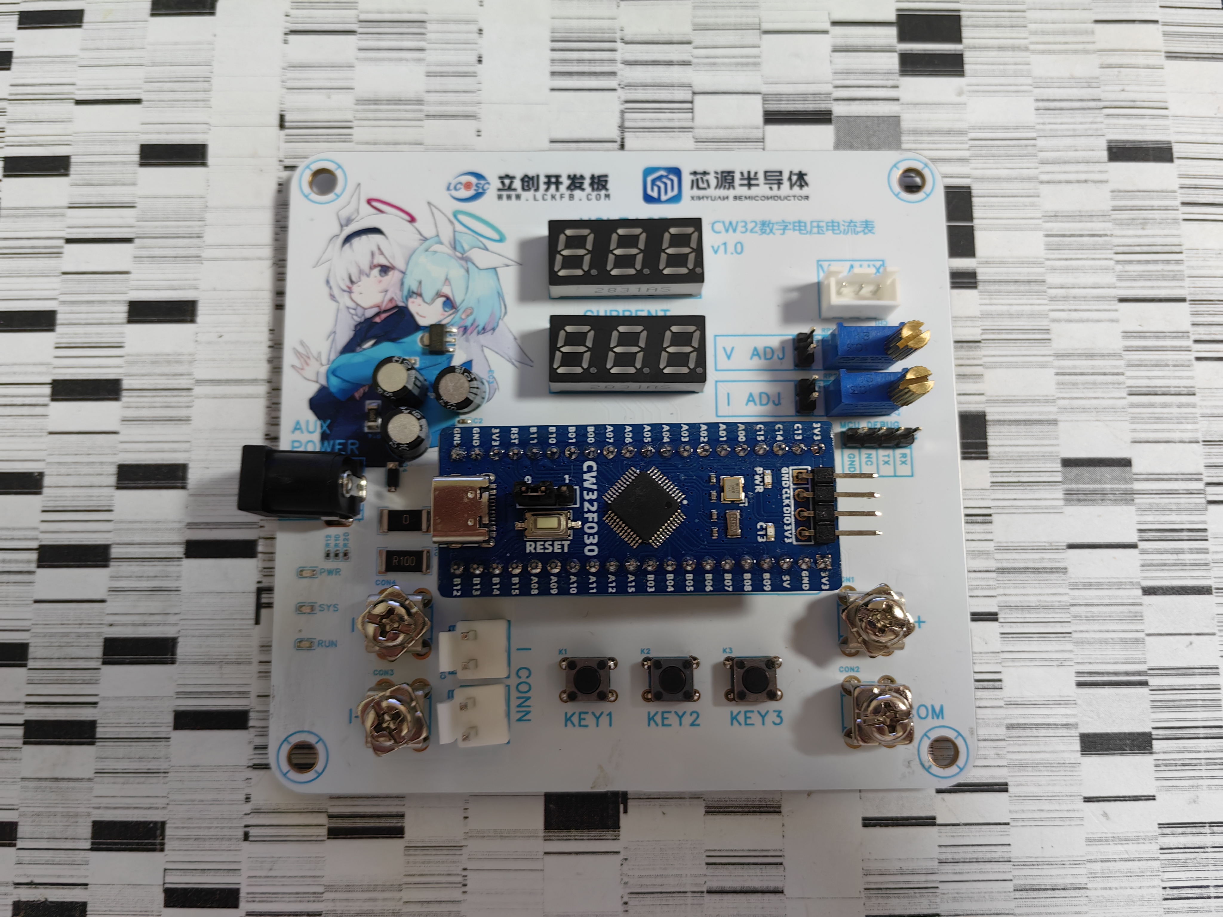

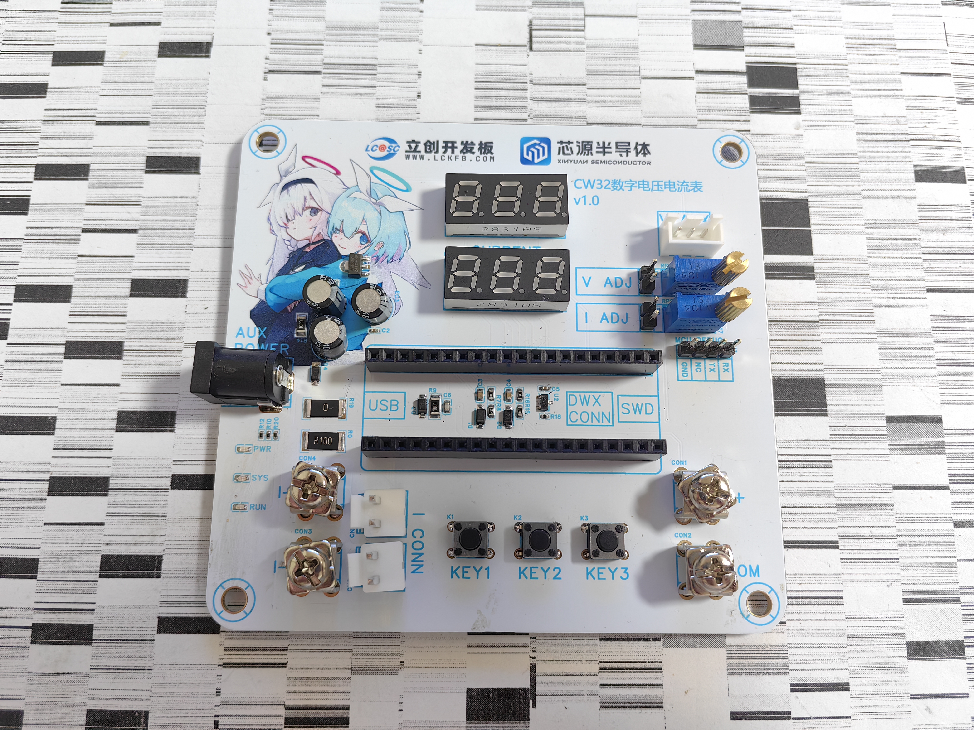

CW32 Voltage and Current Meter
Digital voltage and current meter based on CW32F030 development board
For hardware selection,
          this project uses the CW32 as the main control MCU. Its main features include strong anti-interference capabilities, a high-speed, high-precision ADC, and multiple reference voltages, which are beneficial for accurate voltmeter and current meter measurements.
The circuit design
          is based on the training camp's design scheme, replacing through-hole components with surface-mount components, resulting in higher accuracy and smaller package size.
Experimental verification:
          The program was written according to the training camp's software tutorial. Verification shows that the circuit can perform measurements normally with minimal error.

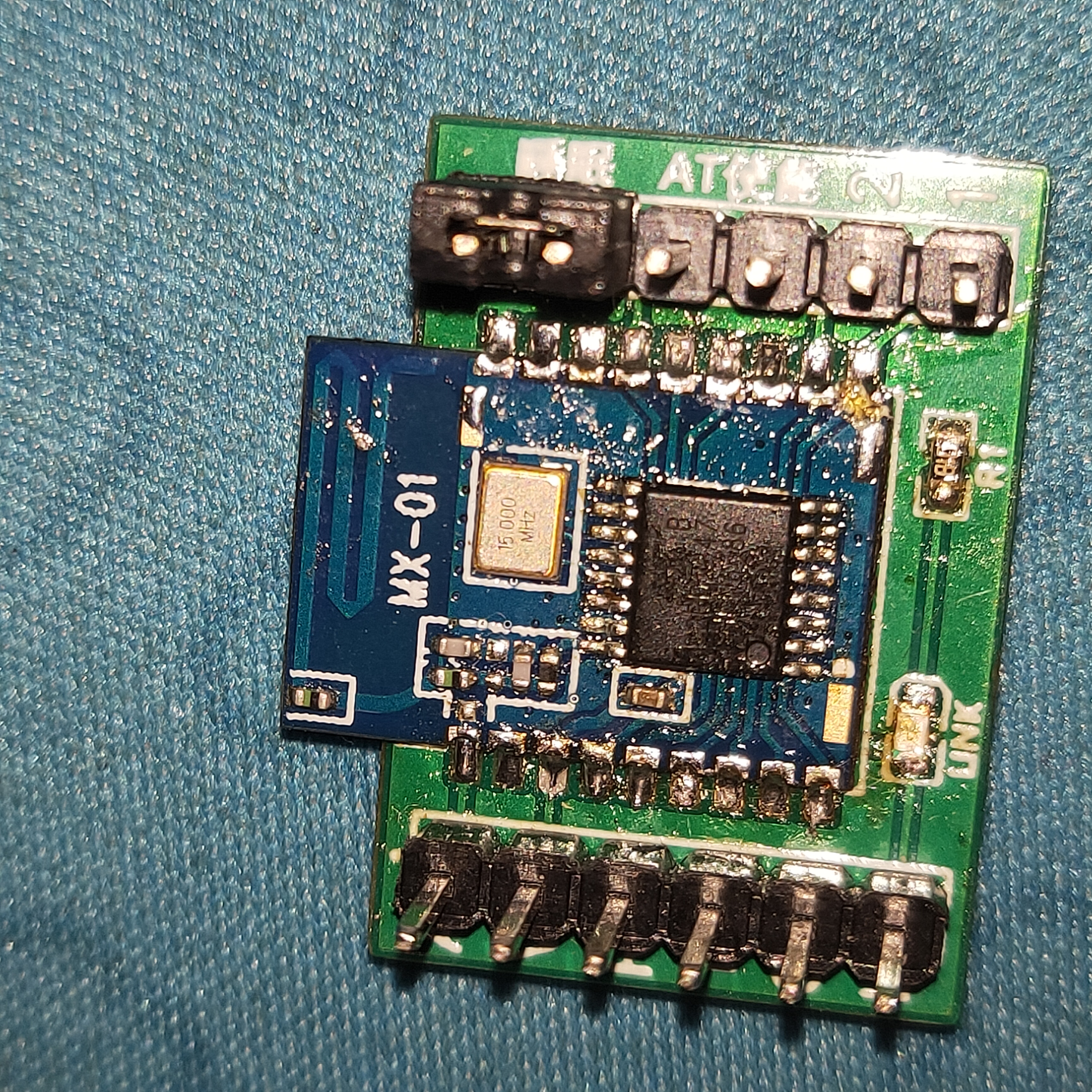

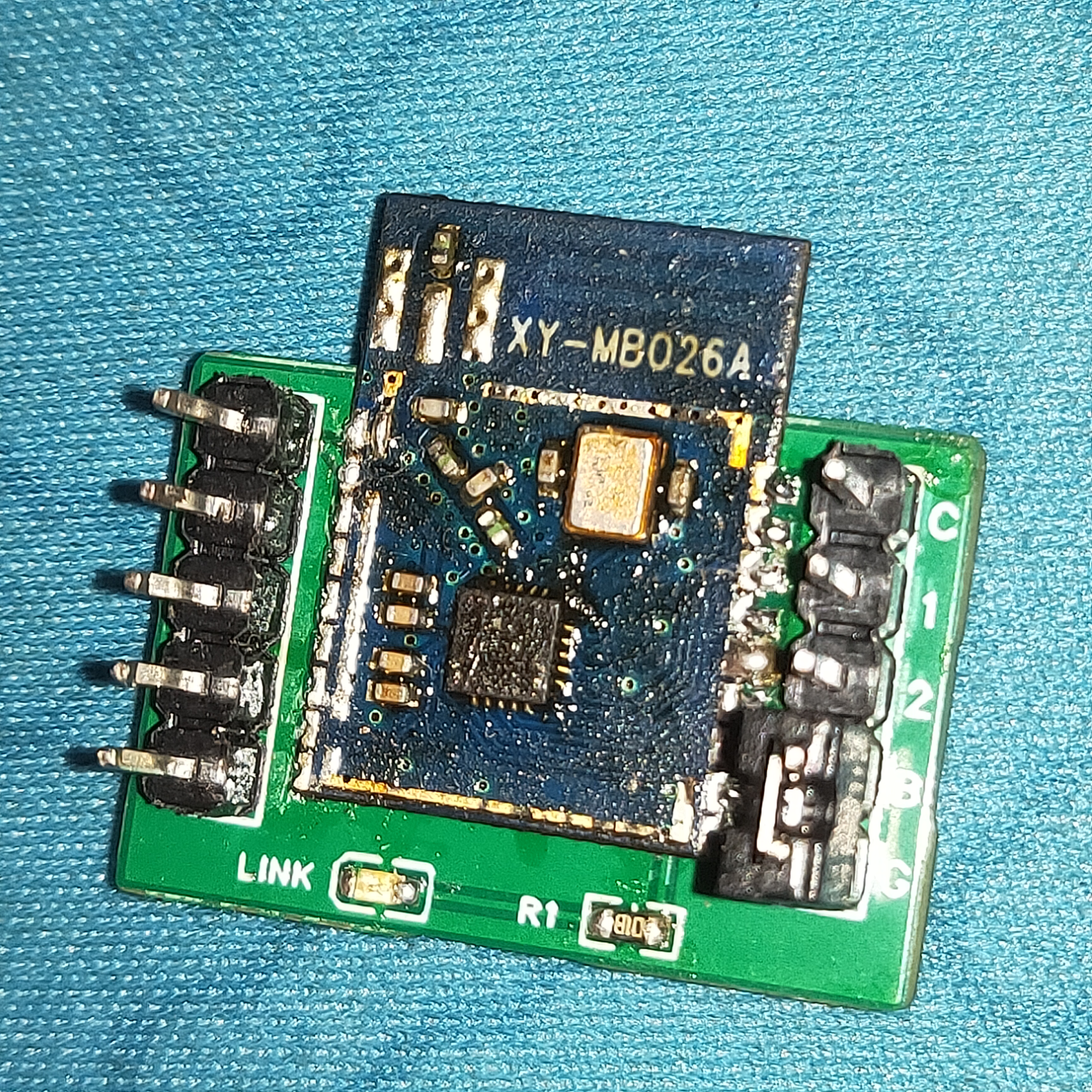

XY-MB026A Bluetooth module baseboard
NewOne Technology's inexpensive Bluetooth module exposes all usable I/O ports. C and B correspond to CDS and BRTS, which are the AT enable and sleep pins, respectively.
The XY-MB026A baseboard facilitates development and debugging. pins
c and b correspond to CDS and BRTS, respectively, serving as AT enable and sleep pins.
Pins B and G connect to the low-power mode.
LINK (L) is the connection detection pin.
