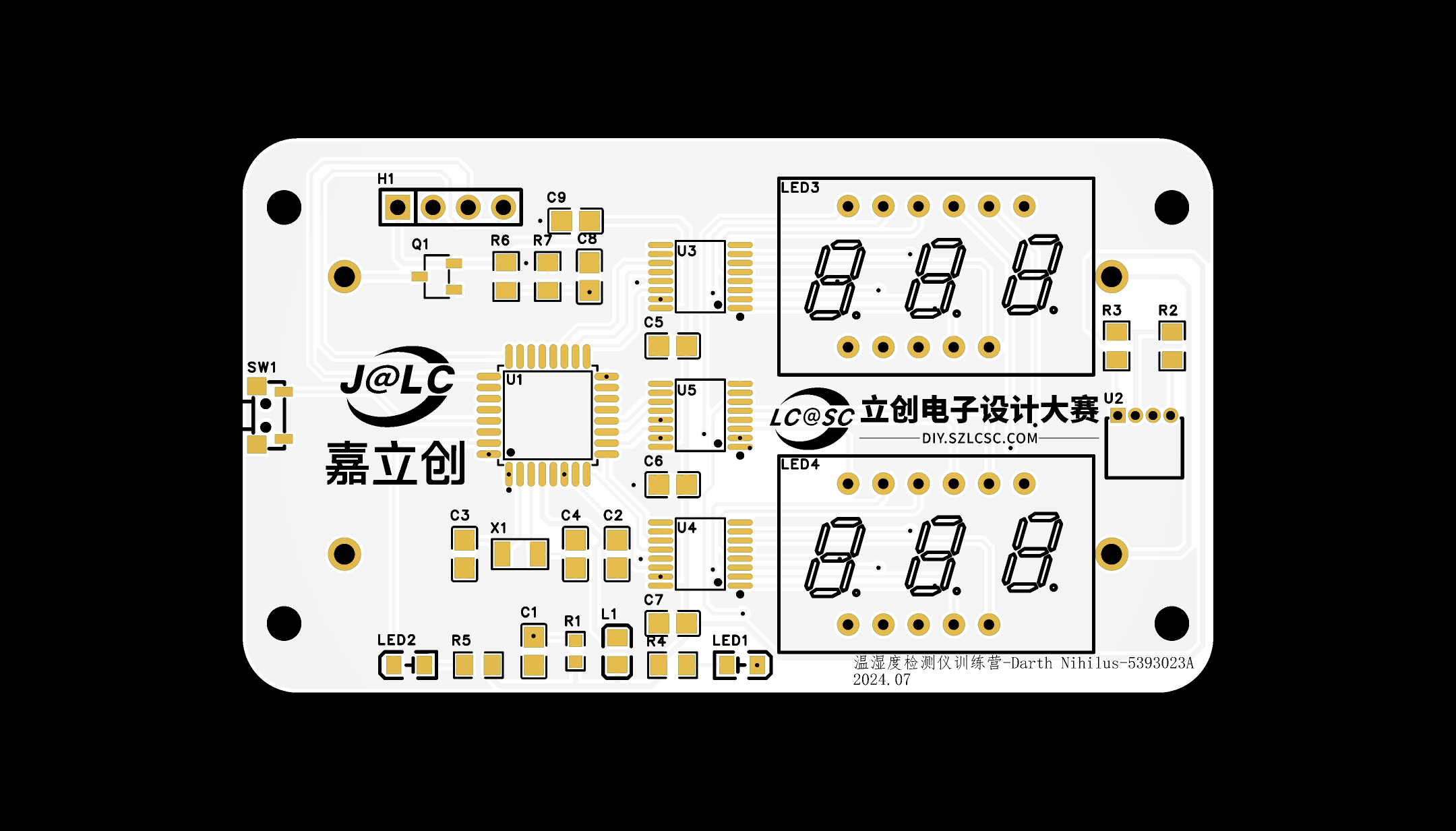

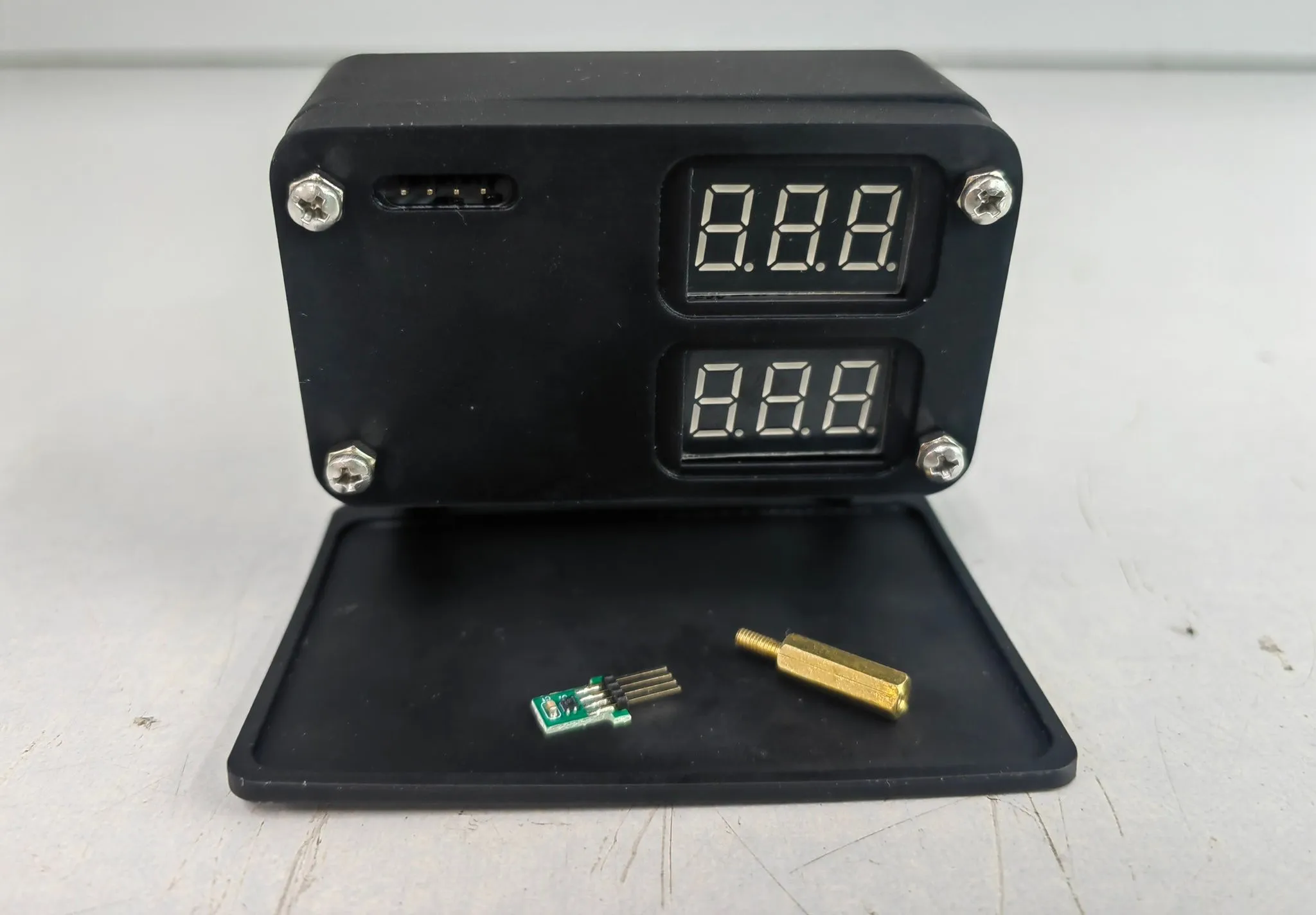

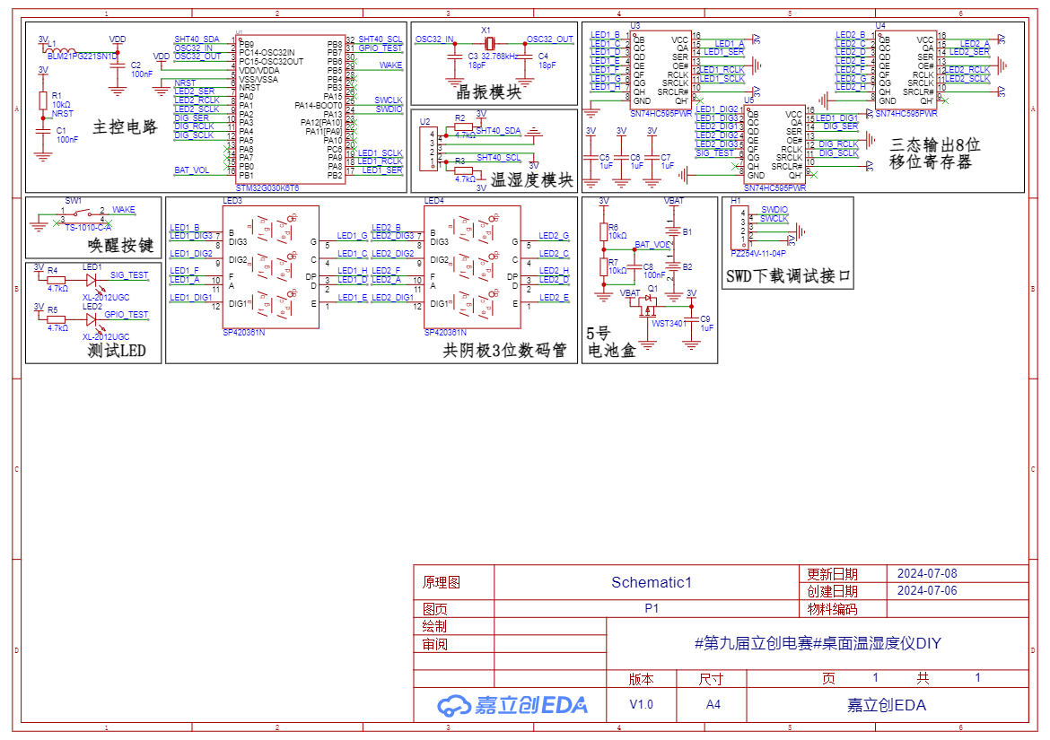

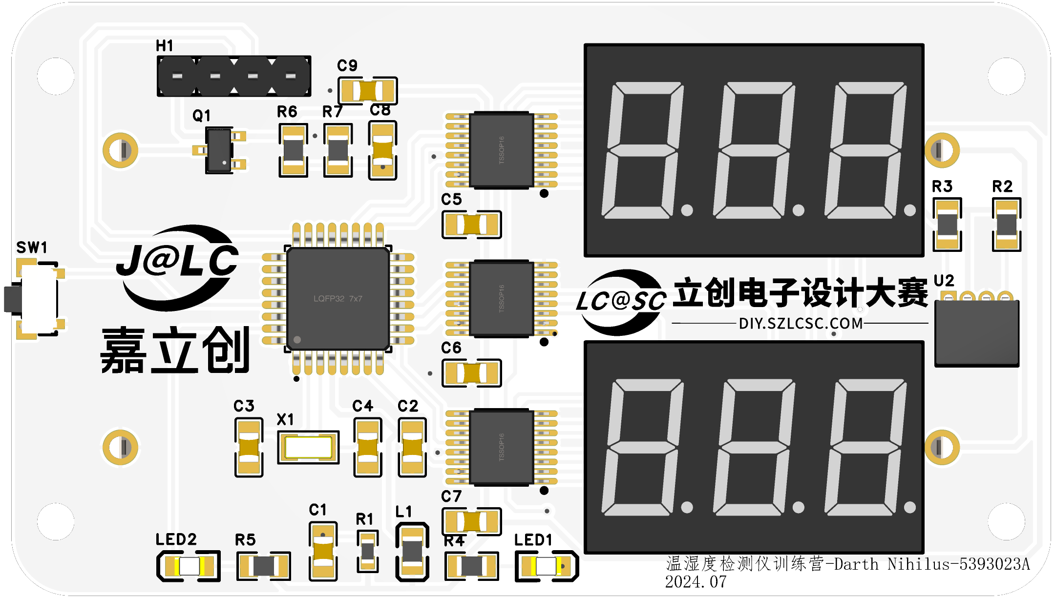

The hardware design
includes schematics,
PCB
layout, physical renderings, and
a
3D exterior shell .

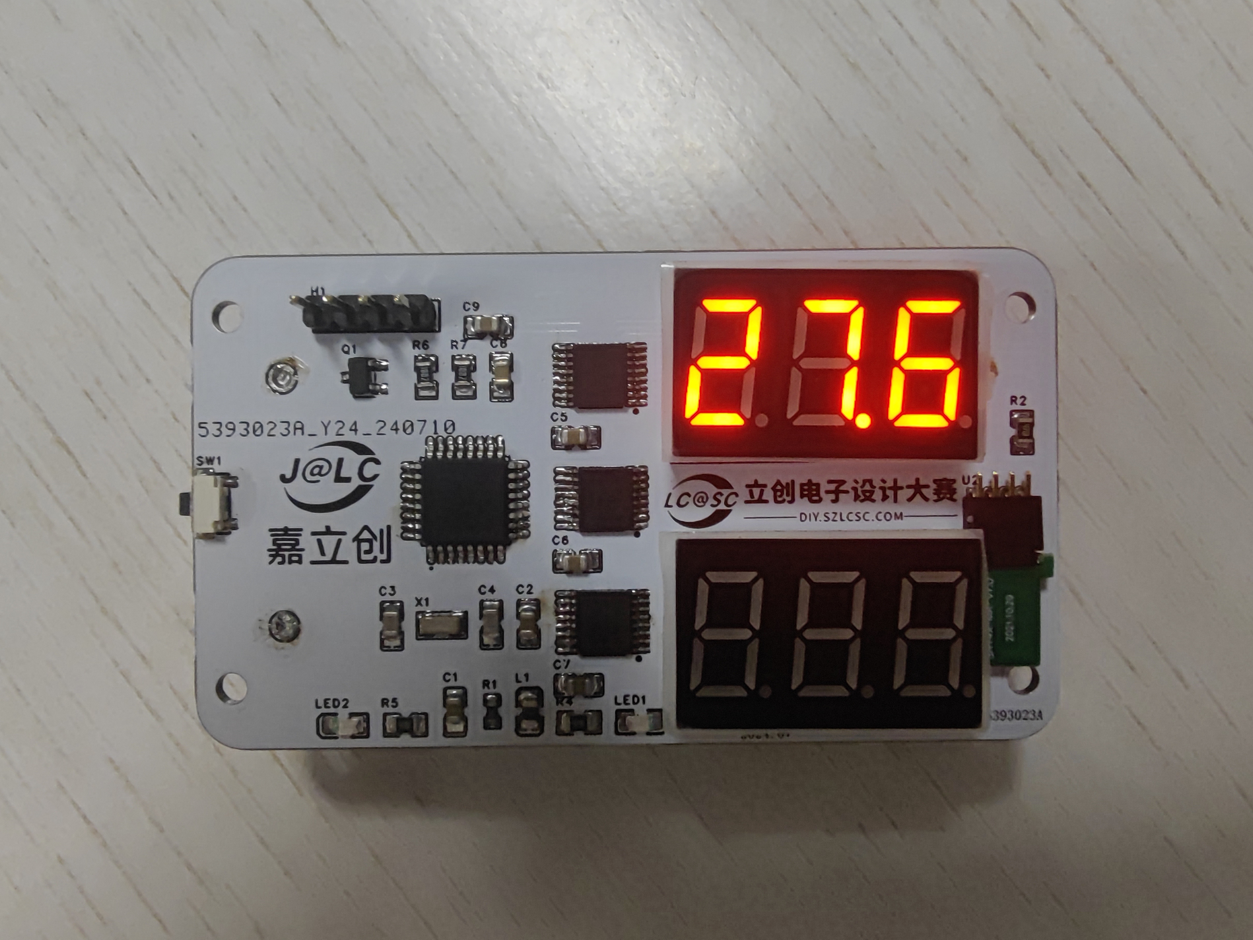

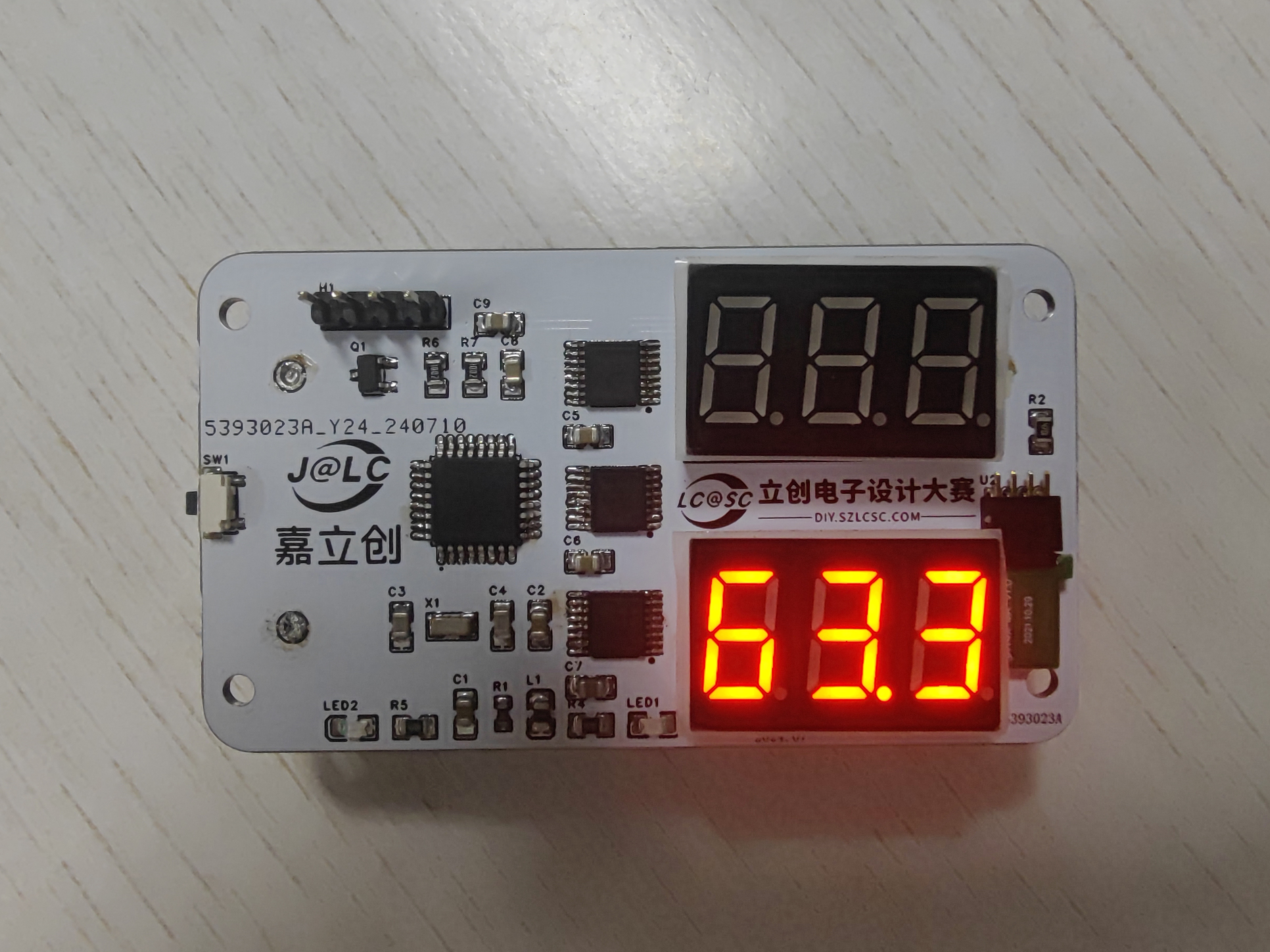

The software design
       was created using "Project.7z" for programming.
       The following results are a demonstration of the "Project.7z" results,
showcasing
temperature and
humidity displays .

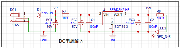

1. Power Supply
Circuit
LDO (Low Dropout Linear Regulator) Selection
This project uses an LDO as the power supply. Considering that most voltmeter products are used in industrial scenarios with 24V or 36V power supplies, the SE8550K2 with a maximum input voltage of up to 40V was selected as the power supply. The main reason for not using a DC-DC step-down circuit to handle the large voltage drop is to avoid introducing DC-DC ripple interference during the design process; a secondary reason is to reduce project costs.

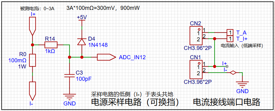

4. Current Sampling Circuit
This project uses a low-side current sampling circuit for current detection. When learning the common ground between the low-side of the sampling circuit and the meter interface on the development board
, please do not solder R0!!!
The design analysis
for this project involves a sampling current of 3A, and the selected sampling resistor (R0) is 100mΩ.
The selection of the sampling resistor mainly needs to consider the following aspects:
the maximum value of the pre-designed measurement current;
the voltage difference caused by the 3A current sensing resistor in this project; and
the power dissipation of the current sensing resistor, which should generally not exceed 0.5V. A suitable package should be selected based on this parameter. Considering the power dissipation (temperature) issue under high current, a 1W metal wire-wound resistor package was chosen
. The voltage amplification factor across the current sensing resistor is also important. Since no operational amplifier is used to build the amplification circuit in this project, the factor is 1.
The current sensing resistor value can then be calculated using the above parameters
. Since no amplifier circuit is used, a larger sampling resistor is needed to obtain a higher measured voltage for measurement.
Considering that a larger resistor would result in a larger voltage drop and higher power consumption, an unlimited selection of a larger resistor is not feasible.
This project uses a 1W package resistor, corresponding to a power consumption of 1W.
Based on the above data, a 100mΩ current sensing resistor was selected. According to the formula, 3A * 100mΩ = 300mV, 900mW can be calculated.
To cope with different operating environments, especially high-current scenarios, the R0 resistor can be replaced with constantan wire or a shunt. The replacement can be selected according to the actual application scenario. For safety and educational purposes, this project will not discuss measurements exceeding 3A in detail, but the principle is the same.

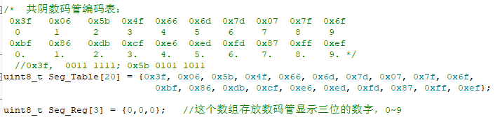

Encoded Display:
In order for the digital tube to display the corresponding numbers or characters, the segment data port must output the corresponding character encoding. For example, to display the number "0", the character code for a common anode seven-segment display is 11000000B (i.e., C0H), while the character code for a common cathode seven-segment display is 00111111B (i.e., 3FH). The specific code depends on the actual seven-segment display.
Dynamic and Static Display:
Seven-segment displays can use either static or dynamic display methods. In static display, each of the eight segments of a seven-segment display is connected to an 8-bit I/O port address. As long as the I/O port outputs a segment code, the corresponding character is displayed and remains unchanged. Dynamic display, on the other hand, lights up each segment of the seven-segment display one by one, achieving simultaneous visual display through rapid switching.
In summary, the driving principle of seven-segment displays is to control the switching state of each segment of the seven-segment display to display numbers, letters, or symbols, and to achieve display switching between multiple seven-segment displays through segment selection and digit selection. Simultaneously, the driving of the seven-segment display can be implemented through hardware circuits or software control, and common cathode or common anode seven-segment displays can be selected as needed.
This project actually uses dynamic scanning display to drive the seven-segment display.

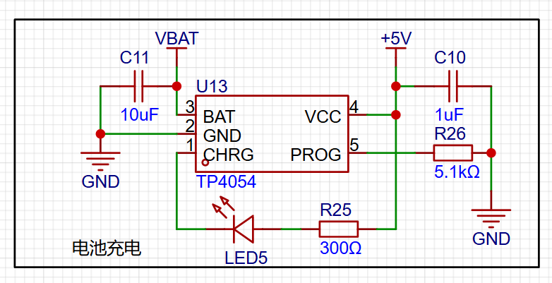

I. Circuit:
The basic circuit followed the tutorial, but a battery charging/power switching circuit was added for portable use.
A small current, small battery was used; the TP4054 was inexpensive and practical .
The more commonly used 78M05 LDO was chosen, with a maximum input of 35V.
With the battery added, power switching needed to be considered. Charging occurs when an external power source is available, and battery power is available when no external power source is available, with the option to turn it off.
A PMOS 2301 is used for the external power source, controlled by a sliding switch. D5 and the PMOS work together to prevent backflow.
When an external power source is available, the battery does not provide power.
Several minor modifications were made: the voltage reference source was a Ref3025 that I had on hand, and the digital tube used a common anode design.
II. PCB
: Thanks to JLCPCB for providing color silkscreen printing; I tried it out, and the output was good, although the printing time was slightly longer than with regular silkscreen printing.

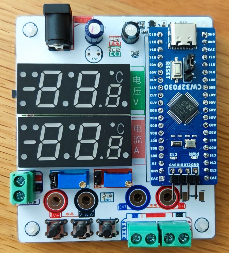

This project was created based on the official CW32 digital voltmeter and ammeter training camp tutorial document from LCSC | LCSC Development Board Technical Documentation Center (lckfb.com).
Hardware Notes:
1. For the upper measurement section, it is recommended to use thicker terminals. I found that the pin header's rated current is exactly 3A, and to exceed the required measurement range, it is recommended to replace it with one capable of handling a larger current.
2. Pay attention to the power rating of the resistors, especially the 100MR R0. To achieve the 3A measurement range, a package of 1W or higher is needed.
3. It is recommended to use a 3296W resistor with a handle for easy value adjustment.
4. After soldering, it is recommended to use a multimeter to check for short circuits between the power supply and ground, as there will be a significant voltage difference. For safety, ensure there are no short circuits.
5. Pay attention to the polarity of the aluminum electrolytic capacitors, clamping diodes, and LEDs.
Software: Refer to LCSC's official example code.
Pay attention to the final voltage and current calibration; otherwise, there will be some errors.
For voltage calibration, press K1, connect JP1, set the multimeter to voltage mode (greater than 15V), insert T_V and T_GND. When the voltmeter displays 5V, press K2 to complete the 5V calibration; press K2 twice to enter the 15V calibration, and so on.
For current calibration, R0 needs to be soldered, JP2 does not need to be shorted, set the multimeter to current mode (greater than 3A), connect the power supply positive to CN2, and the negative to the left side of CN1. Adjust the power supply to perform 0.5A and 1.5A calibrations.
(The above points are basically problems I encountered during the production process. Since I don't have an adjustable power supply on hand, I couldn't perform current calibration, so I only performed voltage calibration, which is accurate as you can see from the cover. Also, the 3D file was incorrect; the screw holes around the edges prevented the board from fitting, so the 3D shell production failed.)

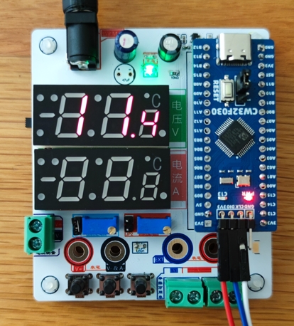

The voltage and current meter based on the CW32 development board uses two 3-digit LED displays.
I. Project Introduction
This project is a LCSC training camp project, using a CW32 development board + expansion board to build a voltage and current meter. The components are designed with basic sampling plug-in type for easy soldering.
The main control core board uses the domestic Wuhan Xinyuan Semiconductor CW32 as the main controller, while also being compatible with other similar development boards; however, the CW32 has advantages.
The training camp provides rich design documents, explaining everything from component selection to circuit design and software design, for in-depth learning.
Training camp document link: CW32 Digital Voltage and Current Meter Training Camp Project Tutorial Document | LCSC Development Board Technical Document Center (lckfb.com)
Accompanying video link: LCSC Development Board Personal Space - LCSC Development Board Personal Homepage - Bilibili Video (bilibili.com)

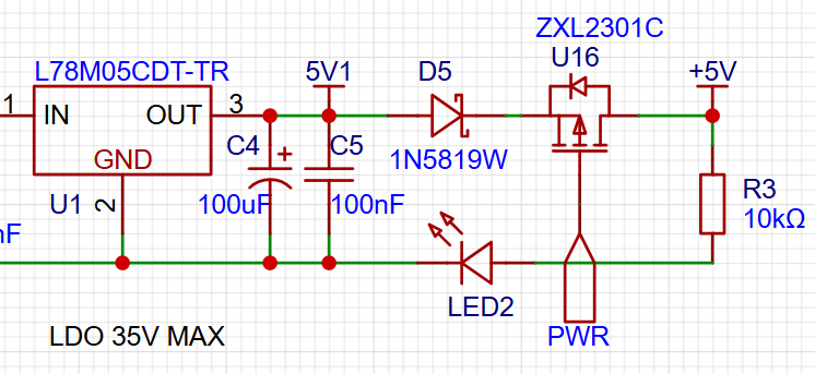

1. Power Supply Circuit
LDO (Low Dropout Linear Regulator) Selection This project uses an LDO as the power supply. Considering that most actual voltage meter products are used in industrial scenarios with 24V or 36V power supplies, this project selected the SE8550K2 with a maximum input voltage of up to 40V as the power supply. The main reason for not using a DC-DC step-down circuit to handle large voltage differences in this project is to avoid introducing DC-DC ripple interference during the design process. A secondary reason is to reduce project costs.

program
defines 5 working modes. The SW1 key is used to switch the display mode. The SW2 key sets the parameter value for the corresponding mode and saves it to FLASH. The SW3 key returns to mode 0.
Mode 0: Displays normal voltage and current values ​​(the upper row of digital tubes displays the voltage value *.V or .*V automatically, the lower row displays the current value _.**A).
Mode 1: 5V voltage calibration setting. The upper row of digital tubes displays 5.05. The lower row displays the current voltage value _.V or ._V. In this mode, the multimeter should be set to 5.00V to measure the measured bit. After pressing the SW2 key, the current value is calibrated to 5V.
Mode 2: 15V voltage calibration setting. The upper row of digital tubes displays 5.15. The next row displays the current voltage value as _.V or ._V. In this mode, the multimeter should be set to 15.0V when measuring the measured part. After pressing the SW2 key, the current value is calibrated to 15V.
Mode 3: Current 0.5A calibration setting. The upper row of the digital tube displays A.0.5. The next row displays the current current value as _.**A. After pressing the SW2 key, the current value is calibrated to 0.5A.
Mode 4: Current 1.5A calibration setting. The upper row of the digital tube displays A.1.5. The next row displays the current current value as *.**A. After pressing the SW2 key, the current value is calibrated to 1.5A.
