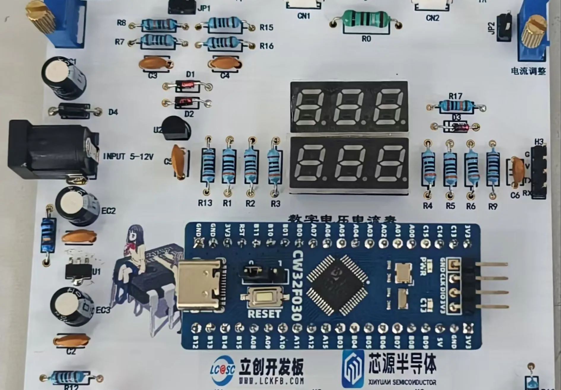

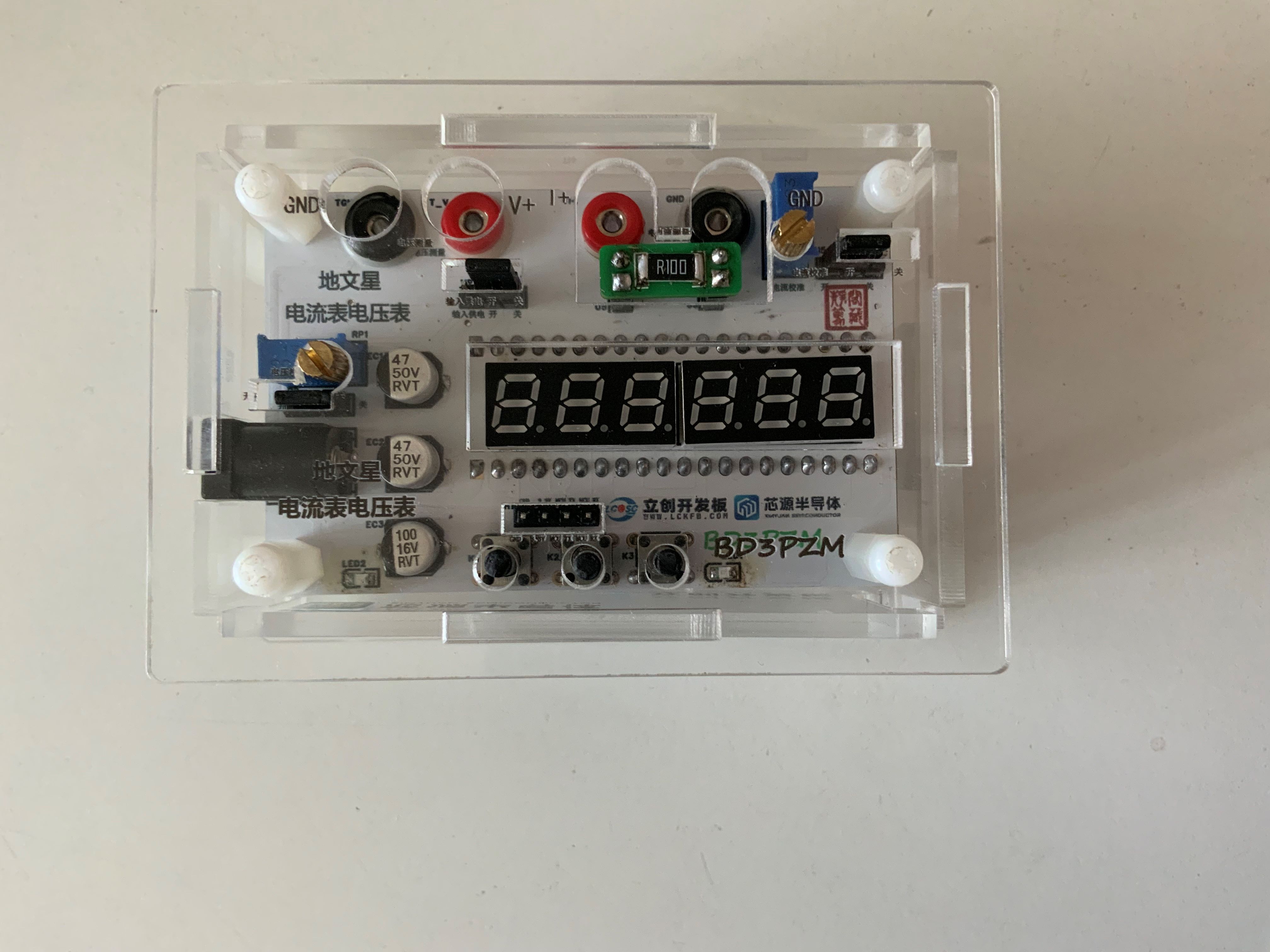

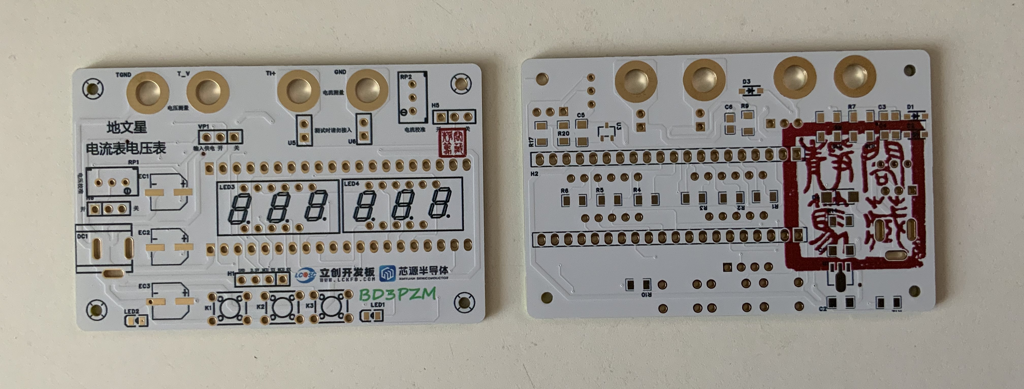

it adopts a core board plus expansion board design concept and uses plug-in components, making learning simpler and exploration more in-depth;
the core board uses the domestic Wuhan Xinyuan Semiconductor CW32 as the main controller, while also being compatible with other similar development boards; however, the CW32 has advantages.
The project is highly comprehensive and practical, and after completion, it can be used as a desktop instrument;

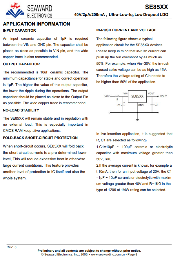

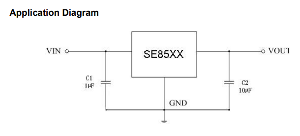

The design manual for the capacitor
provides the application schematic of this LDO:
the principle of almost all LDO devices is basically the same when designing circuits. Therefore, the reference significance of this diagram is not very high. The more common considerations are how C1 and C2 should be designed. If your LDO has EN (enable), you also need to consider the design of the enable pin to ensure that the chip works properly. In addition, some LDOs have adjustable outputs, which have a dedicated pin (adj) that requires the configuration of corresponding external resistors to achieve the specified output voltage.
The most crucial part of LDO peripheral circuit design is the design of the capacitors.
The capacitors around the LDO play a key role in the circuit, and their functions mainly include the following aspects:
Filtering: The capacitors around the LDO, especially the input capacitor, can effectively filter out the ripple interference from the previous power supply.
Improving load transient response: The output capacitor plays an important role in improving the load transient response. When the load current changes rapidly, the LDO has an adjustment time. At this time, the output capacitor acts as a temporary power supply to provide the required current to the circuit and prevent the output voltage from being pulled too low. A larger output capacitor value can further improve the transient response of an LDO to large load current changes.
Phase compensation: For adjustable output LDOs, the capacitor connected in parallel with the upper resistor (R1) (called the feedback capacitor CFB) provides leading phase compensation, increasing oscillation margin and improving load transient response. Zeroing both CFB and R1 contributes to loop stability.
Oscillation prevention: Proper capacitor configuration can help prevent oscillations in the LDO circuit, ensuring stable circuit operation.
Ripple suppression: Capacitors in LDOs also help improve the power supply rejection ratio (PSRR), reducing the impact of power supply noise on circuit performance.
Startup inrush current control: The input capacitor acts as a temporary power source for startup inrush current during LDO startup, preventing the input voltage from being pulled low and affecting the stability of the preceding power supply.
Summary: The capacitors surrounding the LDO play an important role in filtering, improving load transient response, phase compensation, oscillation prevention, ripple suppression, and startup inrush current control. By properly configuring these capacitors, the stability and performance of the LDO circuit can be ensured.
If you carefully review the datasheet, you'll find that the official documentation provides detailed suggestions and references, including layout design recommendations. This avoids engineers having to perform a lot of complex theoretical calculations.
It's worth noting that in my power supply design, I used electrolytic capacitors and ceramic capacitors connected in parallel, one after the other. When electrolytic and ceramic capacitors are connected in parallel, they can be "matched in high and low frequencies," resulting in good filtering in both high and low frequency ranges. Electrolytic capacitors filter out low-frequency interference, while ceramic capacitors filter out high-frequency interference; their combination achieves better filtering.

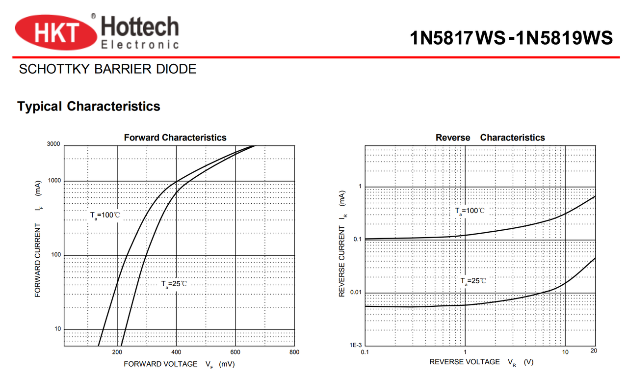

Note: This project uses a series diode for reverse connection protection because the power supply voltage of this device is usually higher than 5V; the 0.7V voltage drop of the diode will not affect the power supply. When the supply voltage is low, the overall power consumption of the project is low, and the measured supply current is low (20mA). Due to the unique structure of the Schottky diode D4 (1N5819), its VF is lower than that of general-purpose switching diodes, as shown in the figure below, with a voltage drop of approximately 0.2V or less.
In conventional circuit design, using a reverse-parallel diode + series fuse can also achieve the purpose of reverse connection protection and circuit protection.
The diode voltage-current curve and
the role of the series small resistor (10Ω) are also discussed.
This project additionally uses a series small resistor (10Ω) for voltage division. This serves two purposes: firstly, it reduces the problem of excessive heat generation in the LDO due to large voltage differences under high voltage conditions; secondly, it utilizes the principle that the series 10-ohm low-power resistor has low overcurrent, acting as a low-resistance fuse to provide overcurrent or short-circuit protection. (The reason the resistor acts as a fuse is that, under overcurrent and heating conditions, it is 99% likely to be an open circuit, rarely short-circuiting. Its fault analysis dictates that it will primarily be an open circuit—that is, it will burn out rather than short-circuit.)
The series small resistor (10Ω) also reduces the peak value of the power-on surge, preventing excessive surges from damaging the LDO.
If electrolytic capacitors were not used, the series small resistor (10Ω) also prevents resonance between the wire inductance and the ceramic capacitor during hot-plugging. Because ceramic capacitors have very low ESR, the damping in the LC network is minimal, resulting in high gain at the resonant point. Adding an external resistor to provide damping suppresses this gain.

When drawing power supply circuits, whether in schematics or PCB layouts, several points should be noted:
Schematic Standards: GND should face down, power supply should face up; avoid ground facing upwards.
Capacitor Design: In both schematics and PCB layouts, electrolytic capacitors should come first, followed by ceramic capacitors. Grounding
Design: Single-point grounding; the ground of the current power supply should be connected to the GND of the main electrolytic capacitor of the current power supply, and the main electrolytic capacitors of each stage of the power supply should be connected to the GND of the main electrolytic capacitor of the preceding stage.

To reduce the learning cost, this project uses the LCSC CW32F030C8T6 development board (core board) as the main controller, but this does not mean we will discuss this section less. From the perspective of training engineers, the correct selection of the main controller is very important, as it relates to the overall advantage of the project.

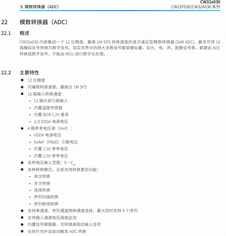

Key features of CW32's ADC:
This project requires a focus on 4 reference voltage sources. Content from the "CW32x030 User Manual".

The ADC reference voltage in this project is 1.5V, which can be configured through the program.

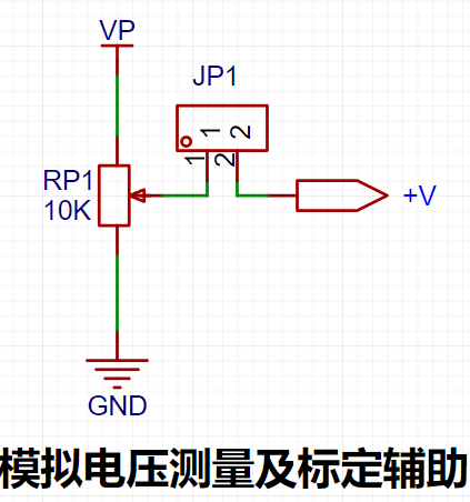

There are many ways to implement range switching, and the development board design provides more design possibilities. Next to
the circuits used for simulating voltage measurement, measurement calibration, and measurement calibration assistance,

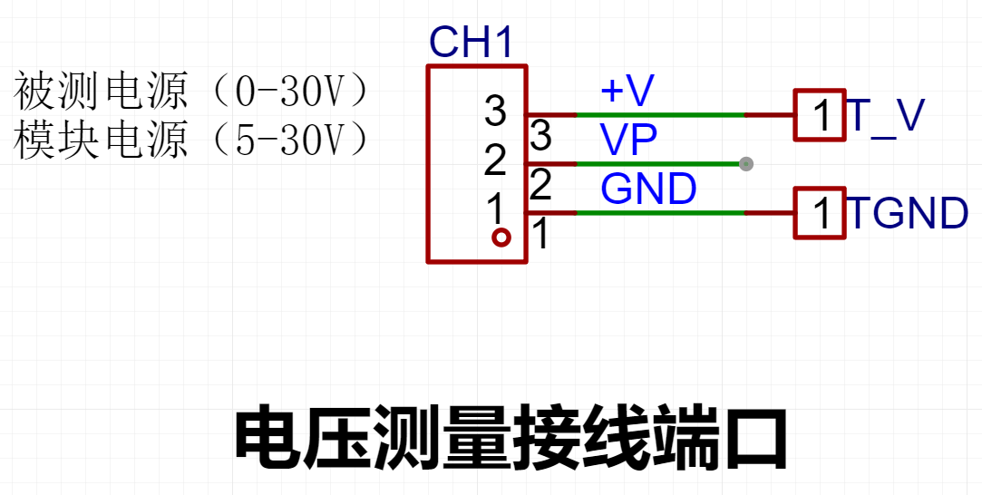

the components labeled T_V and T_GND are the 2mm banana plug interfaces on the development board, used to connect multimeter probes. You can insert the probes of a multimeter or a high-precision benchtop digital multimeter to verify the accuracy of the development board's measurements. You can also insert 2mm banana plug multimeter probes to replace the CH1 port for handheld measurements.
The VP pin is the power supply pin for the development board and should not be connected when using the DC port. When not using DC port power and the measured value is greater than 5V and less than 30V, it can be connected to the power supply under test, or it can be powered independently.
When learning the measurement principles of the corresponding circuits, considering that users may not be able to easily build peripheral circuits for testing and debugging, and adhering to the principle of ease of development of the development board, auxiliary circuits for simulating voltage measurement, measurement calibration, and measurement calibration are specially set up. No external voltage is required for CH1. Use a multi-turn adjustable potentiometer (RP1) to divide the power supply voltage of the development board and connect it to the +V network through the internal circuitry of the development board. Note that JP1 needs to be shorted at this time; a jumper cap is sufficient, and a long-handled jumper cap is recommended. Do not short JP1 if this function is not used.

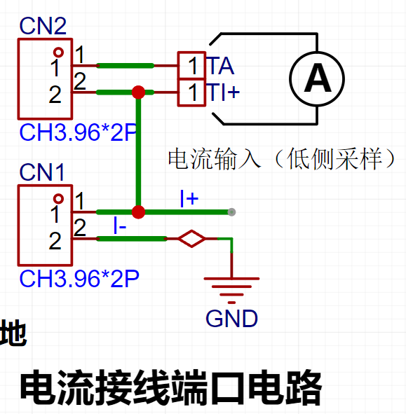

This project uses a low-side current sampling circuit for current detection. When learning the low-side of the sampling circuit and the meter interface of the development board
, do not solder R0!!!
Design Analysis:
The sampling current in this project is 3A, and the selected sampling resistor (R0) is 100mΩ.

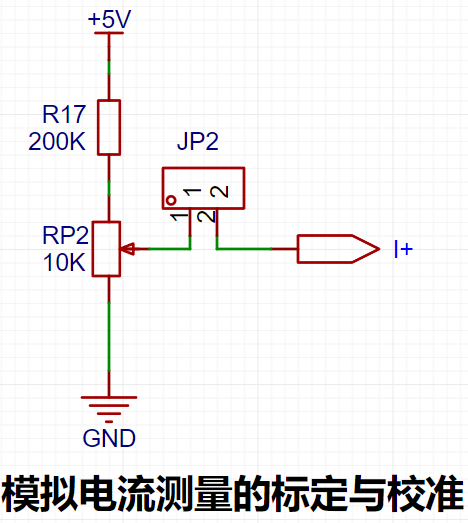

auxiliary circuits for simulating current measurement, measurement calibration, and measurement adjustment,
do not solder the R0 sampling resistor. If this function is not used, disconnect JP2.
The essence of current sampling is to collect the voltage drop across the sampling resistor when current flows through it, i.e., the collected voltage value. This circuit uses RP2 to provide a voltage value in the range of 0~0.238V (5V ÷ 210K * 10K), which is connected to the chip's current sampling pin via the I+ network.
In actual use, the voltage at I+ simulates the voltage drop across the unsoldered 100mΩ sampling resistor. Therefore, the simulated measured current value Imeasured = this voltage value Vi+ ÷ 100mΩ, which is also exactly equal to the measured voltage value multiplied by 10. That is, it provides a simulated current measurement of 0~2.38A.
Set a multimeter or high-precision benchtop digital multimeter to the voltage measurement port, with a range within 3V. Insert the black negative probe into the T_GND interface next to the voltage measurement terminal, and the red positive probe into the TI+ port for current measurement to measure the actual voltage value of I+. Thus, this circuit can not only complete the above design tasks but also allow for a direct test of the accuracy of the MCU's ADC peripheral. You can write your own program to verify this.

4. Current Sampling Circuit
This project uses a low-side current sampling circuit for current detection. When the low-side of the sampling circuit shares a common ground with the development board's meter interface, please do not solder R0!!!
Design Analysis
The sampling current designed in this project is 3A, and the selected sampling resistor (R0) is 100mΩ. The sampling selection mainly needs to consider the following aspects:
the maximum value of the pre-designed measurement current, which in this project is
the voltage difference brought by the 3A current sensing resistor. It is generally not recommended to exceed 0.5V.
The power consumption of the current sensing resistor should be selected according to this parameter. Considering the power consumption (temperature) problem under high current, a 1W packaged metal wire-wound resistor was selected in this project.
The voltage amplification factor on the current sensing resistor: No operational amplifier was used to build the amplification circuit in this project, so the factor is 1.
Then, the current sensing resistance value can be calculated using the above parameters. Selection:
Since this project... Since no amplifier circuit is used, a larger sampling resistor is needed to obtain a higher measured voltage for measurement.
Considering that a larger resistor would result in a larger voltage drop and higher power consumption, a larger resistor cannot be chosen indiscriminately.
This project uses a 1W package resistor, corresponding to a power rise of 1W.
Based on the above data, a 100mΩ current sensing resistor was selected. According to the formula, 3A * 100mΩ = 300mV, 900mW can be calculated.
To cope with different usage environments, especially high current scenarios, the R0 resistor can be replaced with constantan wire or a shunt. The replacement can be chosen according to the actual usage scenario. For safety and educational purposes, this project will not discuss measurements exceeding 3A, but the principle is the same.

1. Power Supply Circuit
LDO (Low Dropout Linear Regulator) Selection This project uses an LDO as the power supply. Considering that most voltmeter products are used in industrial scenarios with 24V or 36V power supplies, this project selected the SE8550K2, which has a maximum input voltage of up to 40V, as the power supply. The main reason for not using a DC-DC buck converter to handle the large voltage drop is to avoid introducing DC-DC ripple interference during the design process; a secondary reason is to reduce project costs.

The main characteristics of the CW32 ADC: This project requires a focus on the 4 reference voltage sources. (Content from the "CW32x030 User Manual")
3. Voltage Sampling Circuit:
The voltage divider resistors in this project are designed to be 220K+10K, therefore the voltage division ratio is 22:1 (ADC_IN11).
The voltage divider resistor selection
is designed to measure the maximum voltage. For safety reasons, this project uses 30V (the actual maximum display value can be 99.9V or 100V).
The ADC reference voltage is 1.5V in this project, and this reference voltage can be configured through the program.
To reduce the power consumption of the sampling circuit, the low-side resistor (R7) is usually chosen as 10K based on experience.
Then, the high-side resistance of the voltage divider resistor can be calculated using the above parameters.
The required voltage division ratio is calculated, i.e., the ADC reference voltage. The input voltage is designed; using known parameters, 1.5V/30V = 0.05 can be calculated.
The high-side resistance is calculated as the low-side resistance/voltage division ratio; using known parameters, 10K/0.05 = 200K can be calculated.
A standard resistor is selected: a resistor slightly higher than the calculated value of 200K is chosen. We usually choose E24 series resistors; therefore, in this project, 220K, which is greater than 200K and closest to the calculated value, is selected.
If, in actual use, the voltage to be measured is lower than 2/3 of the module's design voltage (66V), the voltage divider resistor can be replaced and the program modified to improve measurement accuracy. The following example illustrates this:
Assuming the measured voltage is no higher than 24V and other parameters remain unchanged,
calculations show 1.5V/24V = 0.0625, 10K/0.0625 = 160K. 160K is a standard E24 resistor and can be directly selected, or a higher value 180K can be chosen with some redundancy.
If, in actual use, the voltage to be measured is higher than the module's 99V design voltage, a different resistor can be selected. To achieve a wider voltage measurement range, one can choose to replace the voltage divider resistor or modify the reference voltage. The following example illustrates this:
Assuming the measured voltage is 160V, the solution is to increase the voltage reference to expand the range.
Given that the voltage division ratio of the selected resistor is 0.0145, we can calculate 160V * 0.0145 = 2.32V using the formula. Therefore, we can choose a 2.5V voltage reference to expand the range (increasing the range will reduce accuracy).
Considering the potential fluctuations in the measured power supply, a 10nF filter capacitor is connected in parallel with the low-side voltage divider resistor to improve measurement stability.
The
sampling current designed for this project is 3A, and the selected sampling resistor (R0) is 100mΩ. The following aspects should be considered when selecting the sampling resistor:
the maximum value of the pre-designed measurement current;
the voltage difference caused by the 3A current sensing resistor in this project; generally, it is not recommended to exceed 0.5V;
the power consumption of the current sensing resistor; a suitable package should be selected based on this parameter; considering the power consumption (temperature) issue under high current, a 1W packaged metal wire-wound resistor was selected ;
the voltage amplification factor of the current sensing resistor: no operational amplifier is used to build the amplification circuit in this project, so the factor is 1. The
current sensing resistor value can then be calculated using the above parameters.
Considering that a larger resistor would result in a larger voltage drop and higher power consumption, an unlimited selection of a larger resistor is not feasible.
This project uses a 1W package resistor, corresponding to a power consumption of 1W.
To cope with different operating environments, especially high-current scenarios, the R0 resistor can be replaced with constantan wire or a shunt. The replacement can be selected according to the actual application scenario. For safety and educational purposes, this project will not discuss measurements exceeding 3A in detail, but the principle is the same.

8. TL431 Circuit Design for Voltage Measurement and Calibration:
This project adds an extra TL431 circuit to provide a 2.5V reference voltage, which can be used to provide an external voltage reference for calibrating the AD converter. From a product design perspective, due to the CW32's inherent ADC performance advantages, this circuit is not necessary. This circuit is designed on the development board for learning related application principles.
III. Product Diagram and Brief Introduction:

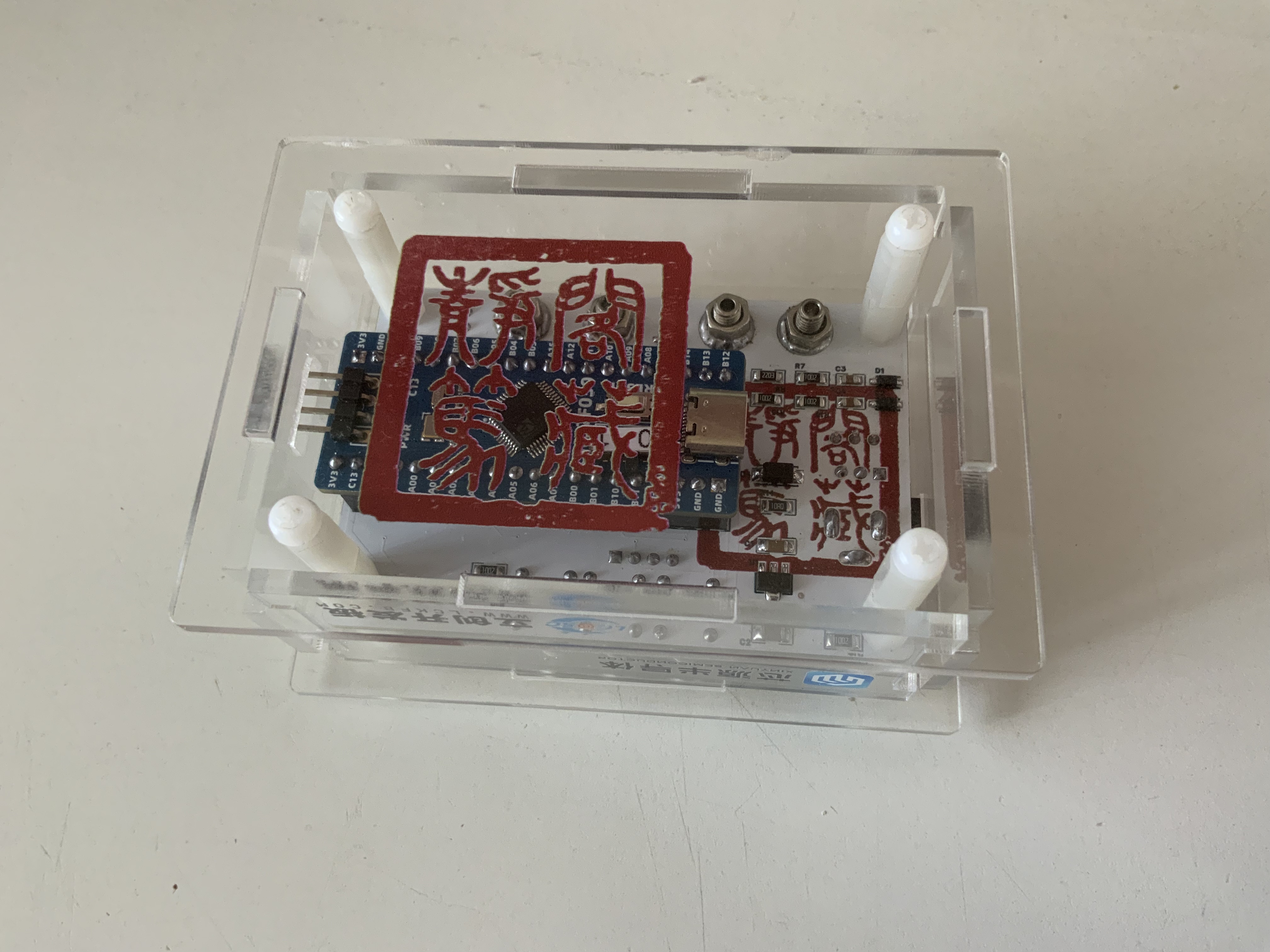

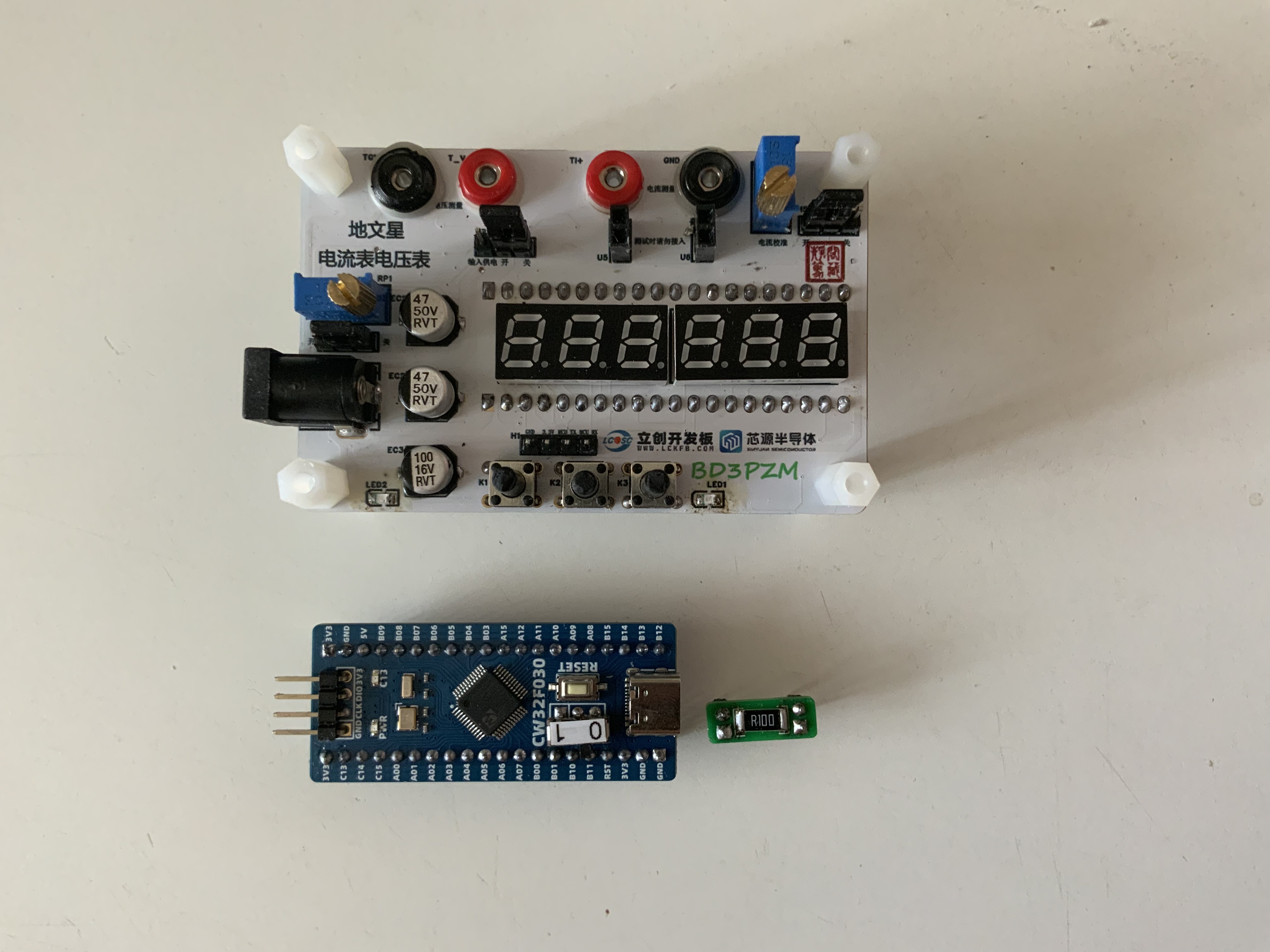

Thanks to JLCPCB's monthly freebie program, five boards were made at once. I must say, JLCPCB's immersion gold and color silkscreen printing processes are truly beautiful.
This is what it looks like after soldering the components. I changed the jumpers on the CW32 development board to single-pole double-throw switches
. This is what it looks like after installing the casing. Due to my lack of experience in designing boards for the first time, the long side of the vertical panel is 6mm shorter. The diagrams in the open-source file have been modified. The acrylic casing for the digital display has a windowed design to reduce glare. This window can be removed if aesthetics and a more cohesive look are desired.
Finally, I would like to thank LCSC Development Board and Sinyuan Semiconductor for organizing this training camp, which allowed me to systematically learn about PCB design and development boards.
