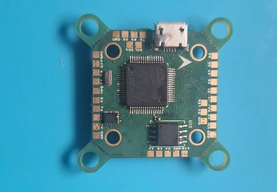

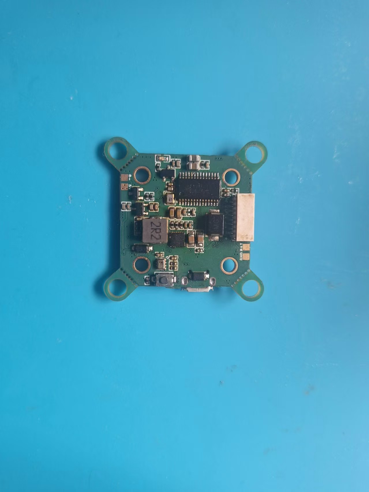

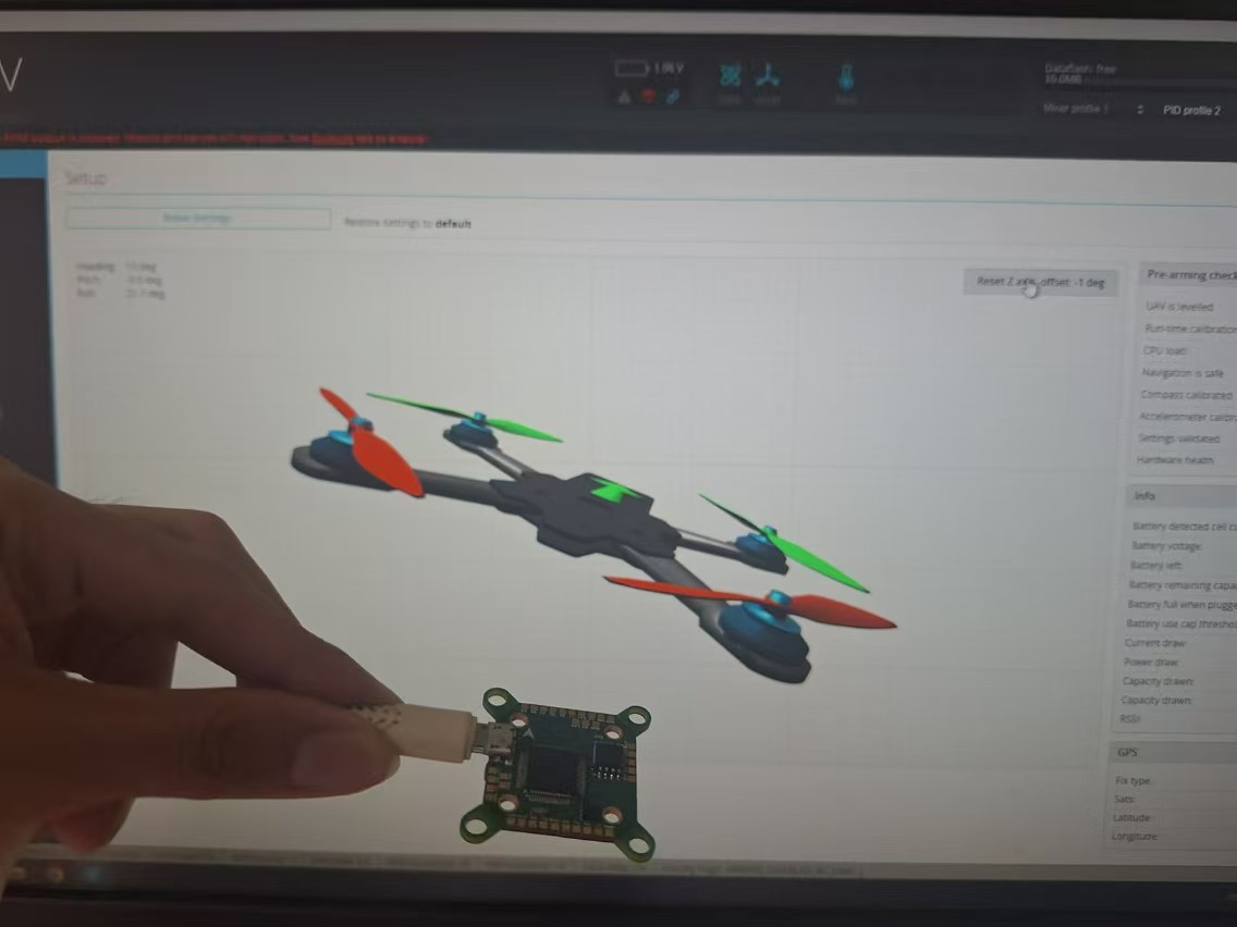

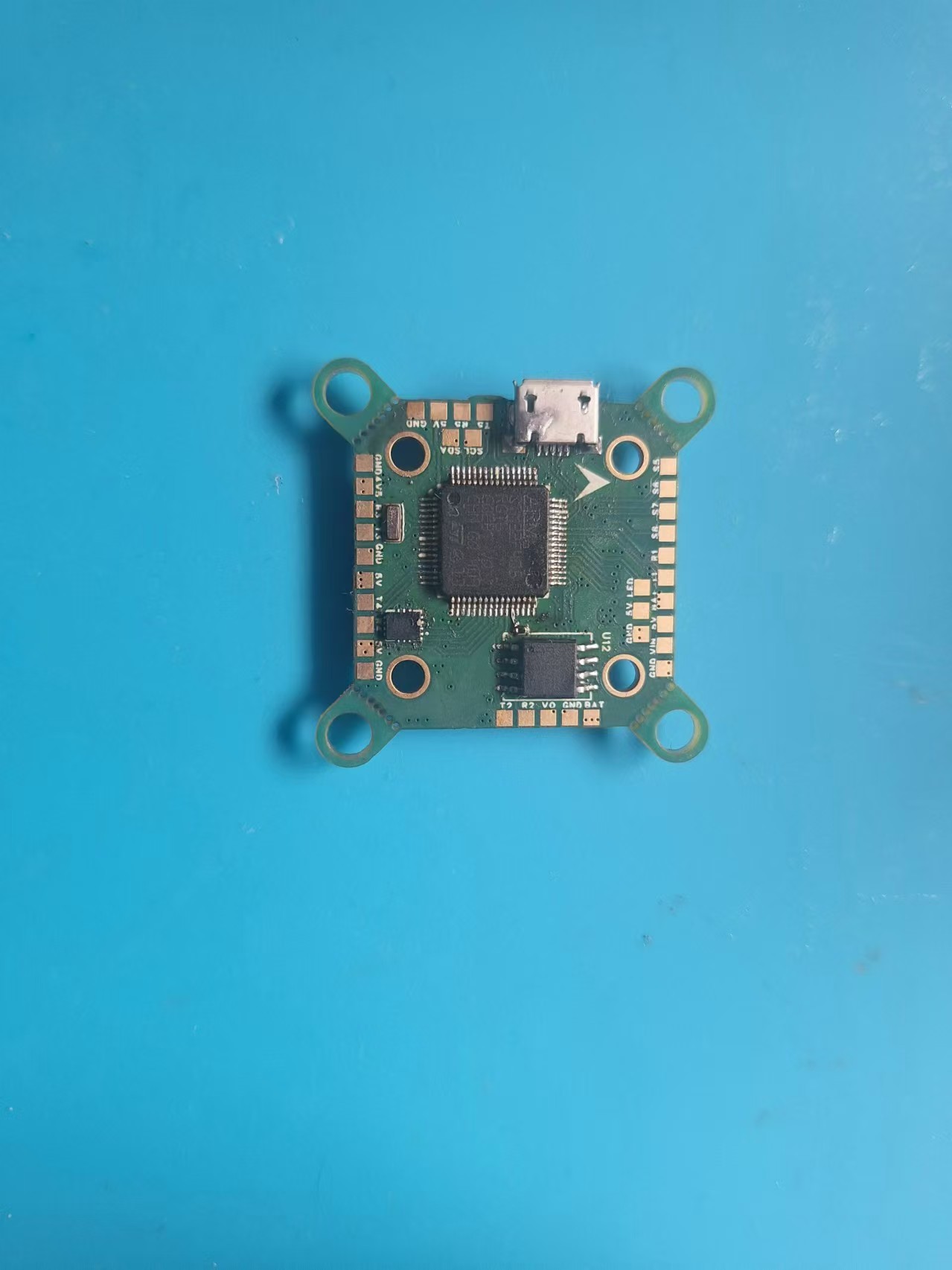

STM32F405 flight controller is compatible with STM32F722 and F446.
The 5 serial ports and 8 PWM
resistors and

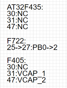

capacitors are all located on the back, reducing surface mount costs. The main controller can use F722, F446, or F405; the gyroscope can use BMI160 or ICM42688; the barometer
can use BMP280 or DSP310. F722 and F446 are directly usable; F405 requires replacing the VCAP pin capacitor. AT32F435 is theoretically usable, but untested.

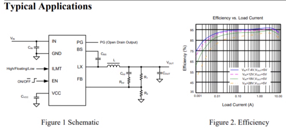

The DC-DC power supply IC is SY8368, using a 2.2UH0530 inductor, providing a continuous 5.5A and a saturation 8A current. (
Finished product image)
