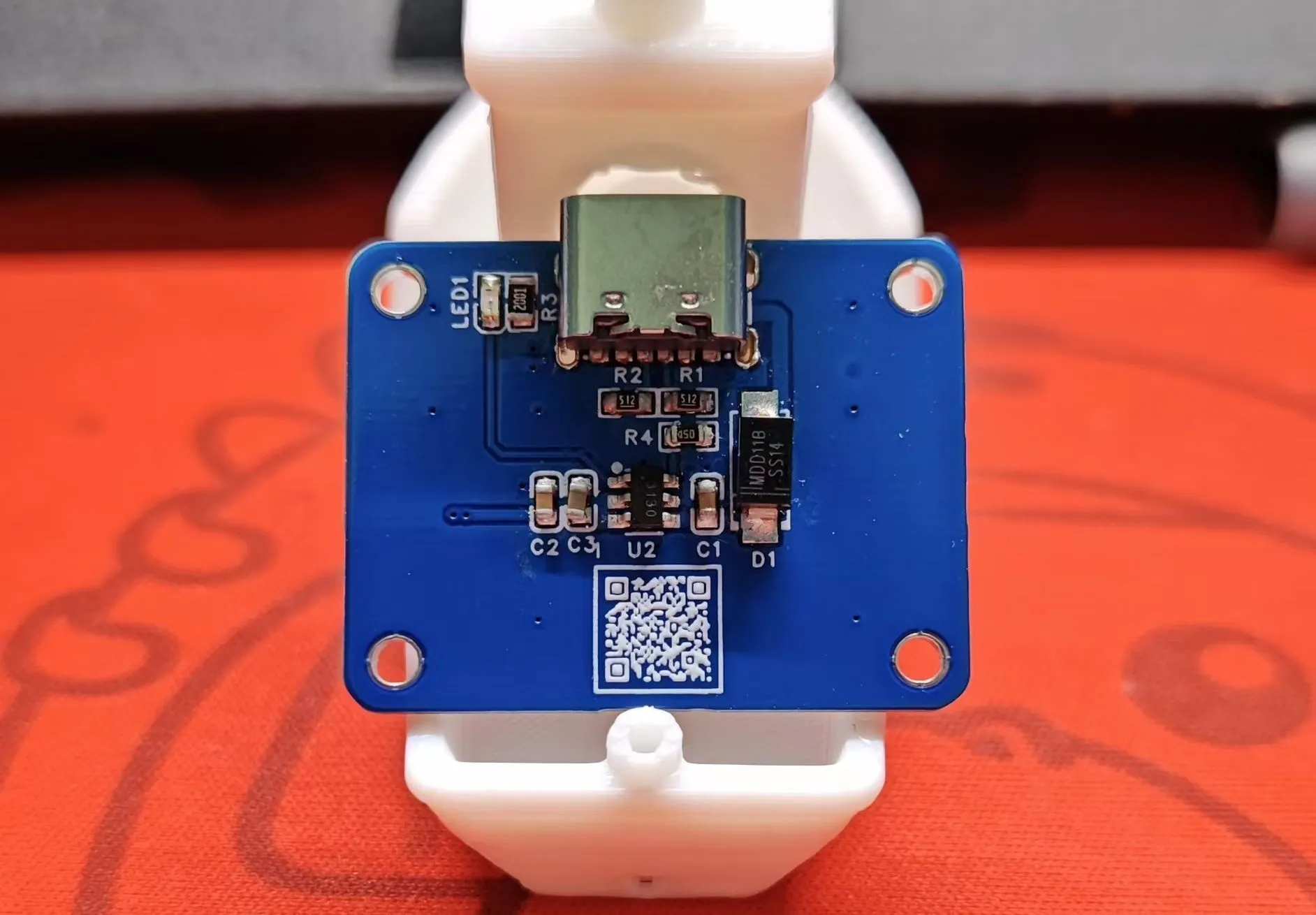

I. Design Summary This circuit
can charge an LIR2032 (3.6V) and a 4.2V lithium battery. It only requires configuring a resistor. An external solar panel (voltage range 3.9~6V) can be connected to charge the battery. The charging current is configured using a resistor, with a maximum charging current of 300mA.
II. Hardware Circuit Composition
This circuit is very simple, consisting of two parts
: 1. Charging Interface: The CC pin is connected to a 5.1K resistor to ground for easy C-to-C power supply.
2. Charging IC
Voltage Configuration Resistor R5
R5 value: 80K for LIR2032, 240K for 4.2V lithium battery.
0R 3.3V
80K 3.6V
240K 4.2V
Calculation Formula
Current Configuration Resistor R4
1188V/120KΩ = 9.9mA
The minimum charging current is 10mA, therefore R4 is 120KΩ.
The maximum continuous charging current can reach 300mA.
3. Physical Demonstration
III. Precautions:
SS14 does not require soldering short circuit (for reverse polarity protection solar panel) when not using solar charging function. R1 and R2 do not require soldering.
