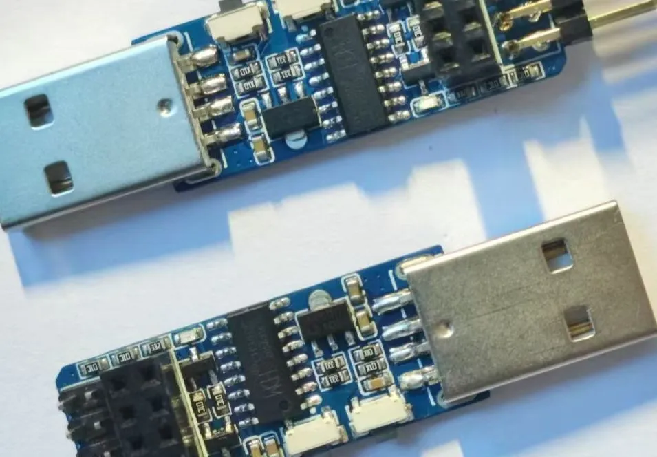

previously purchased several programmers claiming to be CH340C from a certain platform, each with an ESP01S module. None of them worked properly; the chip markings were worn off, and the circuitry differed from the CH340C's specifications. Frustrated and not wanting to waste the ESP01S, I designed this board myself.
This
project does not include the ESP01 module, only the programmer. Automatic ESP download is supported. The board uses a USB-A interface. The two buttons are: the one closer to the USB port is the RST button, and the other is a low-level IO0 button for ESP development. The 2x4 header can be directly plugged into for ESP01 module development. The 2x4 header pins have the same pin arrangement as the header, corresponding one-to-one, and are used for external DuPont wires to program the microcontroller. For ease of understanding, MRX directly corresponds to the microcontroller's RXD pin, and MTX directly corresponds to the microcontroller's TXD pin; no swapping is required. The Windows Device Manager
was verified
to correctly recognize the serial port. The ESP01S module was successfully programmed using the official ESP programming program. After programming with MicroPython, the MicroPython development tool recognized the module correctly and could also program the microcontroller successfully. (
Image of the actual device follows.)
