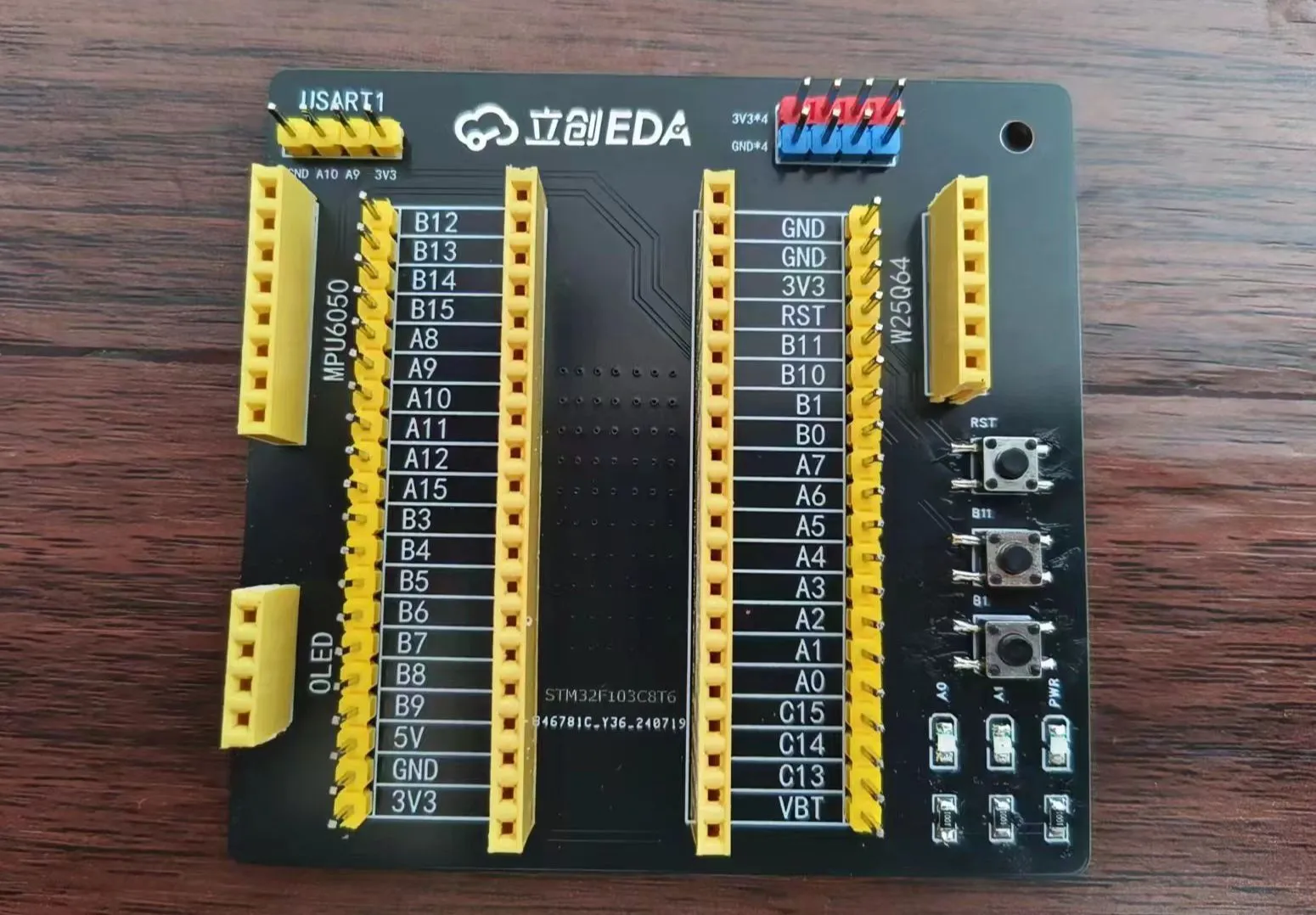

STM32F103 expansion board, compatible with Jiangxie Technology tutorials

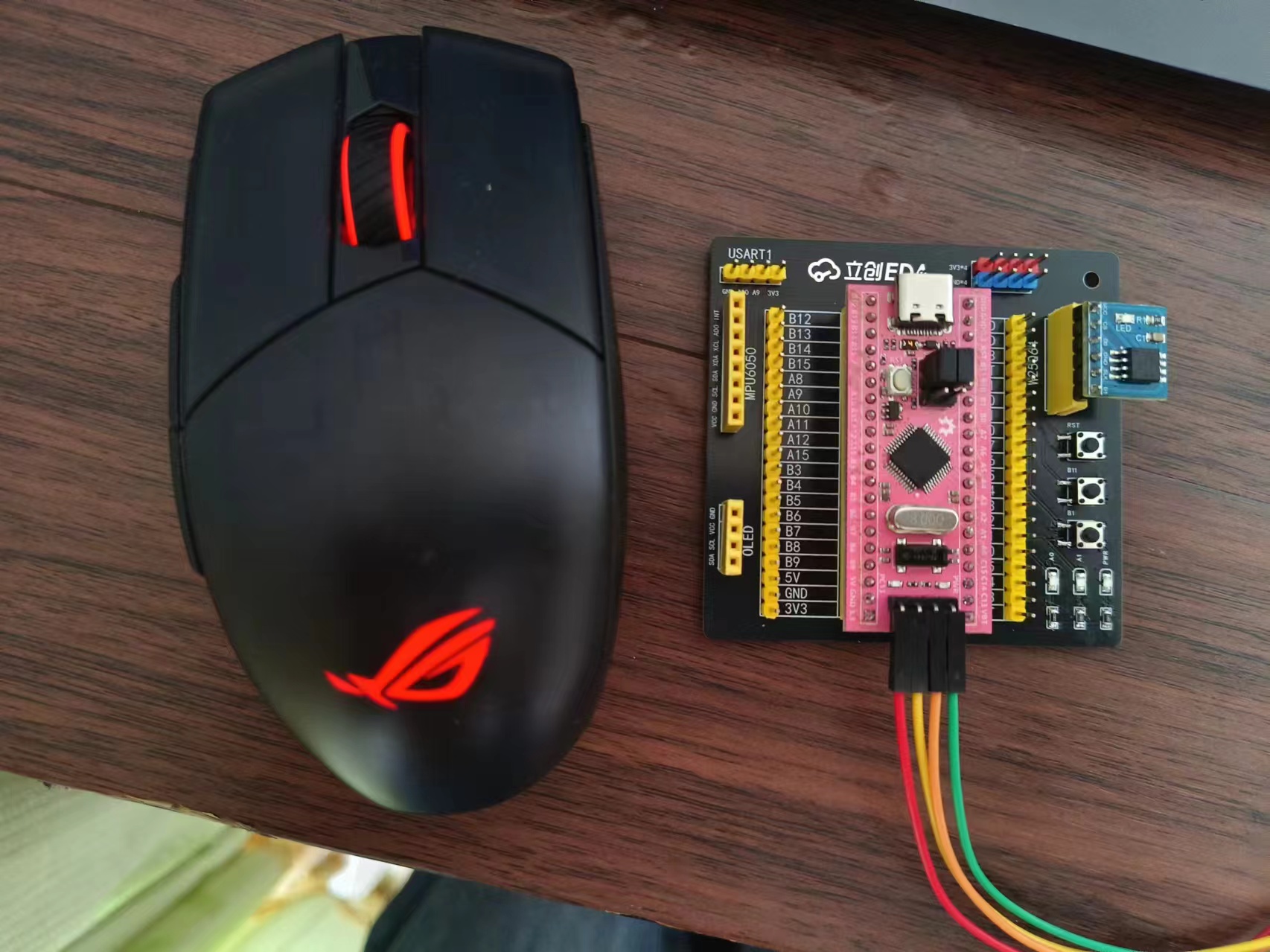

This is a comparison of the board's actual size
with a mouse; the board itself is smaller than half the size of a mouse
It's an

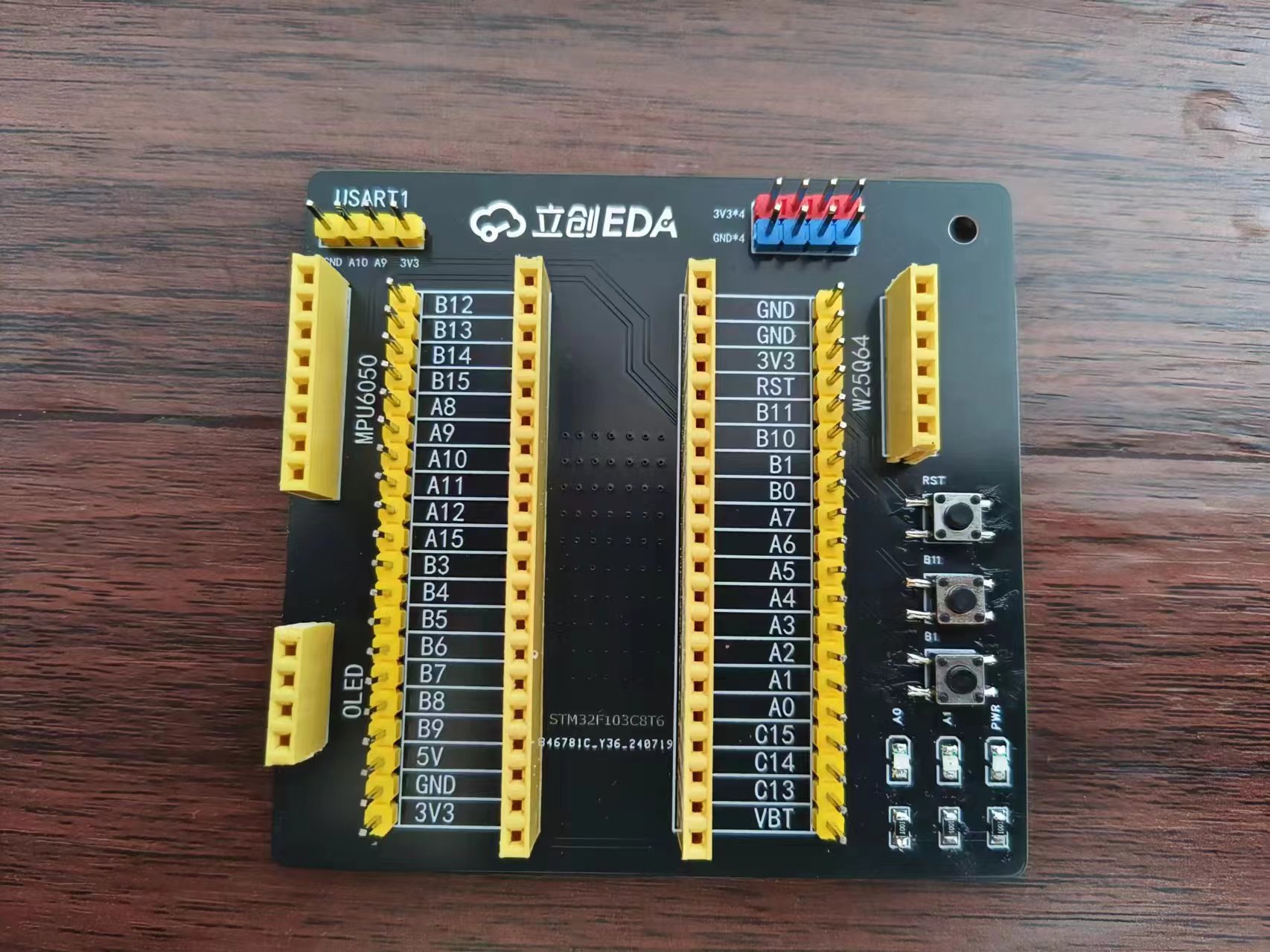

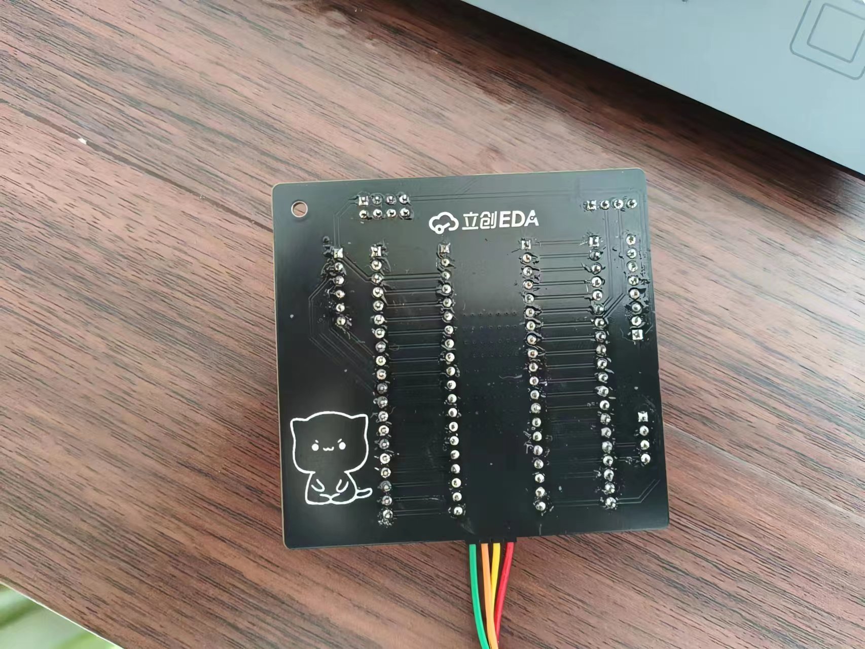

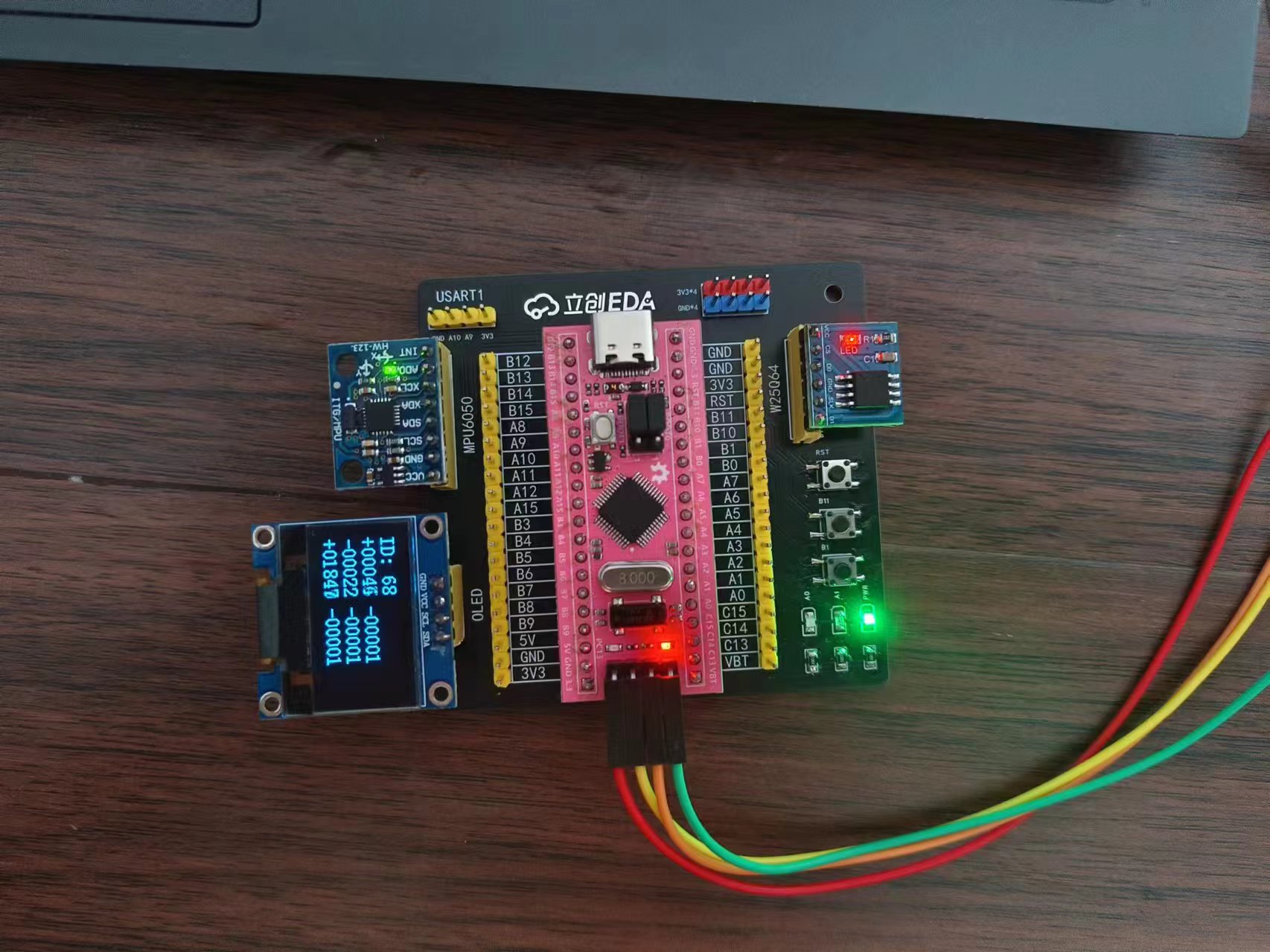

STM32F103 expansion board, suitable for Jiangxie Technology tutorials. The design philosophy is compactness and convenience. All I/O ports are brought out,
with headers and pin headers for connecting to MPU6050, W25Q64, OLED, USART1, and 4 power pin pairs.
Considering the small size of the reset button on the minimum system board, it's also brought out and
packaged on the expansion board
using a 4.5*4.5mm small button package. Resistors and LEDs are 0805 resistors, and both headers and pin headers are 2.54mm.
