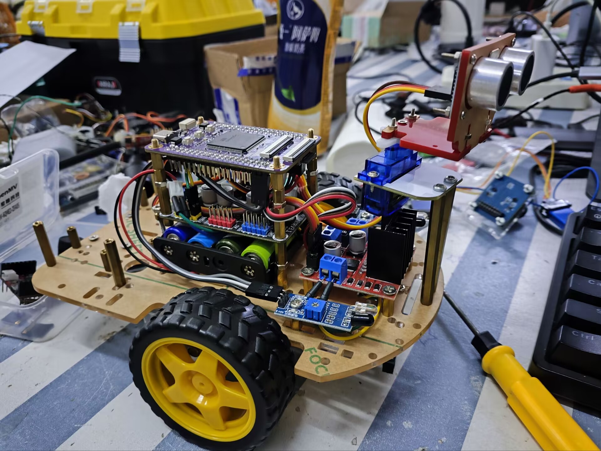

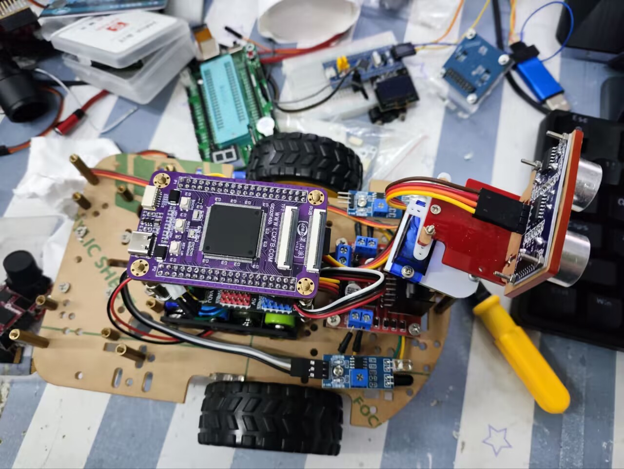

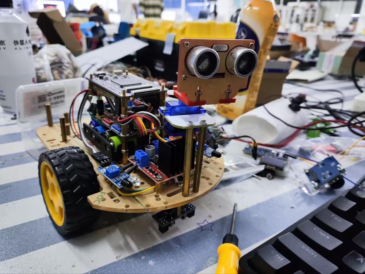

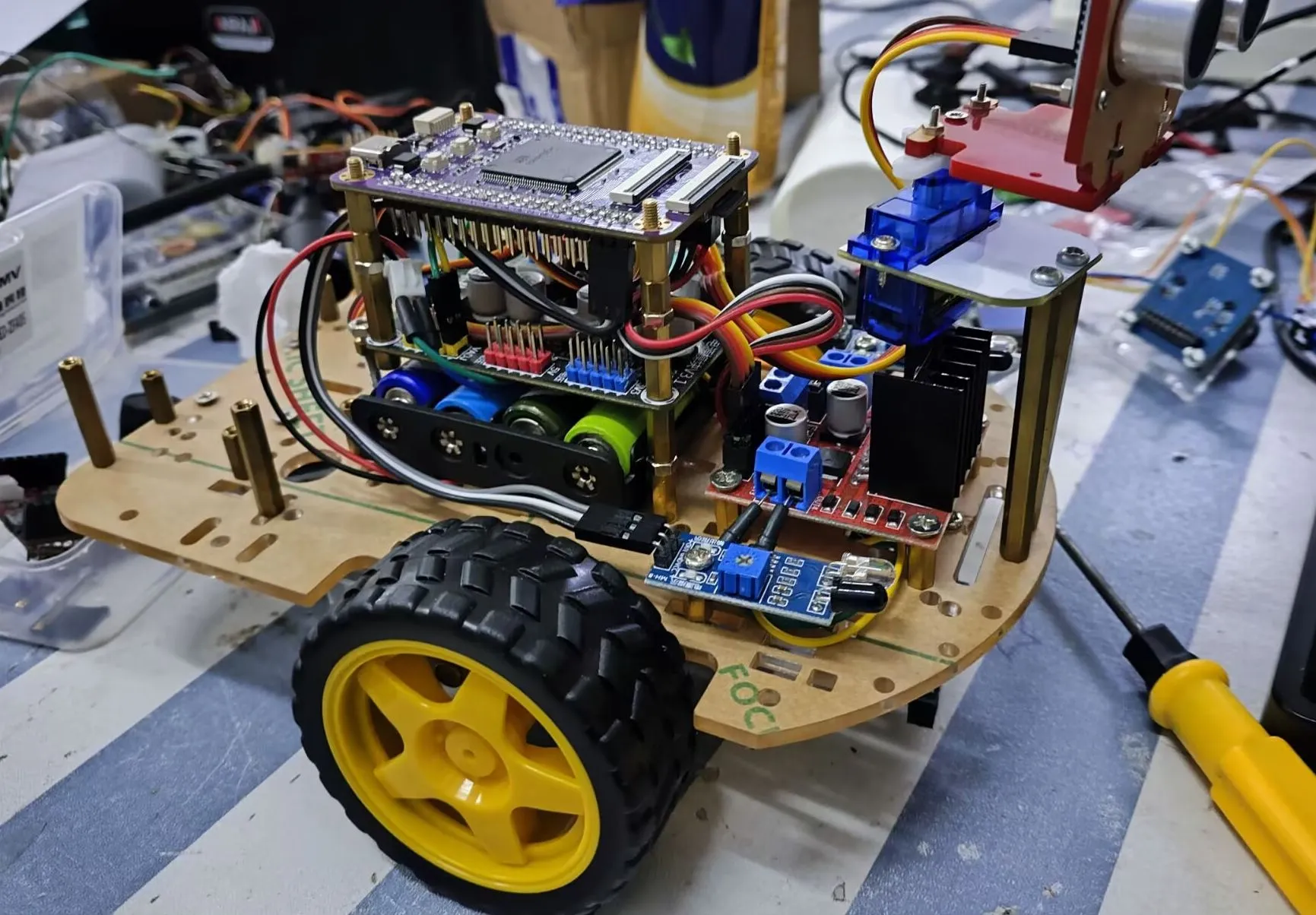

Lichuang Liangshan School Cart
Component Overview:
LCSC Liangshanpai: As the main control unit, it handles all sensor inputs and control signal outputs.
L298N Motor Driver: Drives two geared motors, enabling the robot to move forward, backward, and turn.
Infrared Obstacle Avoidance Module (2 units): Detects obstacles in front of the robot to avoid collisions.
Infrared Tracking Module: Detects preset tracks, allowing the robot to follow them.
Ultrasonic Obstacle Avoidance Module: Provides obstacle detection at greater distances, enhancing the robot's obstacle avoidance capabilities.
Servo Motors: Can be used to adjust the direction of certain parts of the robot (such as cameras, sensors, etc.).
4 AA Batteries: Provide power to the robot.
Longqiu Power Module: Stabilizes the battery voltage before supplying it to the main control unit and other modules, ensuring a stable voltage output.
Geared Motors (2 units): Provide driving force for the robot. Omnidirectional
Wheels: Help the robot turn more flexibly.
Construction Steps:

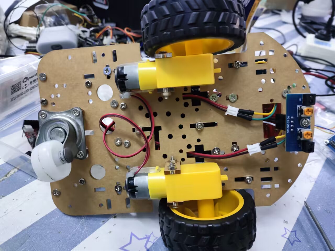

Assemble the Mechanical Structure: Install the two geared motors and one omnidirectional wheel onto the bottom of the robot, ensuring they can smoothly drive the robot's movement.
Power Connection: Connect four AA batteries to the Longqiu power module, then connect the regulated power supply to the LCSC Liangshanpai and other modules requiring power.
Sensor and Actuator Connection:
Connect two infrared obstacle avoidance modules to the input ports of the LCSC Liangshanpai.
Connect the infrared tracking module to another input port.
Connect the ultrasonic obstacle avoidance module to another input port. Connect
the input port of the L298N motor driver to the output port of the LCSC Liangshanpai, and connect the geared motor to the output port of the L298N.
Connect the servo motor's control port to another output port of the LCSC Liangshanpai.
Control Program Development: Write control programs using appropriate programming languages ​​(such as C/C++, Python, etc.) to implement the robot's obstacle avoidance, tracking, and other functions.
Testing and Debugging: Test the robot's functionality in a safe environment, ensuring all sensors and actuators are working properly, and debug as needed.
