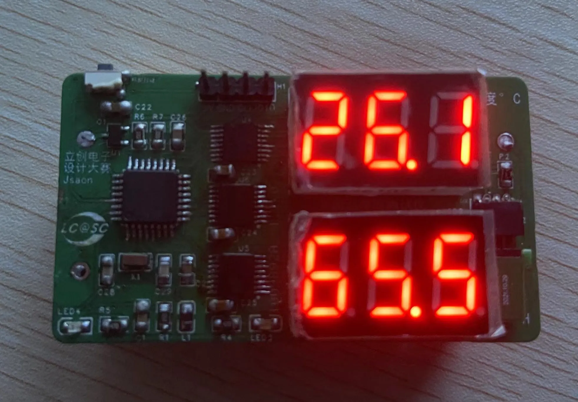

The SMT32G030K6T6 main control IC sends data to the SHT40 sensor, and the raw data received from the sensor is fed back to the main control IC for calculation, analysis, and display on two three-digit LED displays. Low power consumption is also configured. The system is woken up by an external button, displays twice, and then re-enters sleep mode.
