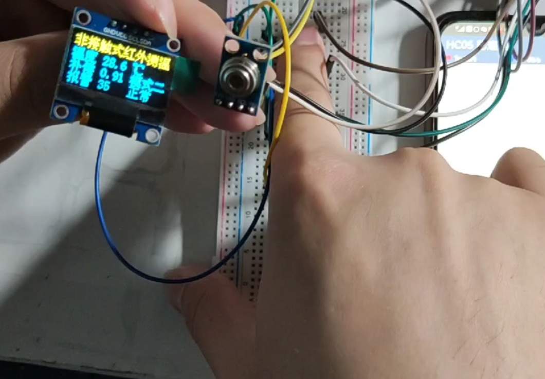

Use SMBus to read the temperature of MLX90614, and then display it on OLED. Press button 1 to change the working mode, press buttons 2 and 3 to add and subtract the corresponding values, and press button 4 to start temperature measurement and send the temperature to the mobile phone.
Implementation function:
1. Measure temperature without touching objects ;
2. Manually press the button to change the temperature alarm value ;
3. The buzzer will respond to excessive temperature ;
4. Manual button for temperature compensation;
5. Press the temperature measurement button to automatically upload the measured temperature of the object to your mobile phone;
Provide schematics, PCB Gerber files, and code projects.
