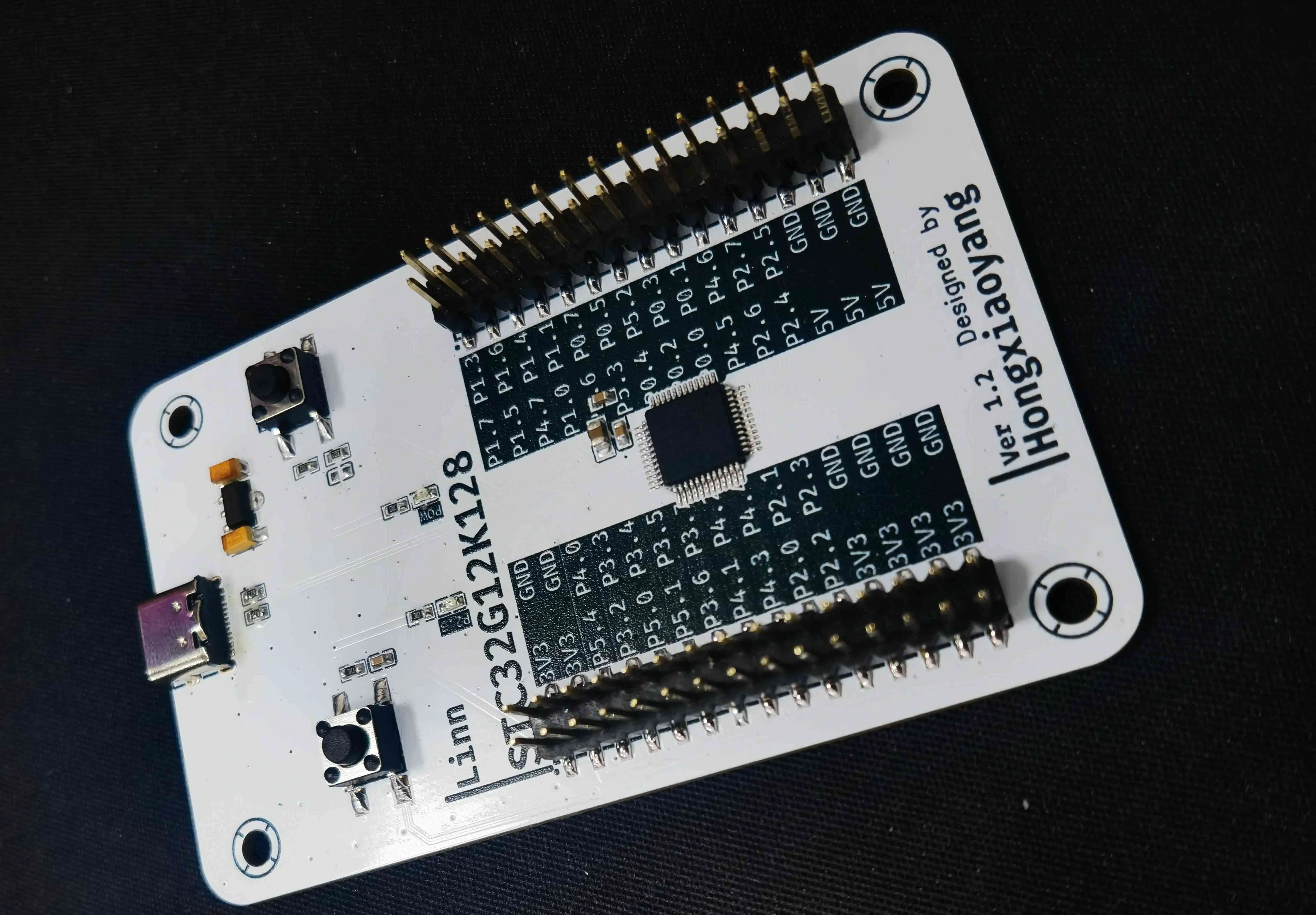

All components on the Linn development board
are surface-mount, resulting in fewer components that can be soldered using a hot plate or hot air gun.
All pins are brought out for ease of use, and numerous 5V and 3.3V outputs have been added.
The tantalum capacitor next to the AMS1117 requires careful attention to polarity; otherwise, it might make a loud noise.
The ISP download is still under verification and modification .
