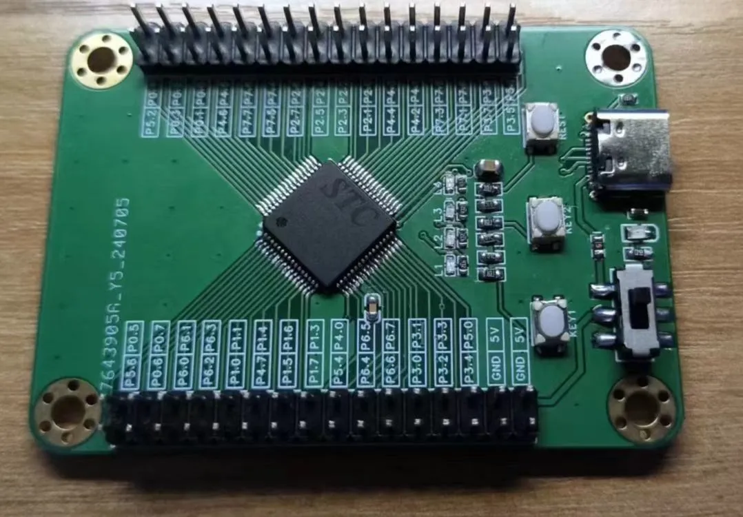

STC Core Board
Note the flash package size; it should be the same as the CH340N.
