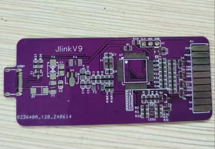

JLink v9_typeC_noScrew_ verified
1. Uses a Type-C interface, STM32F205 main controller, supports JTAG and SWO output. Firmware updated to 9.4 without issues, personally tested. All components used in this project are readily available. If a more suitable component is needed, the ESD protection circuit can be replaced with an ESD5302F.
2. D2 is the SWD write protection circuit; if unavailable, it does not need to be soldered.
参考设计图片
