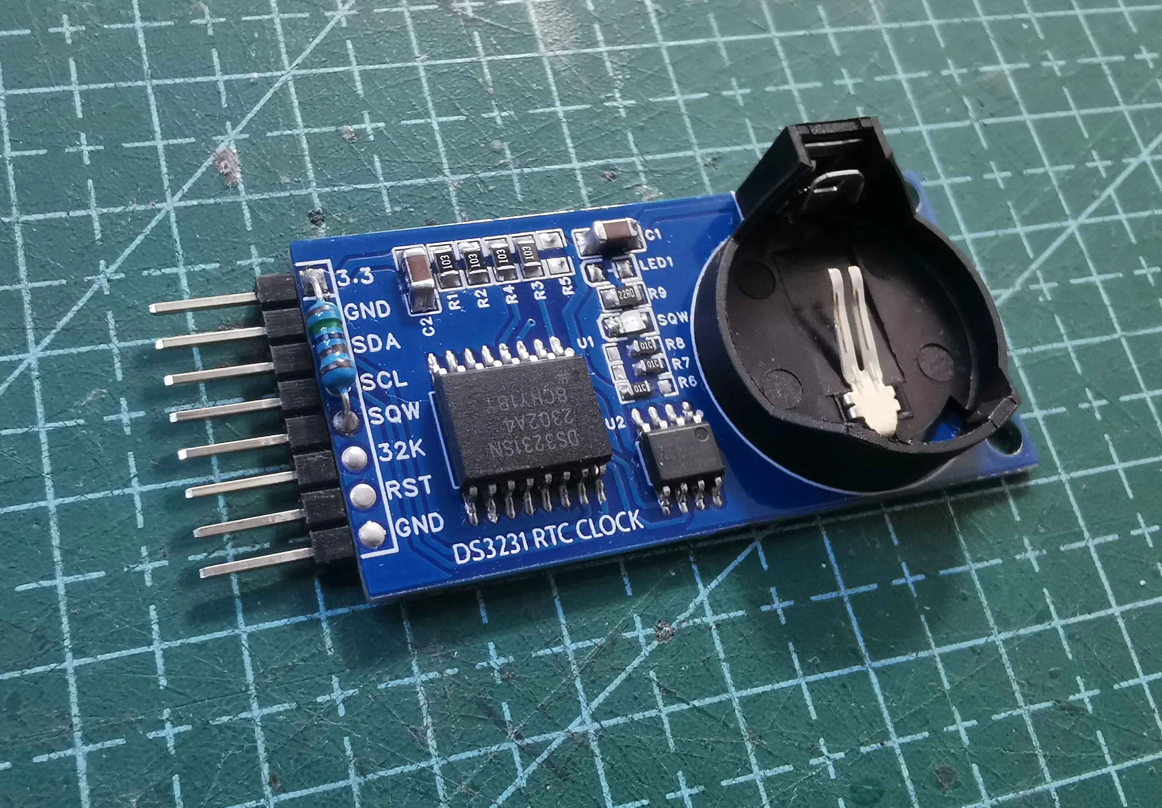

Two years later, in 2024, my soldering skills were barely passable, and I happened to have some stock available at the end of June, so I started this project. The board's dimensions are 50x25mm. The backup battery uses the most common CR2032 battery on the market. It's not too small, but it's not too big either; it can be used on breadboards, perforated boards, or directly connected via jumpers. The circuit diagram is very simple. An AT24C02 memory is added to the IIC bus to store some operational information. To prevent address conflicts with other EEPROMs, R6, R7, and R8 are shorting blocks used to change its communication address. Please pull them high or low as needed. Later, I plan to see if I can use it to make a custom time switch.
                                      Figure 2. The second DS3231 module I drew in 2024.
  I included several programs for this module, including a program to measure the address of IIC devices to determine the addresses of all devices on the current IIC bus, and an Arduino library file for DS3231 read/write that I wrote in 2022. Since I am using an STM32duino, you need to set the IIC bus to pins PB6 and PB7 for testing. Two more points to note: the DS3231 should not be powered by more than 3.3V, as this may cause it to burn out. Also, my board's SQW pin is not pulled up. If you need to use SQW to light up the LED, you need to add an external pull-up resistor and reduce the resistance of R9 (you can see that I added a resistor on my board, from 3.3V to SQW. This way, the SQW pin can drive the LED).

                                                   Figure 3. Back of the module
