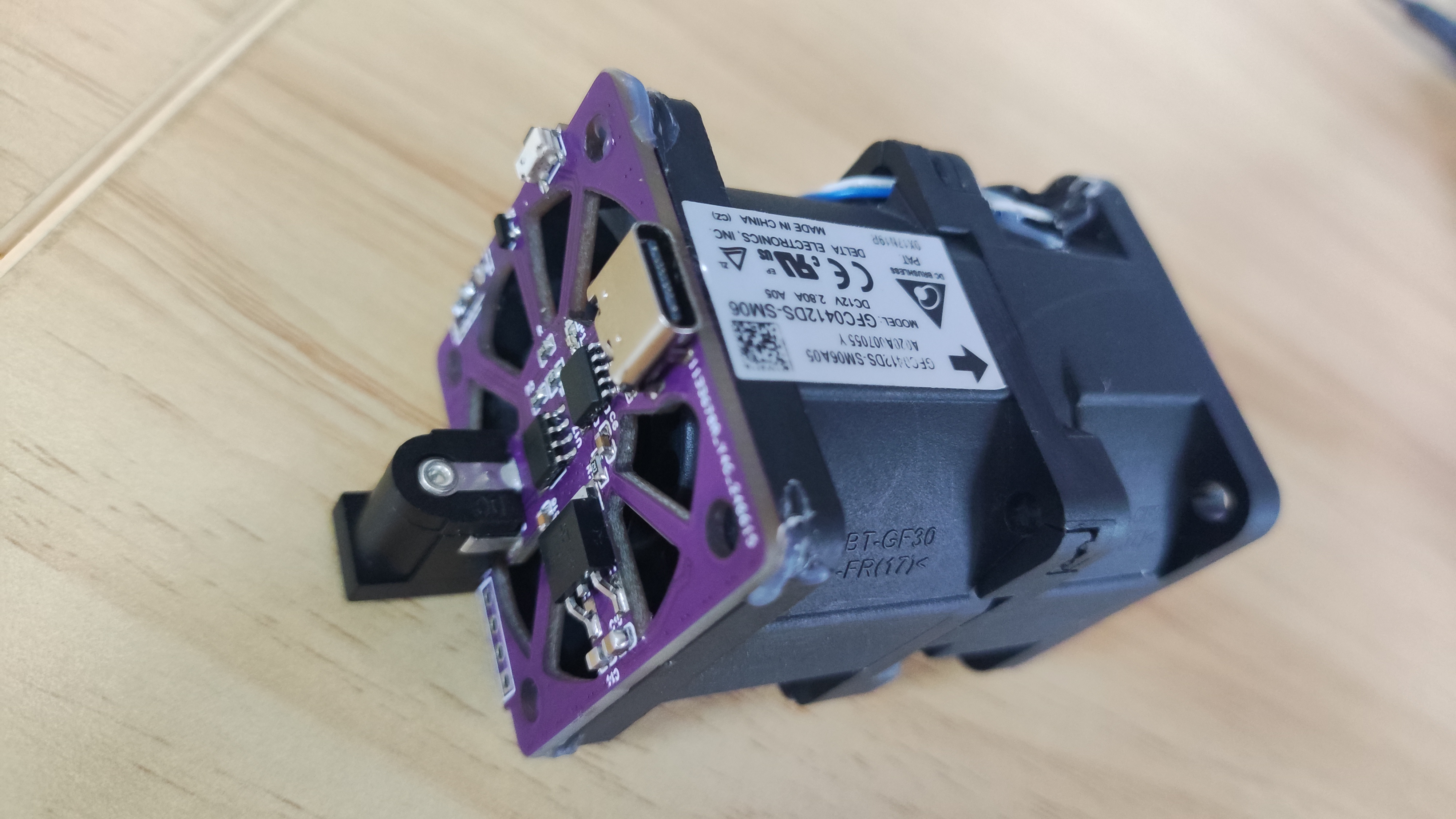

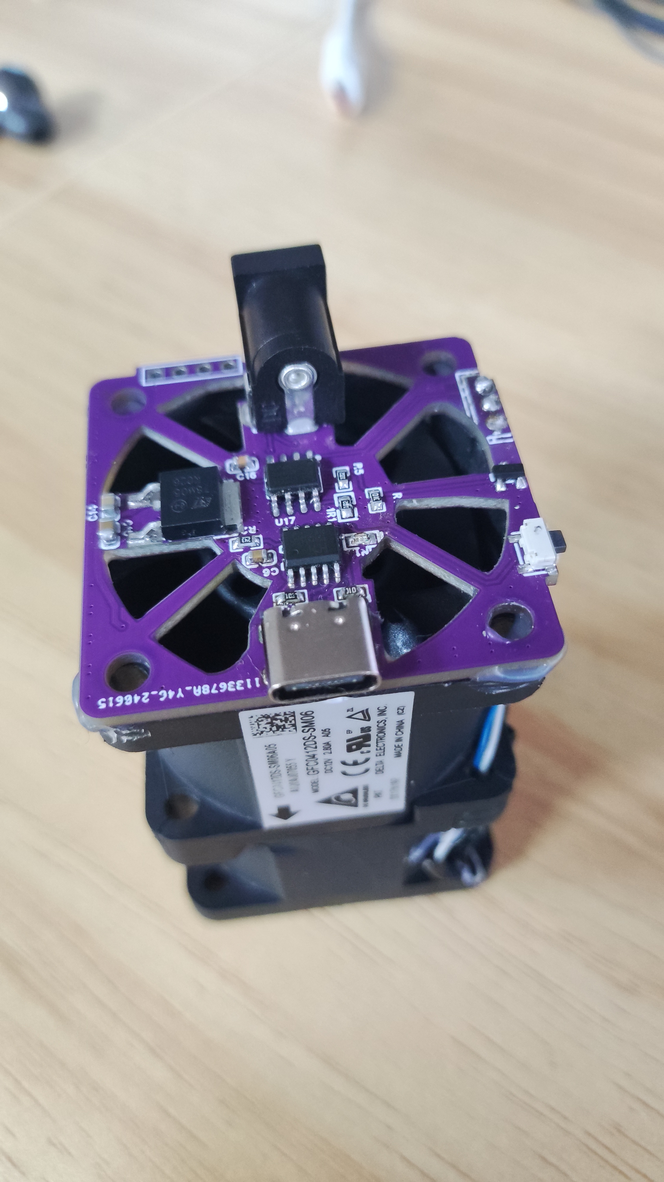

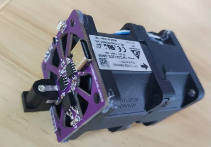

Portable ducted fan, 4 speed settings, 12V power supply, supports PD decoy + DC direct plug.

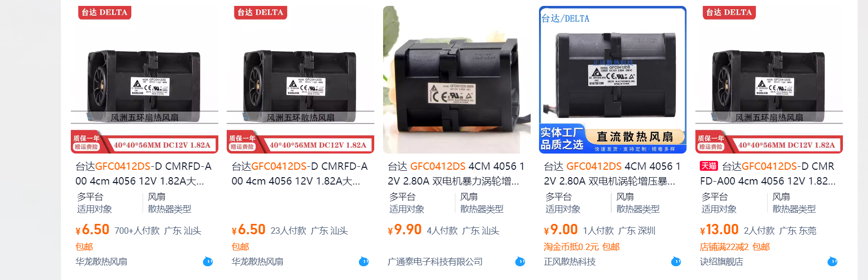

The fan used is a GFC0412DS, 40*40 cm in size. The price on Taobao is as follows: Mine was salvaged from another device
and is controlled by an 8-pin STC8G1K08A-36I-SOP8 microcontroller.
The button logic is
: 0 speed: stop (initial speed); 1 speed: slow; 2 speed: medium; 3 speed: high; 4 speed: fastest. The LED indicator light
illuminates
for 1 second after the microcontroller is powered on, then turns off. The LED flashes faster with each speed increase, until it remains lit at the highest speed. The firmware is attached.

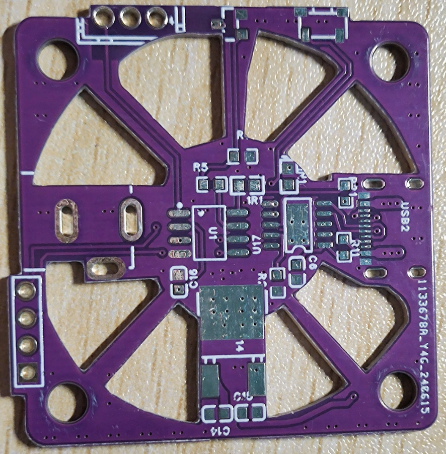

For

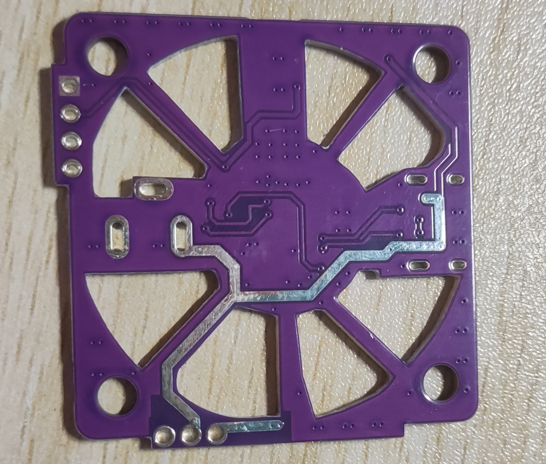

board fabrication, choose version 78M05.
The solder mask layer on the back of the board has been removed; you can add solder to increase the current.
