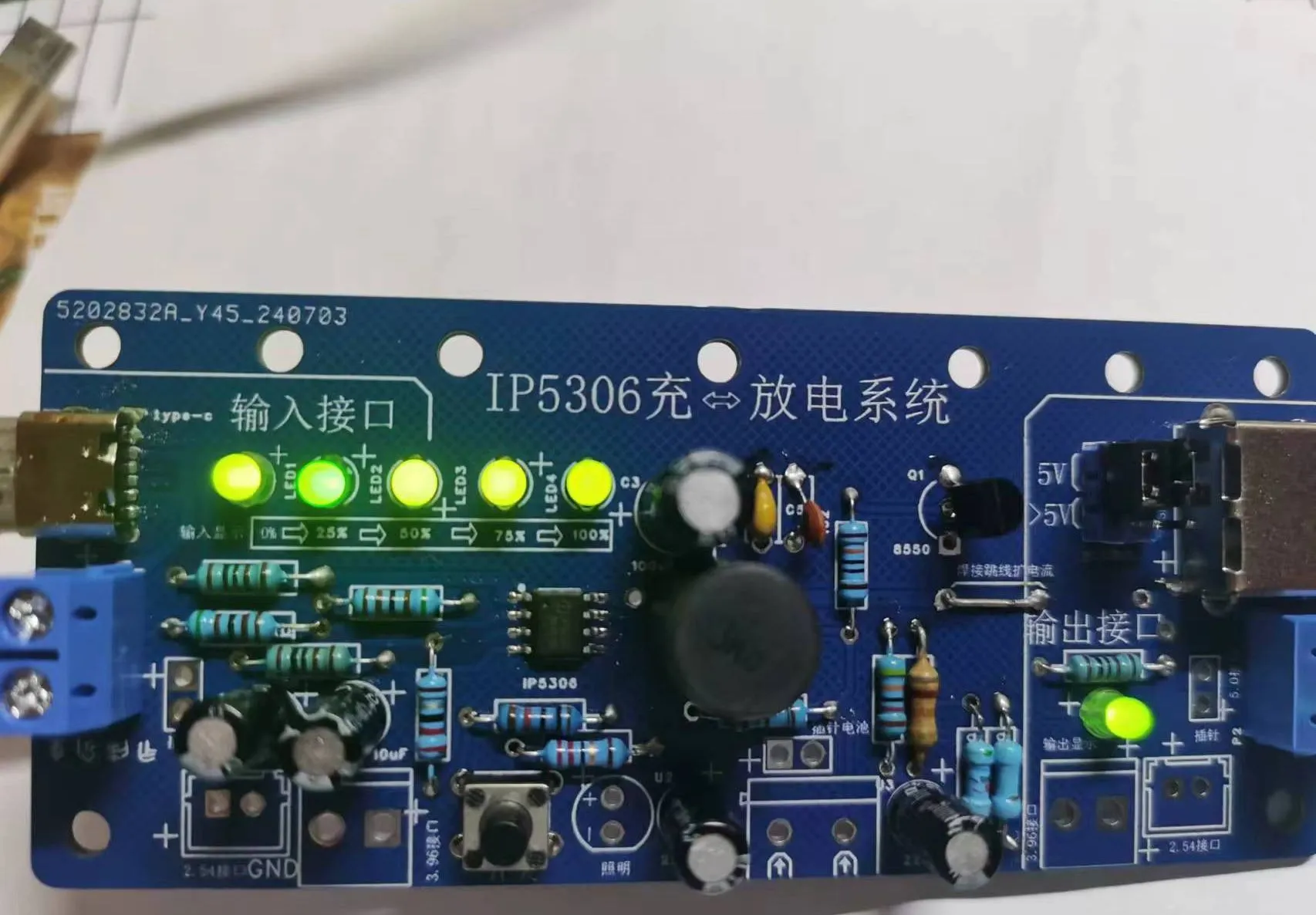

IP5306 Charger/Discharger
The circuit board is designed with through-hole components in mind, except for the 5306 surface-mount component. Those who prefer smaller boards and miniaturized designs should choose other options. Since this circuit board uses discrete components, those with lower power consumption requirements can choose to use 1/8W components (this circuit diagram uses 1/4W). Also, when soldering the 5306, remember to apply solder flux to the back of the chip. This circuit diagram includes two additional solder holes to enhance subsequent heat dissipation.
